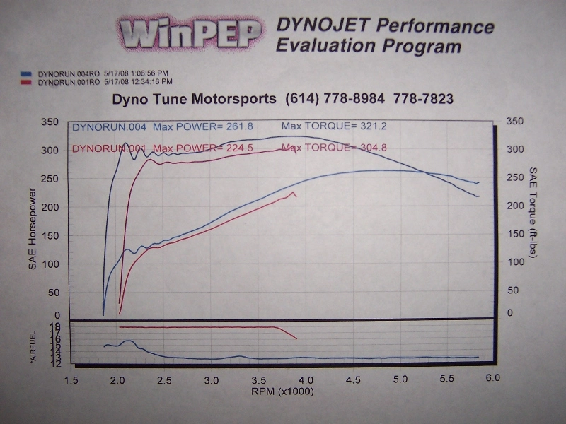

We found out the stock intake is definitely too small for the 5.4L. It made a ton of torque down low, but hit a wall about 4500rpm. We were expecting something close to the 321rwtq, but Shawn was a little disappointed with only 261rwhp. The car is a blast to drive on the street though.

i don't think it has a torque curve, more like a spike.

I saw Brian posted this up on Columbus Racing. Congratulations. That is one hell of a torque "curve".

Yes, its out of a 2003 F-150. It only has 11k miles on it. Like Mike was saying I am a little disappointed at the HP number but the TQ was exactly where we thought it would be. Just waiting for the HPS 5.4 intake to come out

Yeah if you could bump the torque curve up about 1000 rpm, it would be over 300rwhp.

Good point Zero. That is what I am trying to do.
