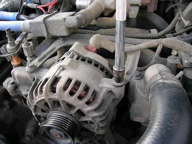

2003 Mach 1 Alternator Replacement
6-Bolts,2-electrical connections and take the tension off the automatic tensioner..
It will take you almost as long to pop the hood and disconnect the battery :D
I wish that every car had an alternator on sooooooo stupidly easy to change as the 4.6 Mustang. I have changed more than one in a parking lot using only a socket drive handle, and a pair of pliers. I tend to buy salvage yard alternators because the alternator is so easy to change. I generally get several years between changing.
