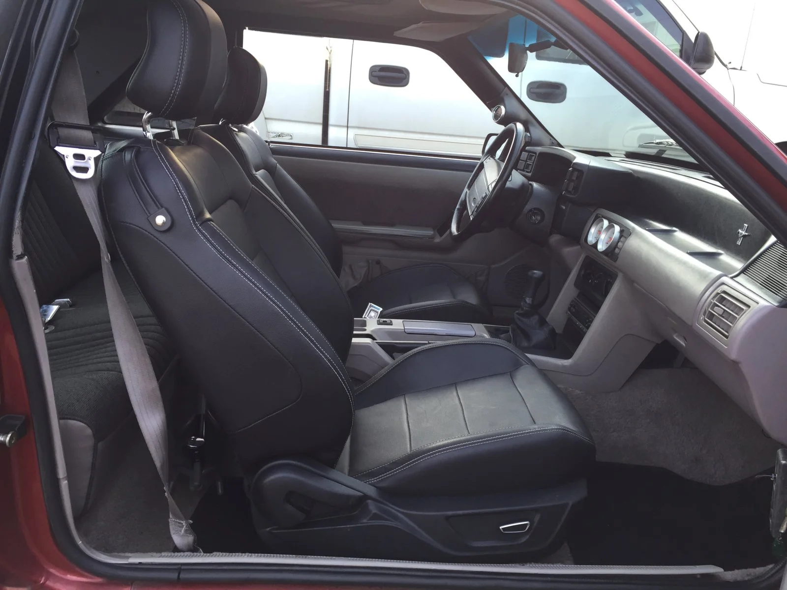

Hey fellas, I'll have to search my phone to see if I have any pictures of it finished. I don't remember if we took pix of the interior specifically. I know there are different versions of these seats, powered, manual, heated/cooled etc. The seats I purchased were manually adjusted, even the height adjustment. Our seats would not fit in the car. They would have sit way too high, and they were no match for the Fox floor. The 2015 seat brackets are welded to the seat frame, so I cut them off with a ziz wheel. I removed the height adjustment mechanism from ours since it was not needed. I welded the square tubing to the round tubes and bolted the Fox seat adjusters to the square tubing. The seats are a tight fit, but they do fit, and they're head and shoulders above the originals.

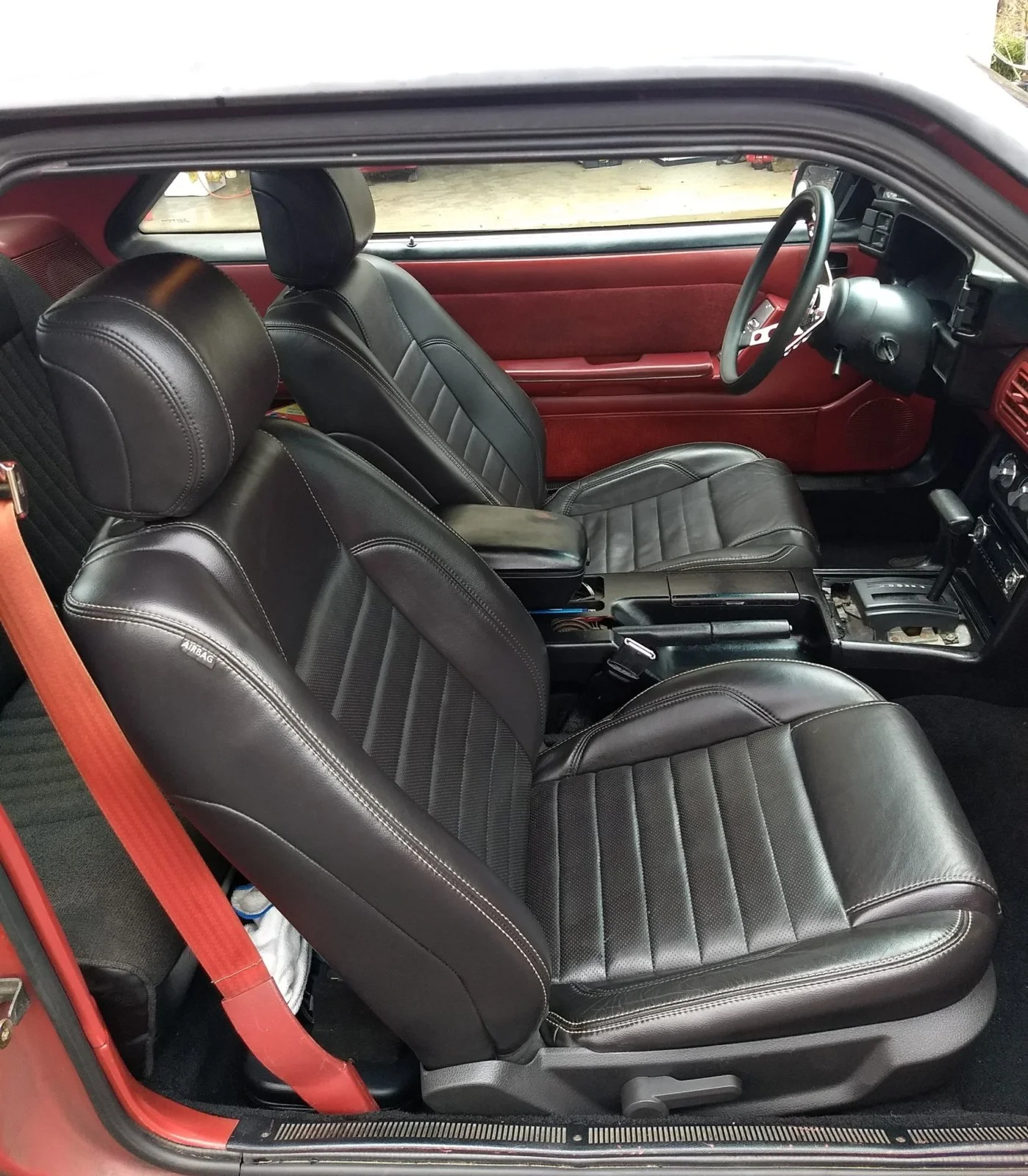

What year seats? How tall are you? I did the 2018 seats I’m my 1990 hatchback and love it. I have detailed pictures in my build thread, somewhere around page 80 or so I believe and the link should be in my signature. I used 3/4” square tube with 1/8” wall and welded it all together. This raises the seat height a bit and I’m 6’3” so I cut the rear feet down on the Fox tracks and that made it perfect for me.
