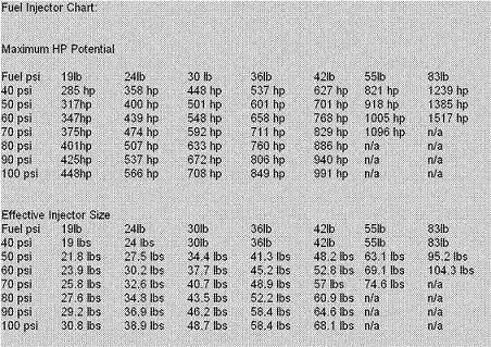

Suck it up and buy 42s and a tune. With 24s you'll be needing an FMU to ramp up fuel pressure enough to support the boost. The trouble with doing that is whenever pressure is ramped up then the max volume of fuel the pump is able to produce is reduced.
An FMU must be tuned mechanically whereas sufficient sized fuel injectors can be tune electronically. Many tuning facilities refuse to tune an FMU and that may leave you tuning it yourself.
For that, you'll need a wide band AFR meter. A good one will cost you at least half of what a custom chip will cost. You also may discover that you'll need a helper pump in addition to your in-tank pump because you're trying to provide the necessary fuel volume at elevated pressures. Those also cost money.
Last but not least, fuel injectors become more inefficient, the higher you ramp up the fuel pressure. Atomization is not as complete at 70+ psi as it would be at 40.
In a nut shell... it's better to run properly sized injectors at near stock fuel pressures than forcing smaller ones to do the job.
One other small footnote:
24 lb injectors are usually good to about 300HP as mentioned above. That figure is for normally aspirated applications. More injector is required to make the same power in a boosted app.
Yes... it can be done with 24 lb injectors. There are certainly better ways to do it though. Having the ability to electronically control your AFR will result in an often, much better power band.

Thanks for all the replies. I finally made up my mind. I'm going to get 42# injectors and a anderson PMS. Can't wait to get it all together. Do I need to get a mass air meter calibrated for the PMS? I was reading about it and is said that "Now comes with global fuel adjustments, which means you can offset the mass air for different sized injectors." Thanks again

heres an injector chart for you for reference for boost
