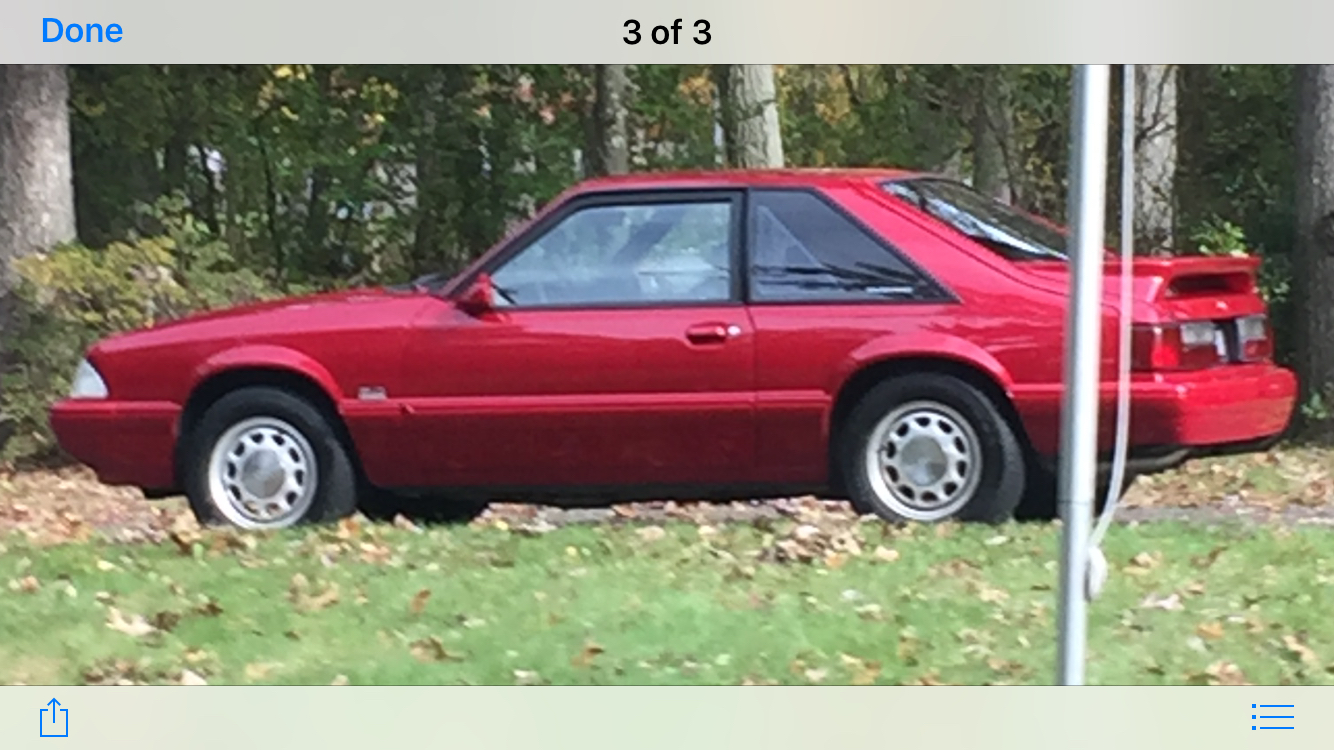

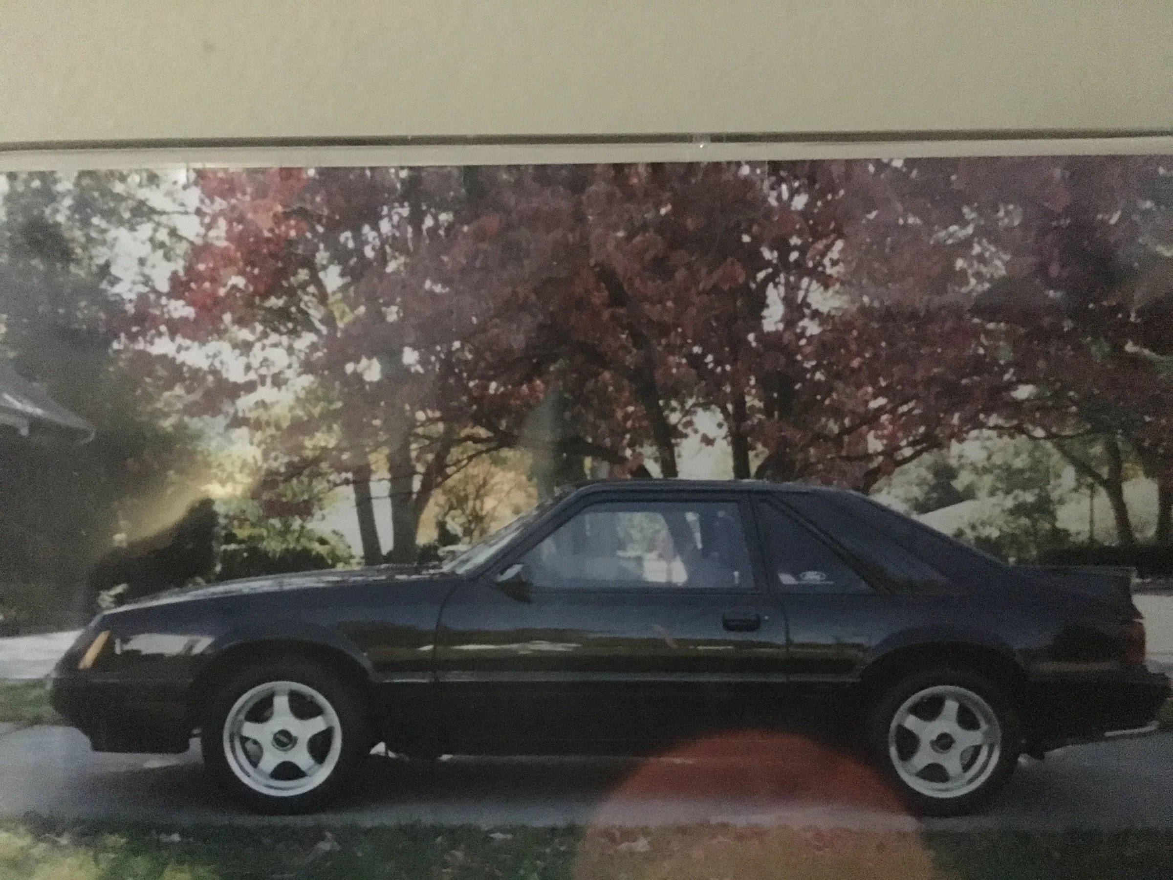

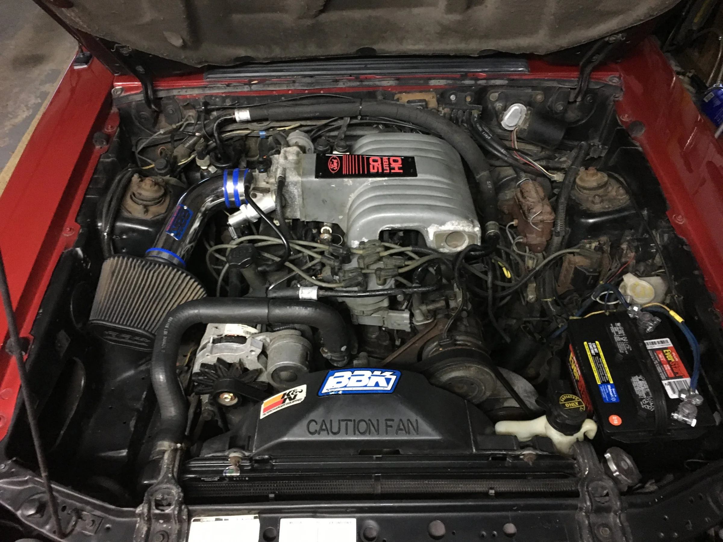

Anyway, glad to be here, and here’s some pics of the new ride, and one pic of the Black one I had years ago.

Very nice:nice:.
How about I move your thread over to the ‘79-‘95 General Talk subforum. Lots of ther guys will join in, maybe one of them can help you with those covers?:shrug:
The previous owner really did do quite the swap on it. It looks good, though I’m a 4i’d guy myself.

Welcome to Stangnet. I have a couple questions about your new 86' Mustang. Are you sure it's an 86'? The rear quarter windows are the 87-93' style. Are these interchangeable? If this really is a 86' then I'd like to kick the previous owner in the nuts. Good luck with your car.

I would also recommend you replace that hot air intake with the stock CAI box, install a set of MM subframe connectors and upgrade to a 3G alternator

You can put the '87^ windows in a 4i.

I agree with that hot air. I have found the BBK tube without the mass air connection, which will get the filter into the fender well where it belongs.
Frame connectors are definitely on the list as well. Had some Kenny Brown (I think that was the name) on my last years ago.
Why the upgrade on the alternator? What concerns would you have now, to address that right away? Thanks!!

Upgrading the alternator and power and ground wires are one of the best upgrades you can do. The electrical system on these cars is underpowered by today's standards.
There also were issues with the stack alternators melting the connectors and causing fires.
The 3g alternator upgrade allows you to run electric cooling fans and headlights at the same time without worrying about the headlights flickering or dimming when the fan is on.
In my case, my camshaft would cause the idle to drop a little idling at traffic lights at night. I'd get that headlight flicker and dimness until I started pulling off from the light. After upgrading the alternator that condition was fixed.
