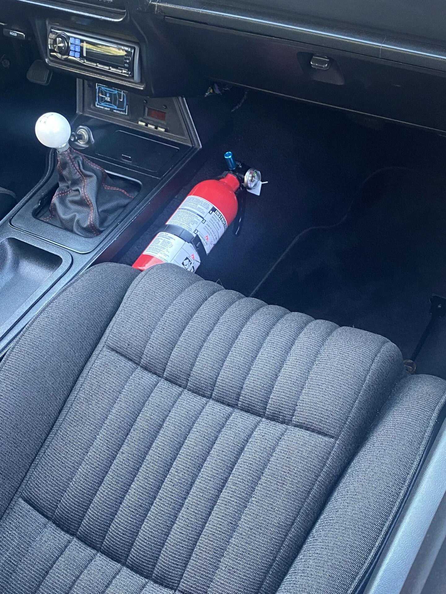

And on the advice of @1hot87gt and @Mustang5L5 I got rid of the 3M Velcro, and screwed in my fire extinguisher for a more secure mount.

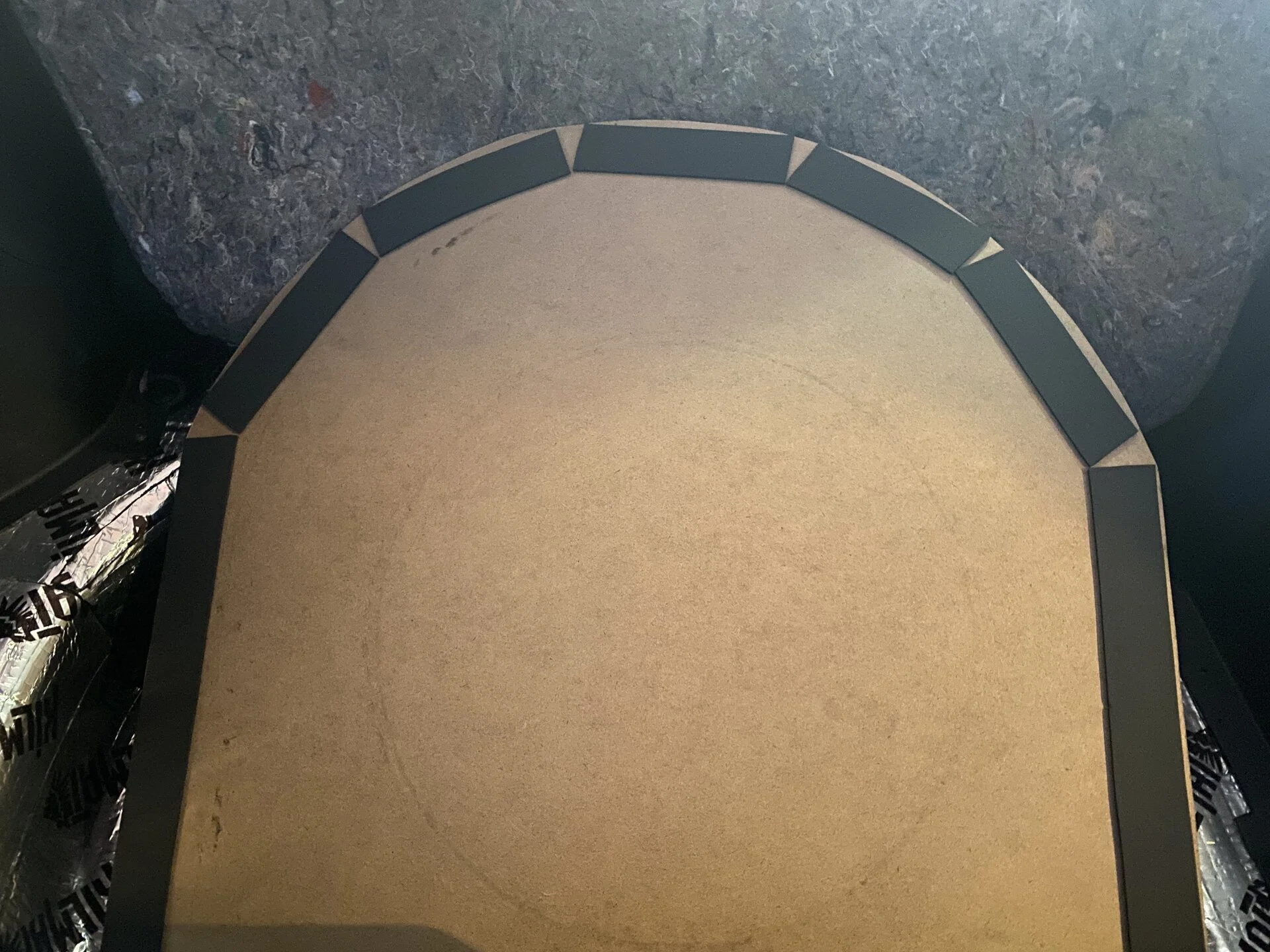

Took the car for a nice ride today. Really just been enjoying driving it lately!
I made a spare tire cover from some 1/4 mdf a while ago, but right now I have no spare. I hear the thing rattling constantly. Should I use some thicker material, or any suggestions on securing it? I had it velcro’d down before I did Kilmat, but I’m leary of attaching the Velcro back to the thin foil on the Kilmat. I feel like it will pull the foil off if I need to remove the cover. Maybe some 1/2” foam insulation around the perimeter of the board?
Long winded post for a real minor issue, I know! Lol

Way back when I was working at the Auto Glass shop, we found that the armatures ( power window motors) would get flat spots on them in the up or down position and not work..... Pulling up or pushing down on the glass ( if you can get a hold of it) will sometimes move it enough for it to work, at least to get it up when it starts raining.......

I’ll try that. It fit nice when I first did it, but I think the lack of the spare is causing it to “belly” and not fitting as well. Just an annoyance right now…… I’ll get it!

Find some Styrofoam like they use for packaging a tv and carve it to fit between the board and the bottom of the tire well, hot glue one end to the board and some foam to the other.
the factory uses Styrofoam between the spare and cover on some vehicles.

Cleaning up in the garage tonight and I came across a roll of pipe insulation. This should do the trick on the spare tire cover to keep it quiet!
