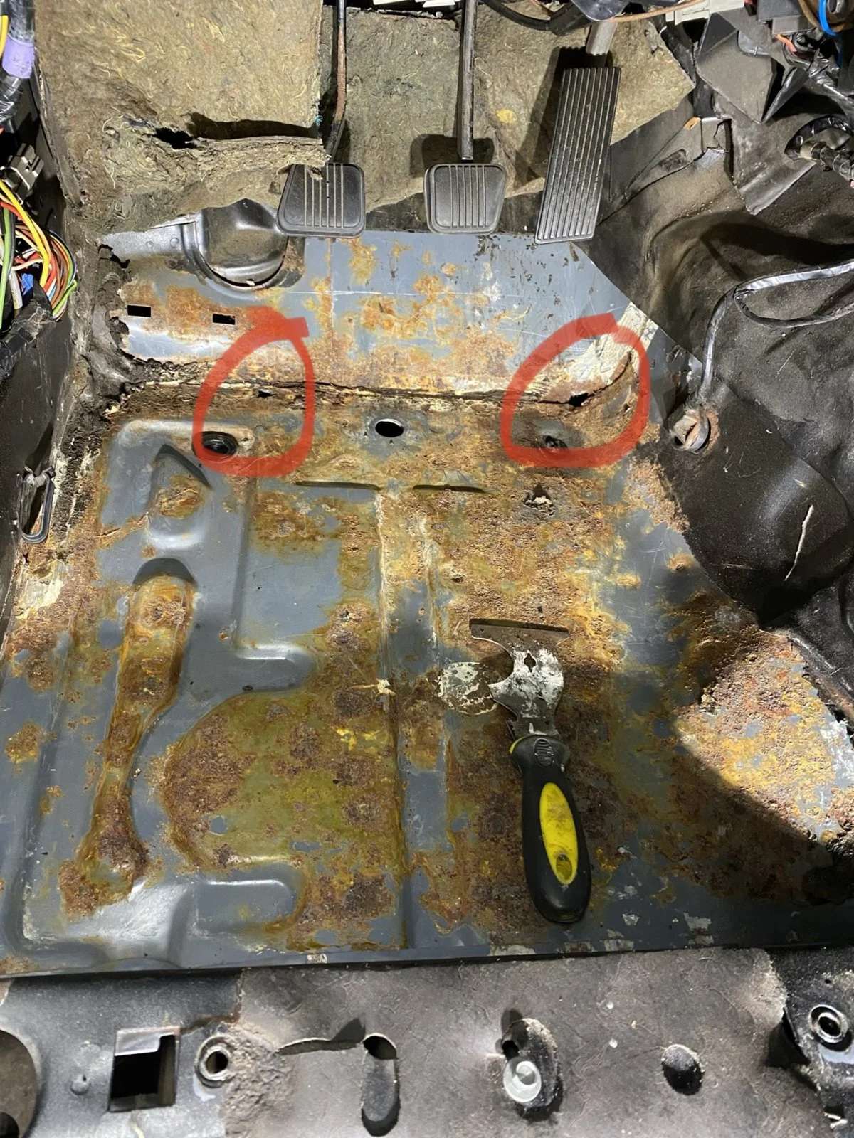

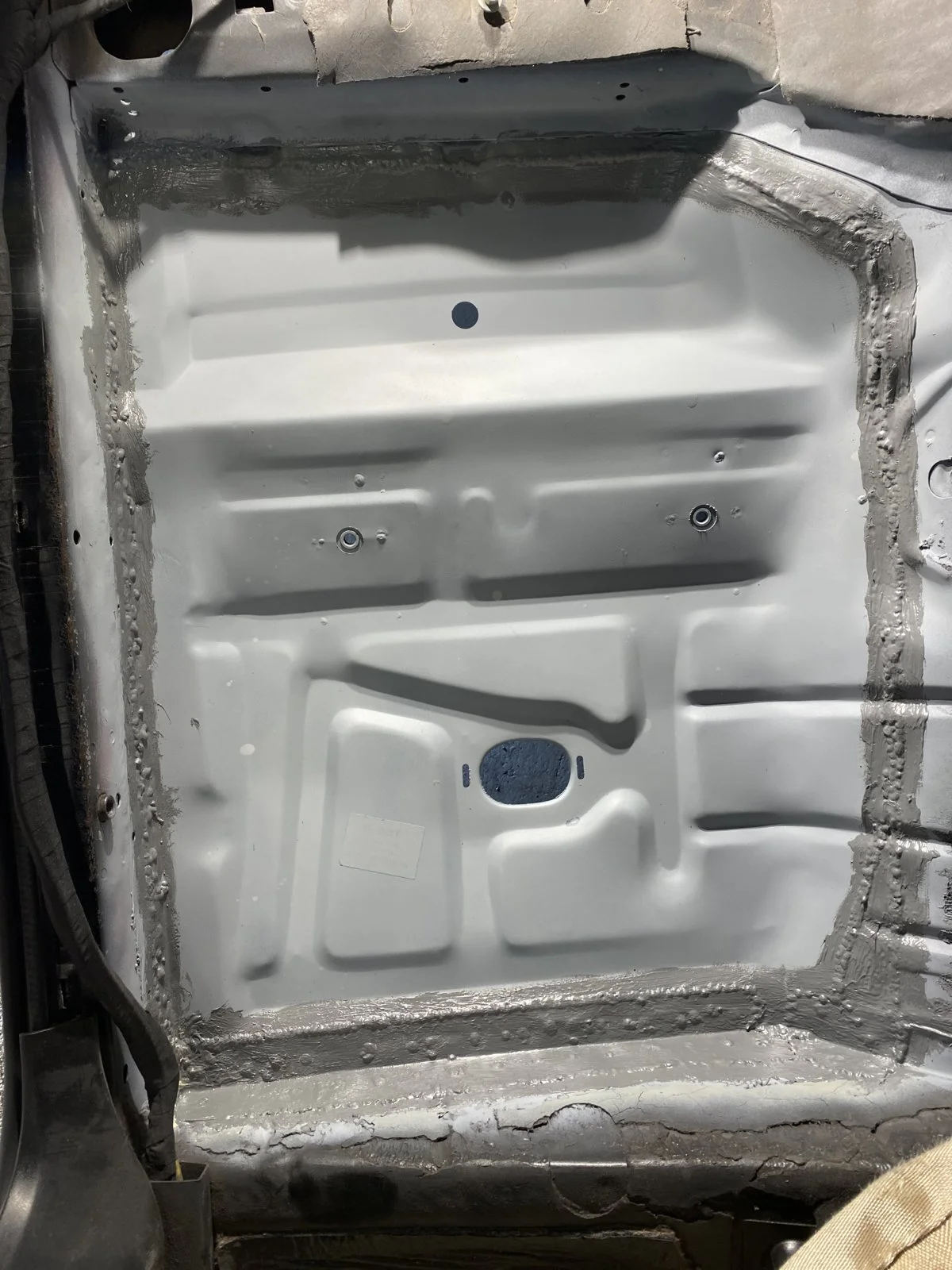

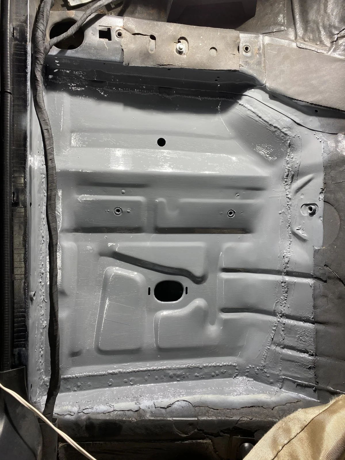

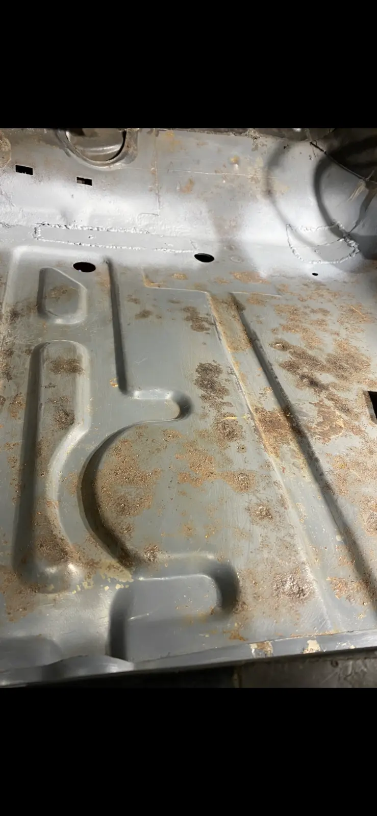

Just from replacing my floor pan, every side was a lap joint. Some offset ones as well in other key visible areas.
It’s a floor pan, a lap joint won’t hurt. It’ll be seam sealed on both sides (I assume).
Unless your building a concours correct car, even then, lots of factory lap joints to copy.
