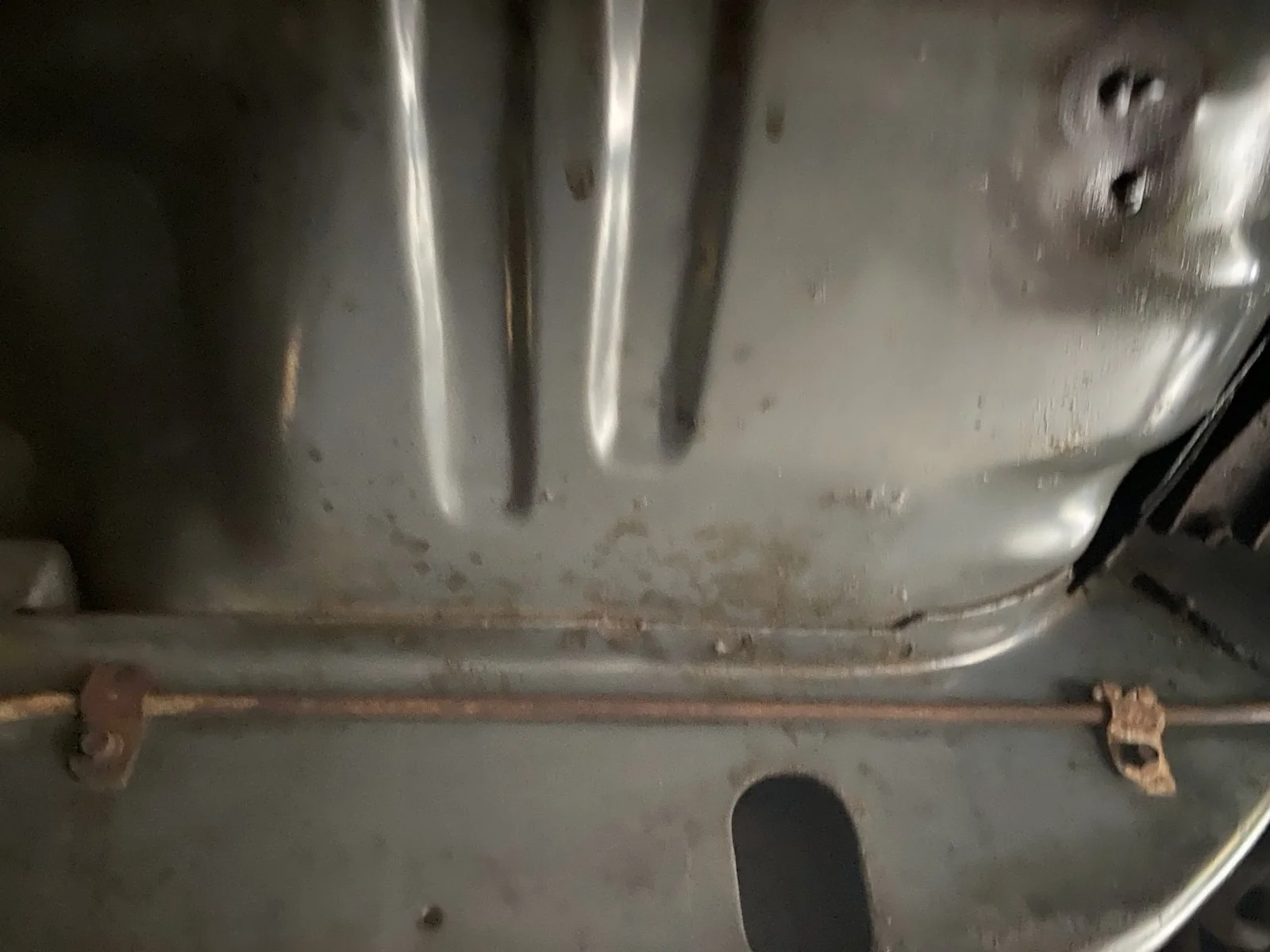

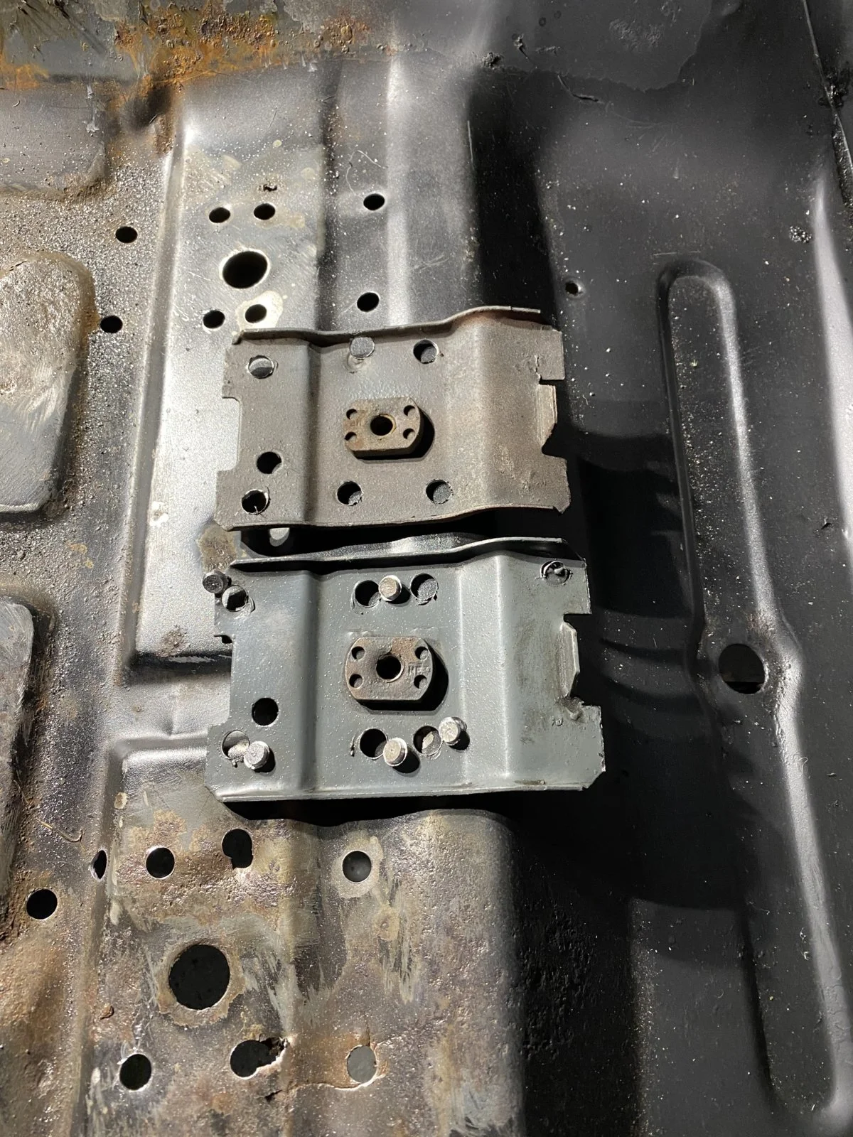

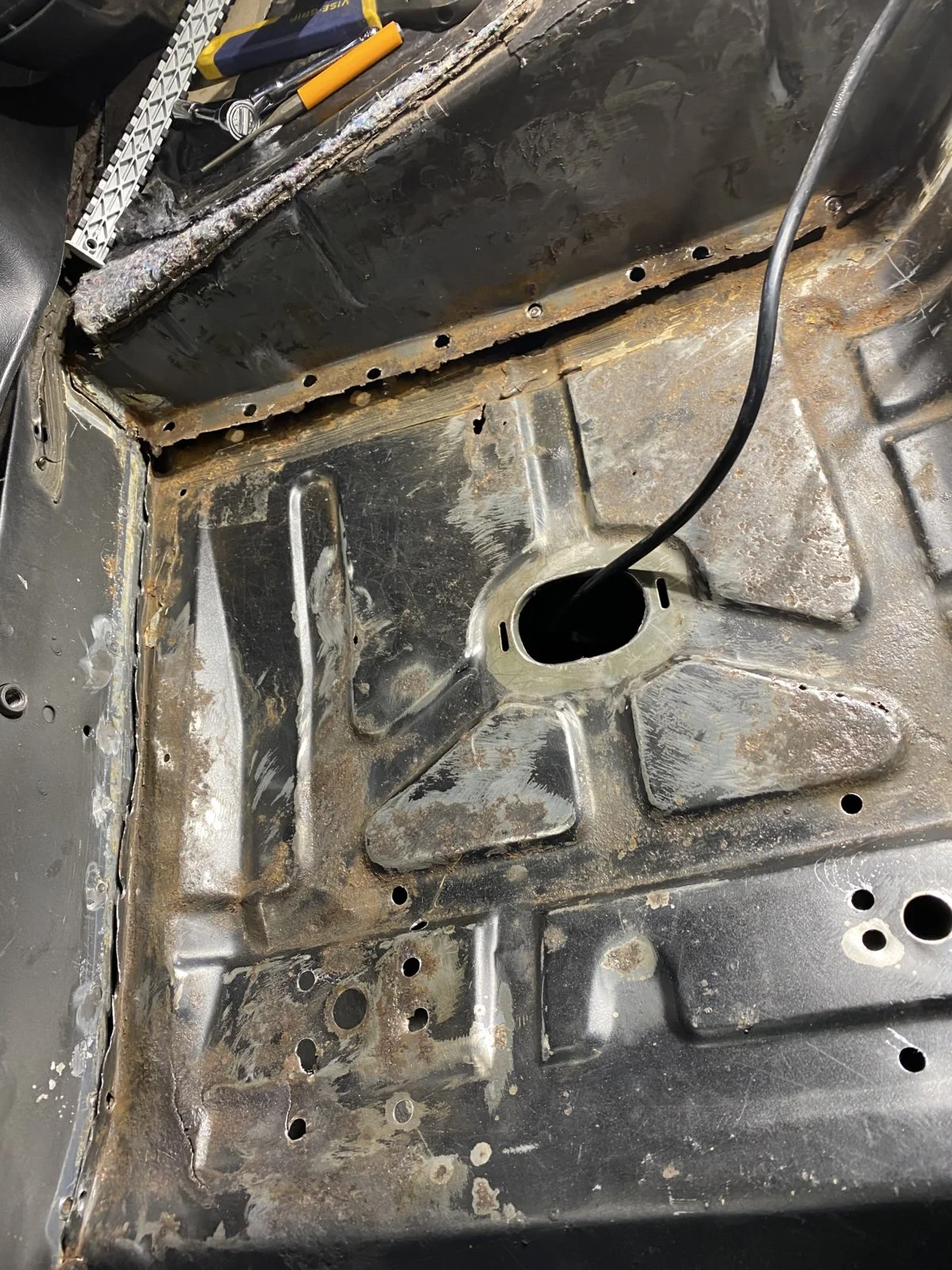

So after a lot of back and forth..... I’ve decided I’m just going to cut out the whole rear section of passenger side floor pan as well. From underneath, I thought I could get away with some small patches. Once I got all the sound deadener off, and saw how much really needs to be repaired, cutting it all out is the only way to go. I’m fairly happy with the driver side as my first go at this, so I figure this one can only come out a little better.
On top of all the holes, that section where it meets the rear seat support at the 90 degree has seen better days for sure!

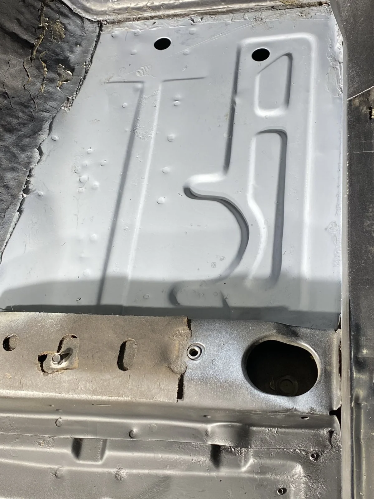

And I figured while I was here, I may as well rip up the sound deadener for the passenger front and be absolutely sure I was ok there. All was good. Scuffed it up and primed for now. It’ll get POR15 once I’m done with the rear section.

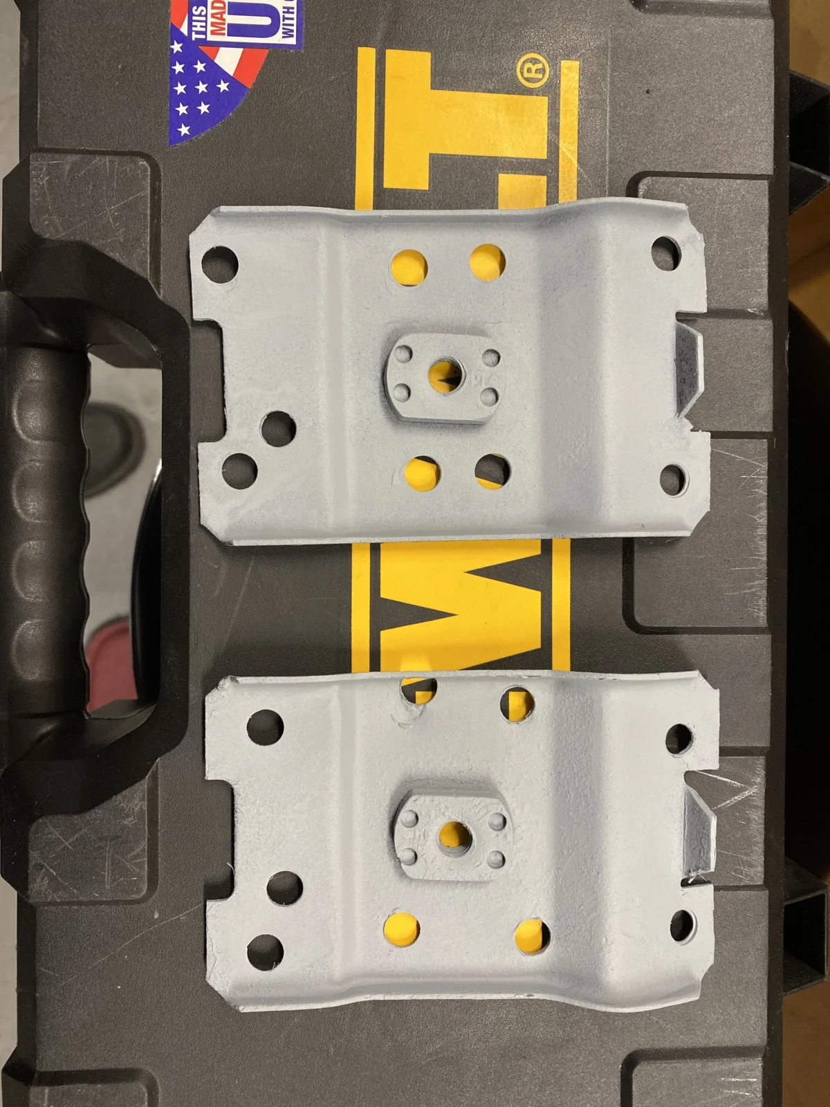

Anyway - I got the brackets cleaned up and primed with weld-thru, and I got all my spot welds drilled. I may have to fab up a new “L” piece at the rear like I did on the other side. Not much good metal left there.

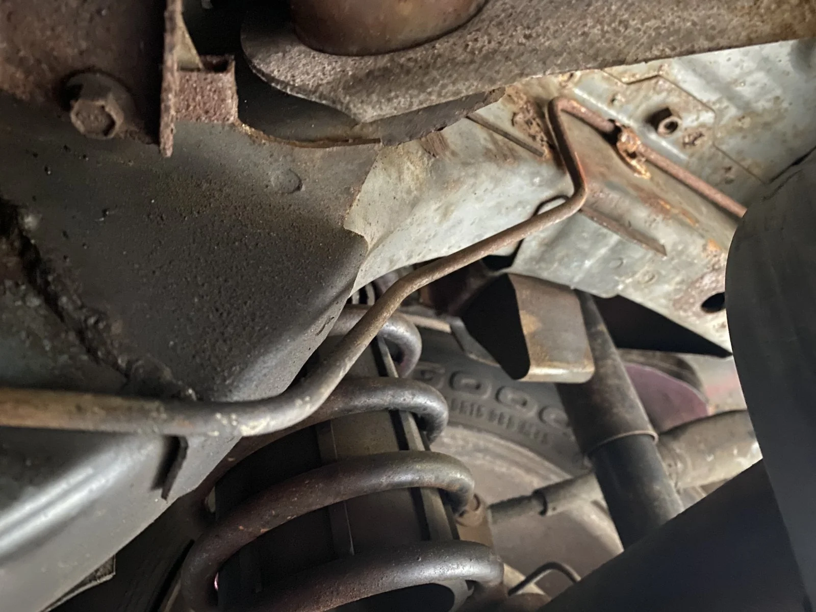

I’m off Friday, so I’m hoping to drop the tank and get the fuel lines removed.
Then I can go to town with the welder on the floor and subframes.

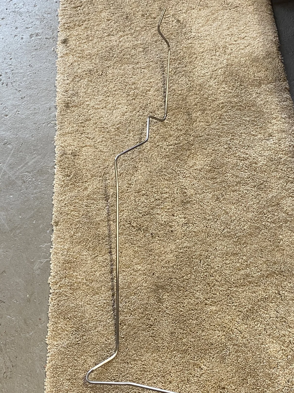

Deciding whether to use the $30 off $300 coupon on the stainless fuel lines for when I reassemble.:thinking:

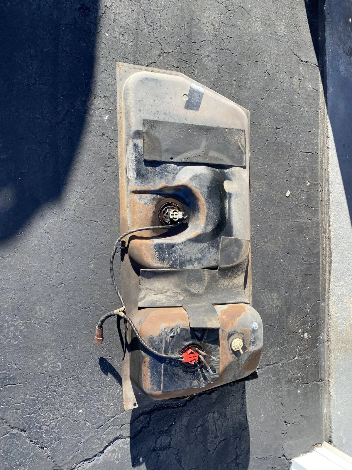

Got tank out with no issues. Got it emptied and a quick clean up.

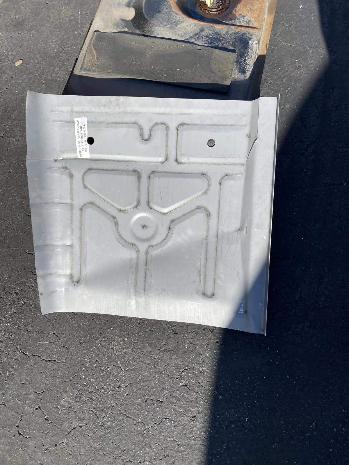

Also got my delivery on the floor pan.
It has two small cuts on either side..... I guess to allow for movement???? Not crazy about that. And although not “factory”, I like that they have that big hole closed in!

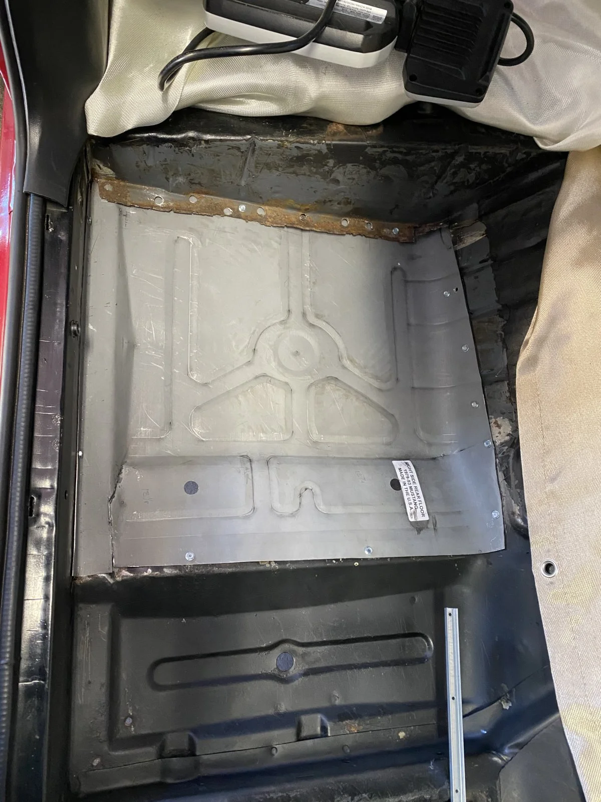

Got the new section fit in with sheet metal screws this morning before work. I’ll mark it for my final cut, as well as cut that rusted section off in the back. Need to get to store for some metal so I can redo that piece. Little at a time. Work really gets in the way of having fun!!!
And just a note on this Classic to Current panel I bought. All they do is bead roll the raised sections. It took a lot of extra bending and fitting to get it where my seat brackets sit flush with the pan. In hindsite, I would have bought the whole side and cut it where I needed it. The piece I got for the other side from the Mustangs Unlimited sale was much better fitment.

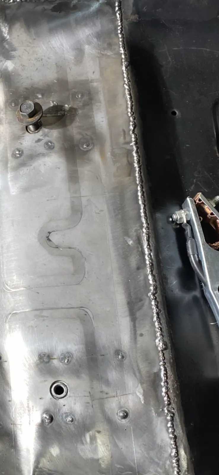

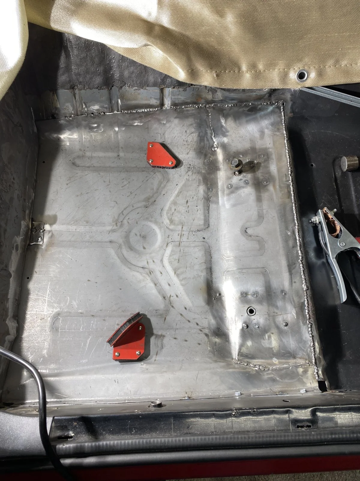

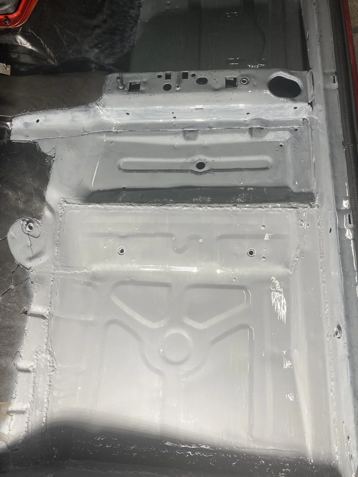

More progress on the floor today. Not completely done, but I got a good bit welded in, and I’m much happier with my welding on this second piece of the floor. I still burned through a few spots, but only because of my impatience to do “one more spot” as I was stitching in the welds.
The trans tunnel toward the back was burning through quick too. Not sure if it is much thinner there, but what worked on my front seam, was way too hot for that. I’ll have to find a helper to hold my copper paddle to fill those in, as well as this floor pan not having those grooves the original does. That will be a challenge to get solid, but I’ll figure it out.

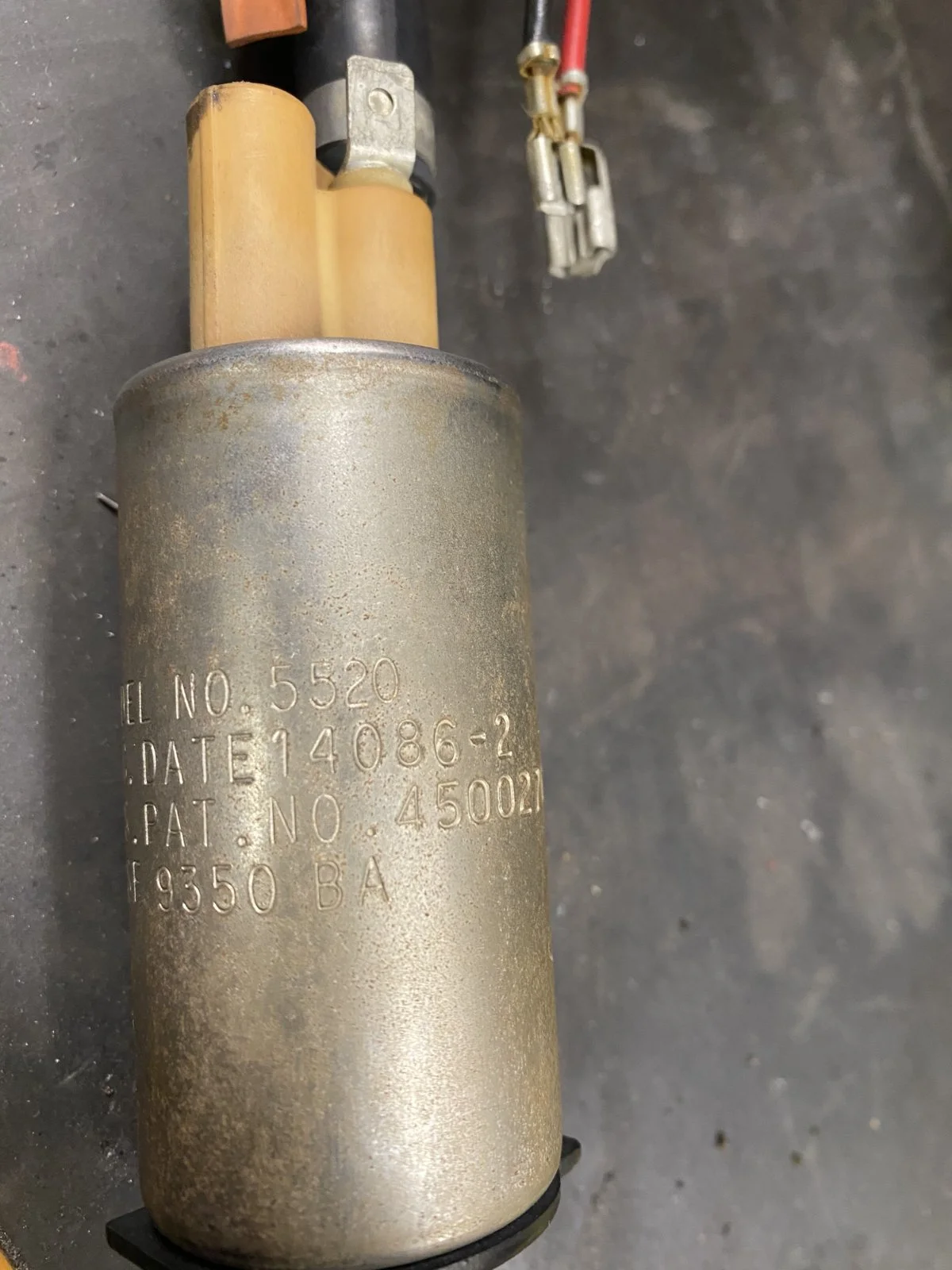

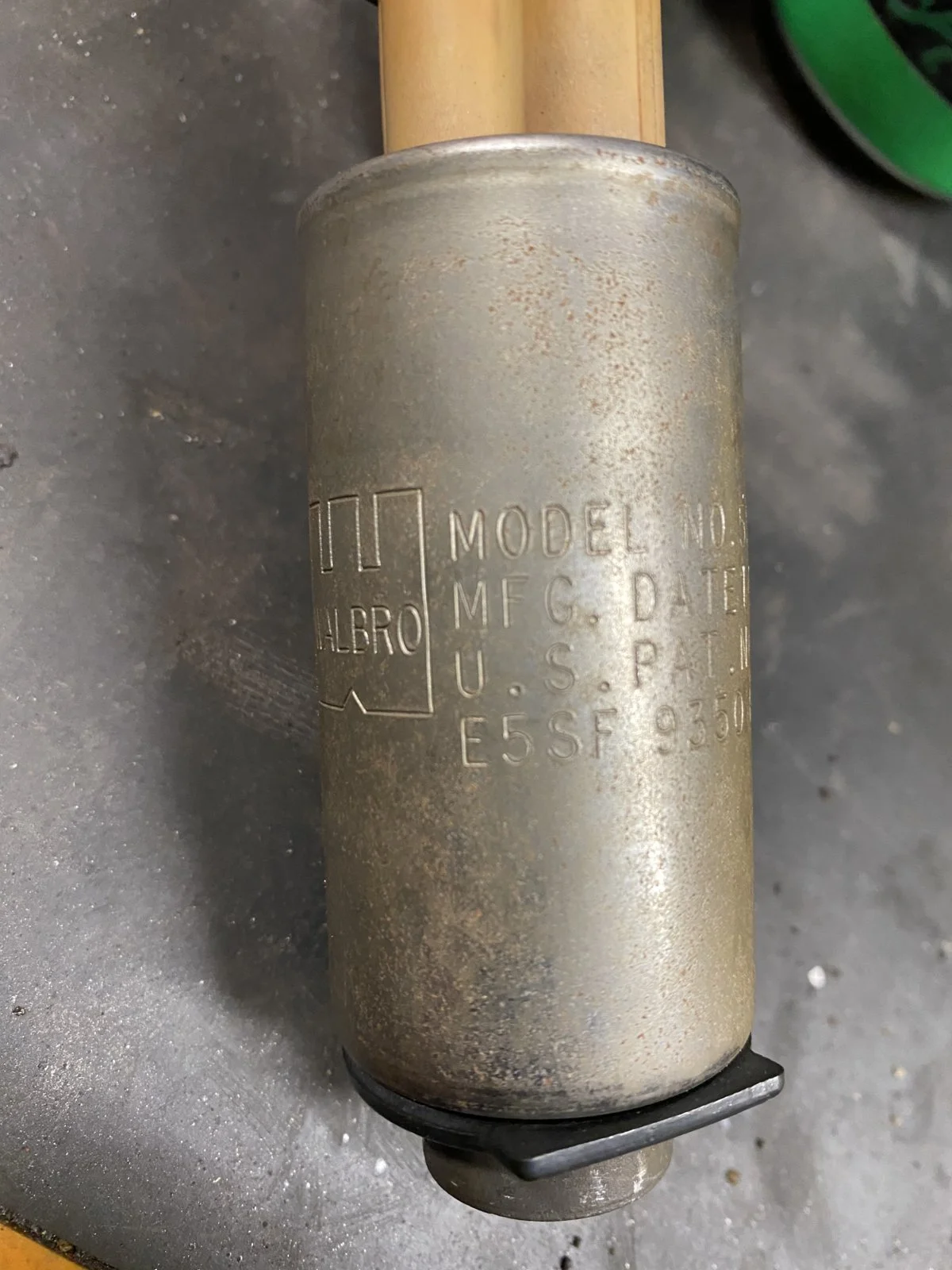

Started messing with the fuel pump and bracket as I was sitting at the work bench. Took it out of the tank, and pretty sure this is an original. Mfg date ends in 86, and from what I can tell, model 5520 is an original pump for these cars. I guess it’s time to change it out!!
