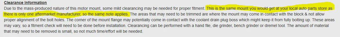

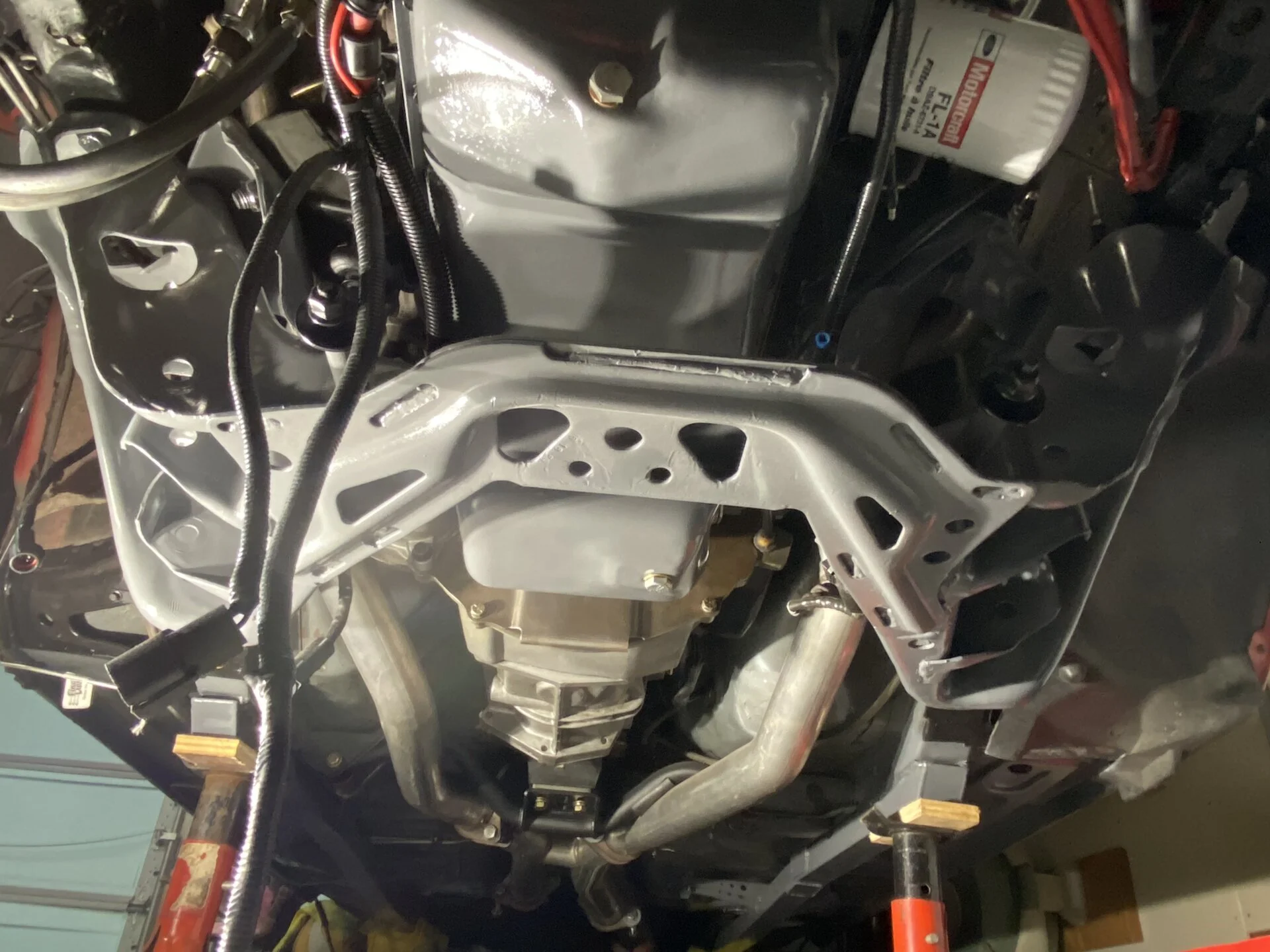

Has anyone used the LMR Convertible ones? These mounts are desirable due to lowering the engine 1/2" over the standard ones.
I was actually looking those until I started hearing about all the fitment issues. I’m interested to hear if anyone used this exact pair.
If I go with the poly, I guess I’ll have to go back to a rubber trans mount.
........ or I could just throw these old ones back on until I pull the motor (probably a winter 2022 project)

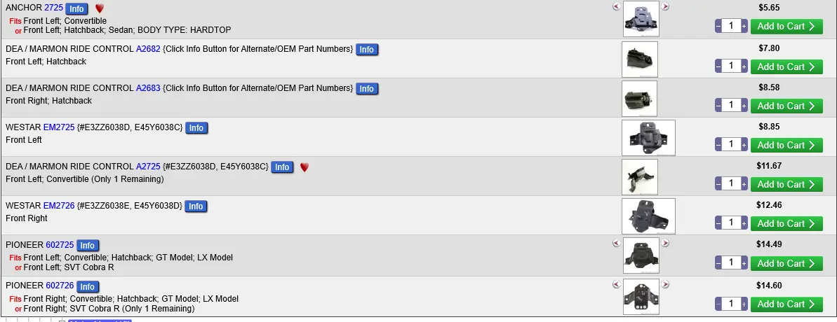

The LMR ones are the same as what you would get at the parts store. A lot of what LMR sells that isn't branded is repackaged parts store parts. Water pumps, power steering pumps, master cylinders, etc. All stuff you can get at Napa for cheaper.
I've had the Anchor mounts, and the Pioneer mounts in my hand and they are the same. The bolt holes don't line up. LMR sells a lot of repackaged Pioneer brand parts from what I've found. (Their speedo cable is one example)
Even LMR admits they are all from one source.
Just save your money and buy the $6 anchor mounts vs the $60 LMR stuff. It's gonna fit the same

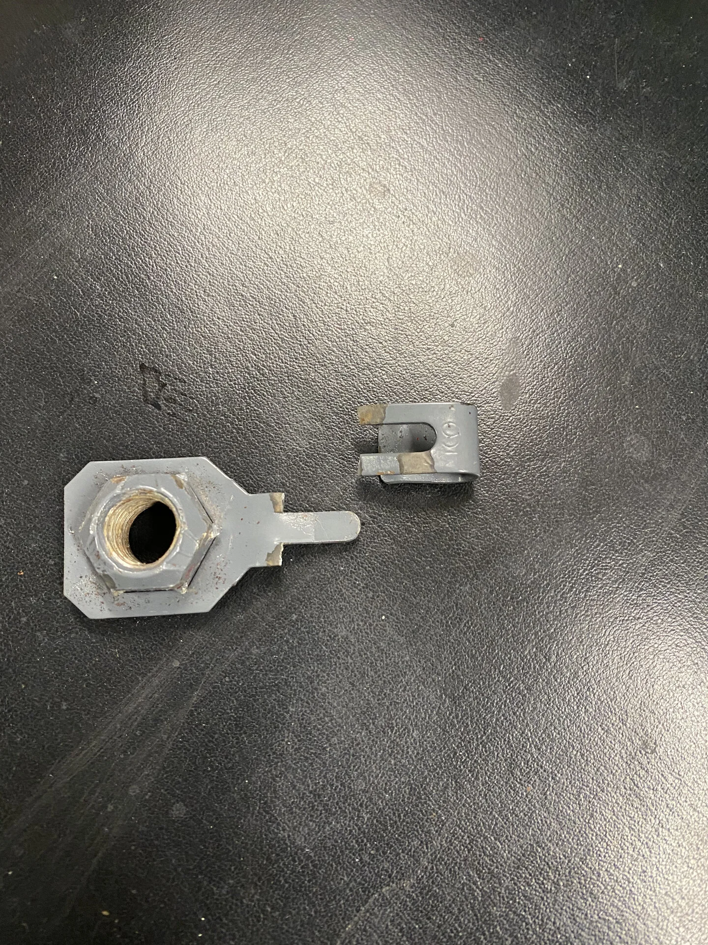

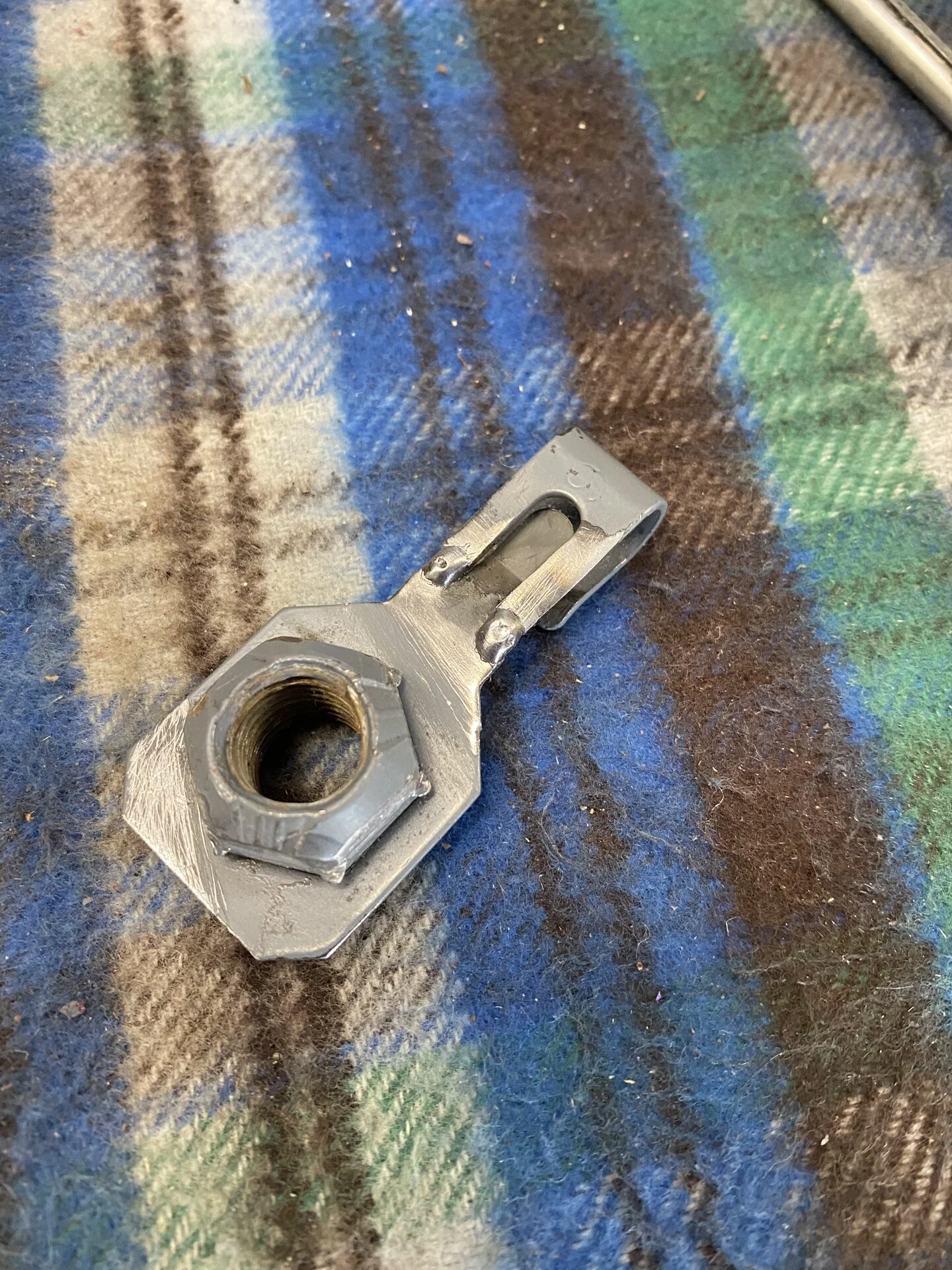

In the meantime, I remembered I had a welder :doh: and I fixed my k member nut/clip that had broken!

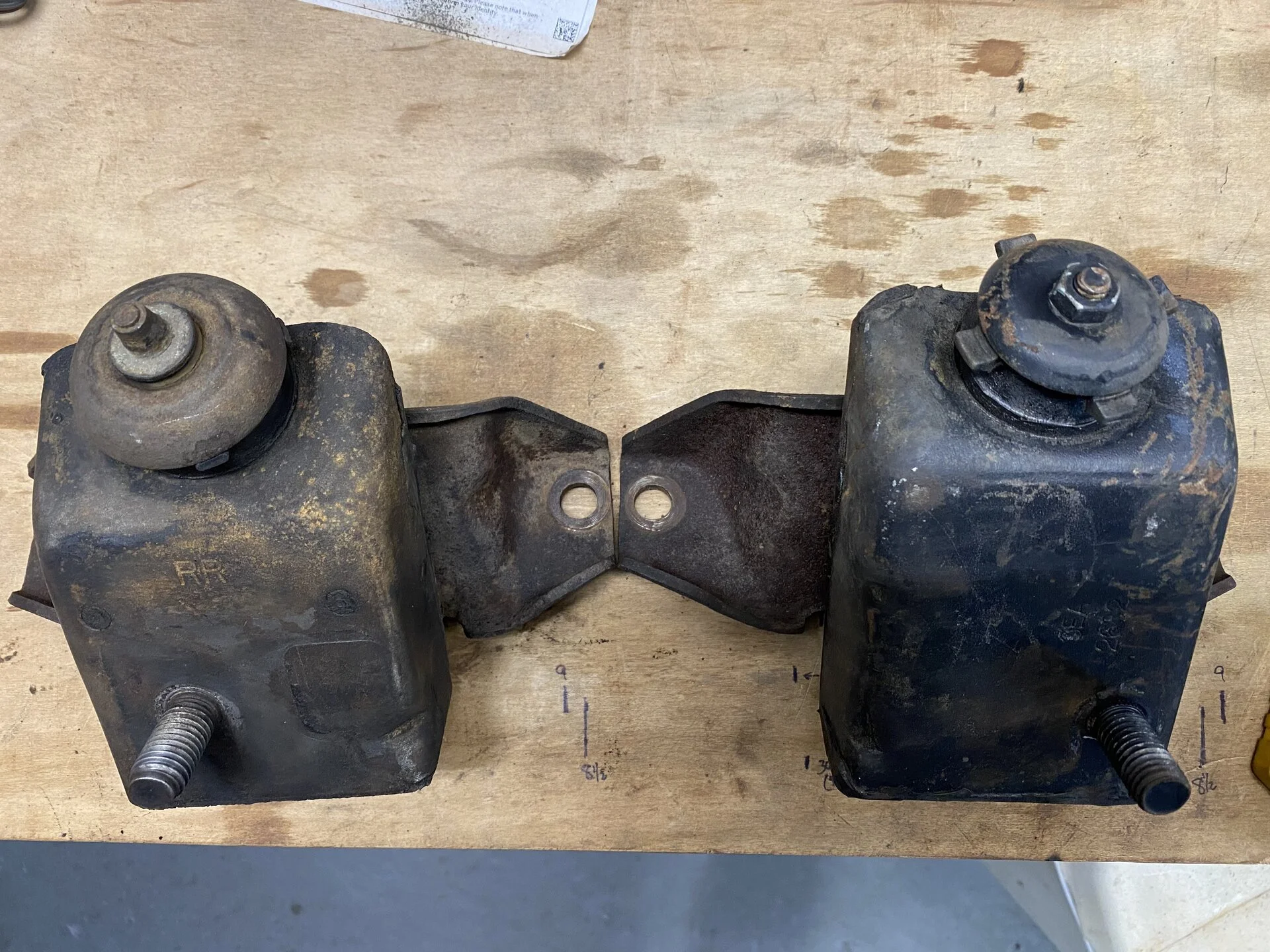

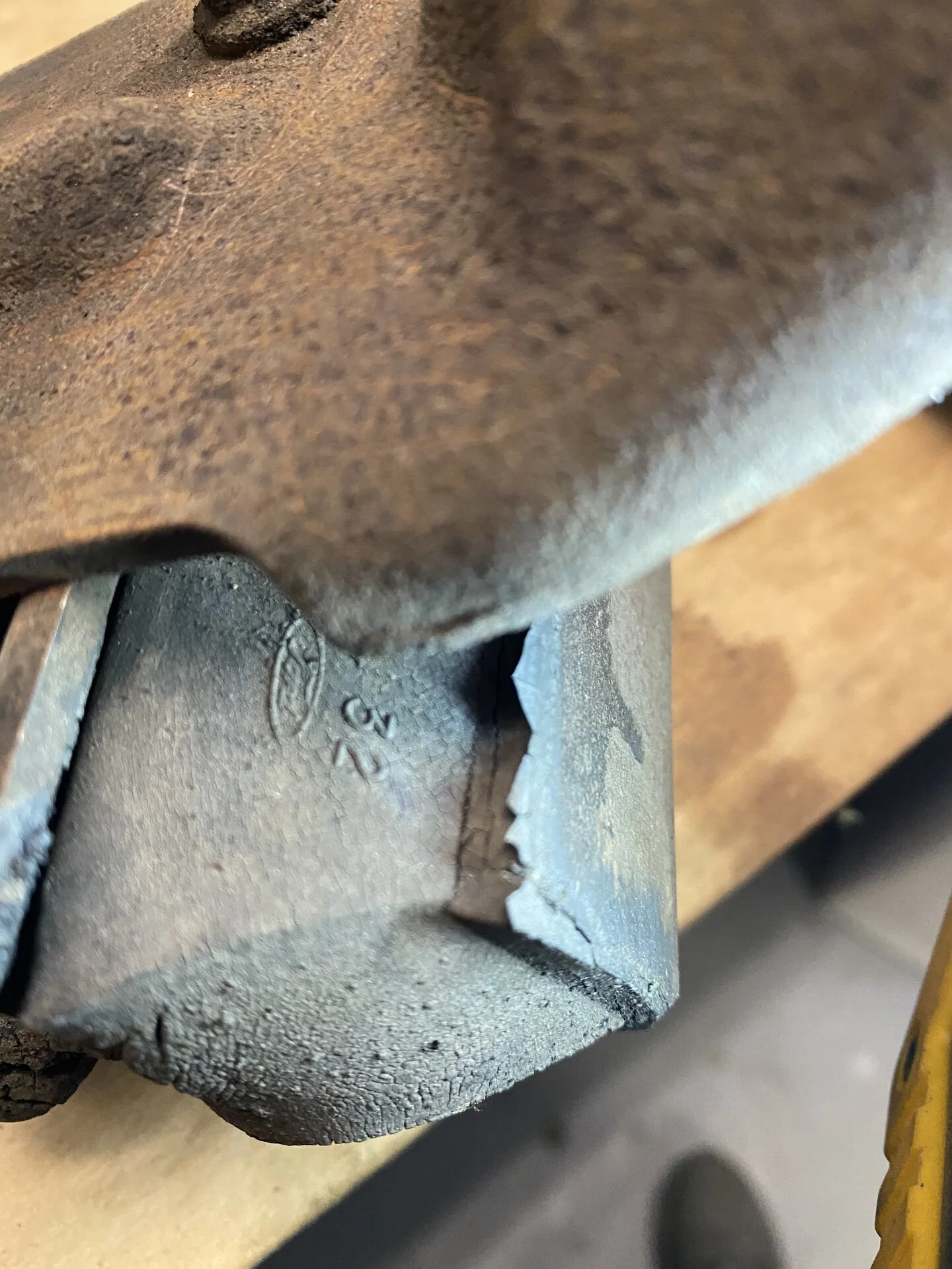

I will say this...... the one on the left in the pic is a Ford part, and the other had been changed at some point to who knows what brand.
The Ford one is noticeably heavier than the other.

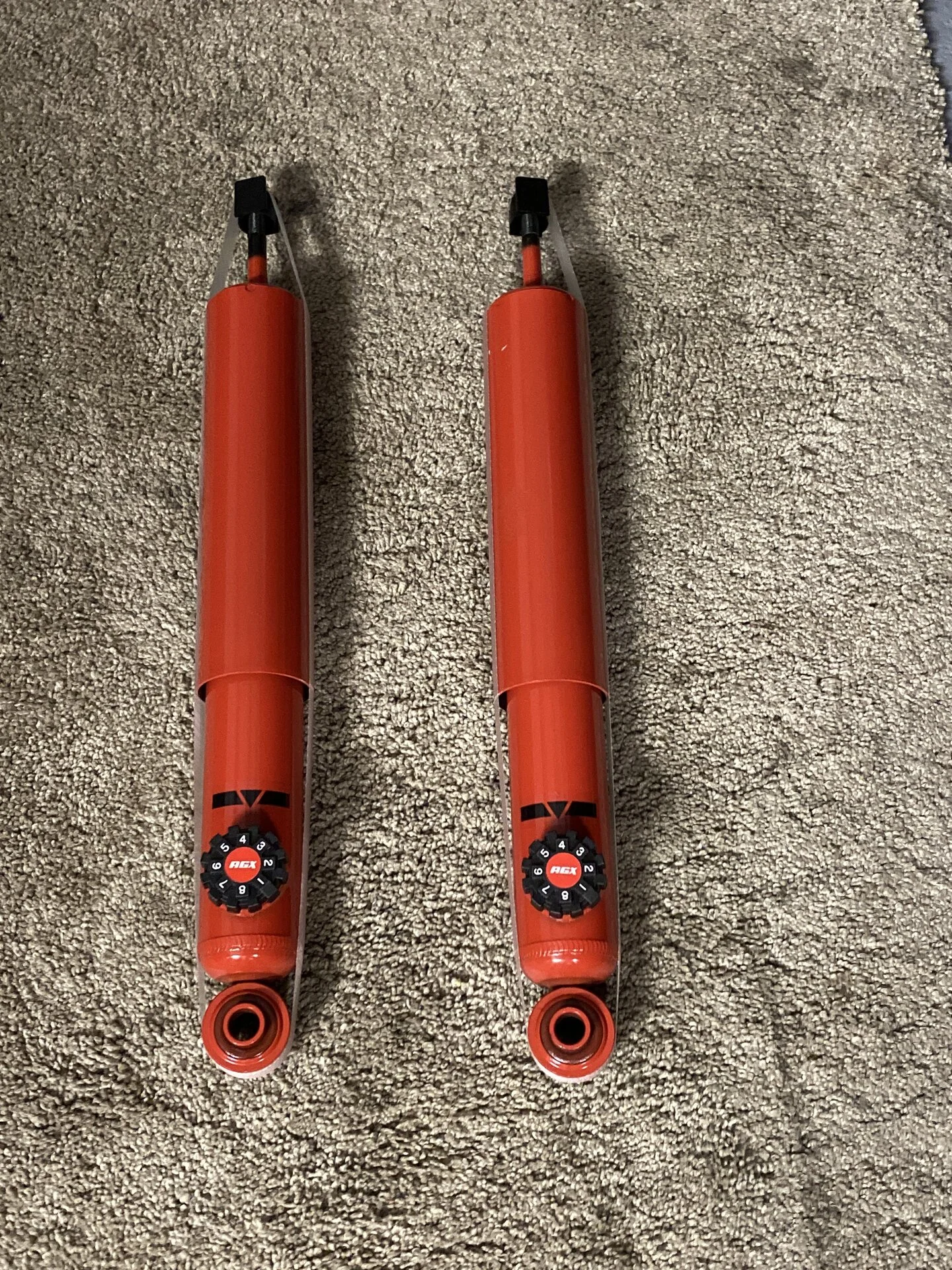

Got an email yesterday that RockAuto got the AGX shocks back in stock. Placed the order before they went out of stock again, and they were here today.
One step closer to completing the parts shopping list!

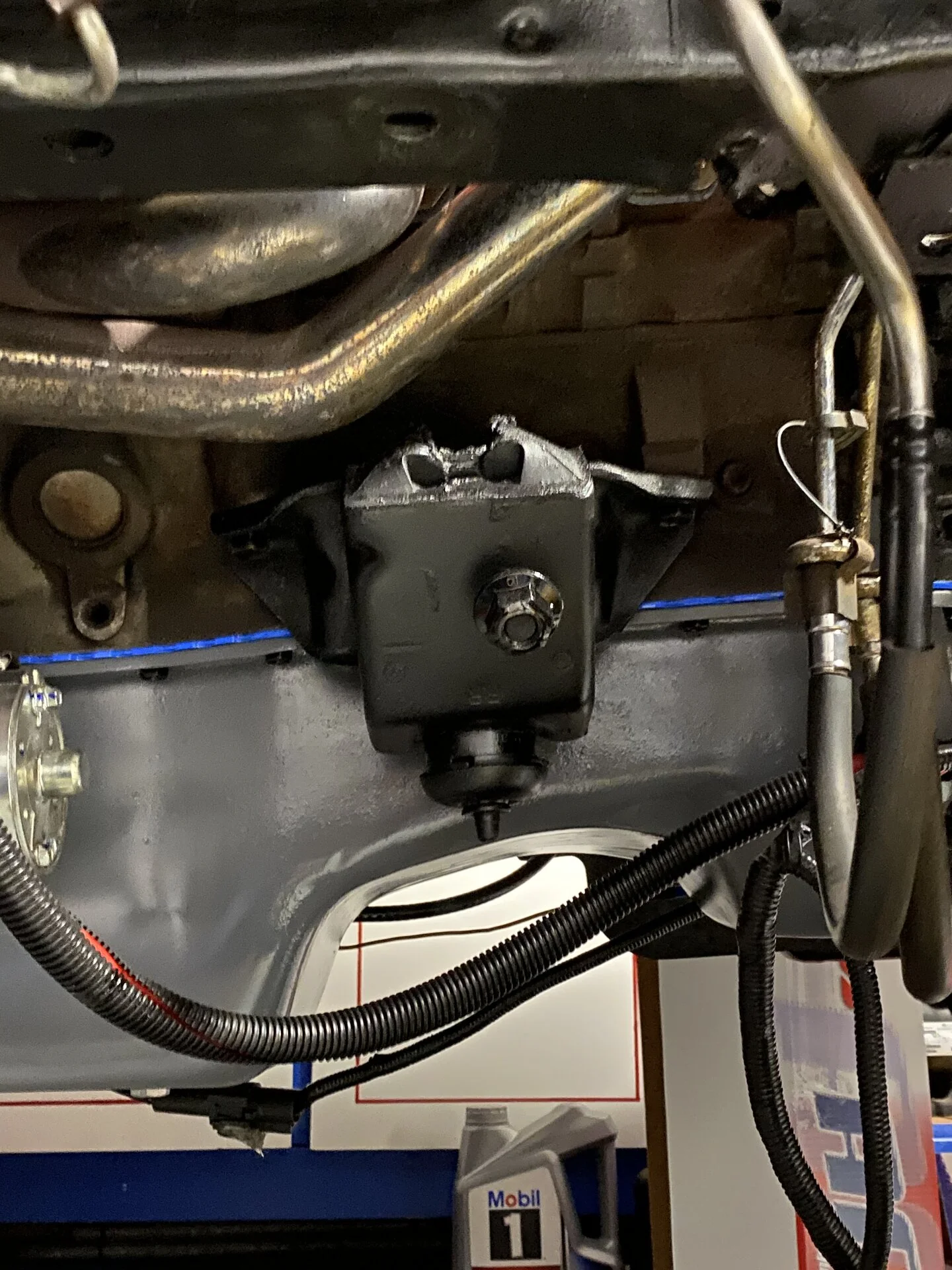

And as far as my motor mounts...... I cleaned and painted the old ones, and I’m sending them right back into service. I’ll redo all that when I pull the motor.

After all the hard work (and great!) work you’ve done I’m surprised you’re not replacing those motor mounts.
I use the agx shocks/struts as well. They seem to work well!
