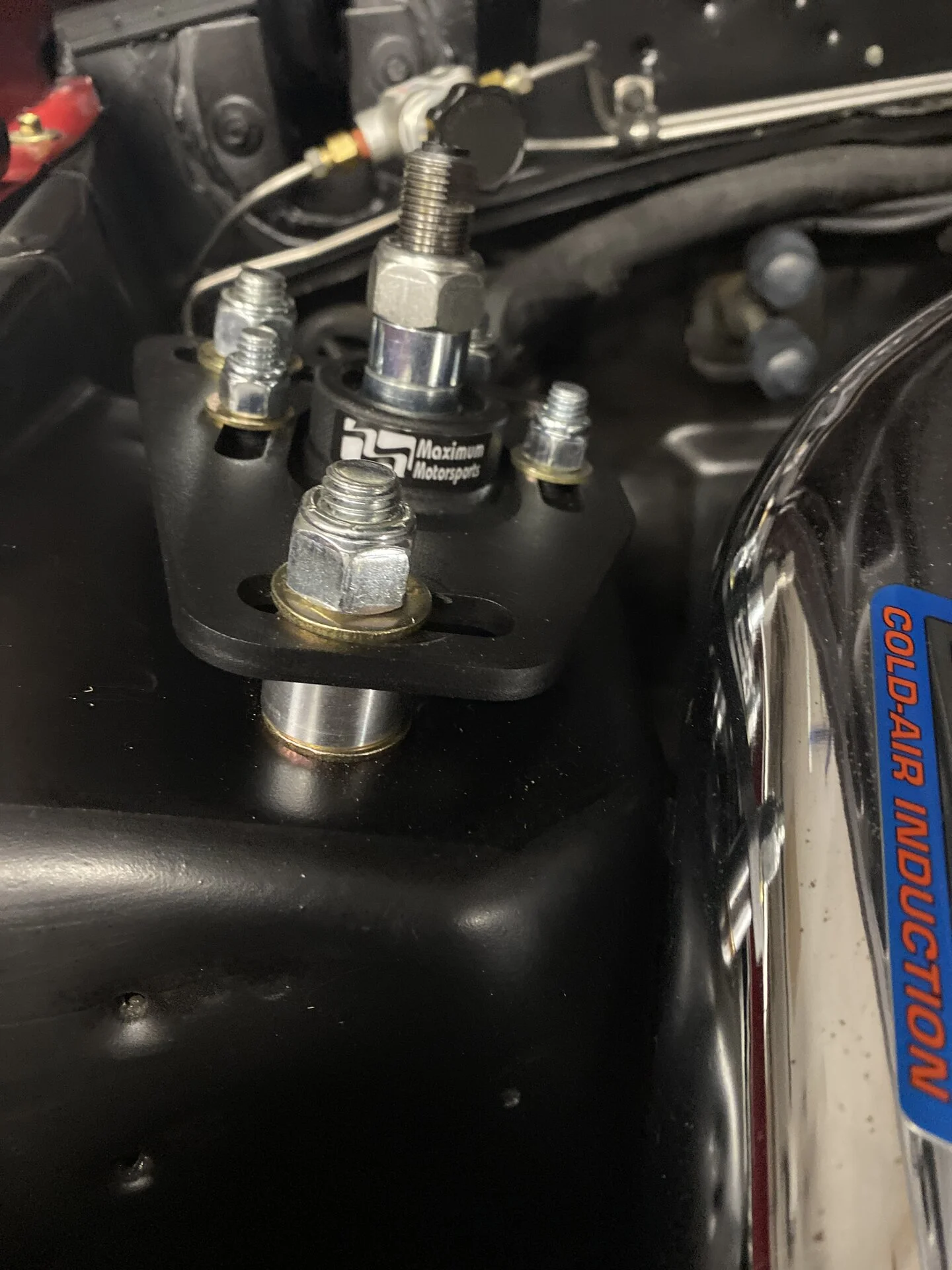

I'd rearrange the spacers and look and see what happened. With the nuts tight it should've pulled the strut all the way up. The strut rod is thicker than the threaded end so the spacers should've sat all the way down on that shoulder. There'd be no way for the strut to come through further. The threaded portion of the strut could damage the hood if they are too long.
That’s the funny part. The top of the strut seems to be at the same height as it was before, just below the hood line. Tough to see in this pic.... but all was good when I first installed.
I knew I’d have some hiccups with so many things changed at once, but I was surprised to see this.
Edit:
Although..... I guess as I think about it, it had to have moved up that 3/4”...... but the hood does still close without issue.

I would be VERY careful even shutting the hood for the night. Grab some silly putty or modeling clay first, or just stay up late and do what 90sickfox says.

Here’s where I’m at leaving the spacers where they are, and the hood closes fine.
But...... I have not had an alignment yet, and that could change where the top of the strut hits.
Doesn’t rearranging the spacers change the strut travel? Wouldn’t putting more spacers underneath hinder the amount of travel?

I think I may move the small spacer underneath. That will be one large and two small on the underside, with one large up top.
It will allow for hood clearance once aligned, and not limit strut travel too much.

I’d put the entire strut shaft under the c c plate, and only have enough sticking through on top to get the nut fastened…if it was me.

I know the instructions say to toss one .48" and .24" under the spherical bearing and then one of each on top as well but perhaps the manufacture of your struts has more thread portion than other brands thus requiring that .24" on top to be moved to underneath the spherical bearing? Instructions do say you need at a minimal of one spacer on top of the bearing for proper movement. If it were me, I would yank one and stack one .48 and two .24 on the strut shaft, install it into the car and jack up the control arm so the strut shaft is thru the bearing fully and install the single .48 spacer on top and see where your at.

I put all spacers underneath except for one small .24 up top. It lowered the top of the strut enough, so no matter where the strut ends up after proper alignment, it will not effect hood closure!
