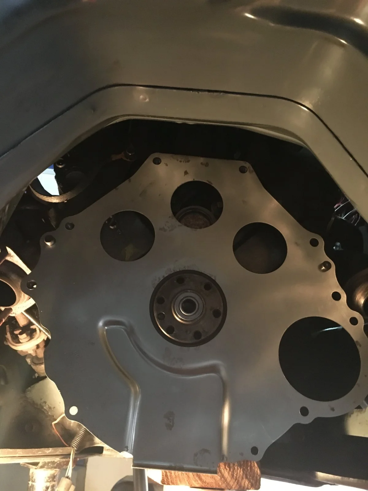

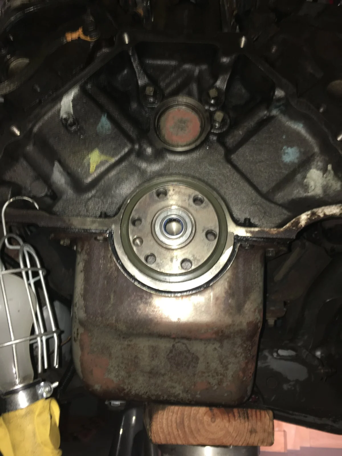

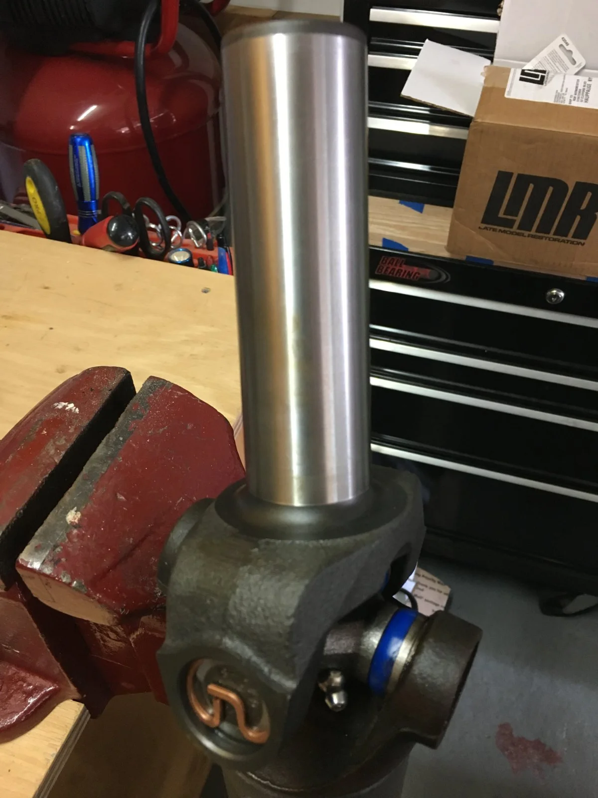

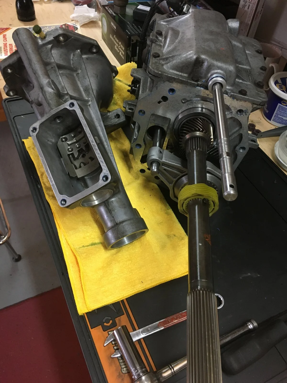

I decided to do the bushing. I was able to get a newer driveshaft from a buddy’s car (he went to aluminum), and I had new ujoints and yoke put on that. Hopefully that all solves my tranny leak.

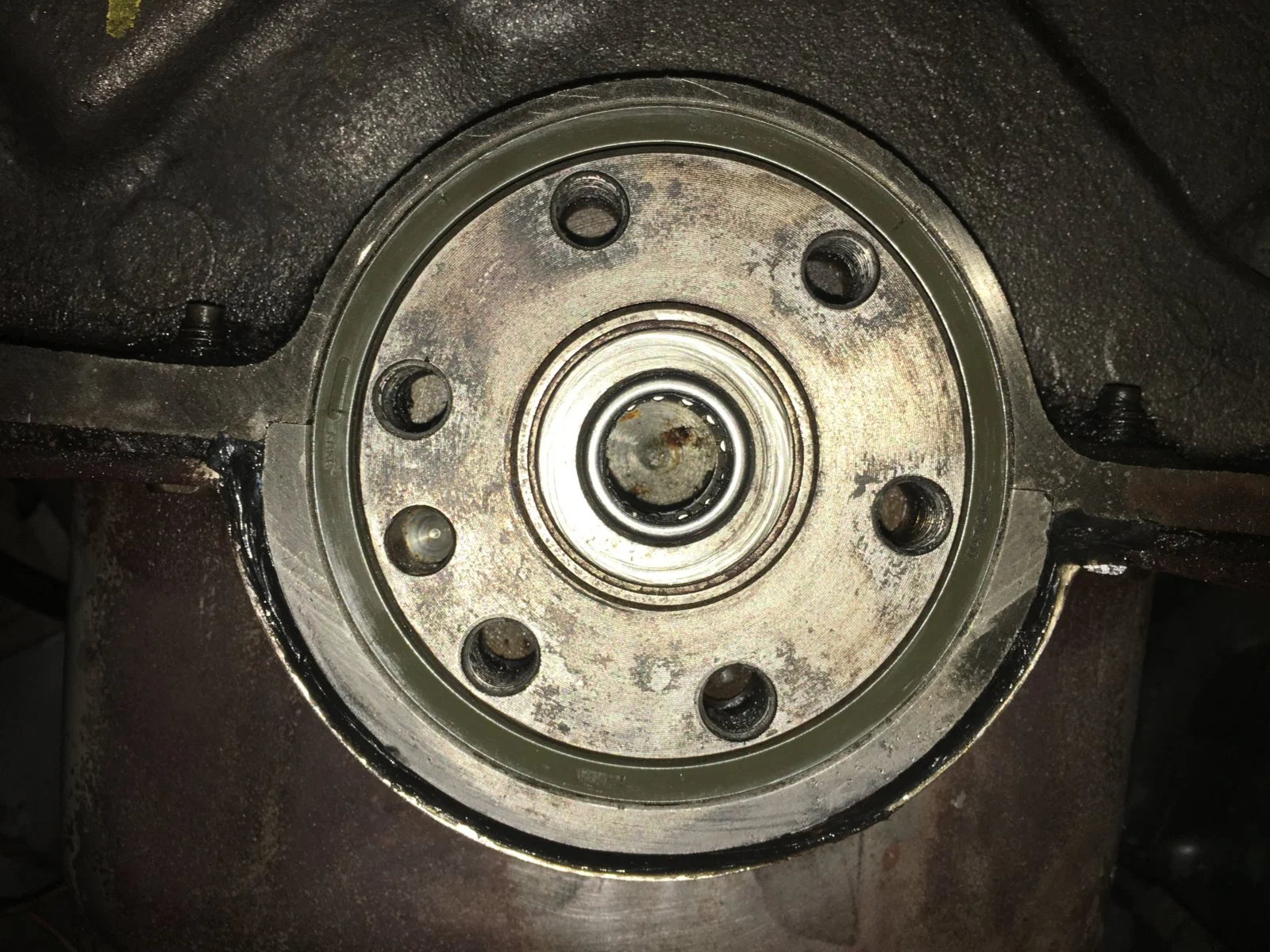

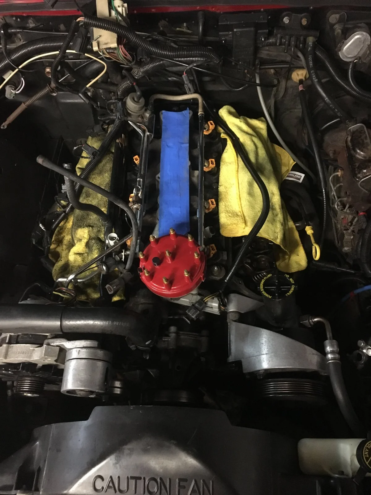

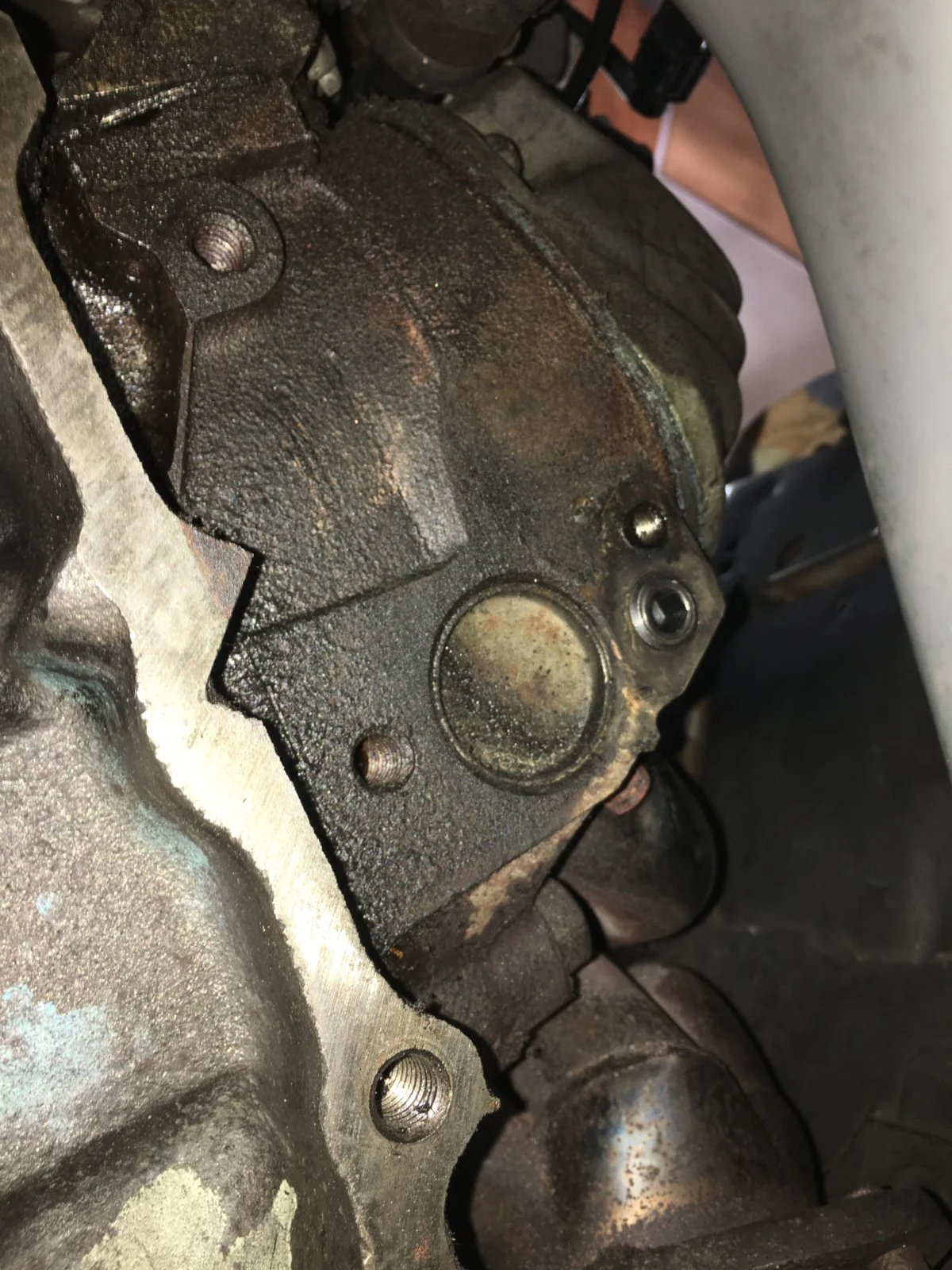

I got everything off down to the crank, and now I’m wondering if it was my rear main leaking at all. The P.O. has put black RTV on the oil pan under the bearing, and after a few days, I’ve noticed a small amount of oil from the pan gasket. The rear main is still completely dry. Just wondering if you guys can see anything from the pic. To me, the rear main looks ok, and has definitely been changed already (its National brand), and looks higher quality than the one I just got from LMR.
I also replaced the pcv valve, completely took the screen apart and cleaned that, which was pretty gummed up. Maybe pressure was getting too high causing leaks?
I guess my question is would you do the seal, or wait and see. I’ve heard too many stories of them leaking again right after replacement, I’m leaning toward hoping it was the pan and the pressure. I did get quite a few turns on the pan bolts too when making sure they were tight. Thanks guys!

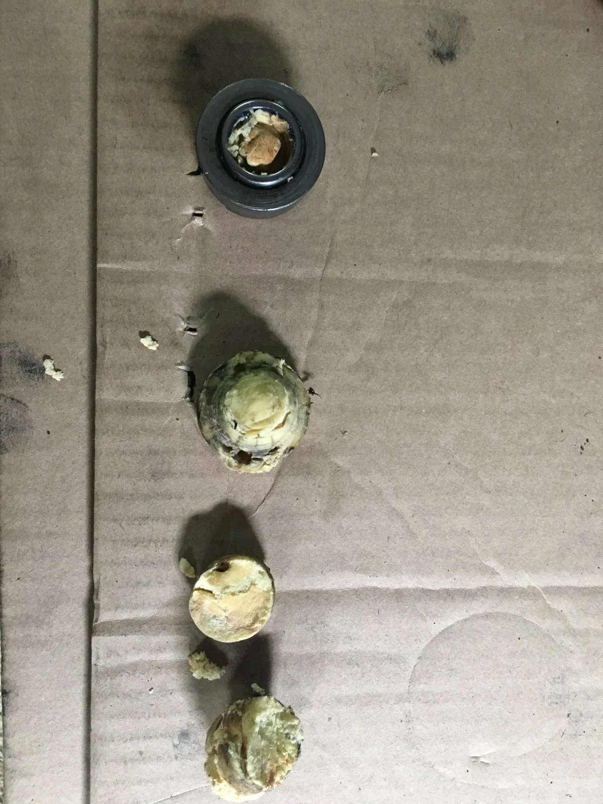

Ps. Anyone deleting the smog, don’t waste your time with the overpriced thermactor plugs. With the access I had with everything apart, a little in and out with a 5/8 bolt cleaned the threads, and these Allen head plugs from Ace worked like a charm.

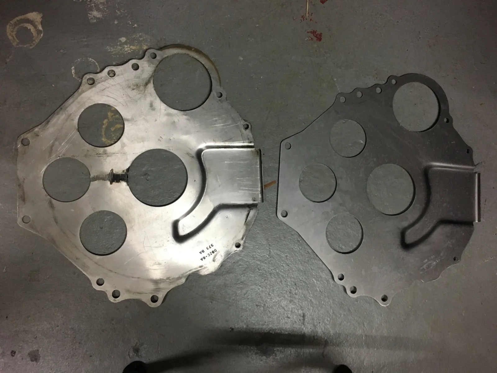

Yeah, I’m leaning toward putting this all back together and see what happens.
I’ve cleaned EVERYTHING under here, so taking it apart again will be a breeze if I have to do it again.
I almost just want to see if the PCV issue and the loose pan bolts make a difference before I mess with the seal.

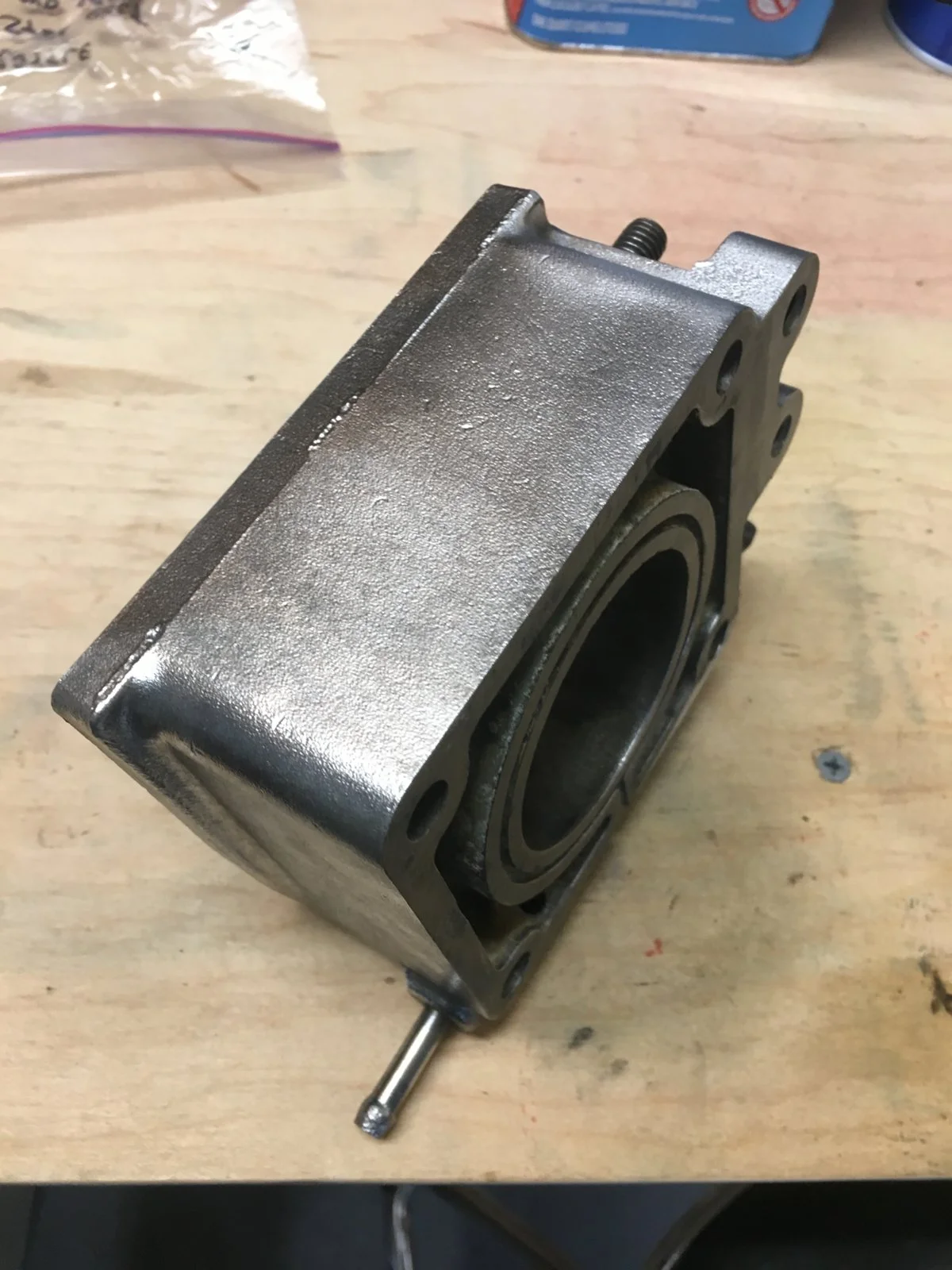

Just got my new spacer plate from UPS today too. The Ford piece on the right weighs almost double the piece of crap that was in there!

Will do. Thx.
When I did my clutch, pressure plate and flywheel I was expecting to replace my rear main, but it looked fine. Maybe that is my culprit.
I did do the PCV and screen while I was in there a while ago, and it definitely seemed to have slowed considerably, but something definitely still dripping slightly.

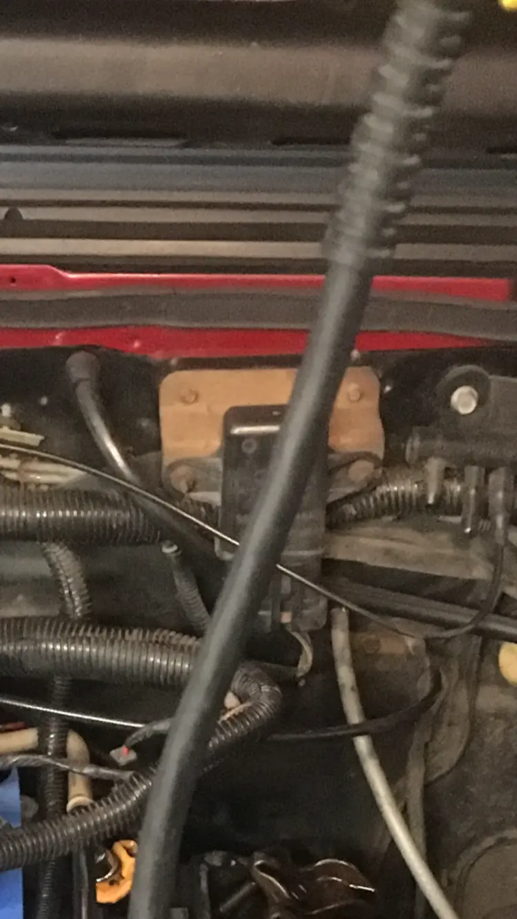

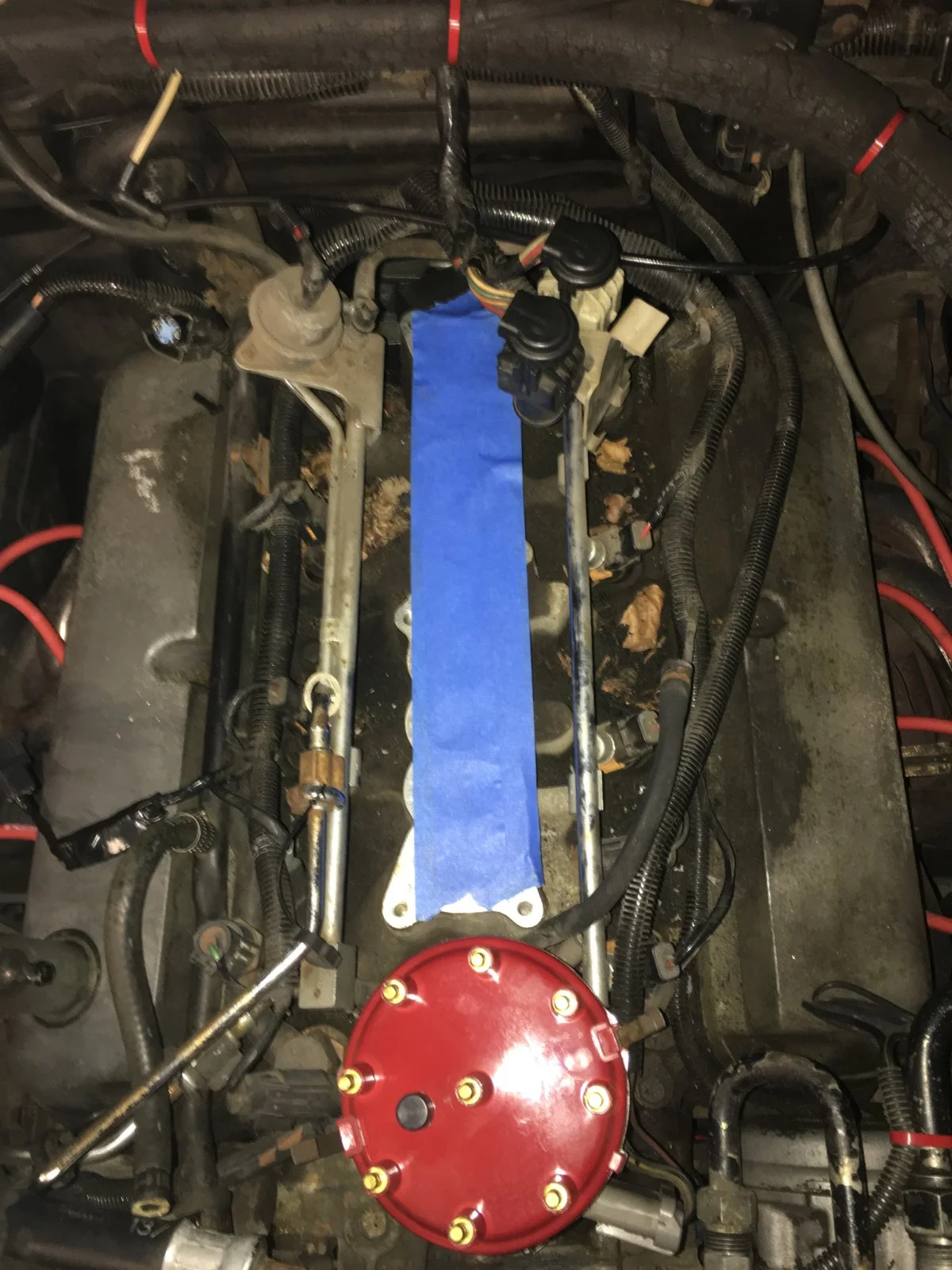

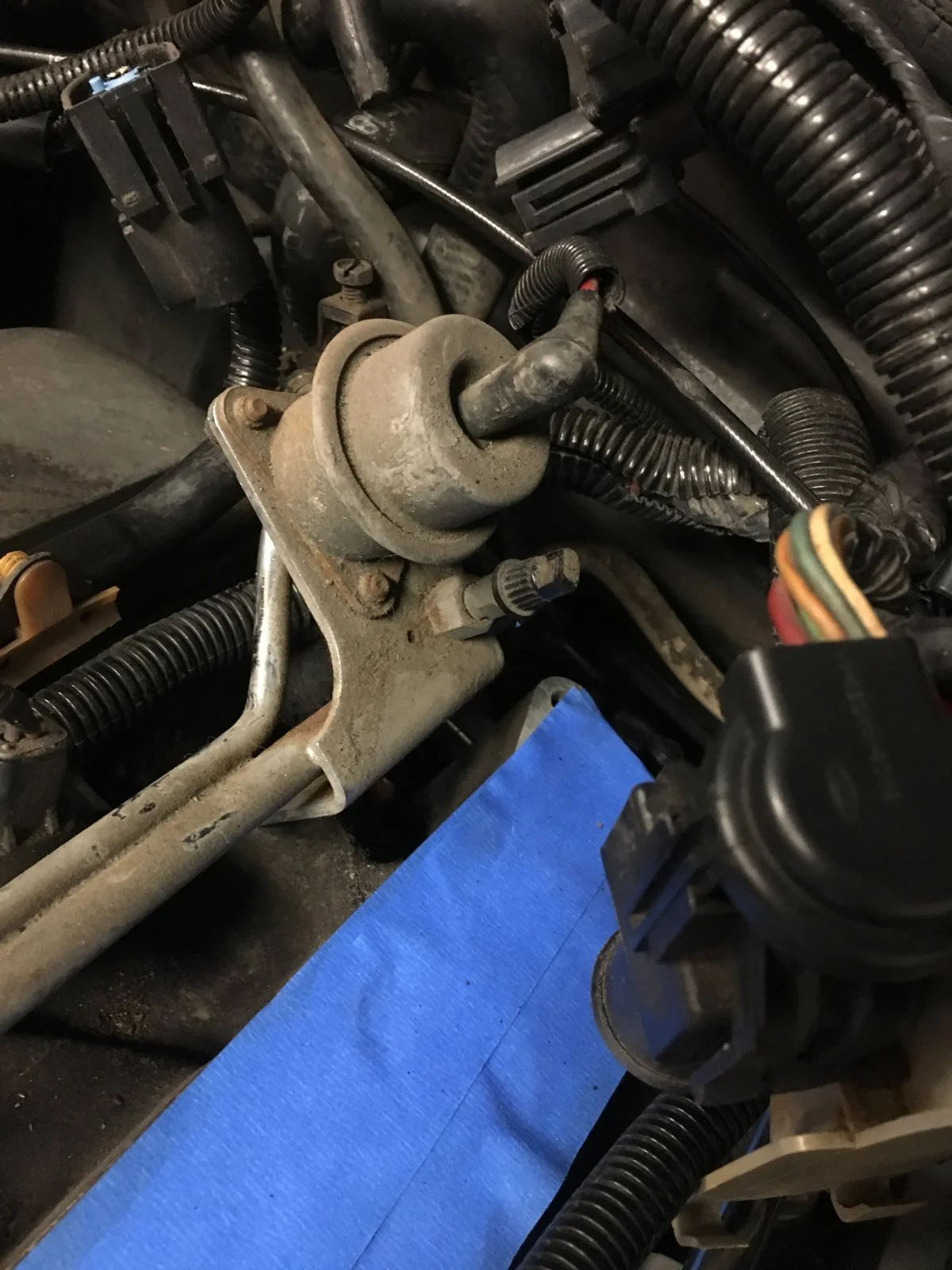

Not one of Ford’s better ideas!! How do they think putting this valve under the upper intake, facing inward, was a good idea.
My old 86 GT that I owned had it right up front near the distributor!

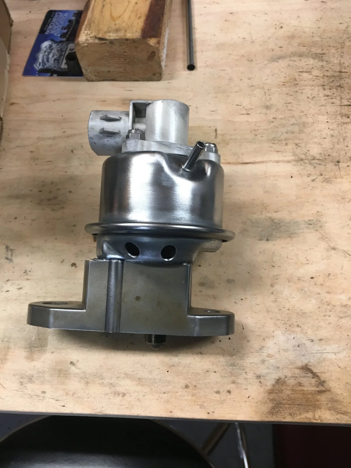

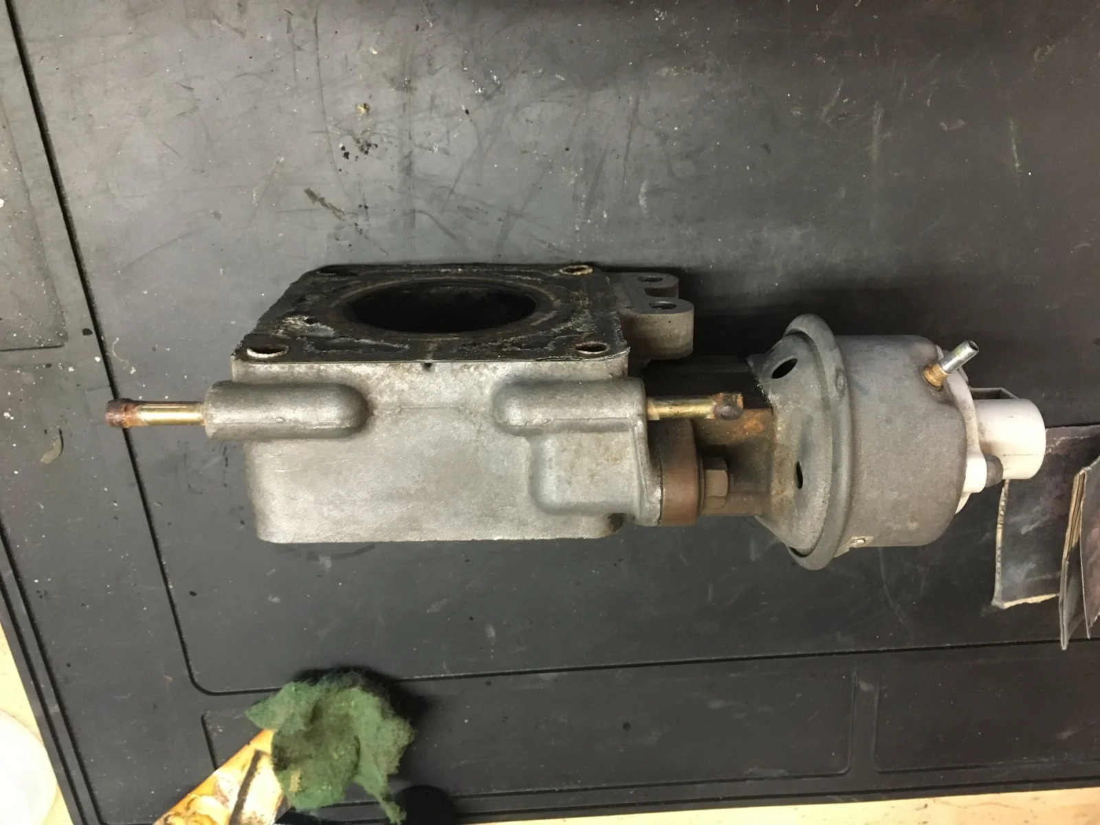

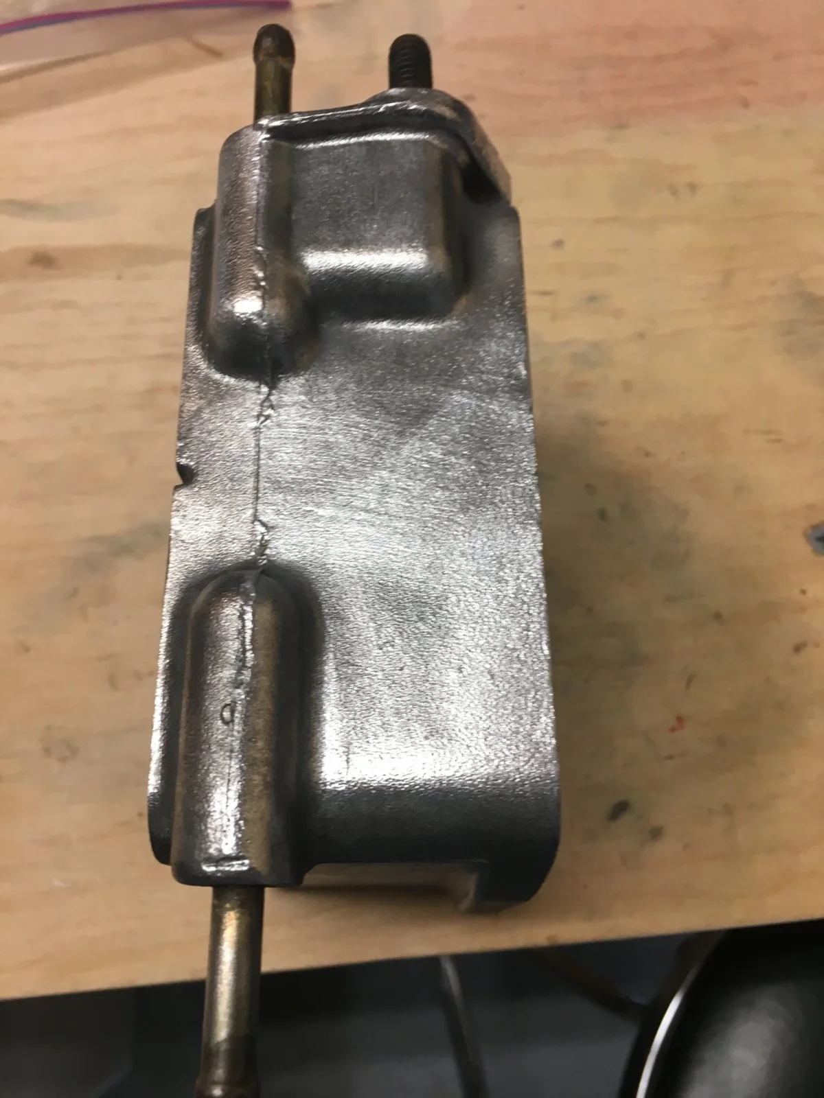

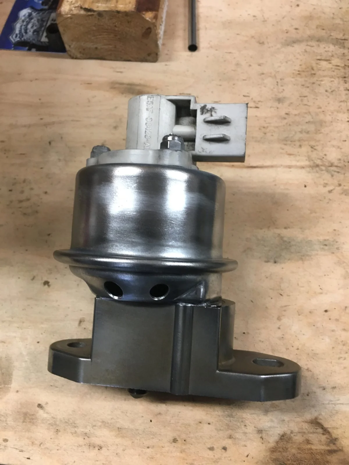

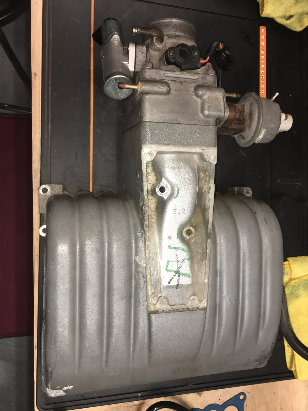

Did some wire wheel work on the EGR and spacer plate this morning.

90sickfox
Wasn't a pretty sight...and I've got big hands
SN Certified Technician
Mar 2, 2015
6,555
5,630
203
45
Hey man...just a quick tip o recently learned.
If you wipe some car wax on the fresh metal it'll keep it from oxidizing and rusting. Ofcourse, painting would be a bit harder. Would need to thoroughly clean and degrease....but if you like the natural look...
Thanks. I do like the natural look, but I am concerned with it being a constant battle to keep it looking good.
Just got some brushes for my Dremel that I’m getting the corners with, then I’ll decide to paint or not.
Reactions: 1 user

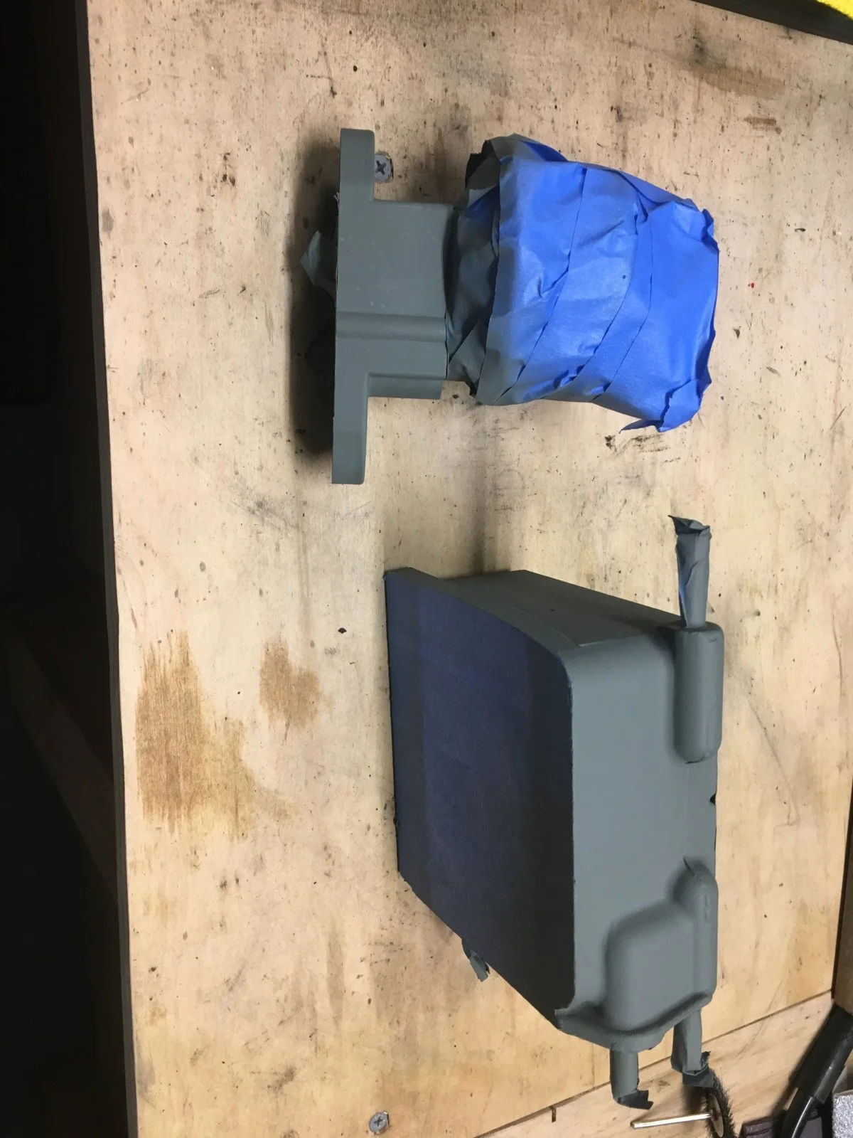

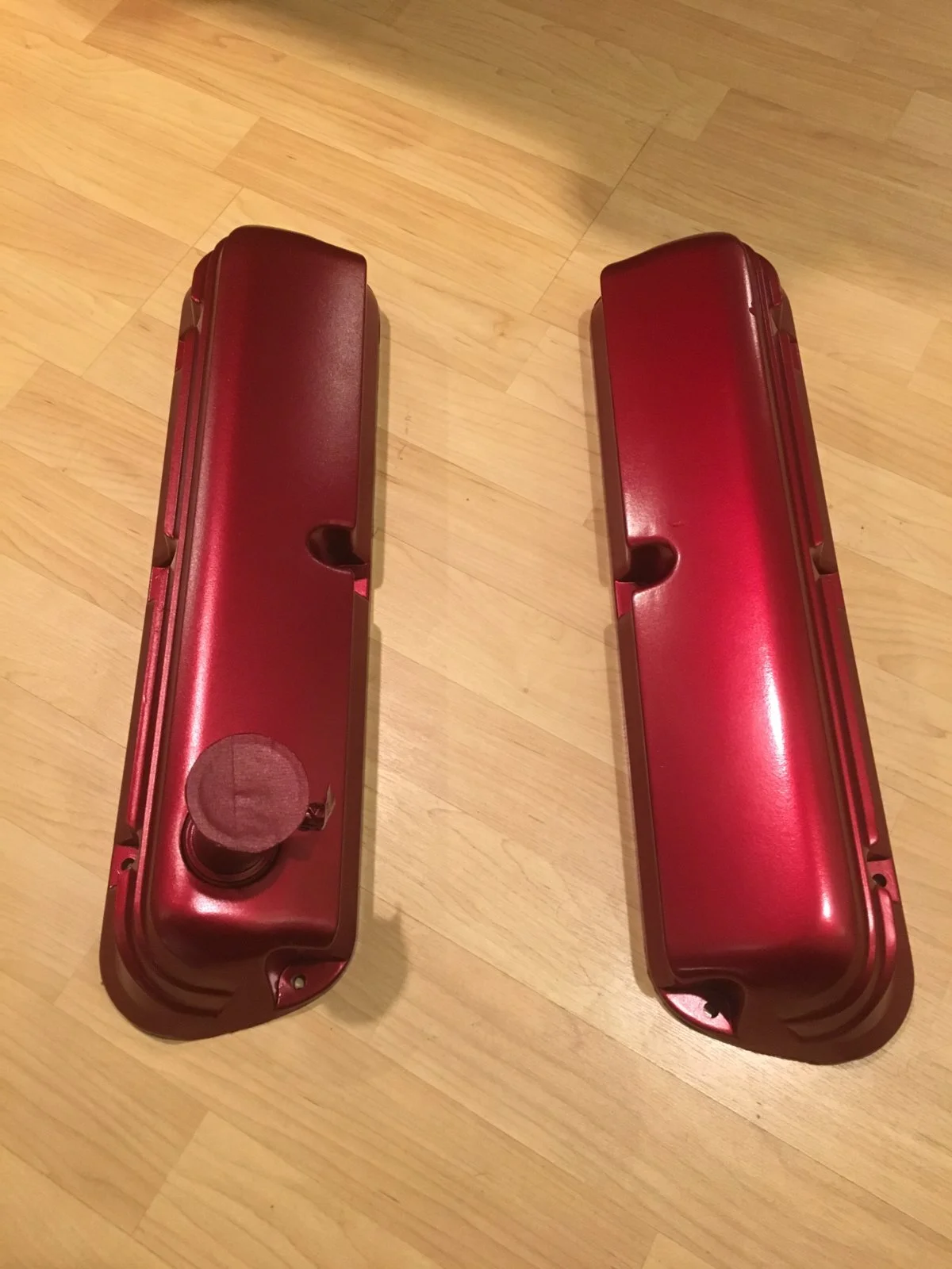

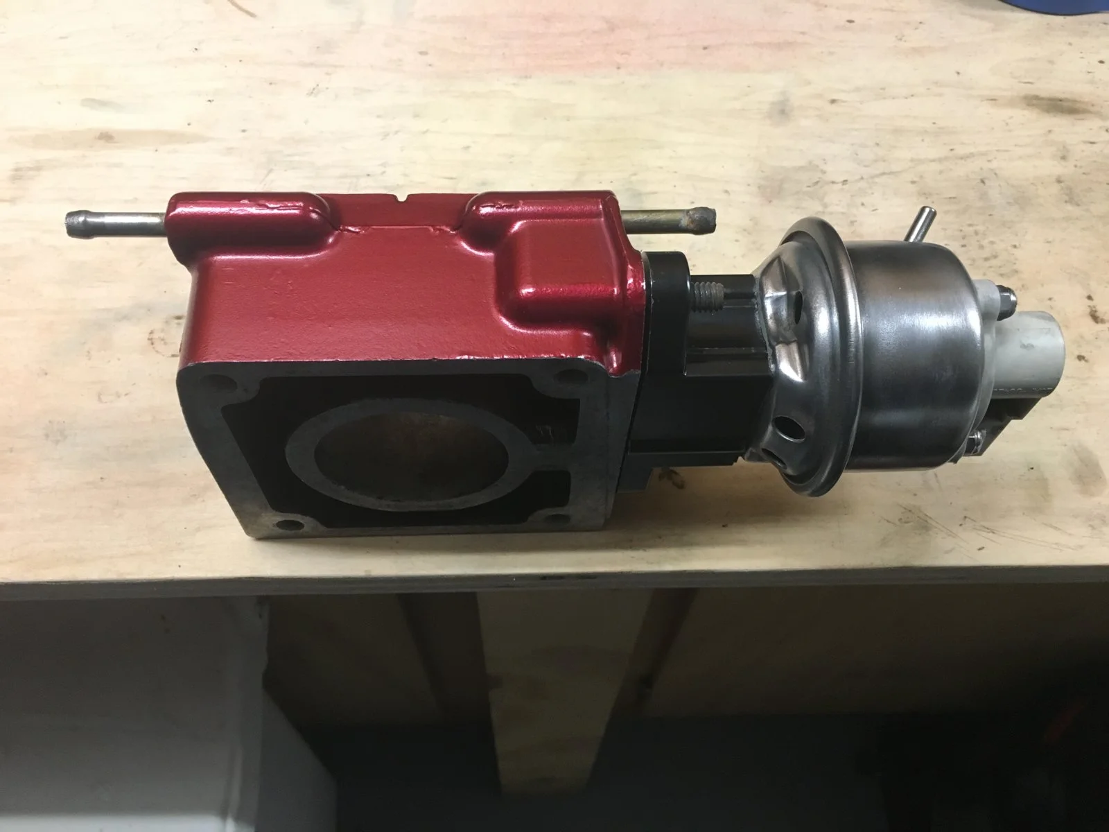

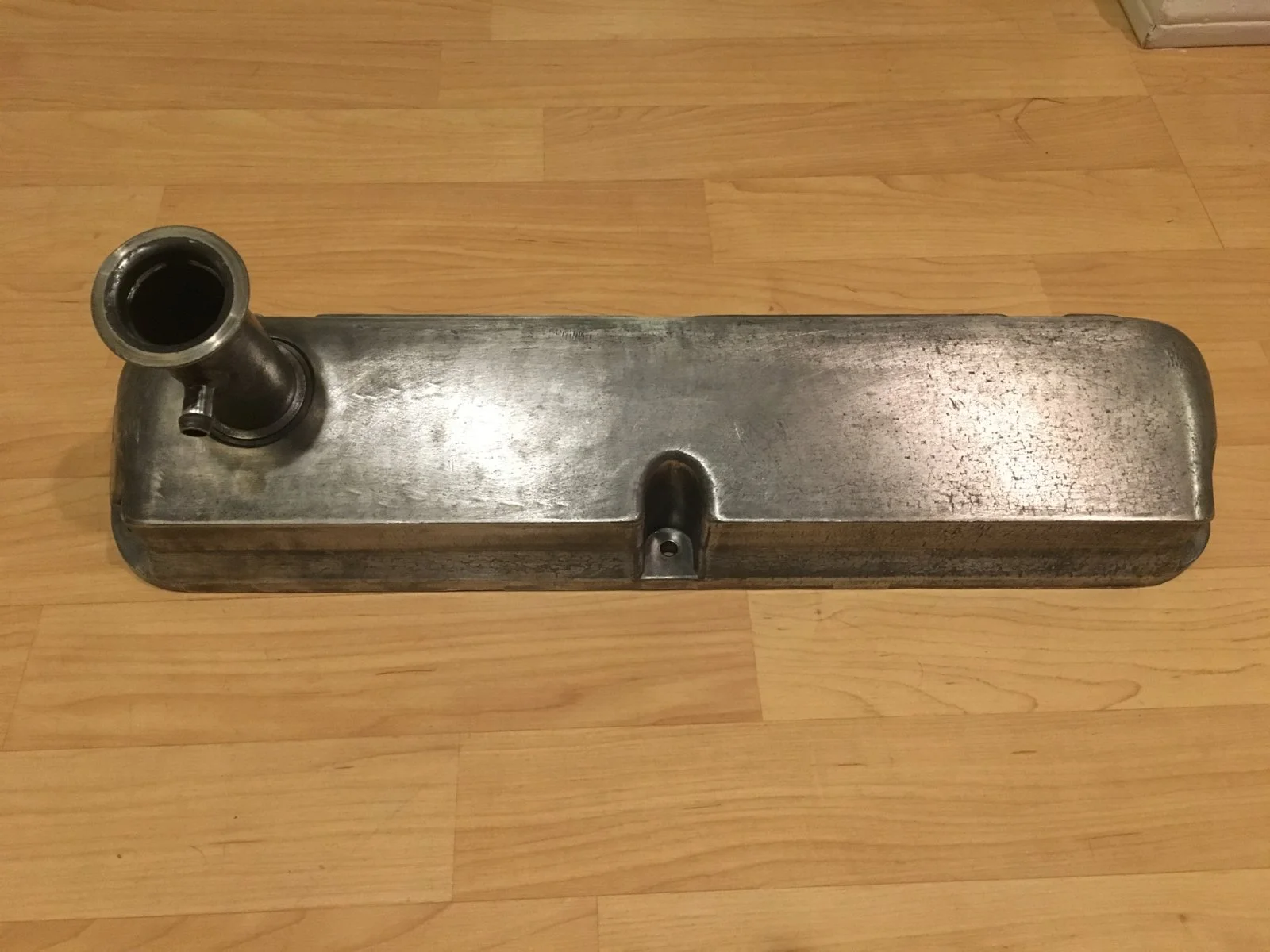

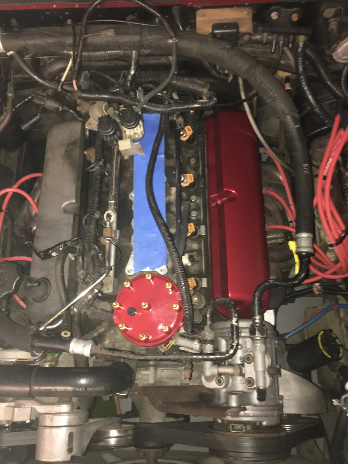

Just a quick update now that I’ve got the paint issues figured out.
Drivers valve cover done (just a test fit)
Passenger side off, cleaned, ready for prime.
EGR and spacer plate primed and ready for paint.
After paint:
I also just received the AC delete kit on sale from LMR, so that will be part of the underhood clean-up as well.
Reactions: 1 users

Some more work today:
Second valve cover painted (still need to polish)

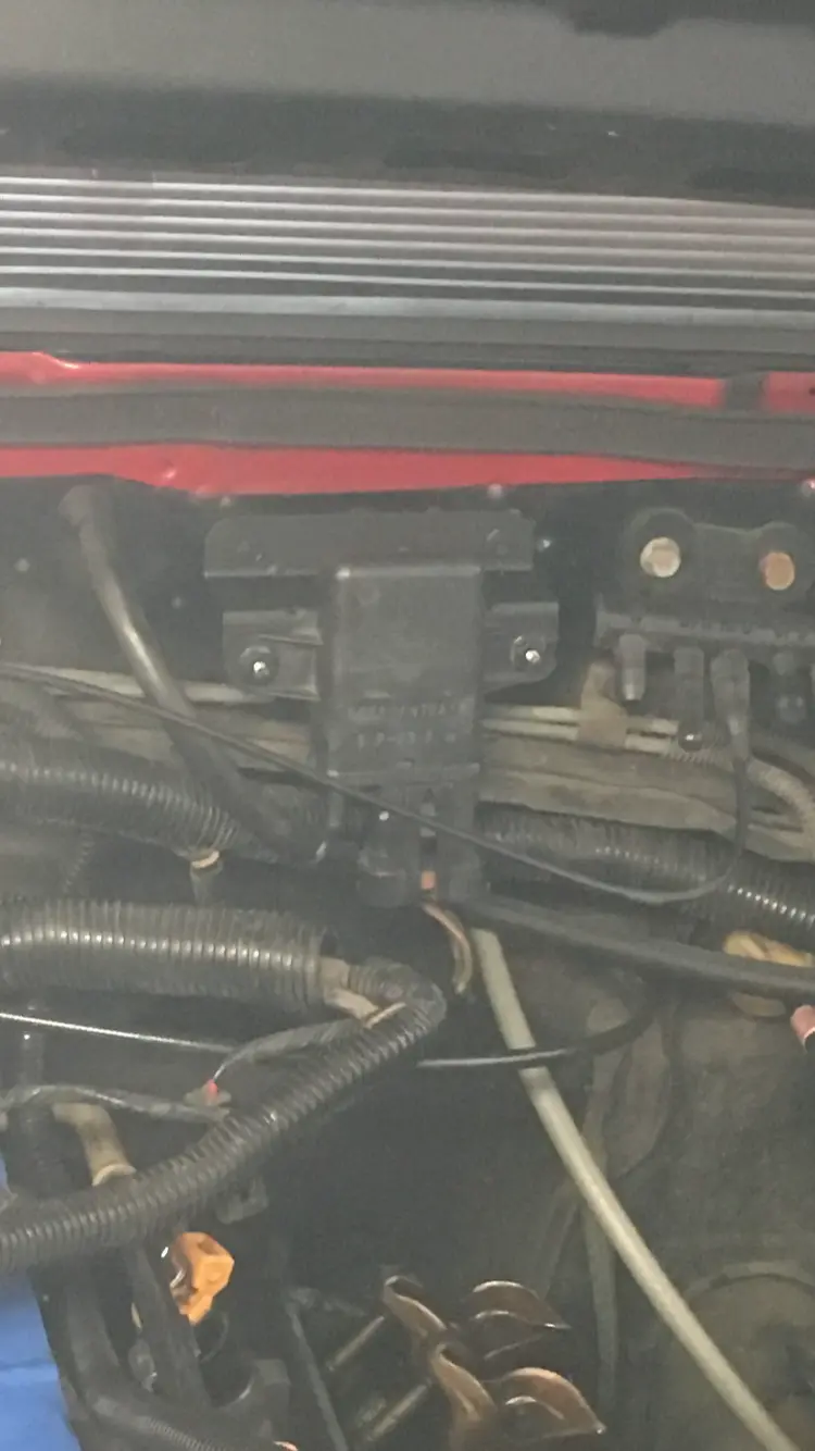

Bracket for MAP sensor has been bugging me for a while, so got that cleaned up.
