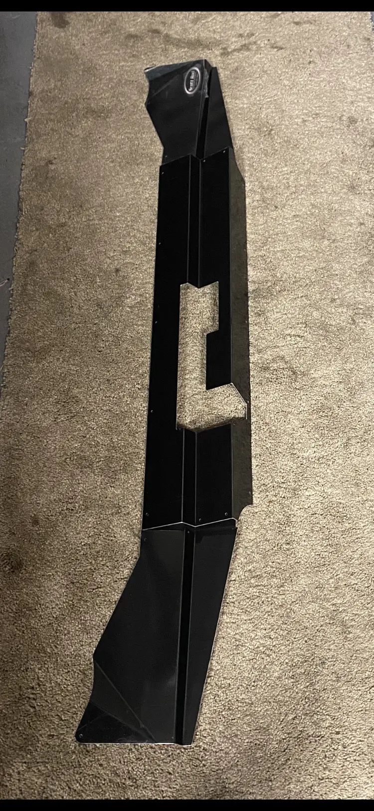

So I shifted gears a little in anticipation of car show season, and picked up a Scott Rod front radiator panel. I also have some Redline hood struts on the way from LMR.

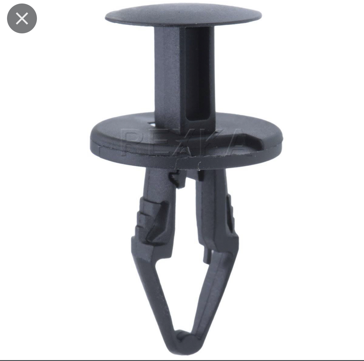

I love the look of these panels, but really hate the idea of the rivets. I rather it be removable a lot easier than drilling out rivets. Are there any other options that would still look good, but make removal easier. I’ve seen the plastic removable rivets, but I’m not sure that’s the way to go either. :scratch:

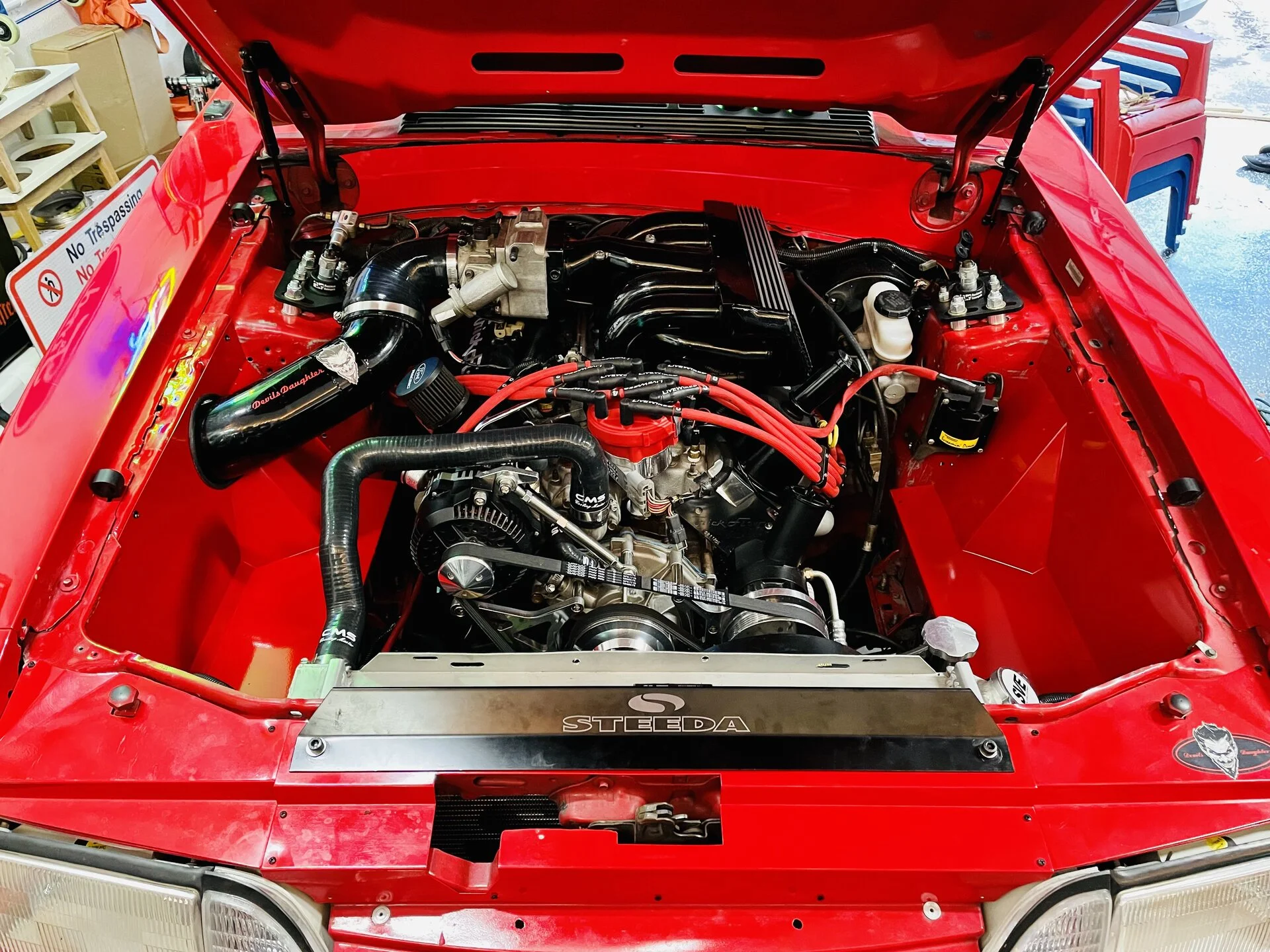

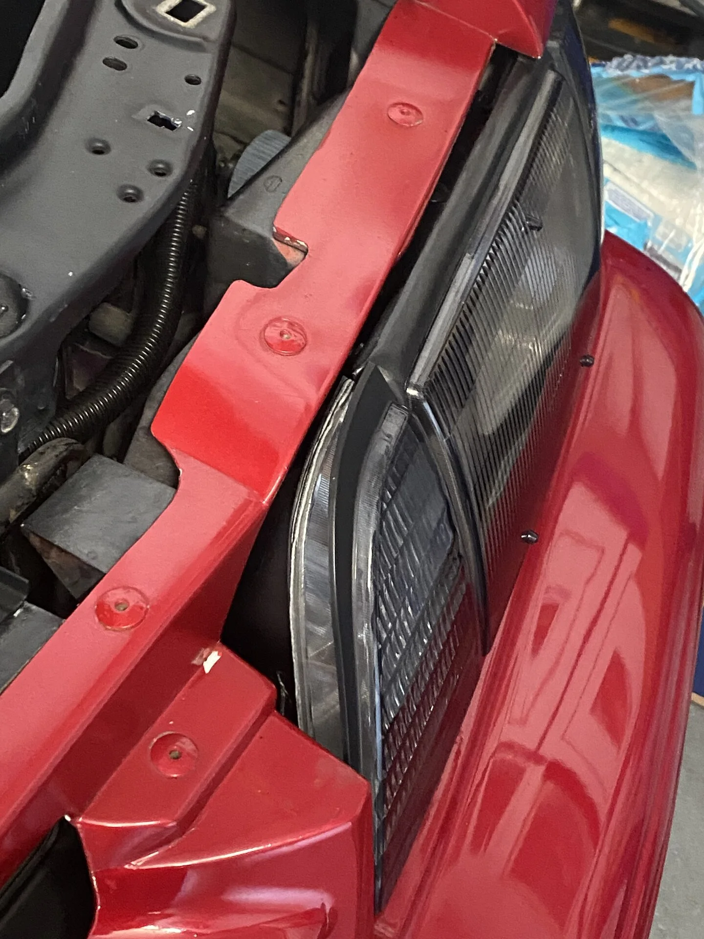

Def didn’t rivet the gap cover. I used some small black screws so I can take it off easier. I like the idea behind those hex bolts but seems they would stick out to far. I used the screws so they would be flat and flush. I did rivet the fender aprons though for now.

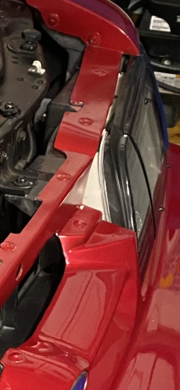

As @derek1993 predicted, this is not as straightforward as it looks. No doubt due to the aero conversion done long ago, and what I believe is a replacement core support.
Where it needs to sit up against the core support, it doesnt have the “reach” to make that right angle down in front of the grill. But when you get the front to fit, the hood won’t close. This will be a test of my patience…….. but I’ll get it!
I also decided on some little black button screws instead of the rivets……. Which is also helping in my “back and forth” in the fitment.

What was the issue just not being able to close the hood? I did have to trim mine some in the latch area bc it was catching and was hitting some. Once I could see where it was hitting I trimmed it and then had no issues.

Thanks and I like the idea of painting the housing of the headlights. As for the squares I just lined them up and then marked, drilled a hole and then from the I made small square cut with my dremel and made it bigger slowly until it fit around it. I was disappointed that these were obviously fab’d for our cars but it wasn’t a legit bolt in. I had to trim some of the bumper gap panel, same with the fender aprons. Tested fitted time after time till it was right, then I just had them powder coated for now until I get the engine bay repainted.
