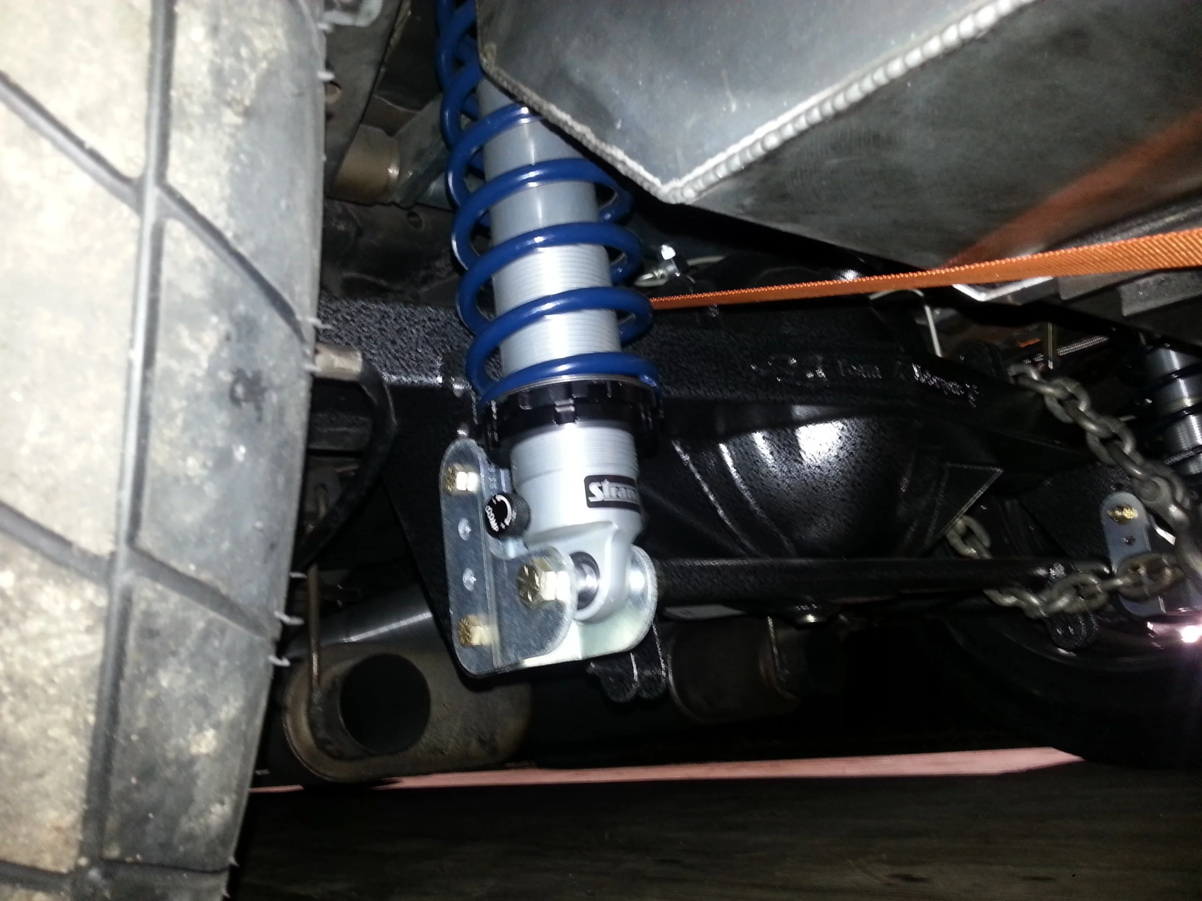

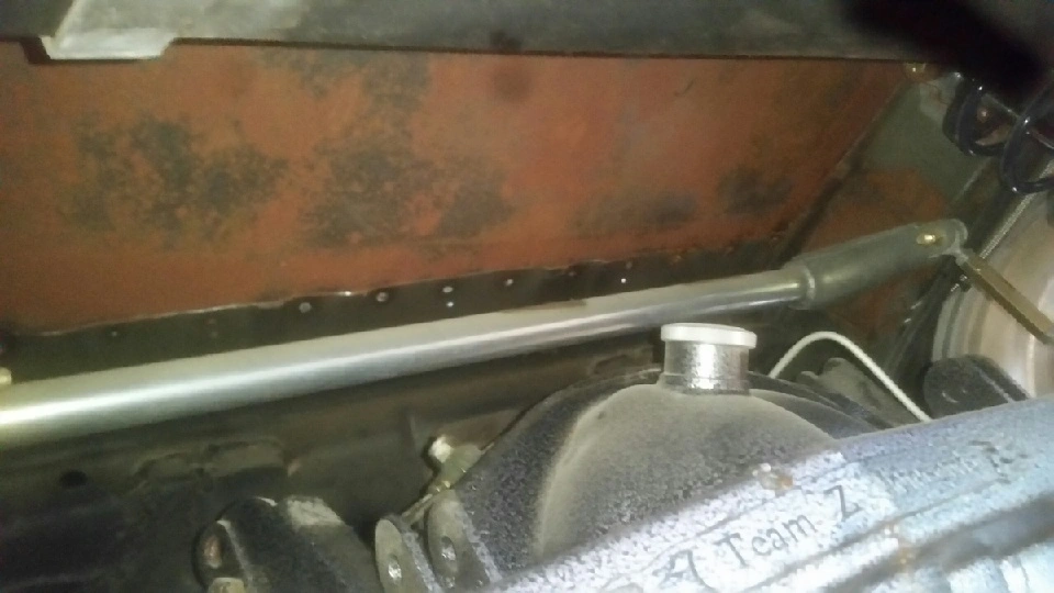

- Team-Z Outlaw 9" rear with 3.70 gears w/ fully adjustable upper & lower control arms, an anti-roll bar tabbed for wheelie bars and a removable parachute mount
- Strange 35-spine axles
- Double adjustable shocks & coil-overs

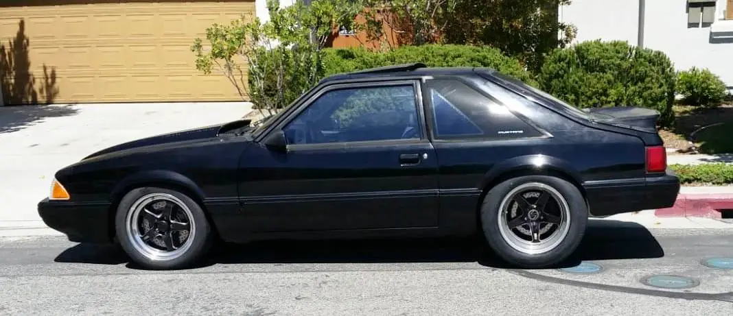

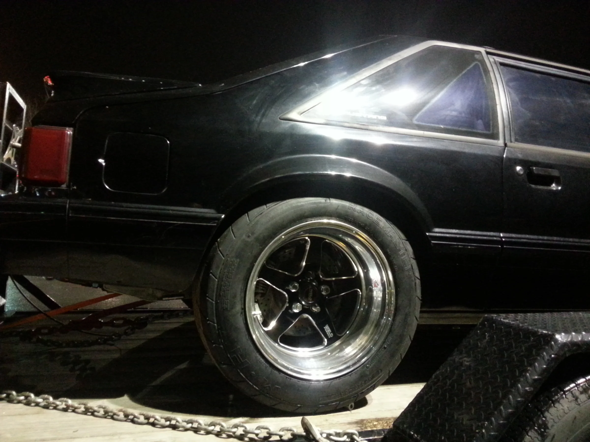

- Weld RT-S S71 black wheels 17x12" with 325/45/17 (28" tall) M&H Racemasters for the street. Hoping to go a 13-14" wheel with a max-sized slick, but still have to figure out exactly what will fit back there. New 17x8" RT-S wheels are on order from summit with 245-45-17 Michelin PSS tires. When I order the wheels and slicks, I'll get skinnies too.

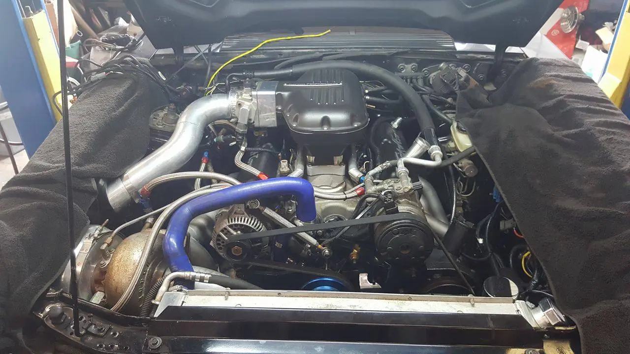

The car was dyno-tuned and made 880 rwhp before the backpressure overwhelmed the 5-7 lbs wastegate spring and boost controller at 21 psi. There is plenty more left in the car. I'm not in a hurry to max it out, though. There are a lot of little things to work through, and until I have slicks, making more power is an exercise in futility.
Currently, I'm working through the tune and have dramatically improved cold-idle, idle, and around town driveability.

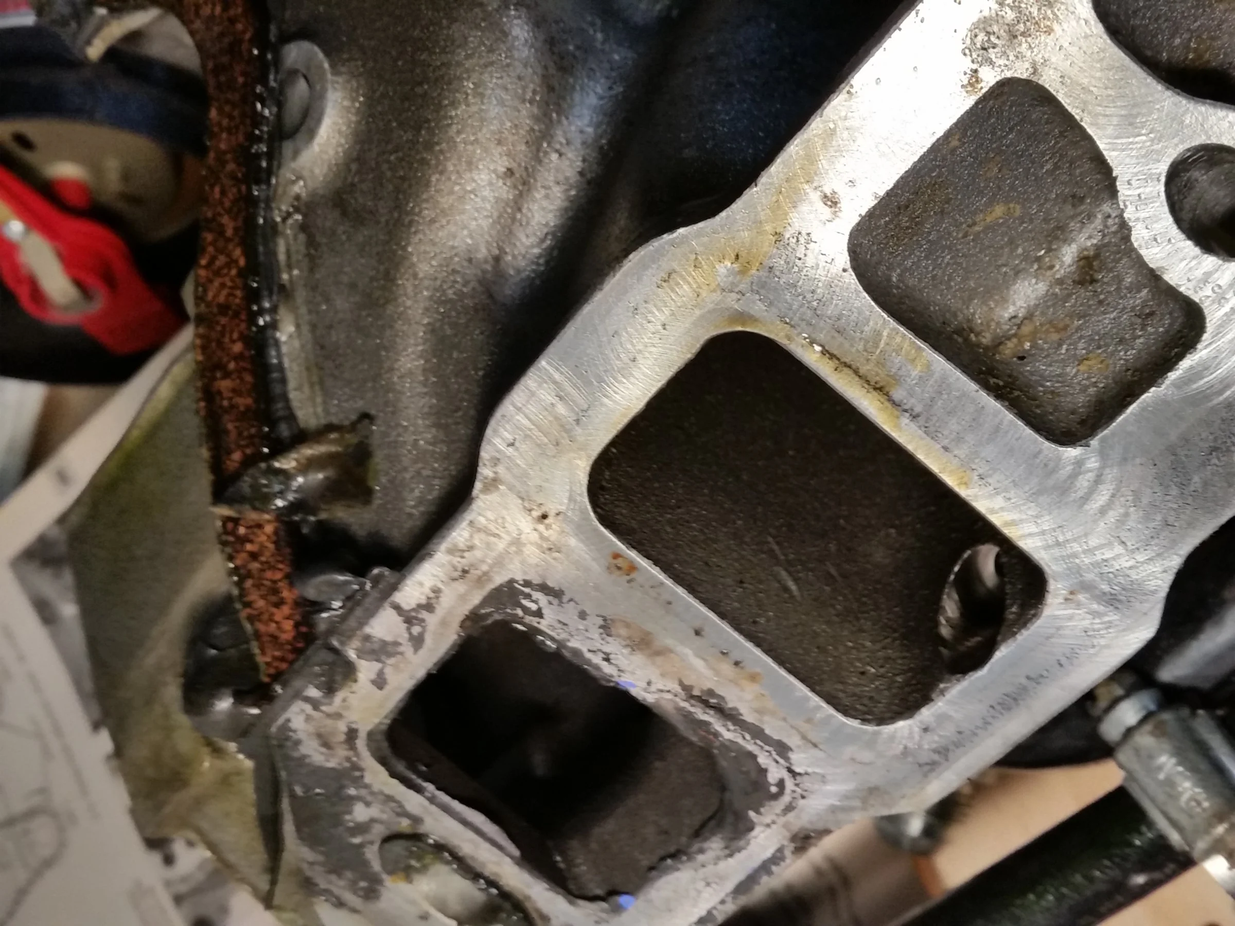

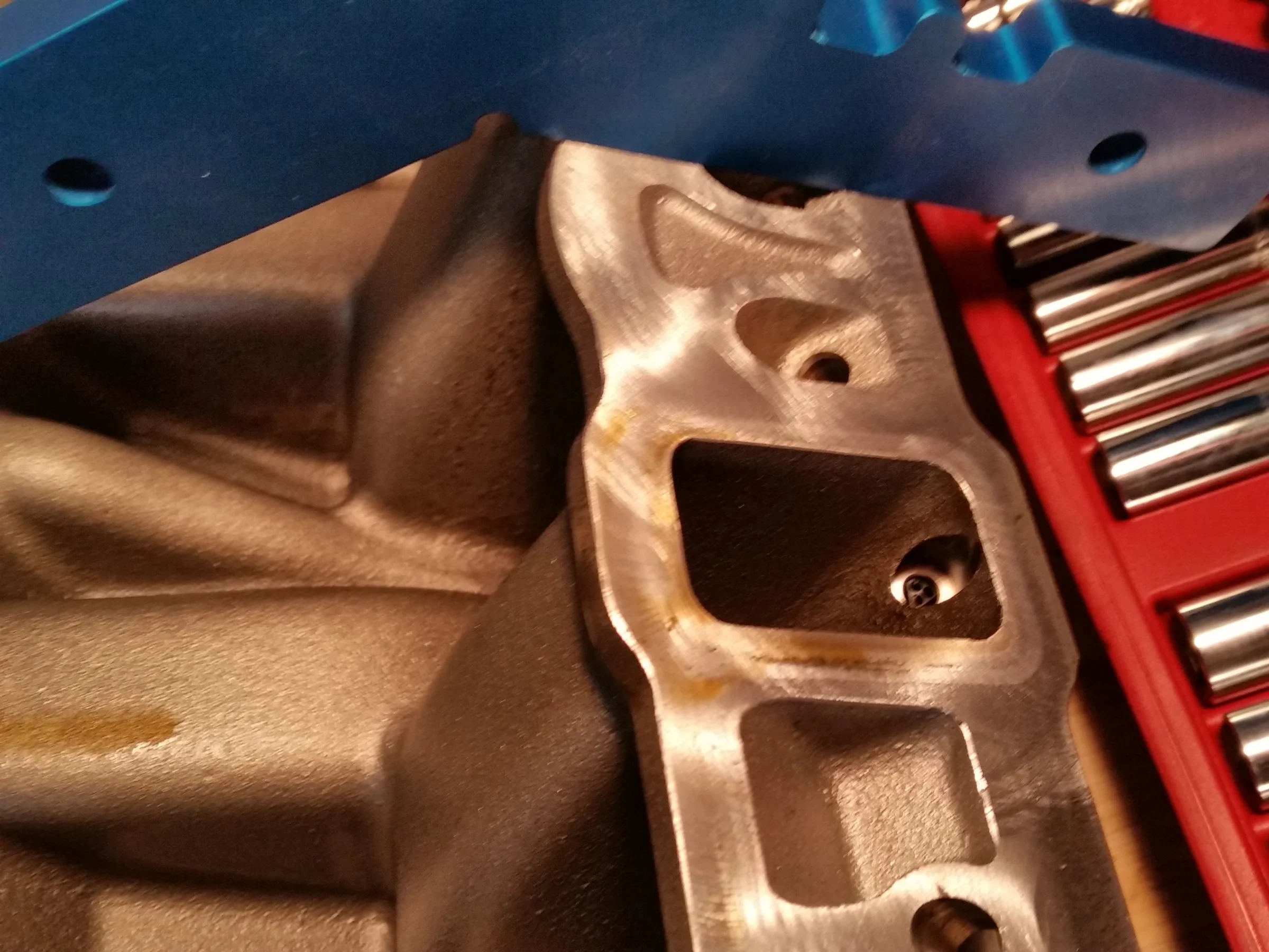

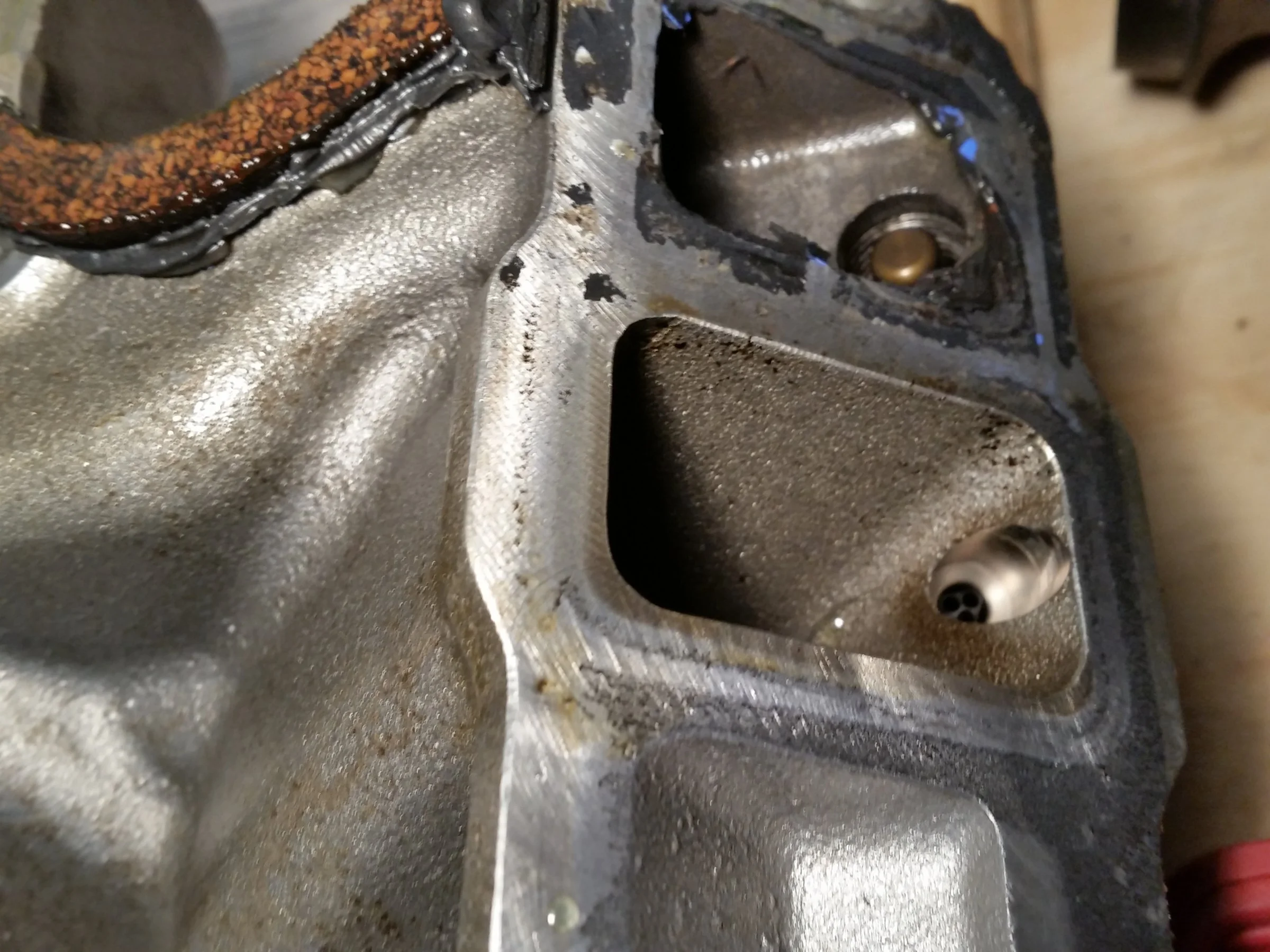

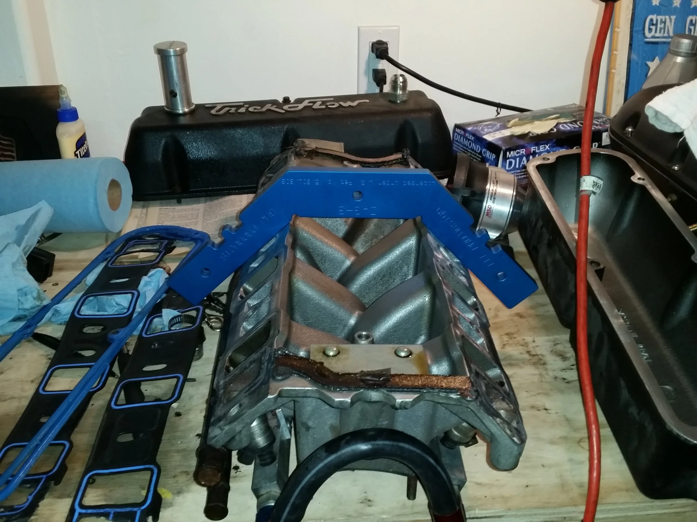

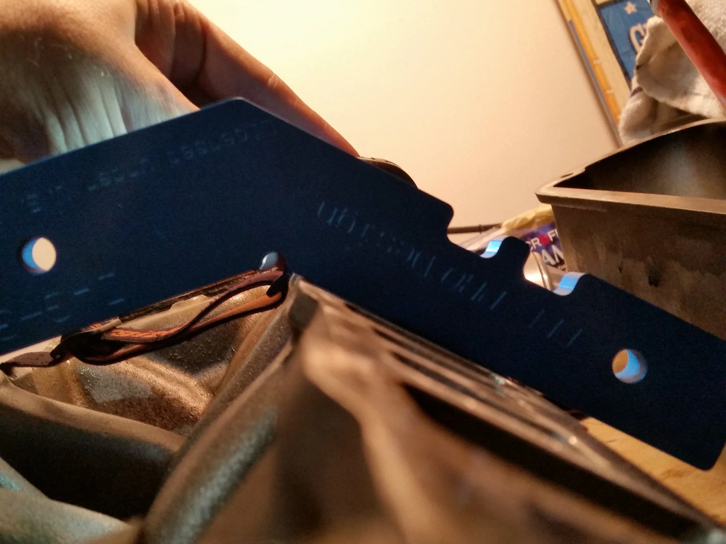

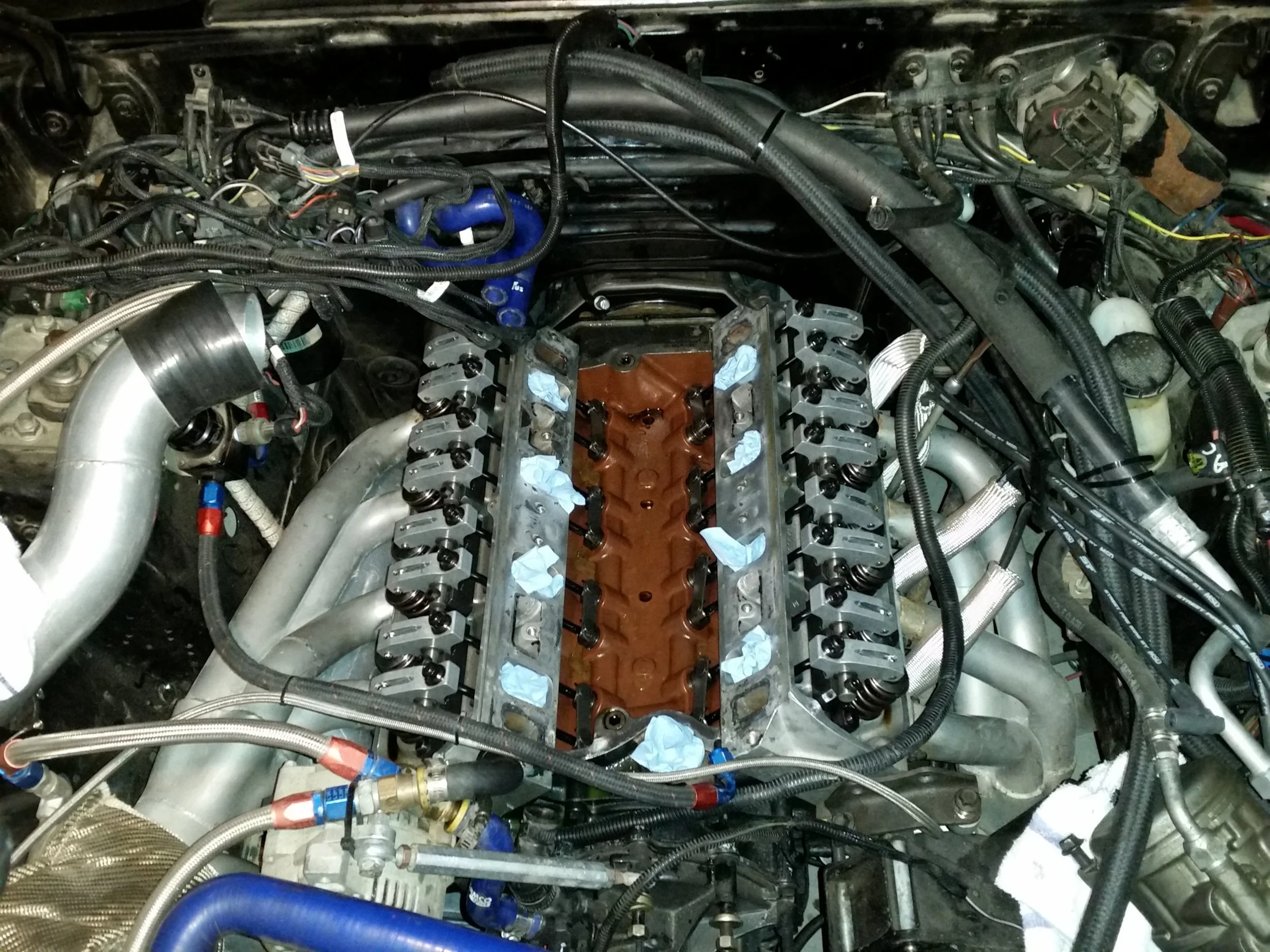

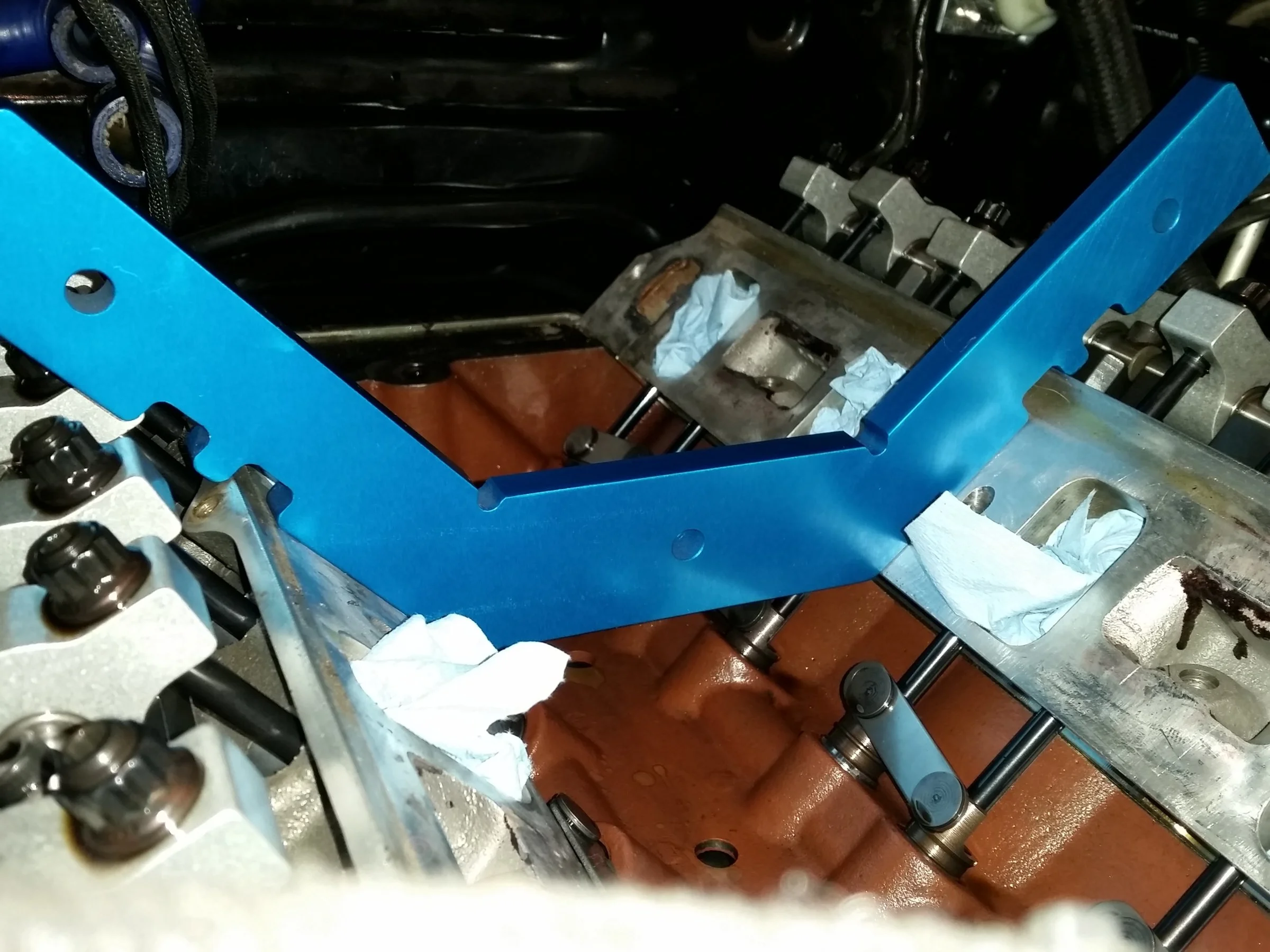

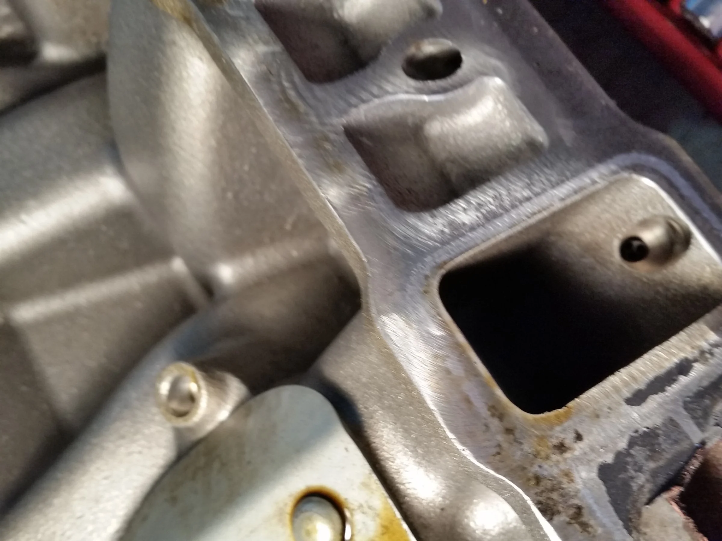

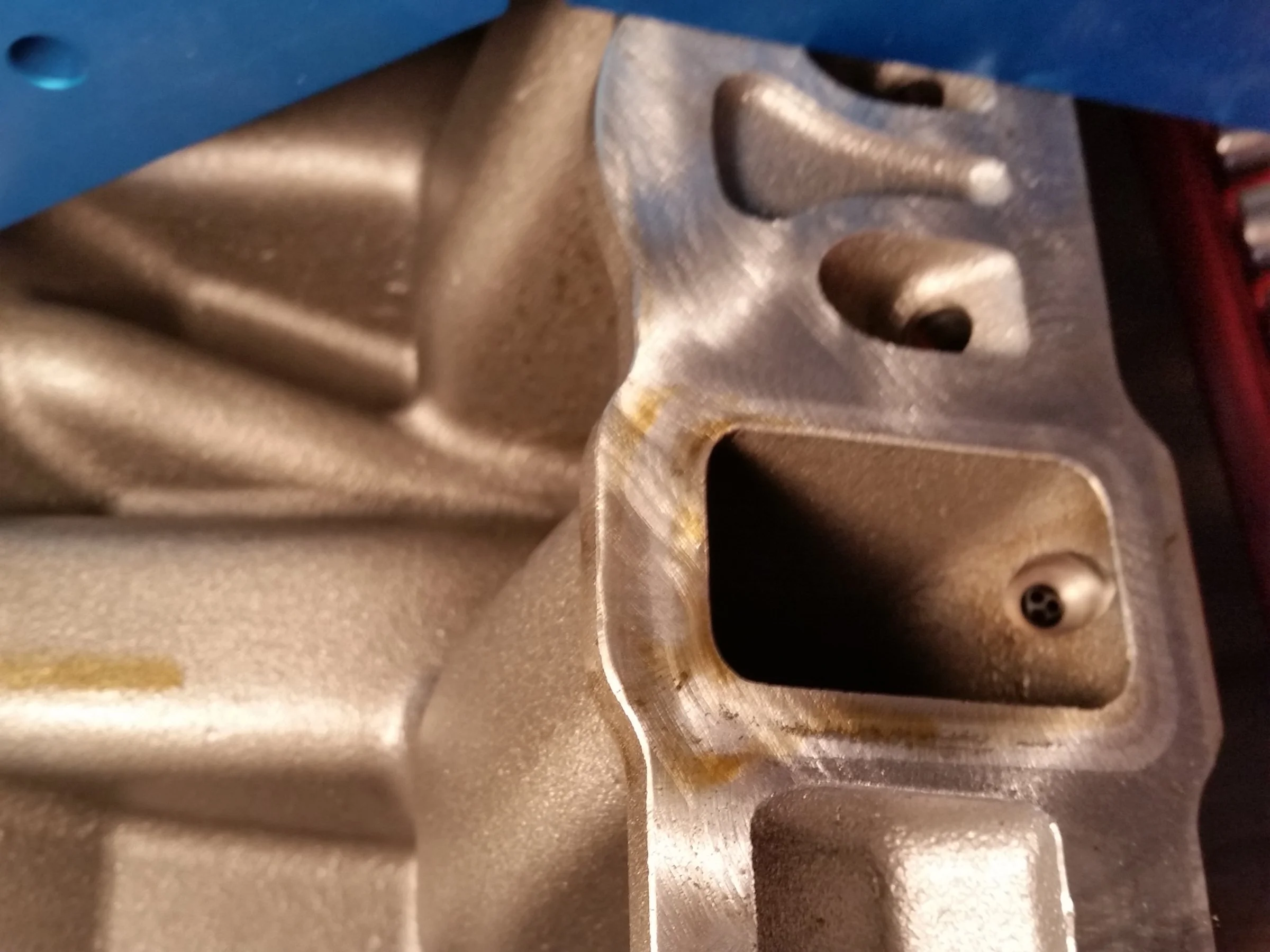

I recently noticed that I'm burning oil that I hope/think is a driver's side lower intake gasket issue. I just started working on it, today. It might take til after the holidays to work through it, though. Too much going on with final exams, visiting family, etc...
- Team-Z mini-tub
