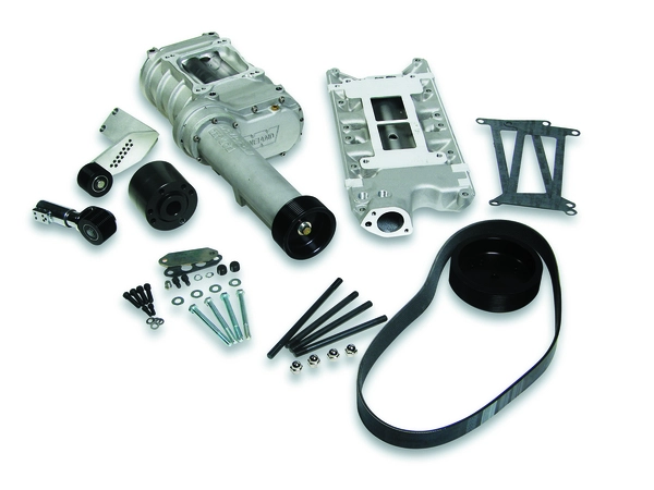

A blower like this in the right displacement (and a hood scoop if needed) might work fine, and it is probably more efficient than a Roots type.
The intercooler on a turbo or centrifugal supercharger will be a big help. I have seen OEM valley superchargers with water intercoolers. Good luck getting a Caddy factory unit to fit a Winsor. Maybe there is an aftermarket combo for Fords I missed.

Yep, I had my part numbers mixed up.
They used to make it for a SBF, maybe somebody decided it wasn’t worth the powder to blow it to hell, and stopped making it. Now it looks like they only make the 174 kit
Just look at how long the front drive is, I think they make a brace that bolts onto that elephant trunk to add support to keep it from flexing.
