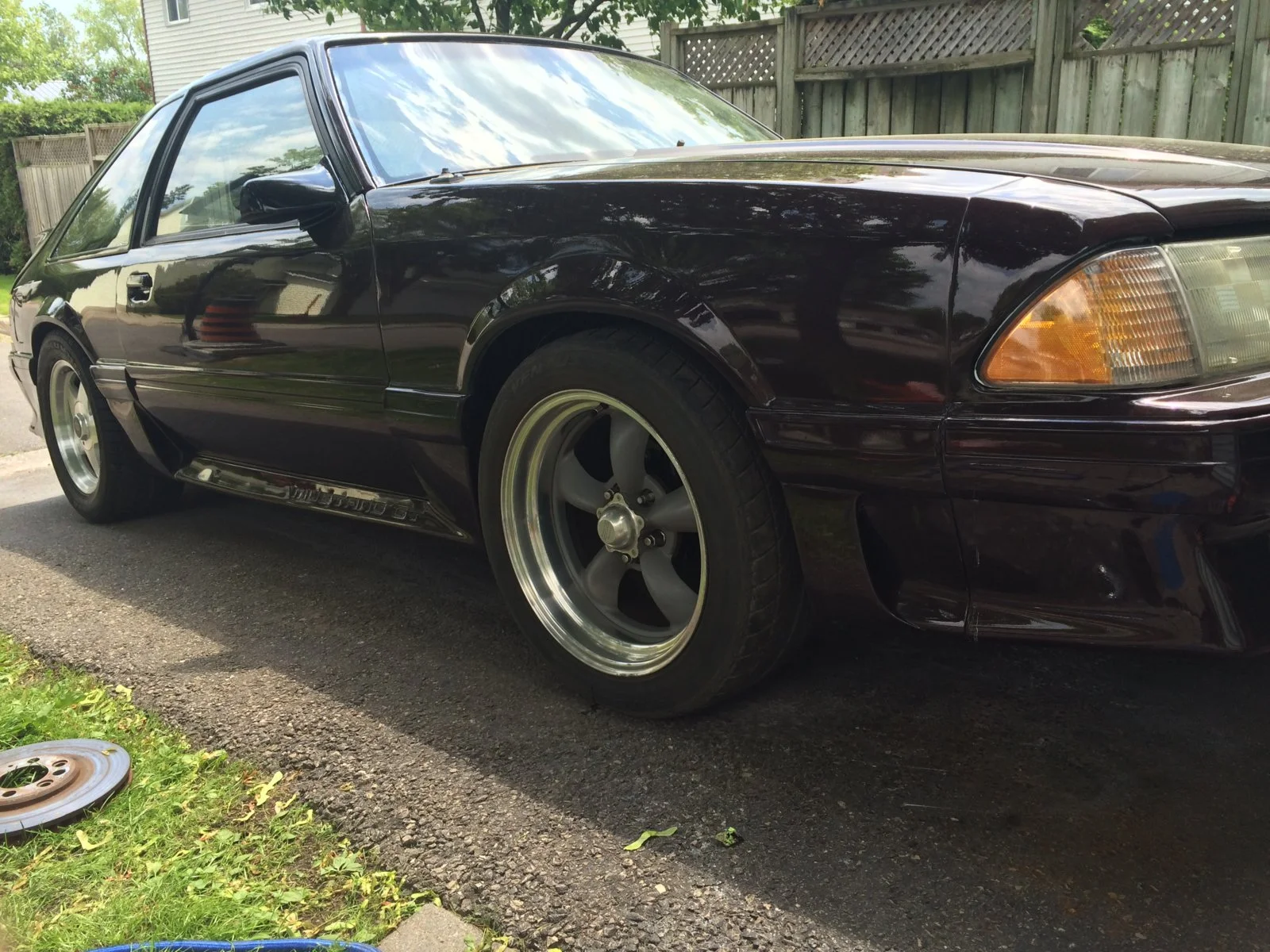

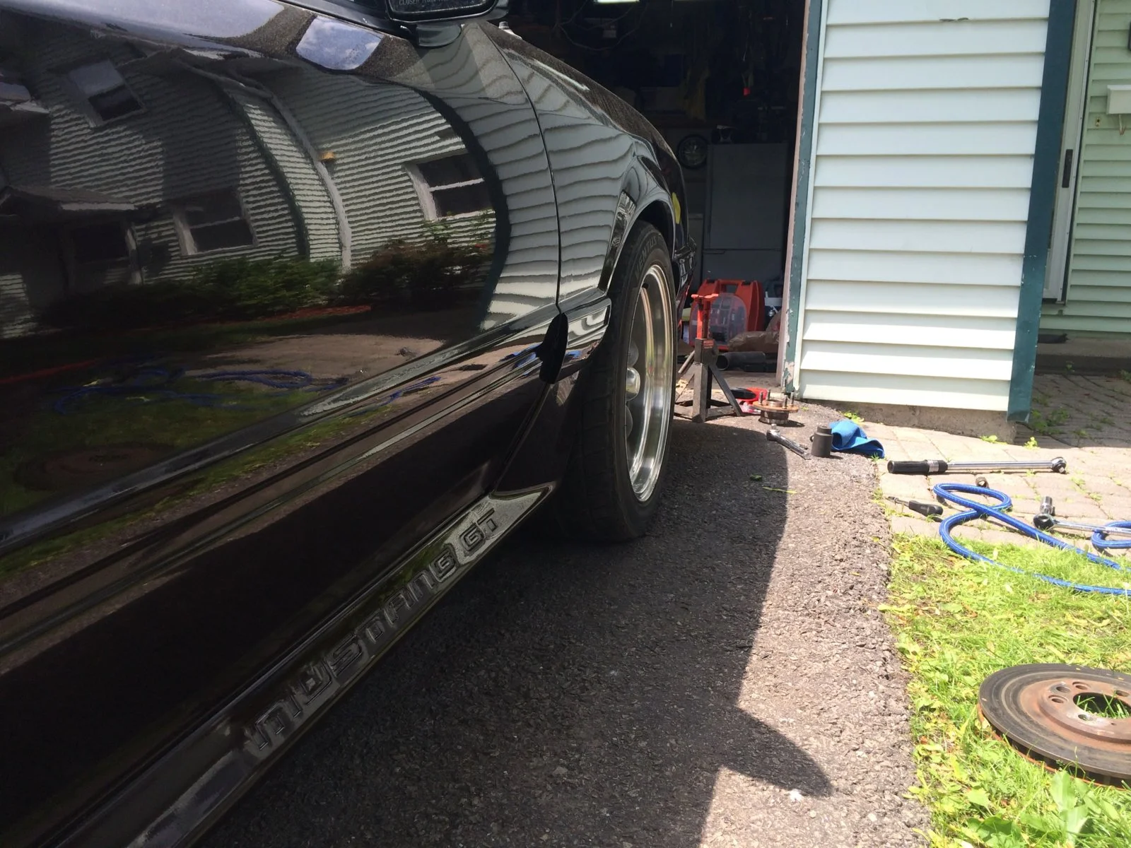

My 90 has the 96+ spindles on fox control arms with the Mathis mod. I am still running 4 lug and have a 245/50/16 front tire on a 16x8 rim. I get a slight rub a full steering turn in one direction only. The drivers side tire touches the plastic inner fender every so slightly. With the Mathis mod and this spindle, I lowered my steering rack with offset rack bushings and do not need a bump steer kit (tie rods and control arm are basically parallel at ride height). I have a Granatelli coil over with 300lb springs on an OEM strut.
My 5 lug plans are to go with Torque Thrust 2's, 17x8 (either 0 or +8mm offest) with a 245/45/17 tire.
I'm pretty sure the tire in the pic is a 245/45/17.
