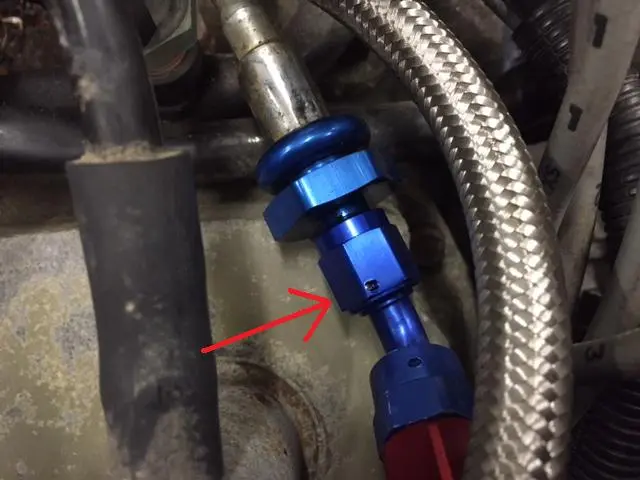

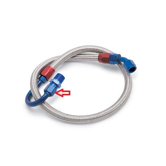

The aftermarket flex fuel lines have a small hole located on the connectors on each side of the hose. I believe that this hole is a safety pressure relief.

Same thing happens to me when I eat chili...seriously though, post up some pics. That's not the typical set up. References may help us give you advice.

I will post some pics of the actual set up when I get home but these are the fuel lines I am talking about.

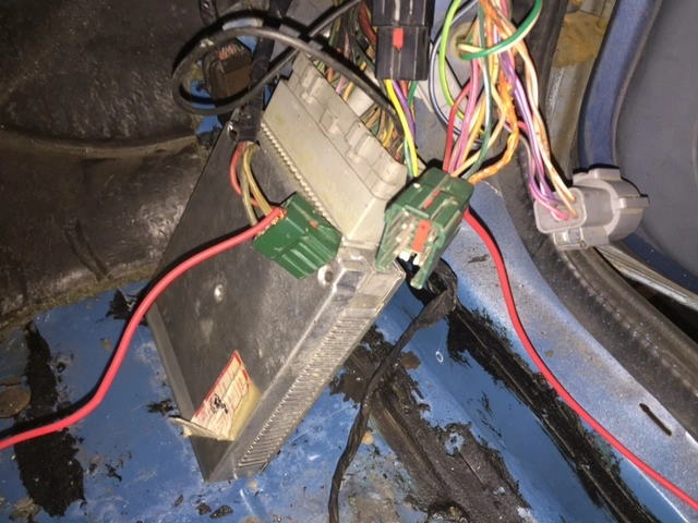

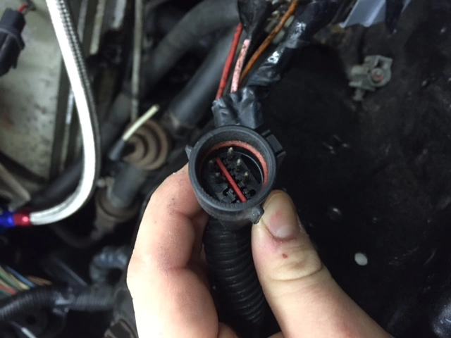

Ok so this is what I have to do to get the fuel pump to run. When I connect the red wire on the 8 pin to the pink wire on the body side the pump runs continuously when the key is in the ON position. It does not shut off after 5 seconds.
There is currently nothing connected to the gray connector near the green 8 pin.
When the fuel pump does run, fuel sprays out of the high pressure line near the fuel rail.
There is also nothing connected to this black connector.
So to answer some of your questions:
1. The fuel pump does not run when I jump the test connector (without and without green 8 pin jumped).
2. I have no shrader valve because it is all flex fuel lines so I cant test fuel pressure.
3.When I test the pump relay with the key in the ON position: There is no power at the red wire. There is good power at the pink wire.
4. I dont think it is a computer problem because I swapped computers and the problems didnt go away.
5.The computer ground near the battery is clean and connected.
Completely stumped.....

Those tiny holes are there for instances where you would want to use a safety wire to prevent the fitting from coming loose.

Ok so with the green 8 pin not connected and the key in the RUN position:
1. No power to either side of the inertia switch. Good power on both wires leading in to the injectors.
2. Both wires to the ignition coil have power
3. Still no power to inertia switch.
4. Inertia switch button is down and not tripped.

Think about what you observed:
1.) There is power on the red wires for the fuel injectors; that means that the ECC power relay is working supplying power to the computer and inertia switch wiring.
2.) You have no power to the inertia switch. That means some wiring harness isn't plugged into it's' mating half. The connector that isn't connected to anything may be part of the answer. Clean the wiring with solvent and post the wire color with stripe. The wire colors aren't there to make it look impressive or pretty. Ford has wiring spec that spells out what circuit the wire colors connect to. If one of the wires is red, you have found one half of the inertia switch wiring. Look for the other half that mates the connector and you are on your way towards getting this problem fixed.

So these this is the gray and black connectors that are currently not plugged in to anything. There is no red wire coming out of either of them. The white/orange wire on the gray connector has 12 volts with no key in the ignition. The only red wire I see is coming out of the EEC relay and it has power when the key is in the RUN position.
