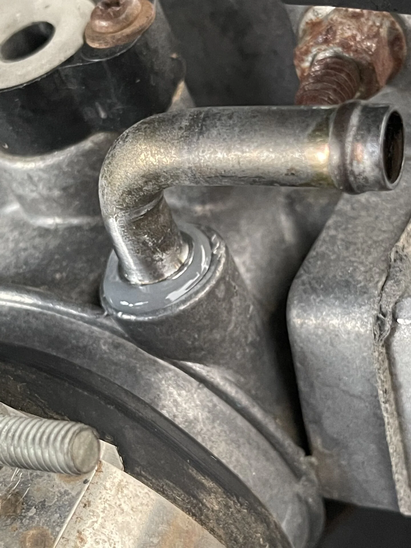

Ok, the big
That is a 94-95 MAF. It works fine with a9x and 19# injectors. I run the same MAF.
However, this is not helping

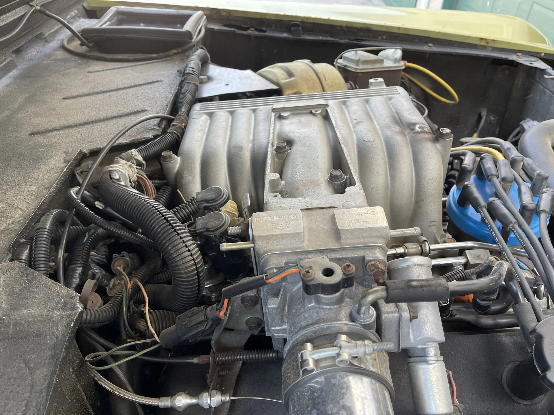

Ok, the big hole has been remedied. I pulled that elbow and carefully removed all the rtv gasket. I cleaned the metal with carb cleaner and carefully sanded everything. I could not find a replacement elbow, so JB Weld was my solution. Very clean, well sealed. Should be permanent. The blue was an old quick fix that I had not recognized as an ongoing problem. Check that one off.

I know there are other gaps in the system, but I am encouraged that the unmetered air would cause rich idle and lean under load.

Thanks. I have JB weld fixed the throttle body leak. When it was running poorly I sprayed carb cleaner all over the top of the engine. Under the intake. Anywhere I could spray. There were no other leaks.

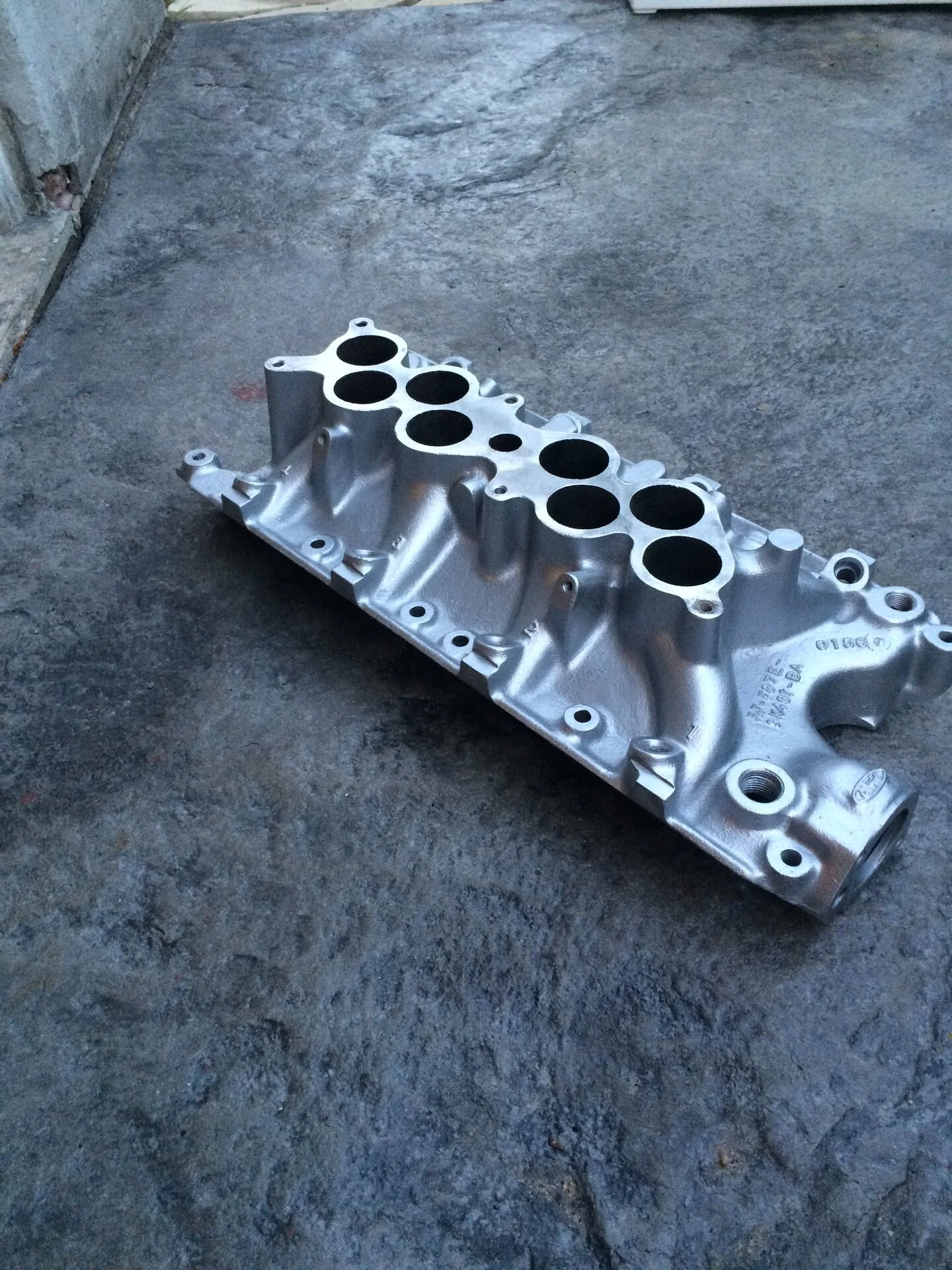

Later explorer intakes lack the central EGR port. Early intakes have it. If you have a pic from the front of the intake I can identify it. EGR is separate from the air pump. Two different systems. So if you were to put it back on you do not need to add the air pump.
To properly delete the egr you will need a tune to shut off the cel. Off-the-shelf tunes may or may not have this. You’ll need to dig into the actual tune to see what it does but for the most part those tunes aren’t really worth it.
Edit: your explorer intake looks like the early model. If you really want to add the EGR you can just unbolt it and lift the upper up to see if it has the center EGR hole on both the upper and lower

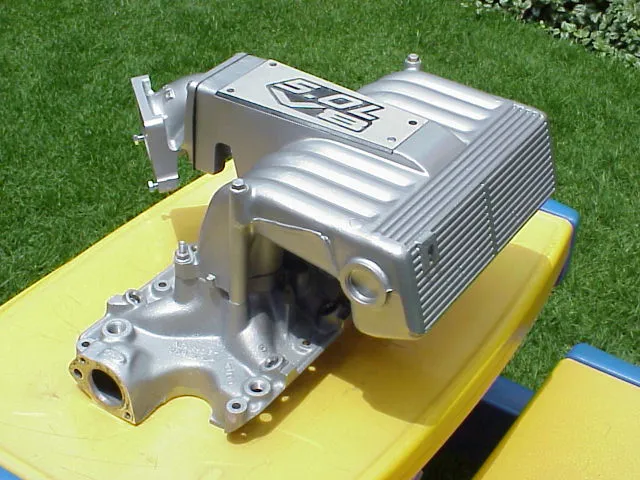

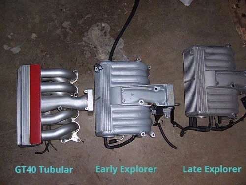

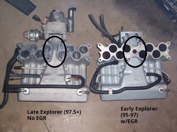

I agree the OP has the early internal EGR type Explorer intake. For those that don't know the quick way to identify, here is a pic off the internet of the later non-EGR style.
Non-EGR type have the notch along the bottom just after the inlet as shown here.
This is my EGR style where the inlet is level across with no notch, just like the OP.

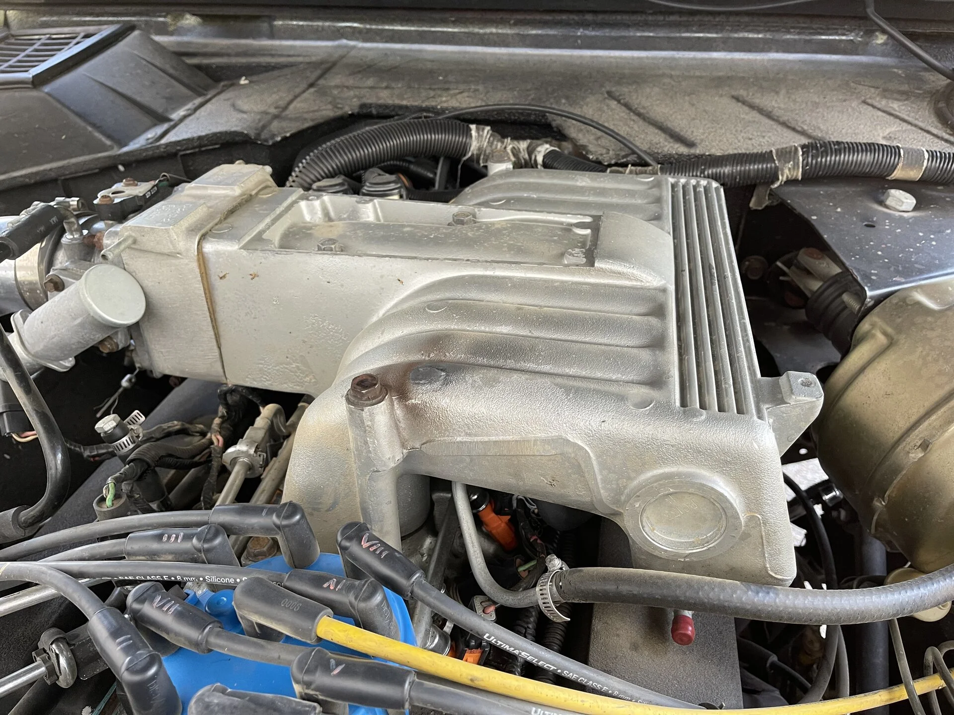

Can’t respond as well as I’d like to on my phone. But I’ll type what I can.
Carb cleaner is an effective way to find vac leaks, but smoke test is a better method. If you suspect any leaks beyond this, I would recommend building a cheap smoke machine and trying that method. It is more effective.
Most of your codes are soft codes. The EGR codes are hard codes that do trigger the cel and will turn off the EGR function in the ECU. While the car does change how it runs, the ECU is properly compensating. If you don’t mind the cel, you can run this way.
As I recall there is a hole in the intake manifold, but the upper intake did not have the hole, so this effectively closed of the EGR system. I was just curious if it's worth getting a different upper intake and putting the EGR back into the system. I recall there was some type of plate I used on the throttle body, but don't recall 100%. See photos of my intake below. Based on your photos it seems I don't have the notch. I guess I don't know exactly where the EGR connects and runs or what I am running. I just recall there was an opening in one and not the other. Perhaps it was the other way around and the intake was non EGR. If you have any idea, I'd appreciate the direction. Thanks.

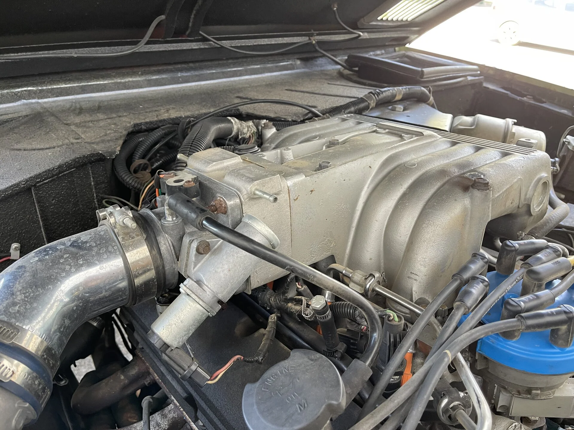

I did get that leak on the intake sealed up well. I am now getting 12mpg, so much better than 8.3. The engine seems to run cleaner and stronger. At this point I would ask, what might I consider next? The EGR?
I'm pretty sure I have the Early Explorer upper intake. Not sure about the lower, if there is a difference. So in my mind it would seem that I should be able to reconnect an EGR, but is that helpful? Useful? Seems to me I put some type of EGR block off plate on, but it's been so long ago I don't recall specifics. But if the upper and lower intake came from the same vehicle, then the "plumbing/venting" should exist to connect the EGR. I think I saw them on Ebay for like about $40 or so. Just not sure if it would be worth the effort or the cost. Curious your thoughts. Thanks. Oh, the attached photos were something I came across from when I was trying to understand the differences 7 years ago.

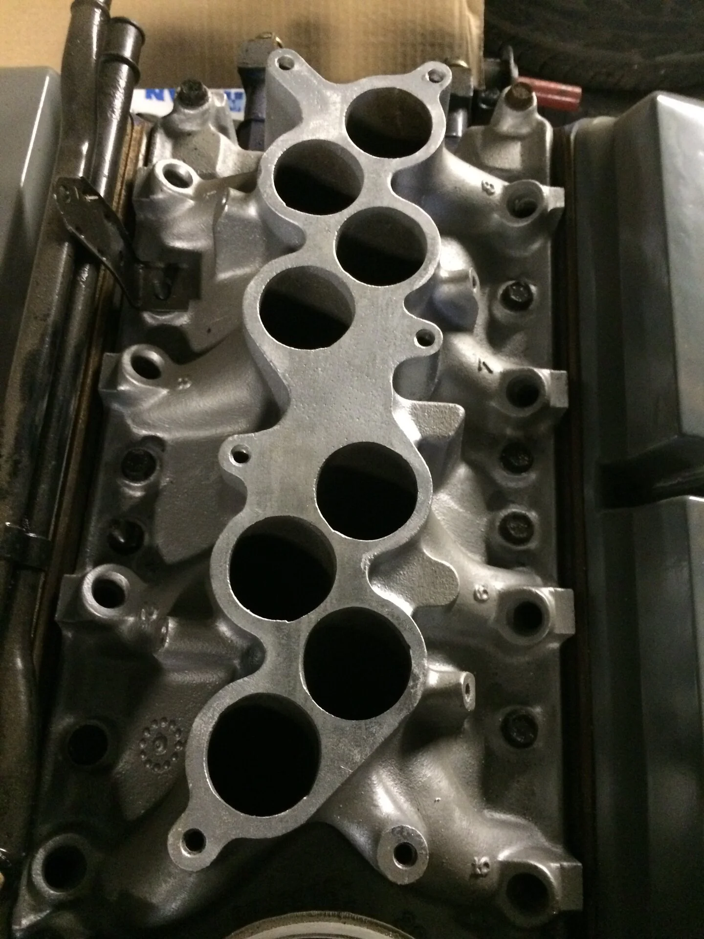

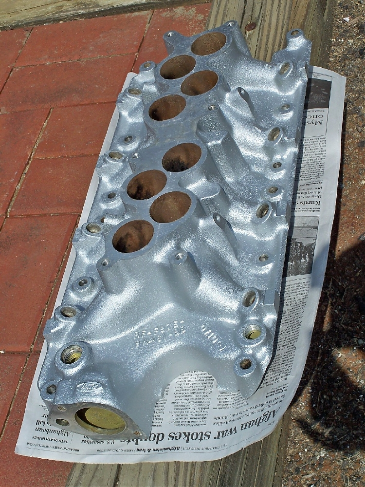

If you have an EGR upper, it does not matter which lower you have, your car will run. If you have an non-EGR upper and an EGR lower, you will have an exhaust leak between the manifolds.
Looking at the lowers, the only visual difference is the port in the middle.

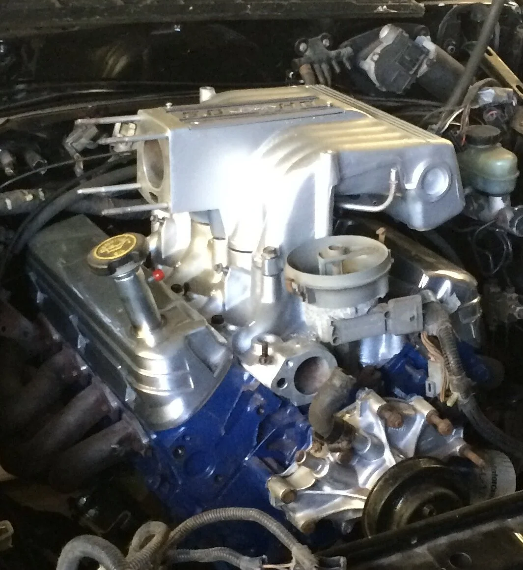

I’ll see if I can find notes or photos of the build. I think I took a couple along the way. Seems I would have had a matching upper and lower from an explorer. The heads were ported GT40 heads, not GT40p. Then the 94 cobra throttle body and the 65mm explorer mass air. I have read EGR arguments and I recall there being no reason to remove it from the stock system. But with it gone, is it worth connecting back up? I do believe I recall that it would fund less.

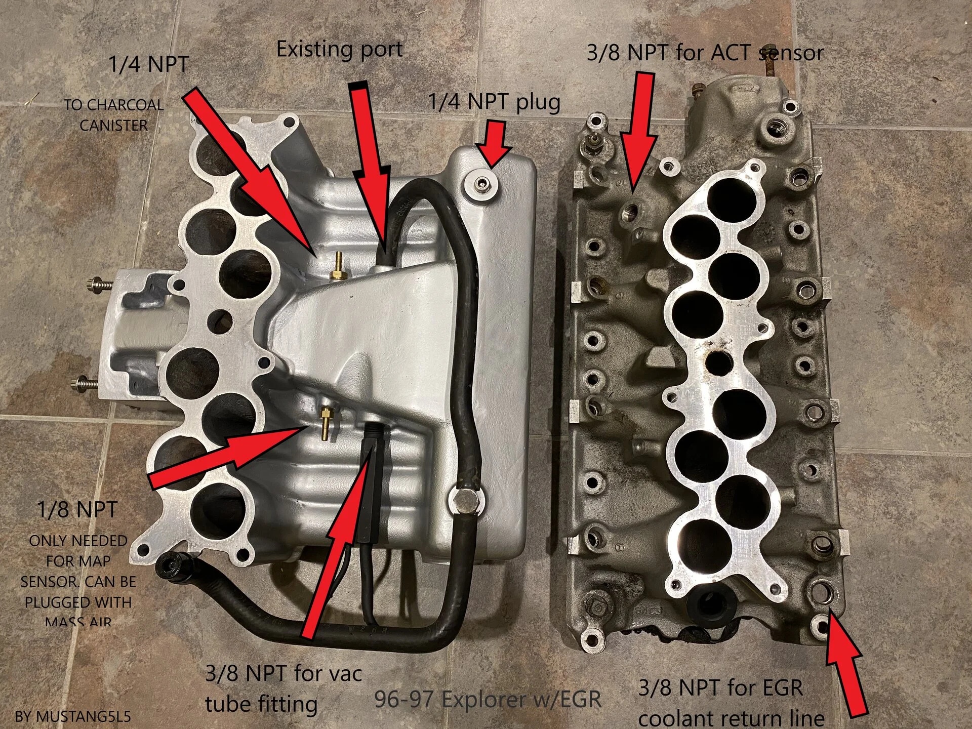

There is another slight difference. Early internal EGR intakes have a provision for the air charge temperature sensor in the #5 intake runner just like the standard 5.0 lower intake. This provision was eliminated on the non-EGR intakes.
