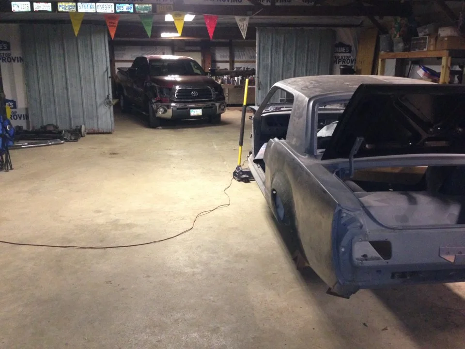

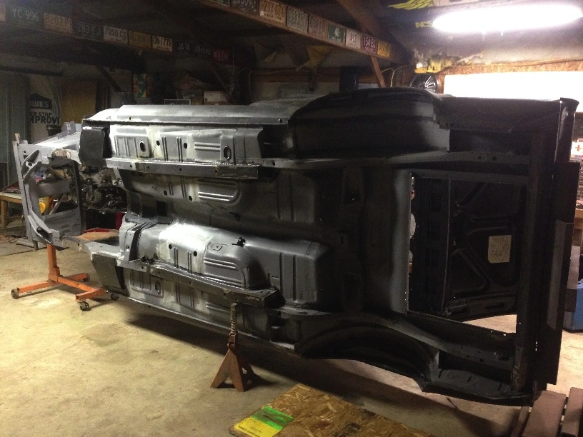

cant believe this thread is still here! Got the car to the new house and ended up rebuilding half of the 30x60 pole barn to get it usable for a shop. Just now getting back on the car but already making some progress. I got my AJE rear suspension before the move, but now im ditching the fox rear and bought a new 9" with fox body mounts to fit the aje rear setup. Also got some stainless headers, and finished welding up my wheel wells and have been rustproofing the car extensively with POR15 and inner panel sprays to keep the cancers away. Almost time to start laying some mud down and bed liner on the floors and under side. Keep ya posted from KY now.
