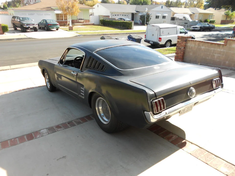

The black one is my pro street 65 fastback big block toploader tubbed for sale.. Make Offer asking 15k fast.
