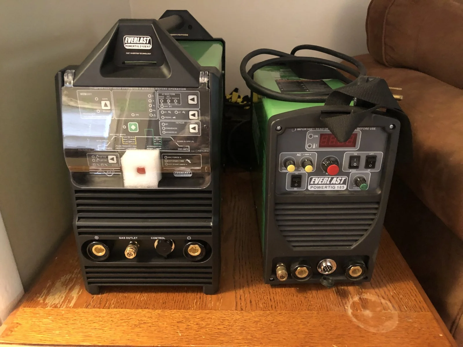

Here's my new welder with my brother's welder, all I can say is.......mine's bigger.

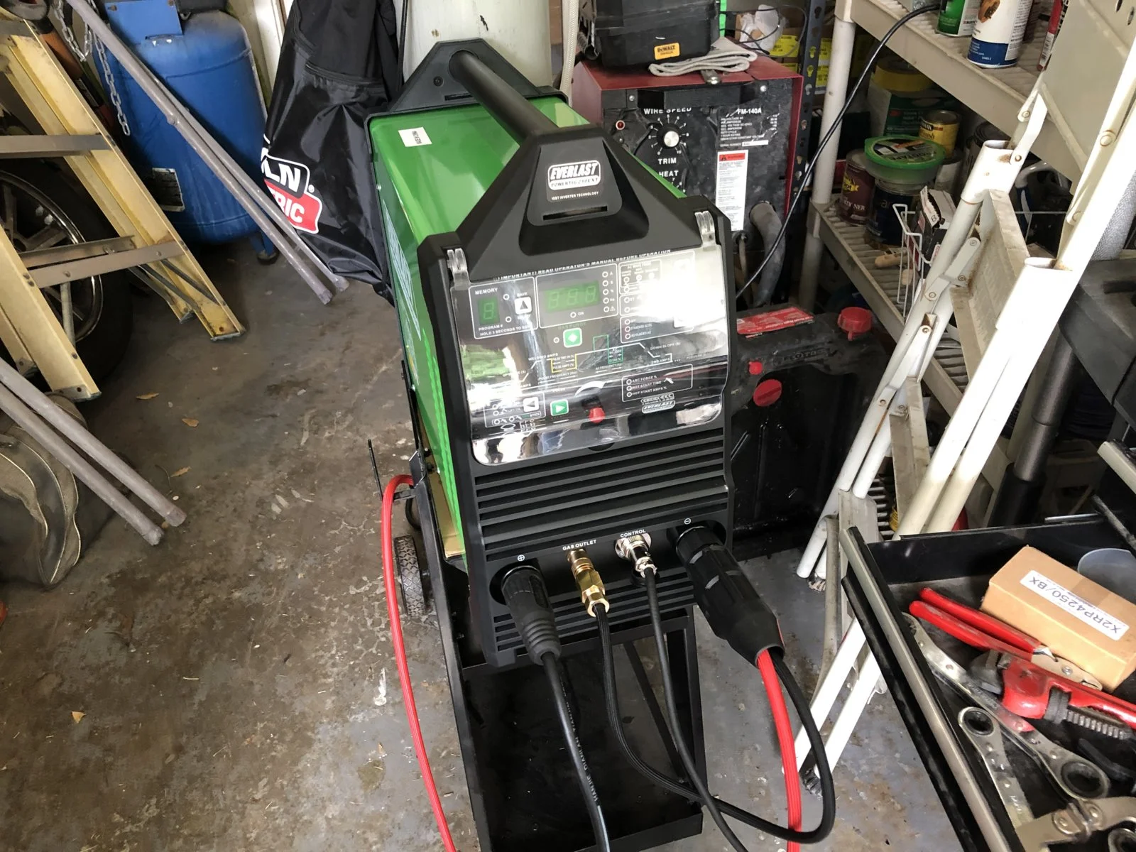

Here it is all connected. I bought my brother's argon cylinder from him for $150. He only wanted a hundred, but i felt like I would be taking advantage of him for that amount.

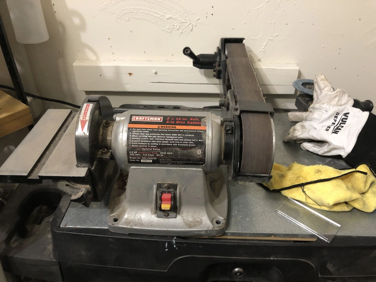

I also got my old belt sander that I used to make knives with for sharpening the tungstens. Best move ever! sharpens those bad boys right up in seconds.

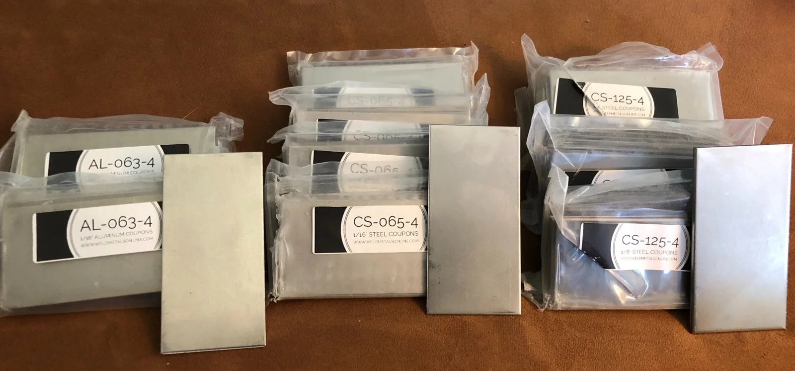

I found a place that sells welding coupons, so I ordered a crapload to use to practice.
