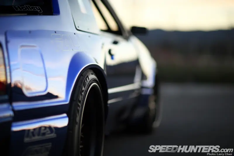

Dave, check out this thread where a guy on the other forum did flares made out of metal that I think would be the look you're going for... I'll volunteer to buy them for my car and you can come down here and practice installing them on mine... I won't even charge you for letting you learn how to do it.
https://forums.corral.net/forums/road-racing-auto-x/1968906-steel-fender-flares.html
And here's the ebay link to where to buy them.
http://rover.ebay.com/rover/1/711-5...0001&campid=5335821607&icep_item=162772048423
I don't want to extend the lip like that, rather bringing the whole quarter out. Again, similar to the maier flares.
My flares will be more like them than anything else except they will be sheetmetal and hopefully fabricated to look , if not necessarily stock, at least very professionally done.

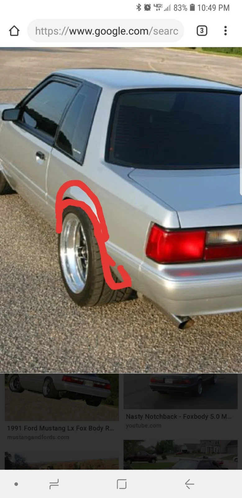

I don't know why no one had made a flare that went off of the actual wheel well line. It would be like the factory lip but stick out another couple inches. It would be bigger and instead of darting back to the body at the bottom it could run less of an angle. Then the body lines wouldn't change at all. The mouldings would even still work with just a little angle cut at the flare transition. No modification to the fuel filler hole....and a whole bunch less work.
Kinda like this....

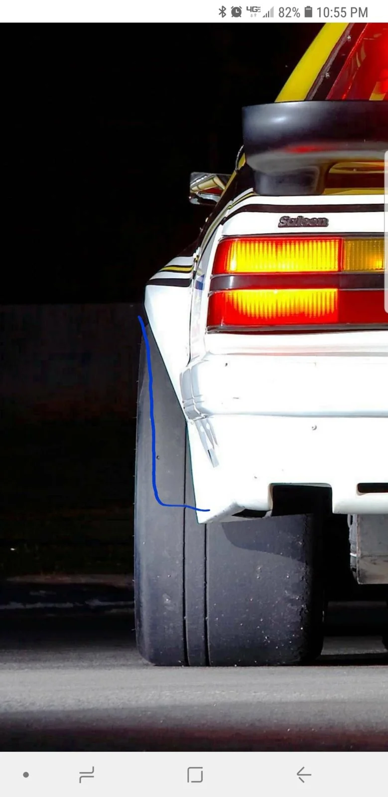

My biggest issue with flares is that they bump the whole quarter out which is unnecessary. They also cause the molding line to look stupid. The angle back to the body just looks bad to me. If you happen to roast the tires the rubber will be all the way up to the tail lights. That angle just looks bad to me.
Edit; my drawings suck on my phone. Wish I could relay what I'm trying to get at. You could raise the arch up about 1/2 to 3/4 inch. And then run the same angle as the factory coming from the top center out to the flared point above tire. Then follow the curve all the way around the wheel well with a less dramatic angle back to the body at the rocker. This would mean your split rocker would only need about 2- 3 inches modified. The same 3/4 inch edge would be retained in the new flare.
I think that way would look almost factory.

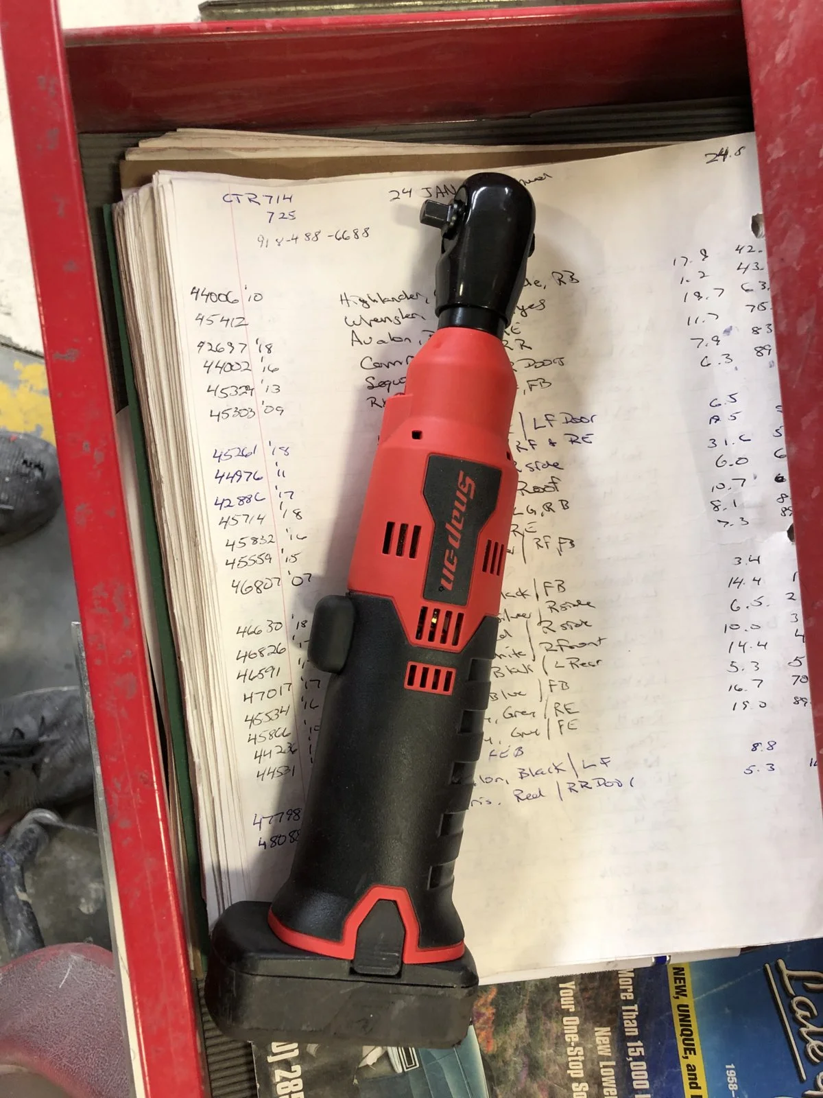

Well, the tool pimp came by today.
It’s a 1/4 cordless ratchet. The 14.4 volt batteries swap with the other six cordless tools I have.
