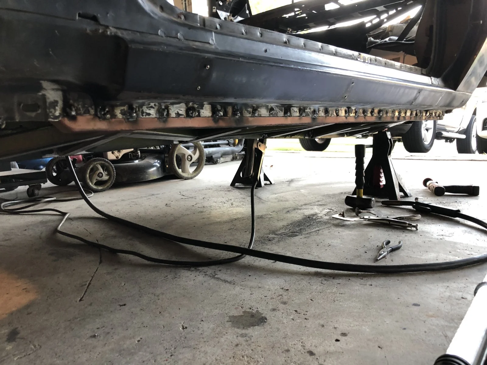

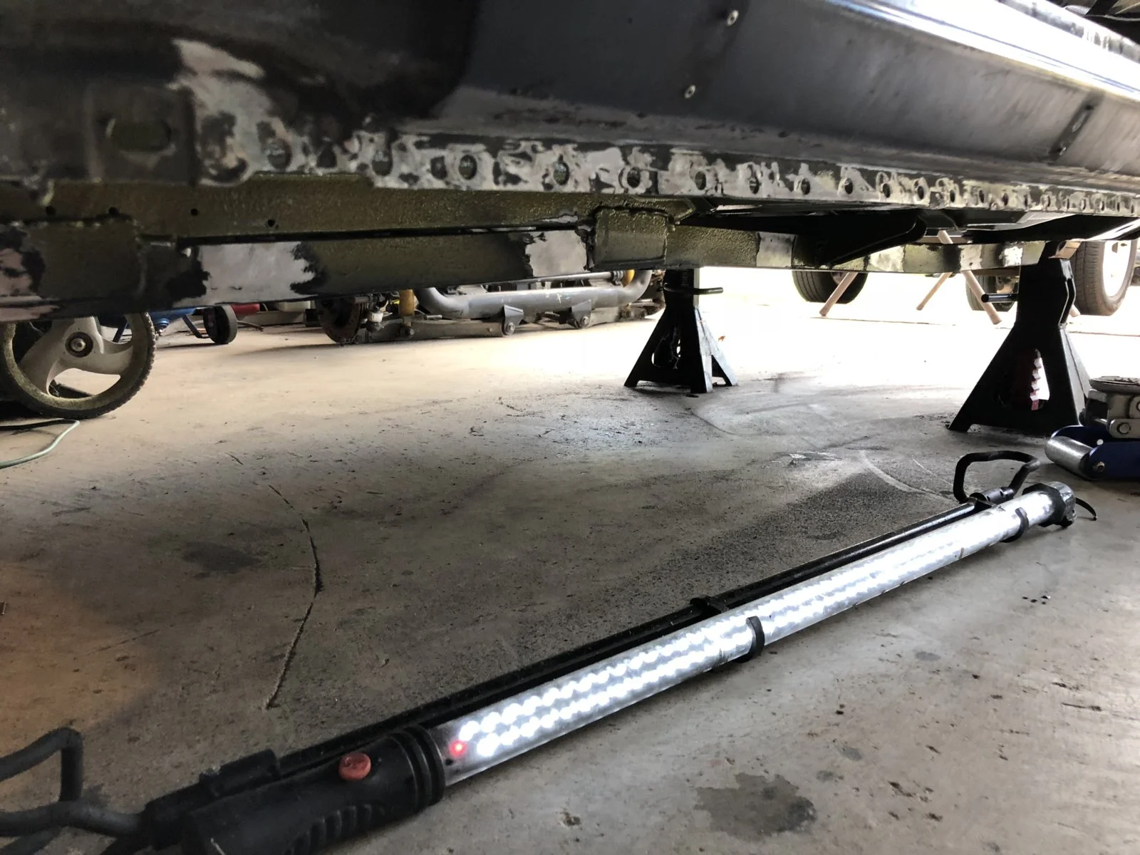

Exactly the same...volcanic blobs of molten steel dripping off, and exploding on the floor.....big fun was had by me let me tell you.I didn’t get much done tonight, I’m pretty tired after work.
I did the spot welds along the rocker.
These were very frustrating. There’s something between the layers of the inner an outer rocker. I’m not sure if it’s a seam sealer or what.
It didn’t matter how clean the metal was on the outside, I got lots of popping. I mean it’s welded solid now, just frustrating not to get a simple pretty rosette weld.
@CarMichael Angelo what was it like when you welded your pinch weld and jr?
Yeah, these welds will spend quality time with the grinder.Exactly the same...volcanic blobs of molten steel dripping off, and exploding on the floor.....big fun was had by me let me tell you.
I think you're right, I think there is some kinda fungoo in between the layers.
I riveted through that pinch weld on the red car,..but then I had that big stupid rivet gun back then,...it broke doing all of the rivets. But they look way better than the welds imo.
I was planning to smooth the pinch weld area anyhow, lol. Now I just have additional inspiration to do that.
Got to admit, that makes me feel a little better.I didn't rosette weld the pinch weld but I did stitch it. I had to spread the panels apart a little and clean them as best as I could with a drill mounted wire brush and then hammer them back together to get anything close to a good weld. Even then, it sucked.
I can't wait to start on the passenger side and put all I learned on this side into that.

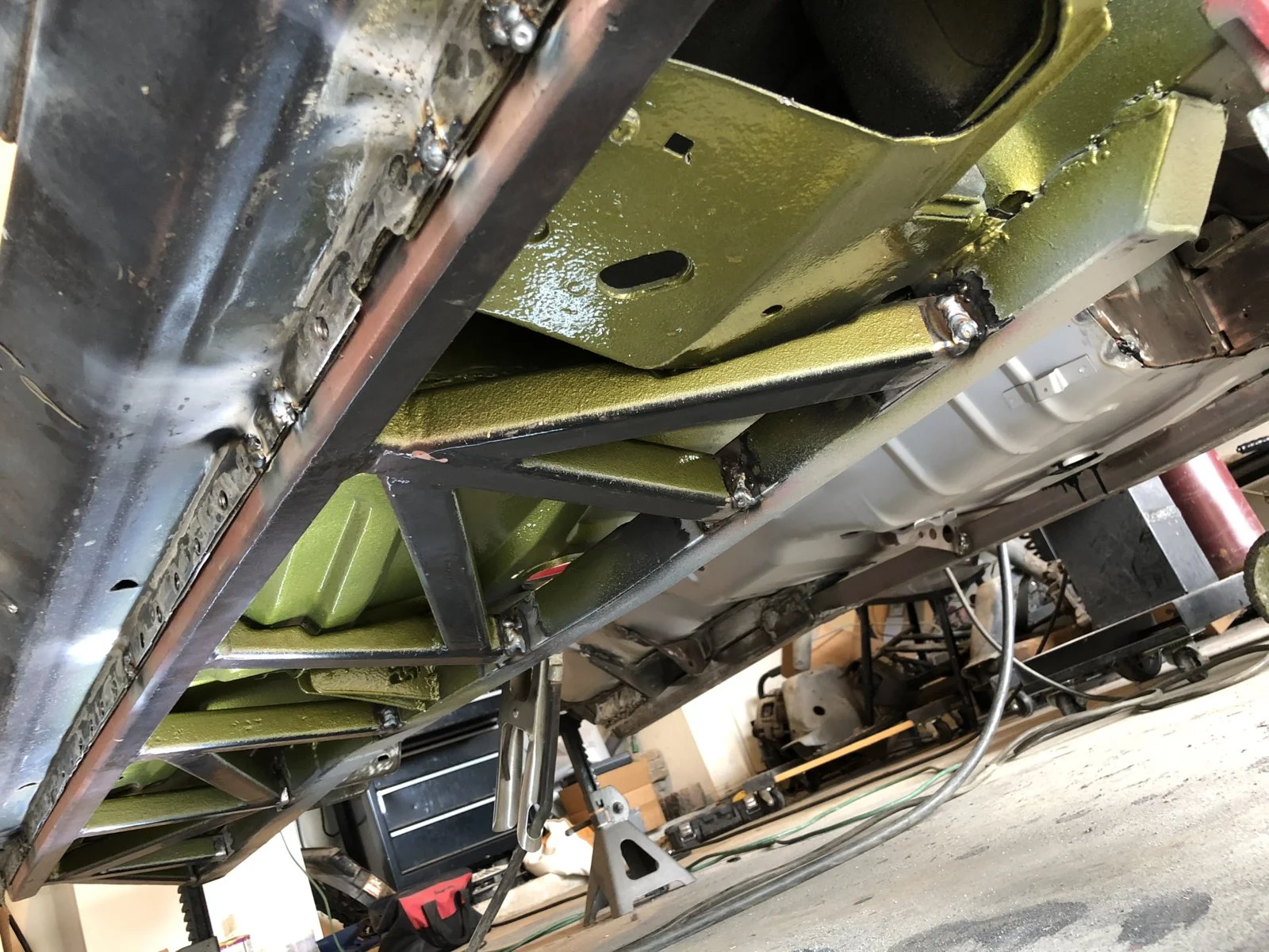

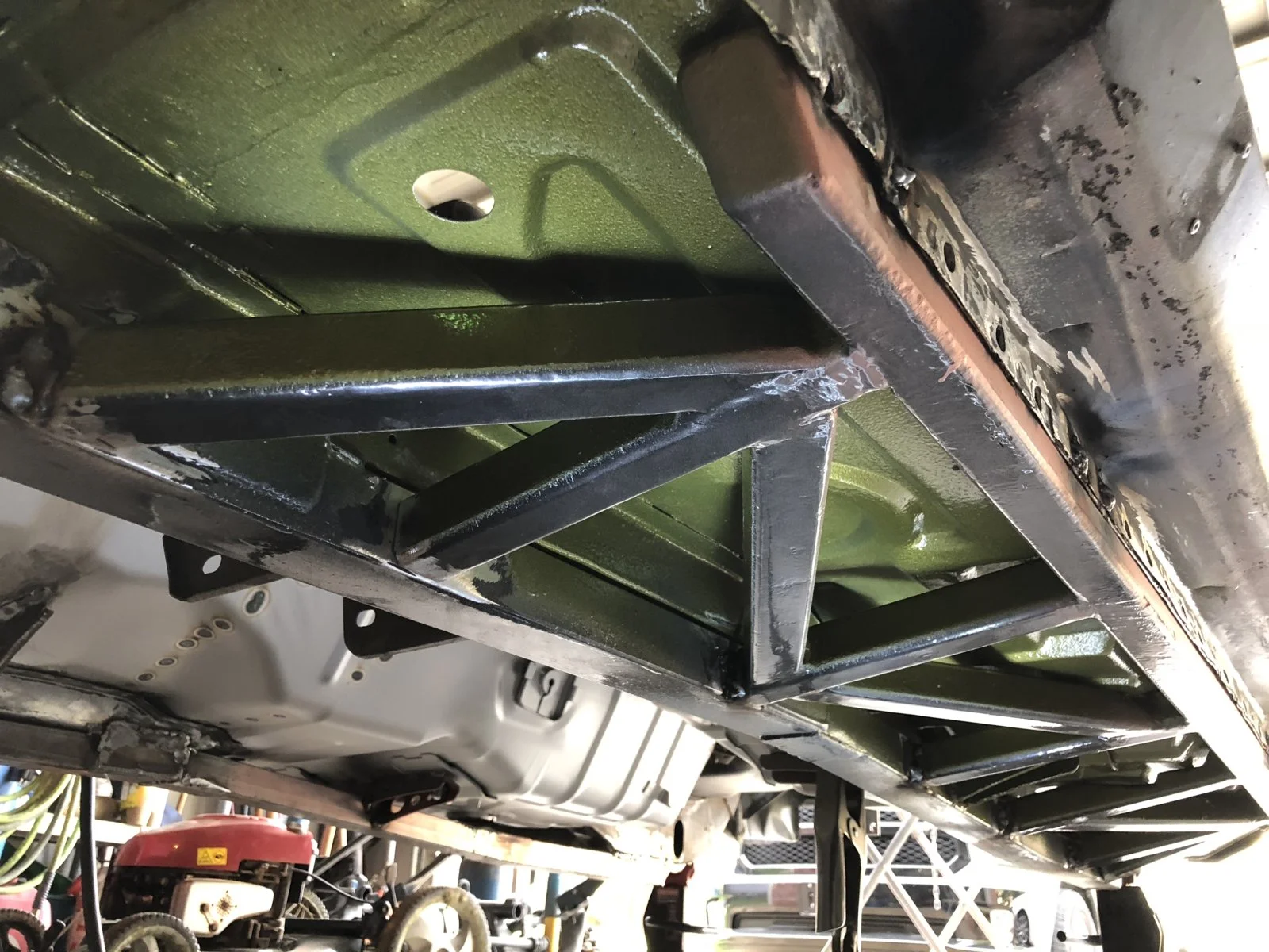

I'm still thinking of doing some stitch welding on the driver's side. The jr is welded right at the top corner of it along the pinch weld. Am I being overly paranoid?

I did mine differently in the grand scheme of things Dave, and far better than just relying on the splattery pinch weld to hold it in.Got to admit, that makes me feel a little better.
I probably could hit a few through the floor.I did mine differently in the grand scheme of things Dave, and far better than just relying on the splattery pinch weld to hold it in.
I also drilled several holes in the floor to let me weld it there too.
But my JRs were built angled up against the floor so that I could do that...I don't think yours are that way?
