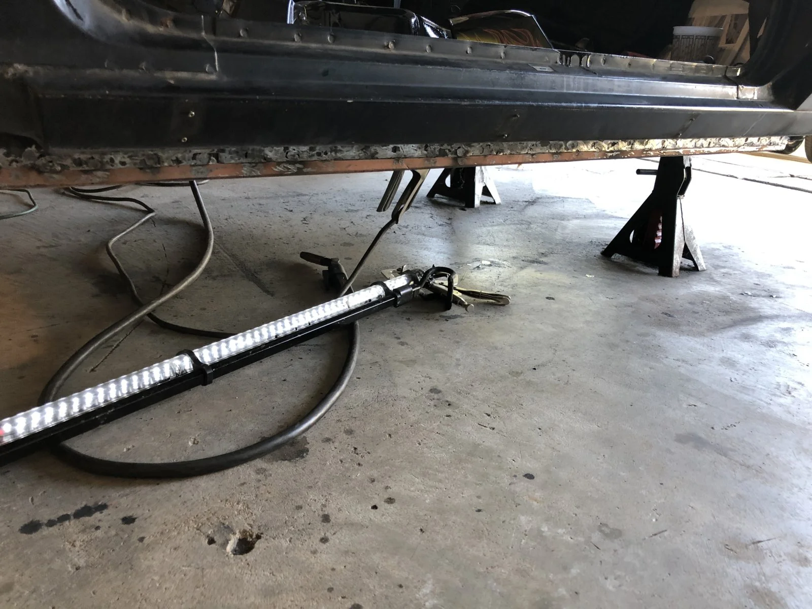

I probably could hit a few through the floor.
I’m going to attempt a set of 3 or 4” bead welds of sorts along the bottom of the pinch weld.

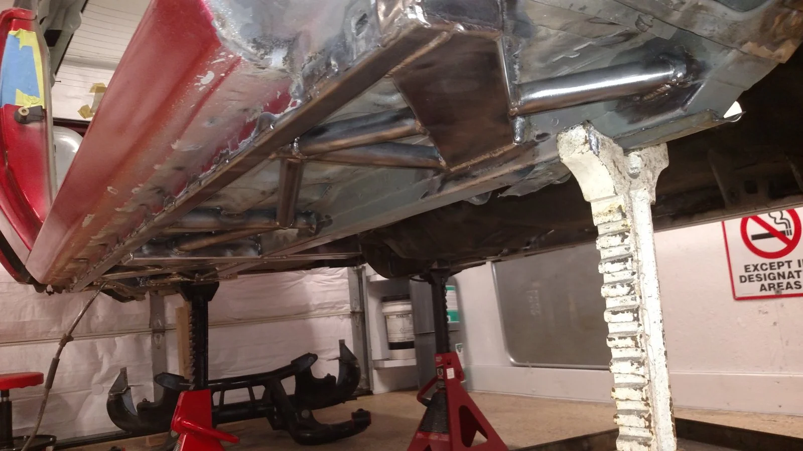

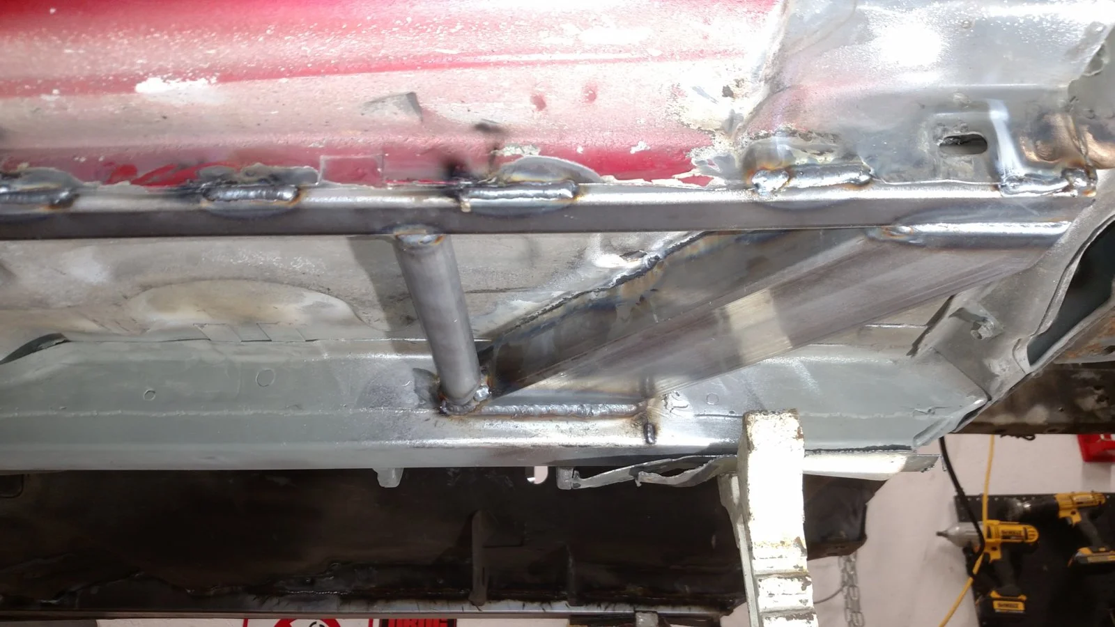

I saw a video of the installation of a Stifflers jr. They did overlapping spot welds. They said they didn’t want to do a bead weld because of the thin metal of the inner and outer rocker.........bs, they had the same issues we’ve had. They don’t say that though.

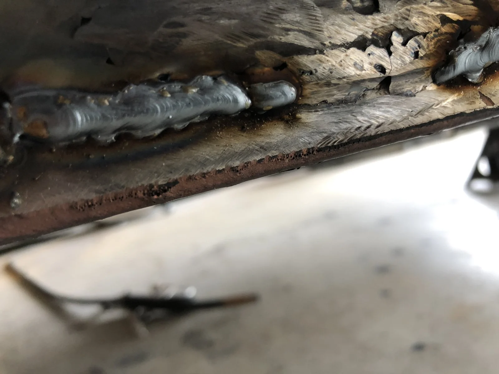

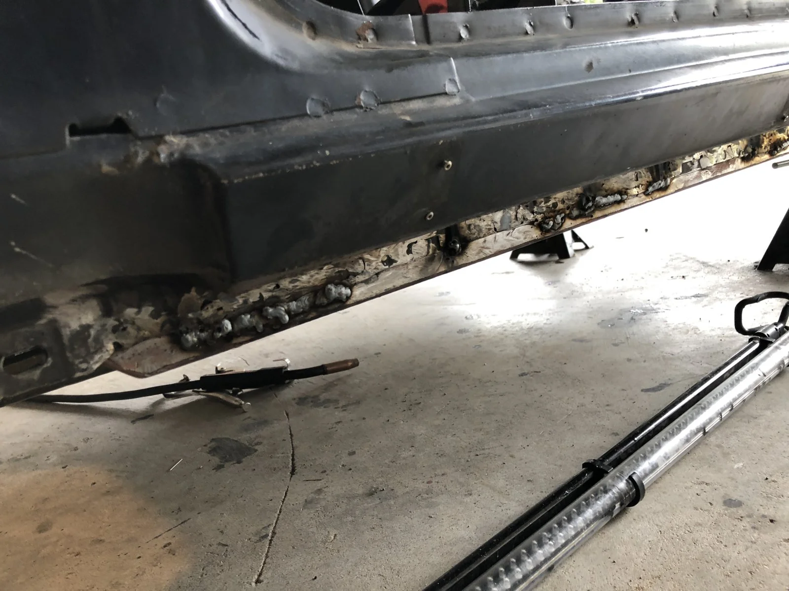

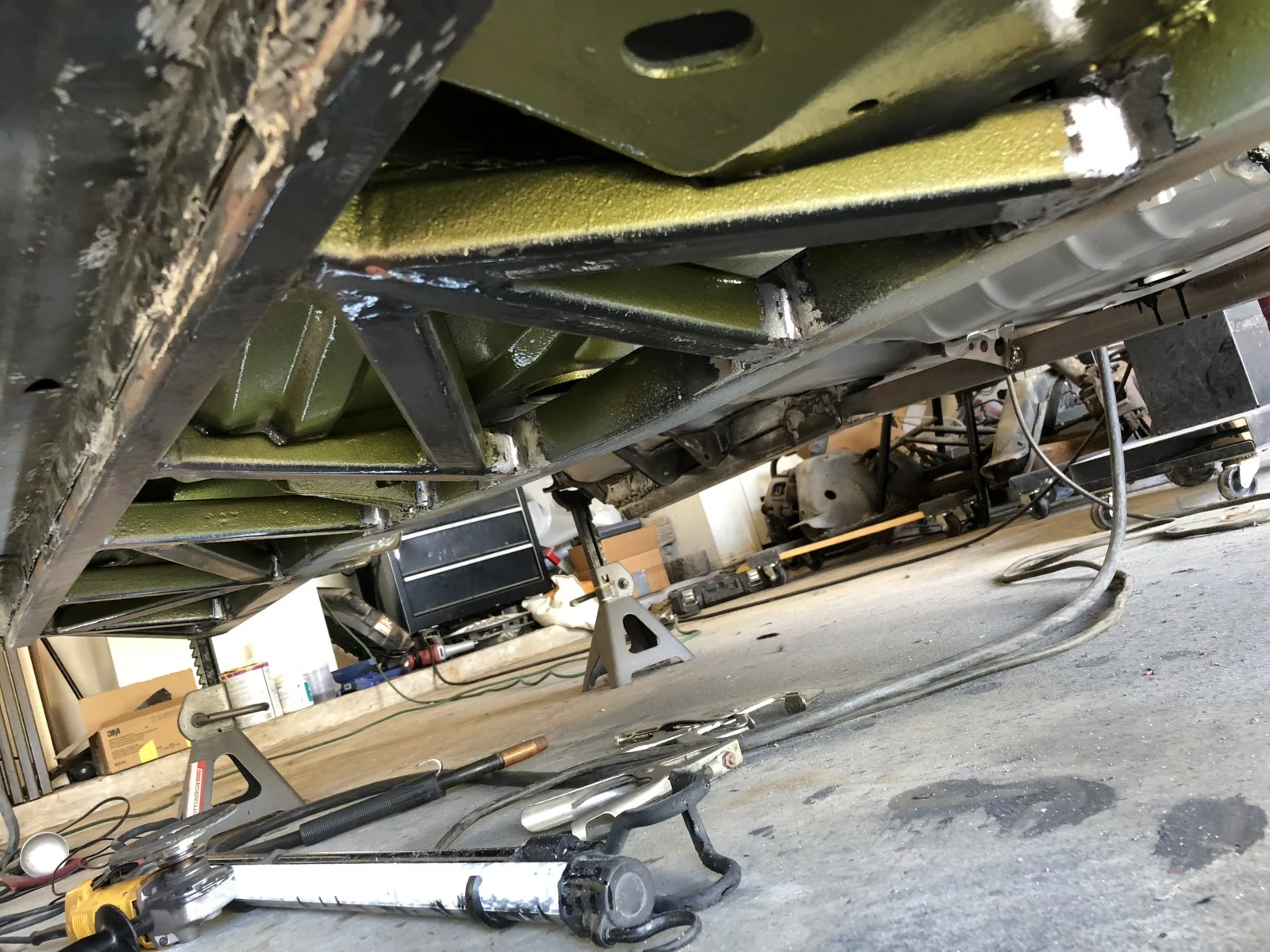

I agree with you there Dave, they just didn't want to go through the effort. It can be done, it's just a PITA. I was able to get an ok bead to penetrate all three layers on the pinch weld and into the rocker square tubing. I also stitch welded the inside of the rocker square tubing to the bottom of the floor pan at the same interval as the outside, and they are integrate and fully welded into the through the floor subframe outriggers.
A little hard to see in these pics, but proof it can be done. Not the prettiest weld, but solid.
Shut up with your "not the prettiest" crap!:fuss: That's what my very best welds look like!
Man, that's just beautiful sht there.

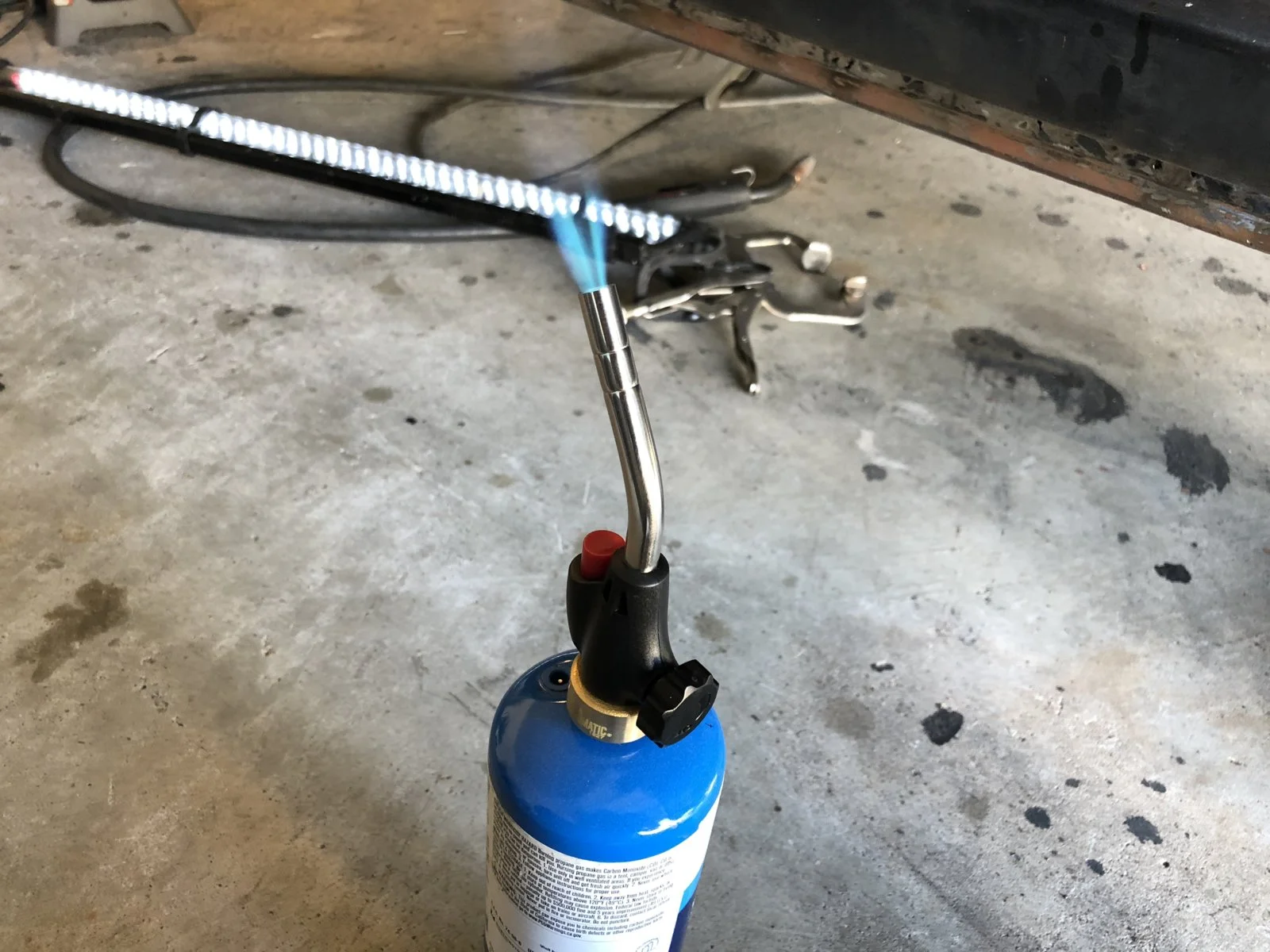

Here's what I was thinking, some garbage between the inner and outer rocker was outgassing when heated up by the welding.
What if that stuff had already been precooked? Bernzomatic to the rescue!
So I take that little blue flame and heated the next area to be welded. Smoke was coming out and I'm thinking, "Yeah baby". Surely we just have a dust between the two panels now, right?:scratch:
Ah no........so, screw it. I'm just going to give the old overlapping spot welds a try. And it's a popcorn fest still! DAAAAAAMMMMMMIIIIIITTTTT!

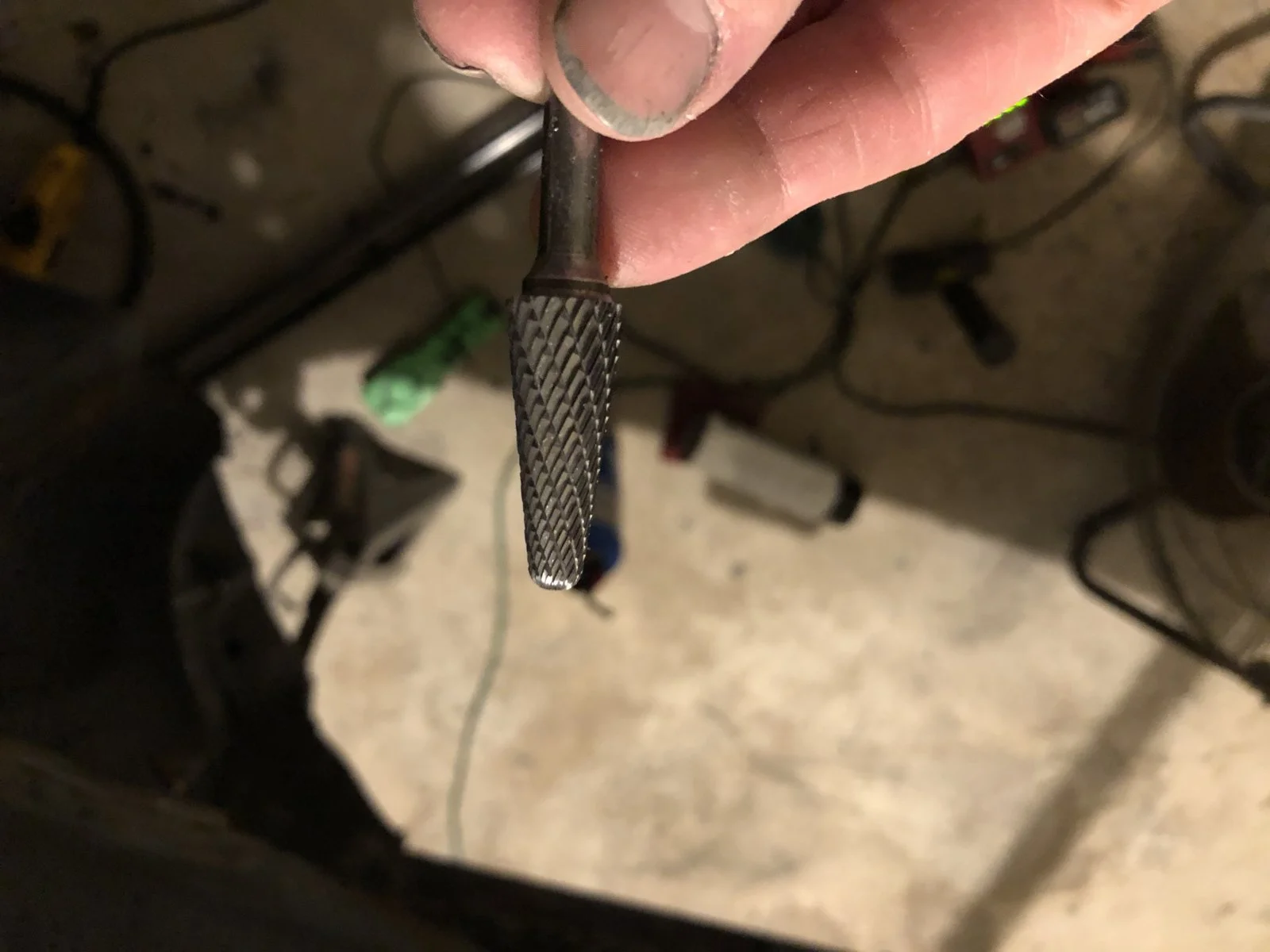

I've been borrowing other guys carbide tips for cleaning welds in tight areas. I haven't wanted to pony up the cash for my own. Today I went crazy.
That little bit cost $69 with tax. It's mine though!

Not today though, I tested out the new carbide burr.
It cuts AMAZINGLY well. I've apparently been borrowing worn out bits. I'm so filled with tiny bits of metal all over my body right now. Ouch is my most used word right now.

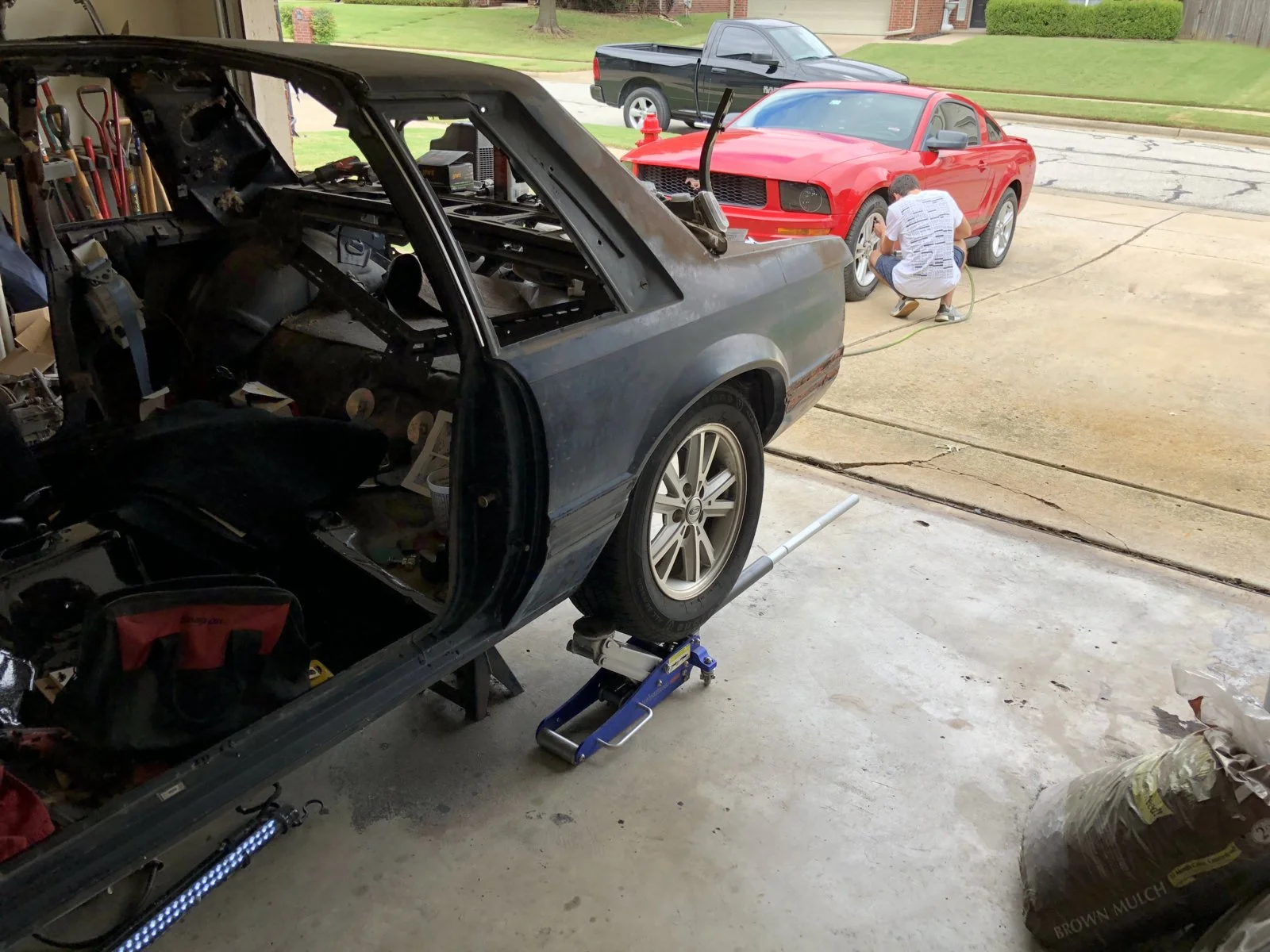

My son and I swapped out his wheels on his mustang today. That gives me my five lug rollers.
I stuck one up under the quarter to see how it would look. (BTW, that's the boy in the background airing up his new tires).

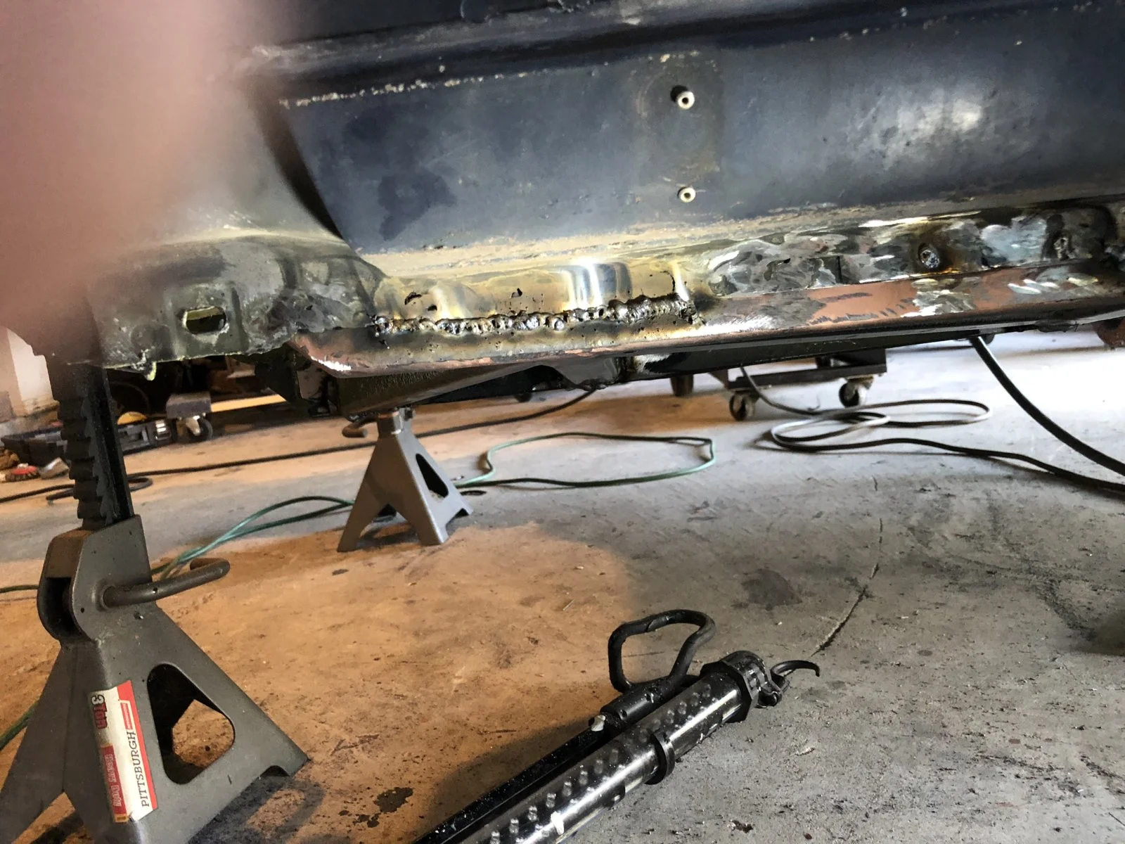

I’m finished welding the driver’s side.
This is my last weld for this side. I’m finally getting the hang of it. In theory, the other side should be just beautiful, lol.
