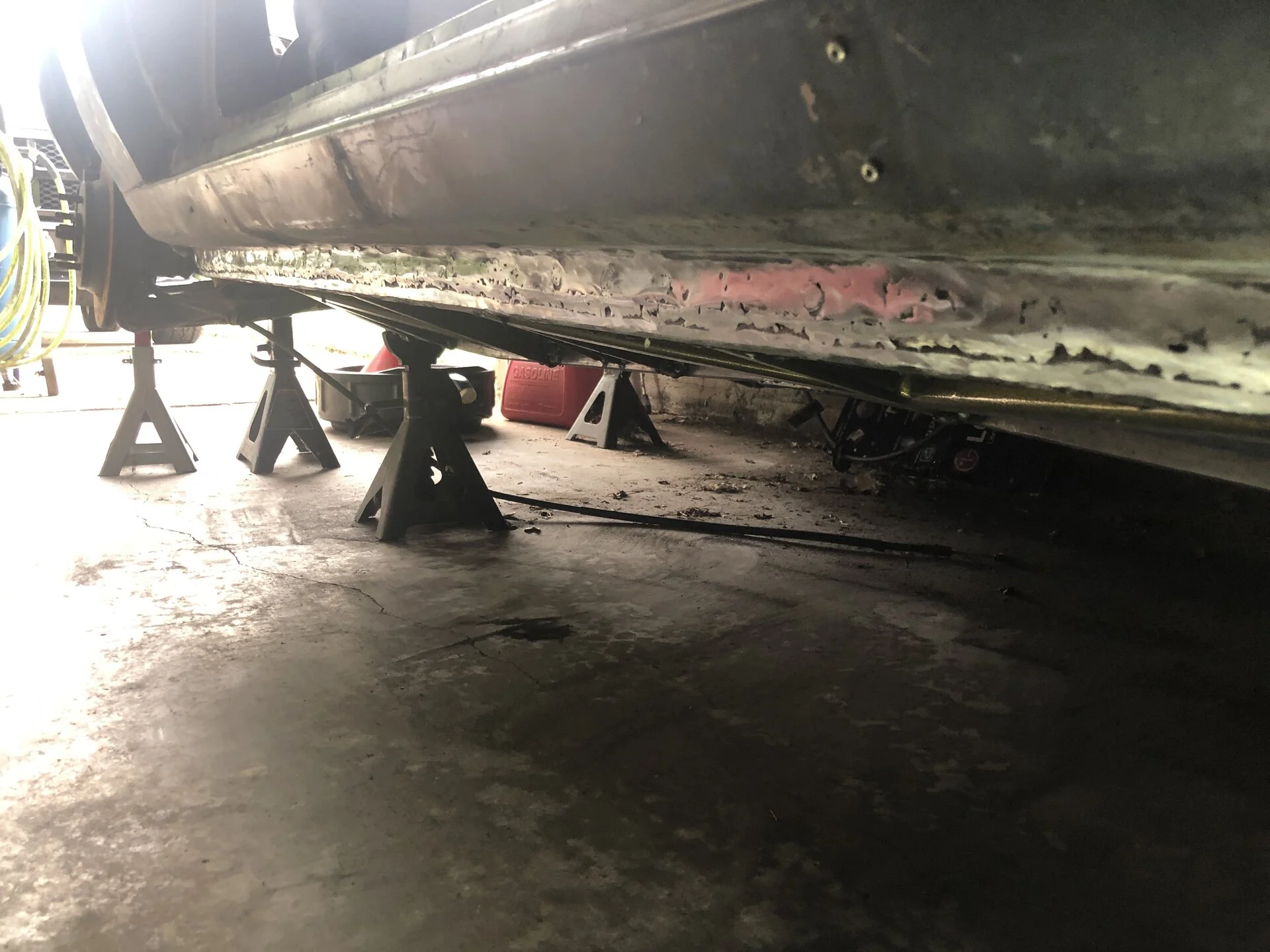

No reinforcements for the IRS other than a hard tail. It’s the upper mount for the sra that I’ll be removing and replacing with a tube support.

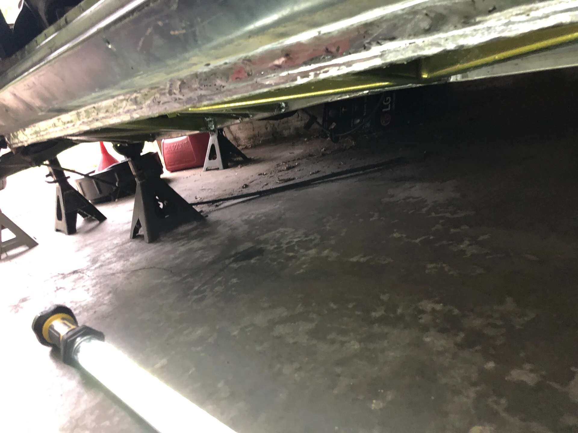

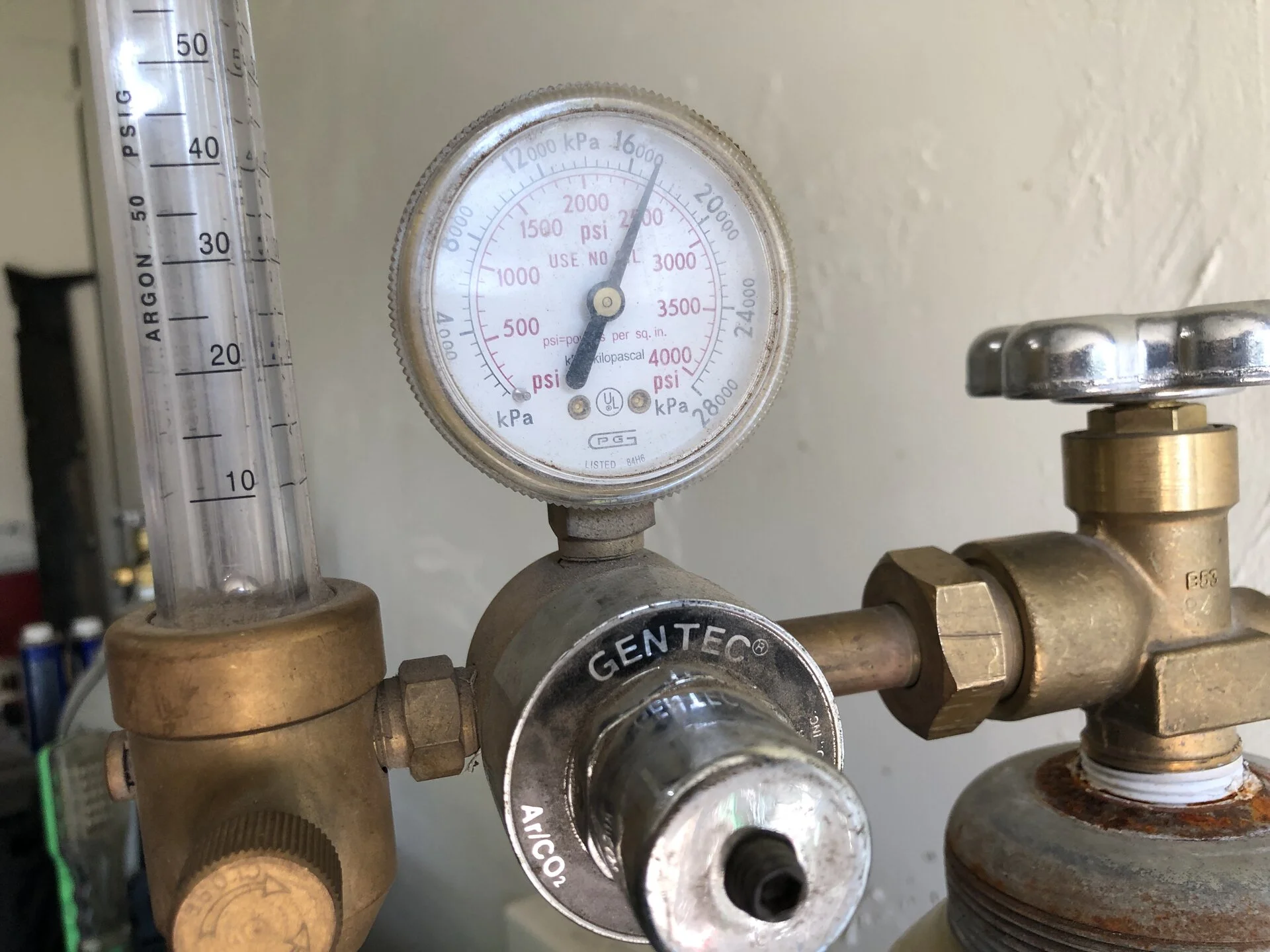

In the mean time I got a nice full 80lb bottle of argon hooked up.
Just doing the final preparations prior to getting after it now.
I would like to finish the welding part tonight. Then clean up starts tomorrow night. (that’s code for grinding)

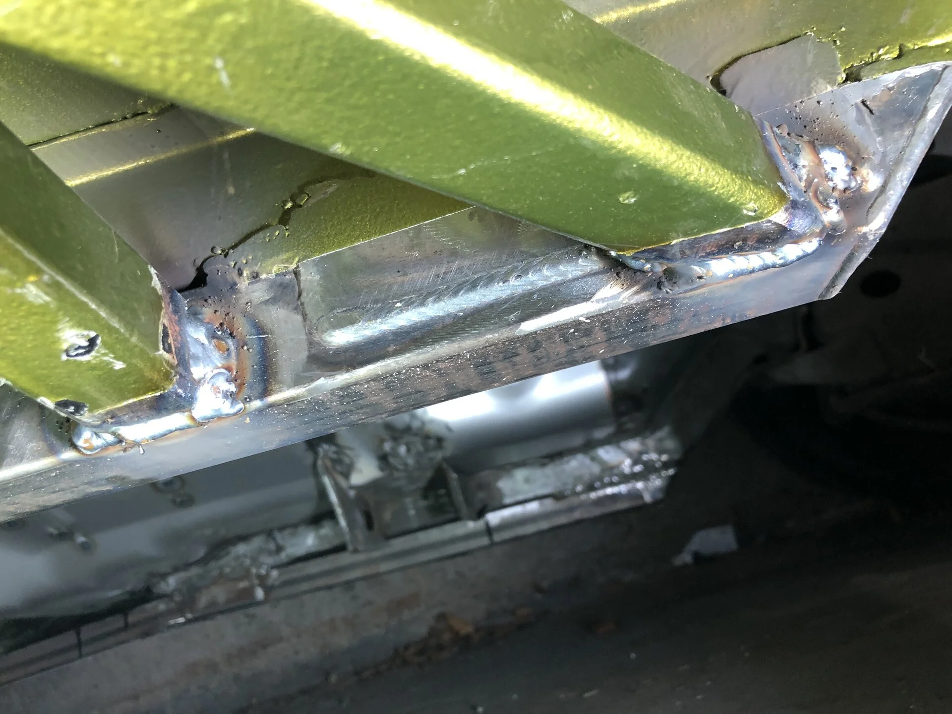

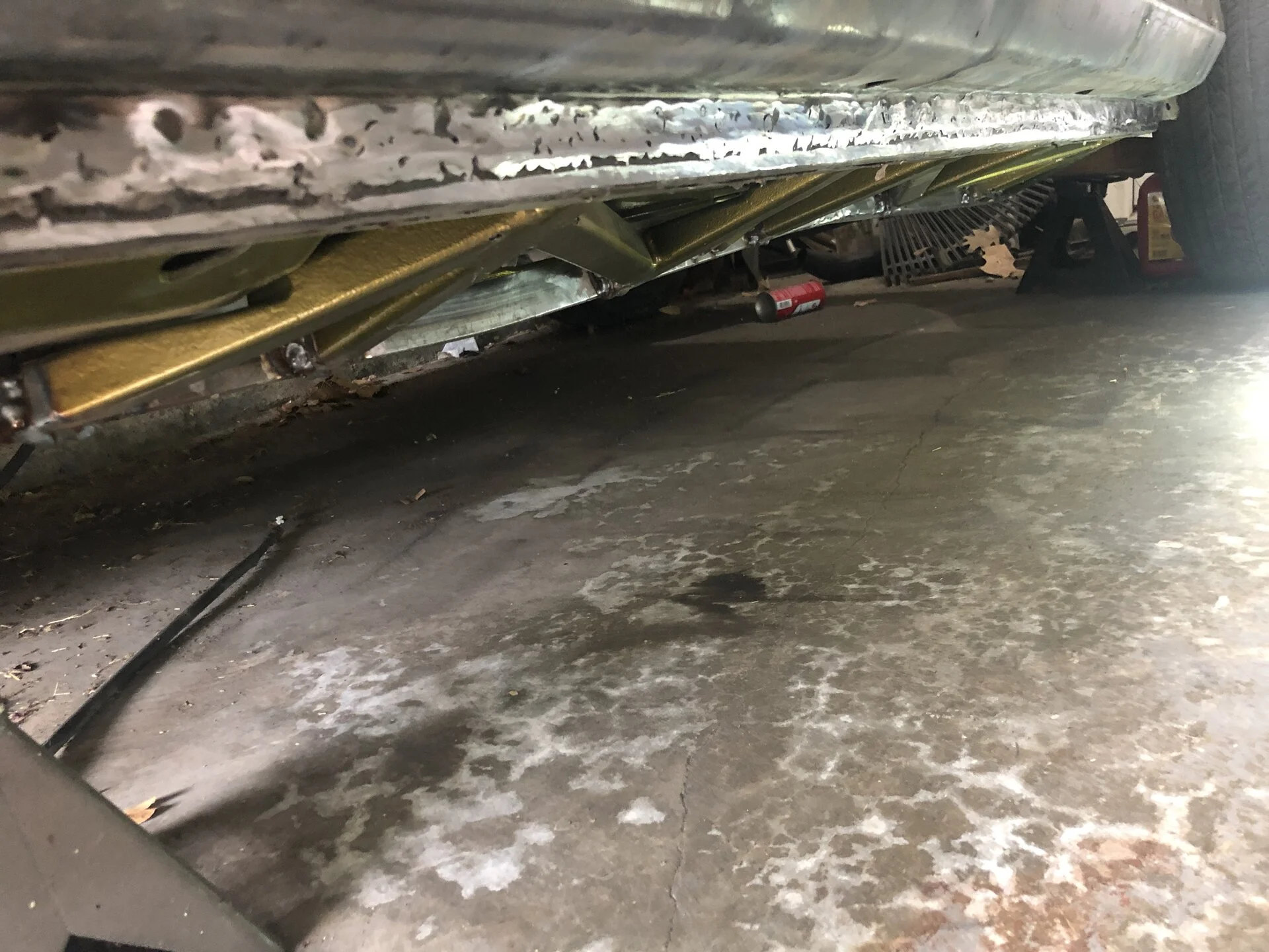

Soooo, It’s fully welded in. Some welds were easy and turned out decent
and then there’s the pinch weld:nonono:.
I knew going in it would be a pita and I wasn’t disappointed. I went along the bottom of the seam and placed tack welds down the entire edge of the seam. Like 18 bagillion spot welds. I figured this would stop the crap from coming out of the seam and make for maybe a prettier weld. As usual, I figured wrong. I persevered and did the whole seam though. It’s ugly as hell, but it can be ground down nice and pretty fairly easy
Once I dress those welds I’ll be able to see areas that might need some touch up welds.
It’s disappointing in a way not being able to figure this pinch weld area out. But it’s great to have it over with.

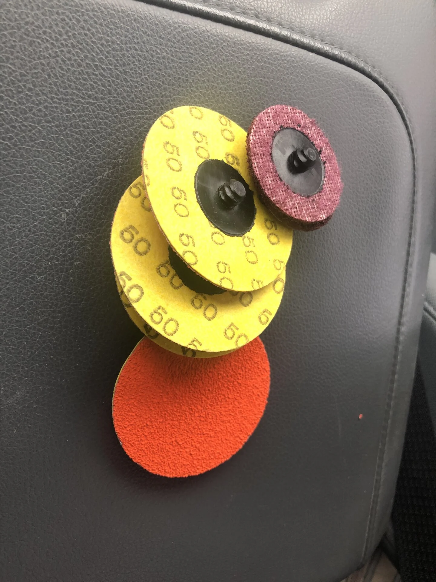

Look what I picked up at the shop today!:taco:
That’s right baby, Davey’s got some hot plans for the night! Chill the Dirty Bastard and open up that garage door!
I’m going to get on my back and Booger and I are going to do the nasty! :O_o:
That’s right y’all, grinding welds tonight, woohoo!
  • Hell Yeah!
My first thought at seeing the picture was of stick on EKG electrodes. I hope your stress level has gone down enough not to need those!

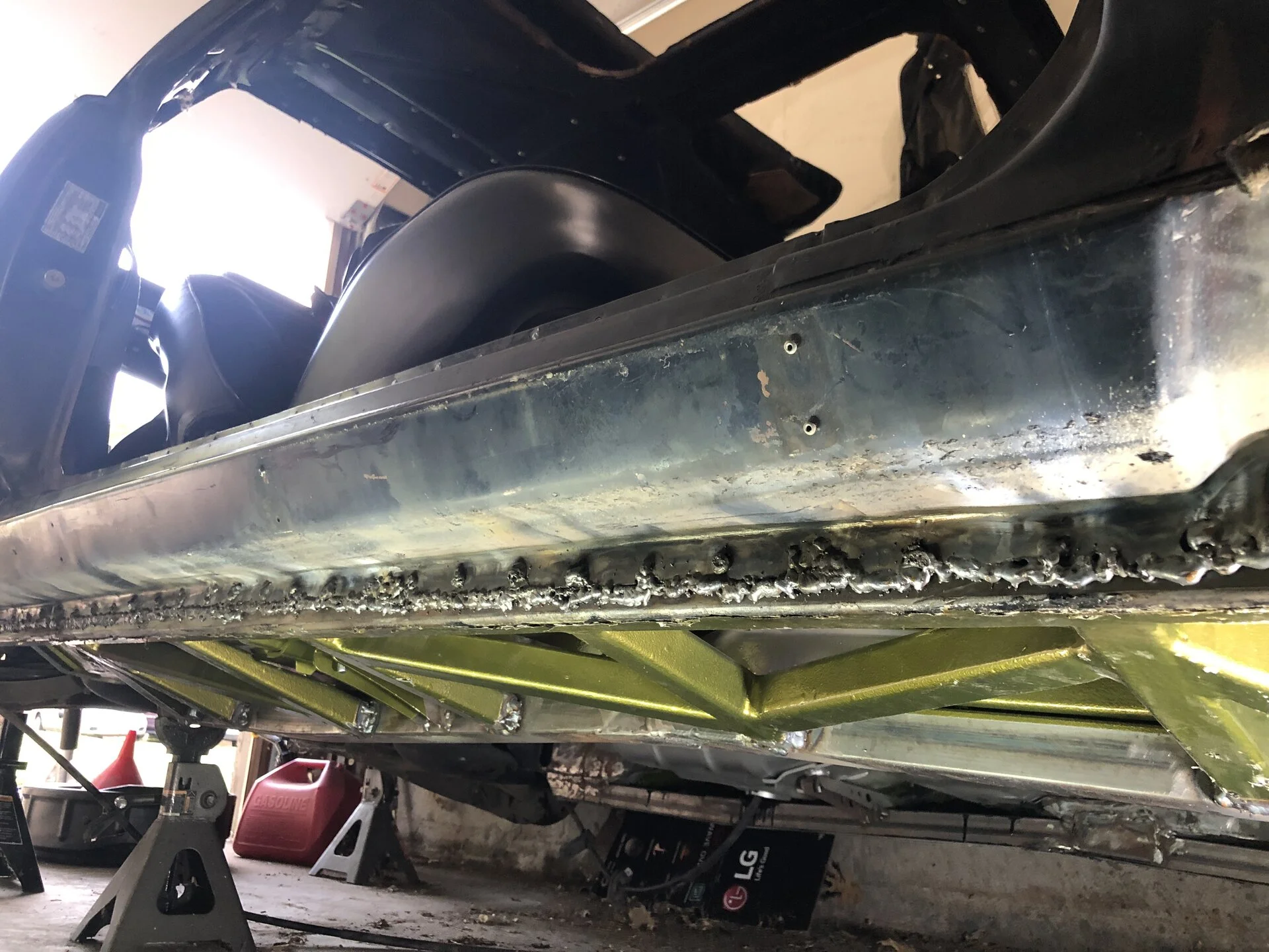

Ok, all I got done tonight was the pinch weld area. This much just about had me worn down to the nub.
It still needs some evening out with a grinder wheel. That’ll be tomorrow night.
It needs about another fifteen minutes of work. All this will be smoothed when I get to the bodywork stage on the body. Tomorrow I’ll get all the welds on the sfc side smoothed as well as the finishing of the pinch weld area.

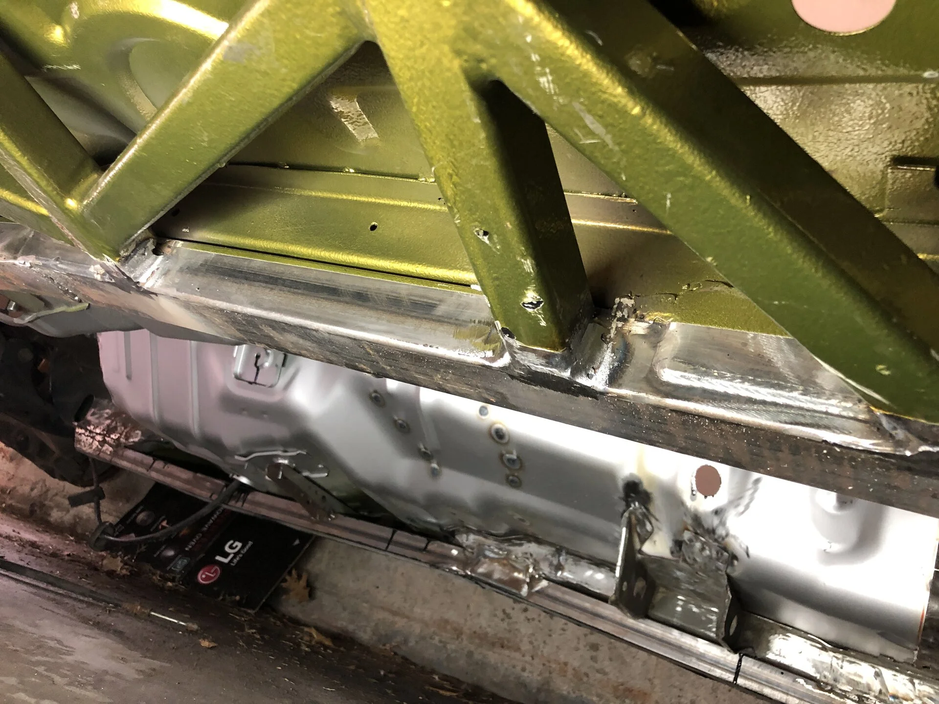

So, super genius here woke up with an idea.....it kind of worked.
So this puts me somewhere slightly above idiot and quite a ways below genius. Definitely not moron though.
I would have hit genius had I done this idea prior to ever dressing the welds in the first place. So, the idea is to measure down 1” below the top edge of the pinch weld and run a piece of 3/4” tape along the seam and grind a hard line all the way down the seam (The reason for 1” is that it allows for about 1/8” of weld below the actual pinch seam). Make it where you can still see the separate connecting pieces, the pinch weld and the support. I would love for it to be smooth metal the whole way down, but reality of welding the seam and getting clean welds isn‘t possible for me. Plus this side’s pinch seam was hammered crap when I got it out of the SY.
So pictures. First one, before super brain came along.
Next with the line ground along the seam. Keep in mind this would be more visible had I started this before having done the initial grind. It doesn’t look real straight, but that’s mostly an optical illusion due to the different slants of the weld. The seam area will easily cover with a thin layer of mud and look uber cool.
I got a bit into the sfc side. That was fun. It cuts fairly easy, it’s just that the carbide bit leaves :poo: ton loads of little super duper sharp shards of metal. I had to stop because I didn’t have back up charged batteries...... :nonono: damned nube.
So, the lessons learned from this side will be put to use someday when I go back to the other side. I still need to finish the pinch weld area on that side.
This means I’ll still be grinding tomorrow. NBD though. Even if it took into saturday morning, I’d still have lots of time to change up how the car is setting and get the IRS out.
