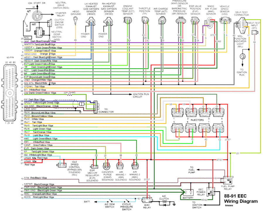

For some reason I have no voltage on my fuel pump wire... I don't have a wire schematic for this, but I did trace it up to under the dash (pink/black wire). I know you should be able to turn the key and see voltage for a few seconds (priming the pump). I wasn't sure if there is a relay or anything that may have gone bad... I checked the fuse panel and there aren't any fuses for it. Any help is much appreciated!!

Okay...a little update.. I have no switched 12v power. I have checked everything (per the schematic), and no 12v where it should be. I do have 12v on the orange/lt.blue wire going to the fuel pump relay. Now I'm trying to trace out and see where the switched 12v originates and go from there. I am getting a partial ground (45 ohm) on the pink /blk wire before it gets to the fuel pump relay (even with relay out of harness). I hope my computer isn't trashed... I did see bare wire on the WAC relay...one being the power and another being the one going to the a/c clutch, which is a ground. Although, when checking that ground..I didn't see a ground with my meter...

Do you have power comeing from the inertia switch?
The diagram show the ground should be on the PK/BK wire.
There should be two hot wires going in to the fuel pump relay and one ground and one neutral.
I believe the Orange/ lt blue and PK/BK should be out with the key on. I will go out and check my car first thing in the morning.

No, I don't have any power a the inertia switch.... And I checked most of the other places that I should have it as well (MAF, injectors, fuel pump relay, WAC relay, etc). I just don't see a source per the schematic that would cause this...but I know there has to be!

check all of your fuseable link at the started senoid.

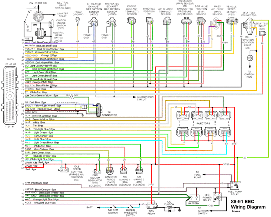

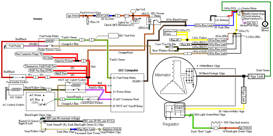

Look at the diagram JRichker posted again (middle top and top right).
Look at one of the others he provided a link to as well (bottom right corner):
Good luck.

Yeah, I guess I was pretty tired last night.... What I was looking for is found in the top schematic (what comes off of the solenoid). The bottom one I had already gone through, but it's the info showing the solenoid that was needed. Thanks guys...I'll let you know what I find when I get off from work today.

I have POWA!!!!!! Okay, just a little advice....don't mistake a dark blue power wire for a ground!! I relocated my wires from inside the engine bay to inside the fender about a year ago (yes, this has been one of those projects that you work on for a few weeks and then it sits, work on it a bit and it sit, etc.). Well, apparently when I screwed down the grounds, I thought this was a ground. The 20 gauge dark blue with years of grime on it definitely looked black....then I saw the fuse link! Anyway, thanks a lot guys for the schematics (I've printed them!) and all of the help!! It's so nice to turn the key and hear my fuel pumps prime!!
