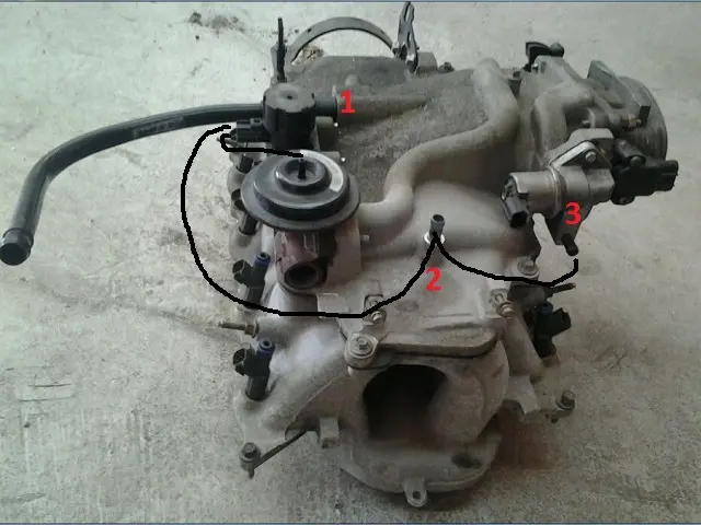

Locksmith charged me 30 because he couldn't get it going and the friend who sold me the roller put me in touch with original owner. He says the theft light has always been on and the car worked fine. Told me the PATS was turned off in his tune. I was also missing the plug to the crank case sensor and he told me I wouldn't get spark if that wasn't plugged in (Im so new to mods). Plugged it in and the car wants to start up now I just need to make an EGR delete plate and run the vacuum. By any chance does anyone have a diagram for the vacuum hoses for an 04 mach 1? I believe the car will start now but will probably run rich due to the tune from previous owner.
This is really the only thing I saw on the internet for vacuum on a mach 1 not sure if this is right but its all I have to go by.

Mocked up the vacuum and blocked off the egr. Car started but wouldn’t stay on unless I hold the gas. I still need to get the valve cover lines. So maybe that will fix it and possibly a tune.
