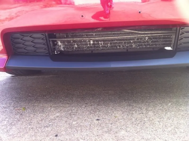

I like the lower opening on the grill of my CS, but hate that it shows my ugly ass radiator. Anybody paint their's black? AM makes a grill insert for that hole, but I hate that it hides the depth.

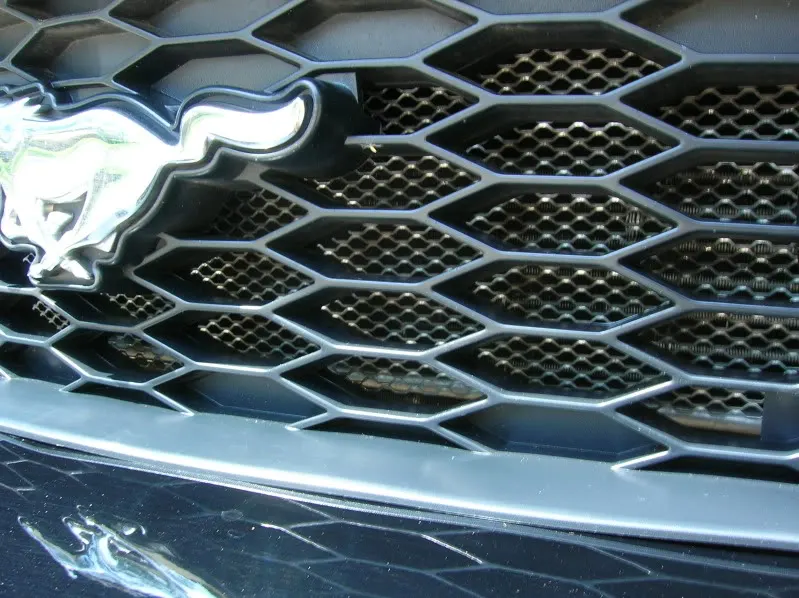

I added an inner screen, left it unpainted but you could paint it black.
It protects the radiator from rock hits and hides its uglyness.
Did the bottem opening too.

That's probably your A/C condenser not the radiator. I don't see why you couldn't lightly paint the bottom half a flat black. That shouldn't affect the heat transfer that much.

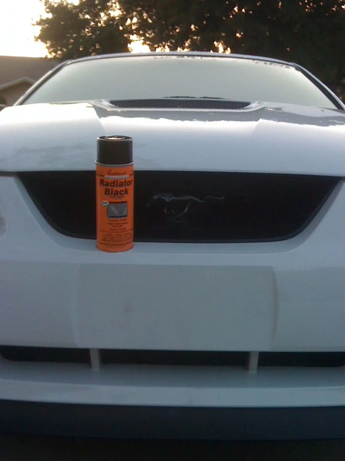

How about a third opinion.
Eastwood Radiator Black Paint - Detail Paints - Paints

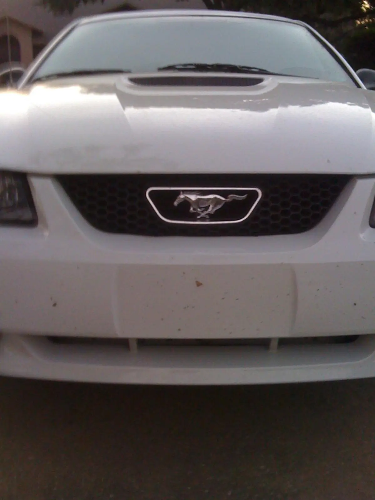

What he said, here is my B4 and after Mach1 grill delete install:
Note-engine did run a little hotter, have no data to back that up, but did notice fan running alot more, the key is very light coats.
And there it is, a paint that is designed not to affect the heat transfer. It still will (any coating will) but that paint it says is designed to help keep heat transfer up. I wouldn't do too many coats, or too thick of a coat lol.
