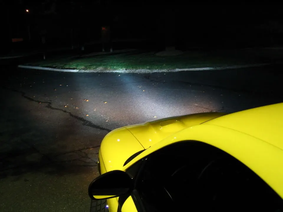

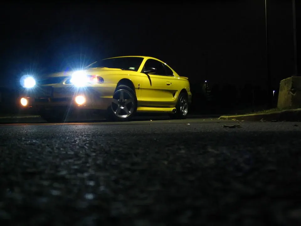

chris 95pgttech's cobra
6k hid in that housing.
