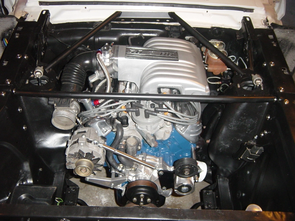

i use this one from moroso: http://store.summitracing.com/partdetail.asp?part=MOR-63810&autoview=sku
you can mount it driver or pass side, high or low.
here's a pic of it installed on my engine: http://home.neo.rr.com/turbo68/eng/P1010032.JPG
