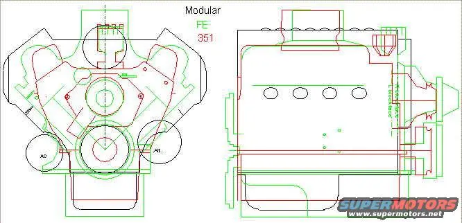

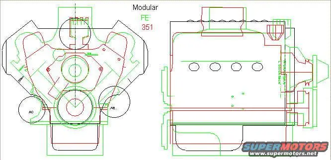

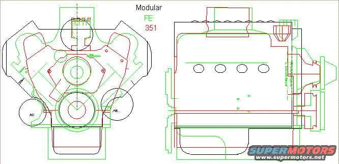

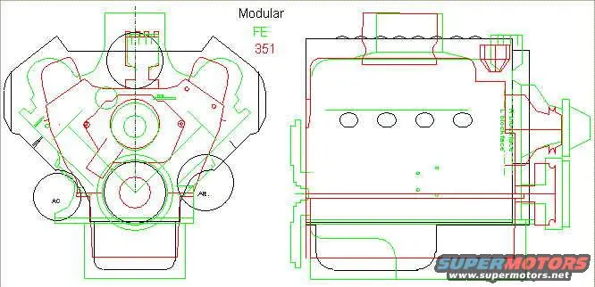

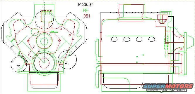

SO ask yourself, is the DOHC 4.6, which is physically larger than a BBF, technically a big block? LOL!
That's exactly my point. It's just as big as many big blocks but is only 281 cubes. I'm not familiar with the physical size of some of these 6+ liter engines out these days but I would assume they're not much bigger than a mod motor.
