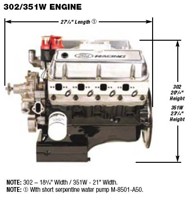

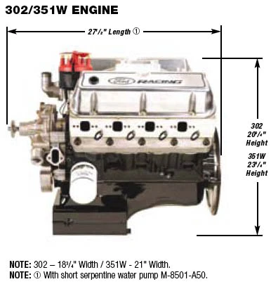

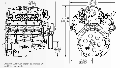

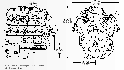

Shaolin Crane said:
Like i said, cant change design, the lswon sits further back, lower in the bay and all displacement engines are the same size. The crank is completely in the block as opposed to the sbf, ive already been through this with Nik, the sbf cant touch that. And thats why its better in MY car then a sbf. And you cant say im cheating or cutting corners or being lazy, i have 2 pretty badass engines on stands here.
Shaolin Crane said:
its alot more then 50lbs, and even so, 50lbs off the front suspension is a HUGE difference. Like ive been saying its the best application for MY car, i just its true for ALL cars so to ruffle some feathers. It works too, ive gotten angry texts from just around 2am LOL
Haha, we did just go through this, I thought we decided that the LS does not actually sit further back (reference pictures from page 4 of this thread). Also, as I said earlier in this thread, the aluminum LS1 block is about 120lbs, the iron W is about 170. Hence, 50lbs difference. With aluminum heads/intake and the rotating assembly of your choice in either engine, I would have to imagine that the end result is still going to be near 50 lbs difference (especially if you go with a carb-style EFI intake on the W).
Hey, lookie what I found on the Google machine:
So, after looking at those pictures, I'm beginning to believe that all this about the LS sitting lower and being smaller than the W is complete internet BS. Granted, the Windsor in that pic is measured with a carb-style intake, and as soon as you slap a carb on top of it or put a 5.0-style 2 piece intake on it, it's going to be taller than an LS. However, the dimensions don't lie, and the two long blocks, as it turns out, are very similarly sized.
fiveohwblow said:
On this school of thought... You said it is 2500-4000 for a complete ls... Hmm.
A 94+ 351 (roller) from yard around here is $200 all day long. Machining is around $150 for it to be tanked, freshened etc etc... Rebuild for another $200 or so, nice set of heads for 1500 from summit or even cheaper on Craig's but well pretend all new, custom cam $350 and miscellaneous like gaskets and valve train another $300.
Block: 200
Mach shop: 150
Rebuild: 200
Heads: 1500
Cam: 350
Gaskets and other:300
Intake manifold: 400
3100 for a potent and stout combo, and that's if you aren't looking for deals. I'm guessing almost 400 to the wheels wouldn't be difficult.
I know there will be other costs associated, but if you ask Shaolin if he'd spend 1500 on run of the mill cylinder heads he will laugh at you. They can be had for half. That's why I am not accounting for other bs. 3k is a realistic budget if you used Craig's, or to have 90% if you're going all new/rebuilt.
I'm somewhat on board with what you're saying, but I'm going to have to poke a couple holes in it... Sorry!
Stock-for-stock, the LS guts (rotating assembly) are superior to the stock Windsor junk. The Windsor crank is supposed to be fairly strong, but the rods are the first things to go mushy, and that's if you manage to keep together the cast pistons. The Lightning engines came with more durable hypereutectic pistons, but still, the whole rotating assembly is going to be weaker (and likely heavier) than the stock LS stuff.
Start talking about aftermarket stroker kits, though, and then the playing field levels out.
Let me also be the first to say here that I HATE the junkyard price argument. It's completely irrelevant, because even if I can only find LS engines locally for $3000+, somebody from 6 states over is going to come along and tell me how he paid $50 for a Corvette engine with 10K miles on it. Then the argument goes to ****.
A perfect example is the local u-pull it joint. IIRC, ANY V8 from them is ~$200 if you remove it yourself. But then, they also have special deal days in which if you can carry it out with one trip, you can take as much as you want for like 80 bucks. So hell, I'll put a Windsor under one arm and a LS1 in the other and we'll have two for $40 a piece! Of course, that's if I remember to eat my vegetables the day before, and the stars align and there is actually a decent low mileage example of ANY engine in that damn yard on that particular day.
So I prefer to stick to the technical side of the argument. I'll let you guys hash out the value and availability of used parts, haha.
