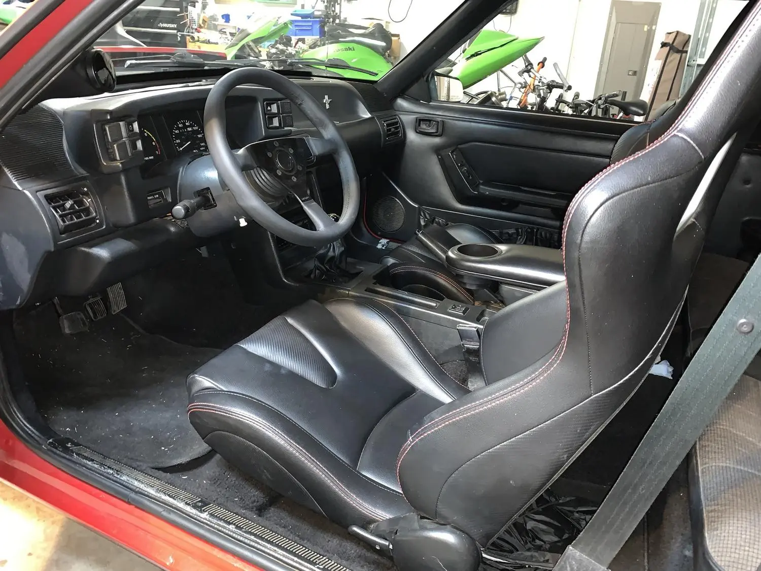

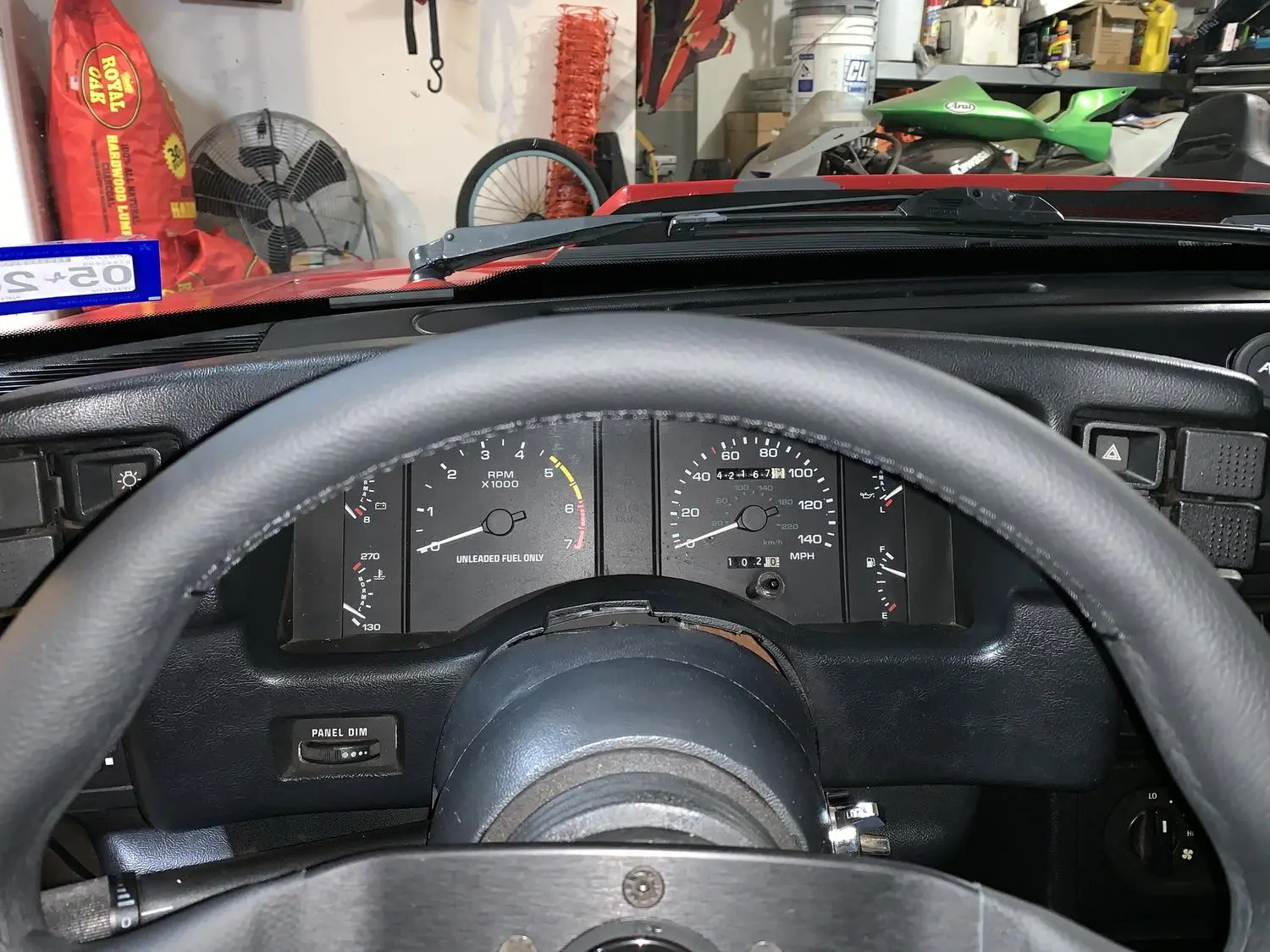

Went and exchanged the wheel this morning, the larger size is perfect but when I got home I realized the screws to attach the new one were missing from the box so I had to make a trip to a hardware store 20 miles away that I knew would have the right sizes... so 240 miles of driving in 2 days got me this. Also the seats a perfect, and sit a lower than the SVE seats do as well as have a better backrest IMO, it curves like your back does when sitting.
And here's my view with the wheel where I like it.

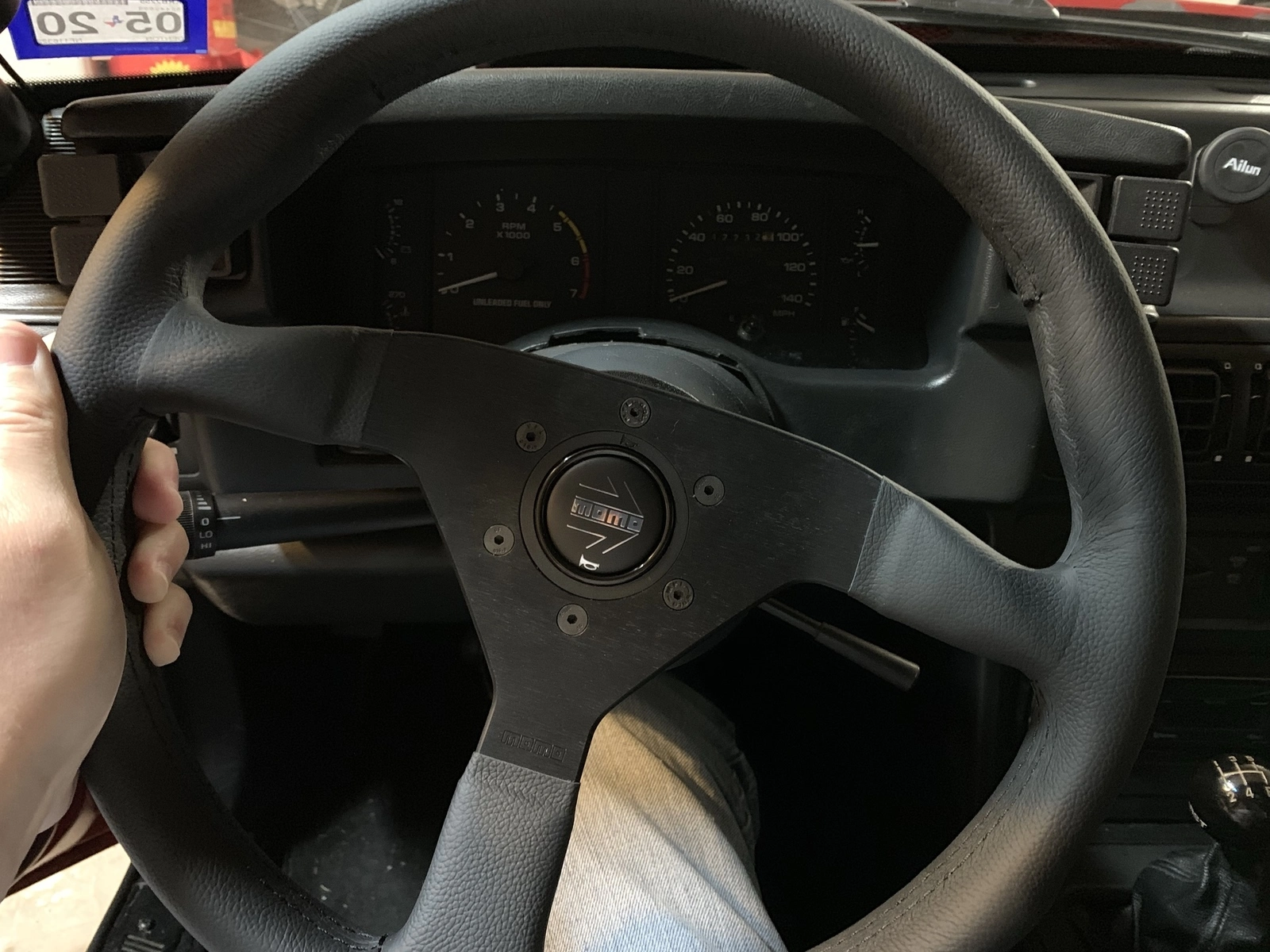

so... I drove the fox to work today with the new Momo wheel for the first time and while I love most everything about it, I will say that my last alignment with the old stock wheel was centered while driving straight my new one is not. It's about the 1:00-1:30 position while driving straight. I started wondering what I did wrong then picked up the old wheel and noticed that the flats were clocked that way to begin with to make it "straight"....
What's my play here? Can I fix this on my own or is it a new alignment to fix it?

Uncouple the steering shaft from the rack and straighten the wheel. No alignment needed.

If I remember from the last time I had mine apart there is a groove all the way around the splined area of the stub on the rack for the bolt.

I didn't want to hear this... yes, the spline on the shaft where it joins the column to the rack should accomdate the change. The wheel where the hub mounts to the column has no way to clock it, it has two flats on an otherwise round surface and can only fit one of two ways 180 degrees apart. I'm not looking forward to getting the car back in the air to mess with the steering shaft.
