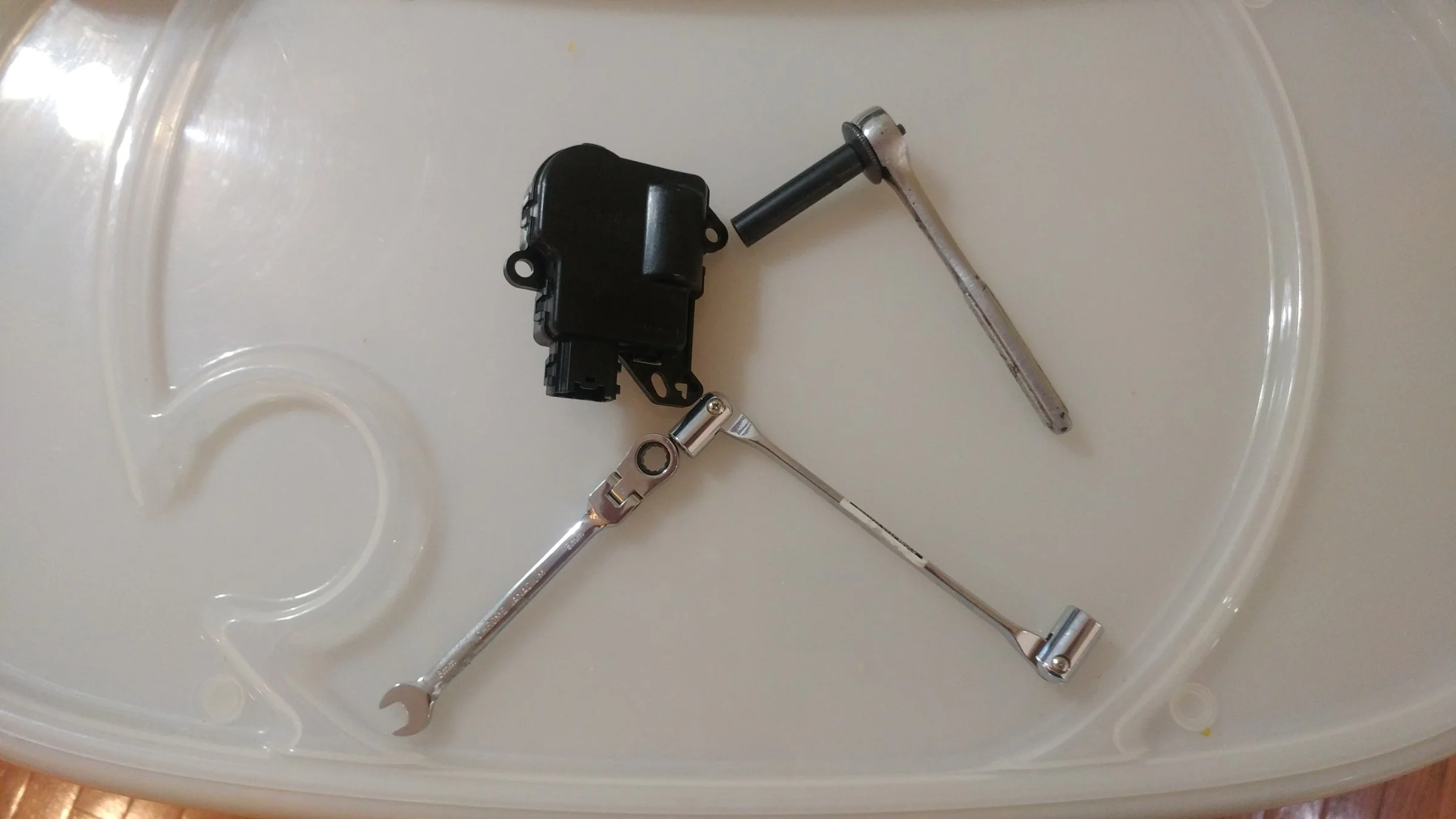

AxleCode
Oct 5, 2016
Oct 11, 2016
#25
  • Oct 11, 2016
  • #25
Using the 8 mm barrel wrench on the lower right screw where the space is very tight worked well, got the screw out in about 5 minutes. I used the 8 mm deepwell on the left and top screw and the little 8 mm ratchet wrench to get the top right screw the rest of the way out. The job took about 1 hour to exchange the actuator. It was somewhat difficult to line up the "key" on the actuator rod into the blend door assembly. The key has a flat spot that faces down. If you plug in the new actuator and push on the dash controls you can see the actuator rod move to line up the flat spot with the blend door rod input. Got the tools at Amazon versus local tool hunt. Good luck.
