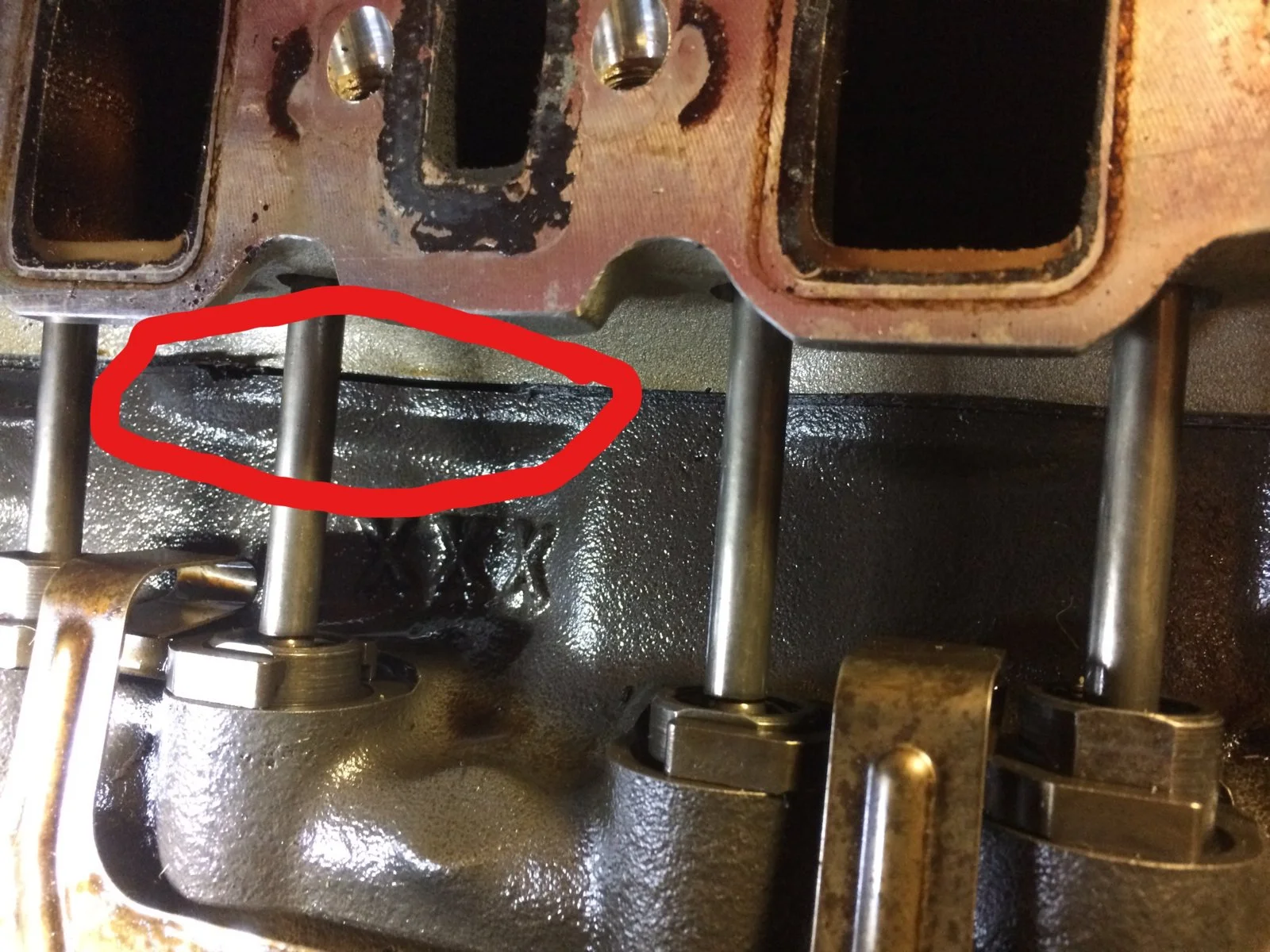

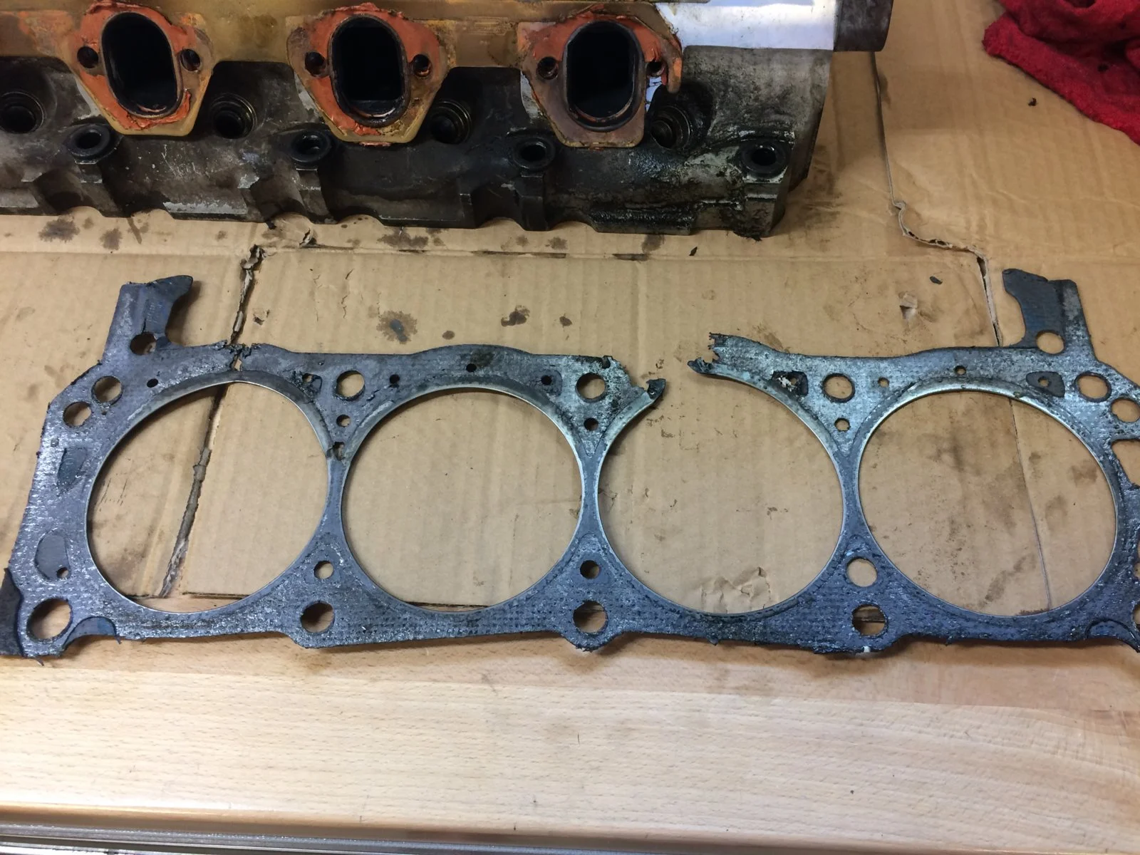

That gap between the head and the block is supposed to have head gasket in it. Pretty sure that's the problem. :mad:
ok, now we need to figure out why. i didnt see any detonation on the plugs and we pulled some timing out in the last tune.....
I'm a little suspicious of how this motor was rebuilt. Some of the things I've found don't look like whoever did it took a lot of care in how it was done. I'm going to get some Cometic gaskets and ARP studs coming to get it going again, then start looking at some options to pull it this winter and drop something a little more reliable in.

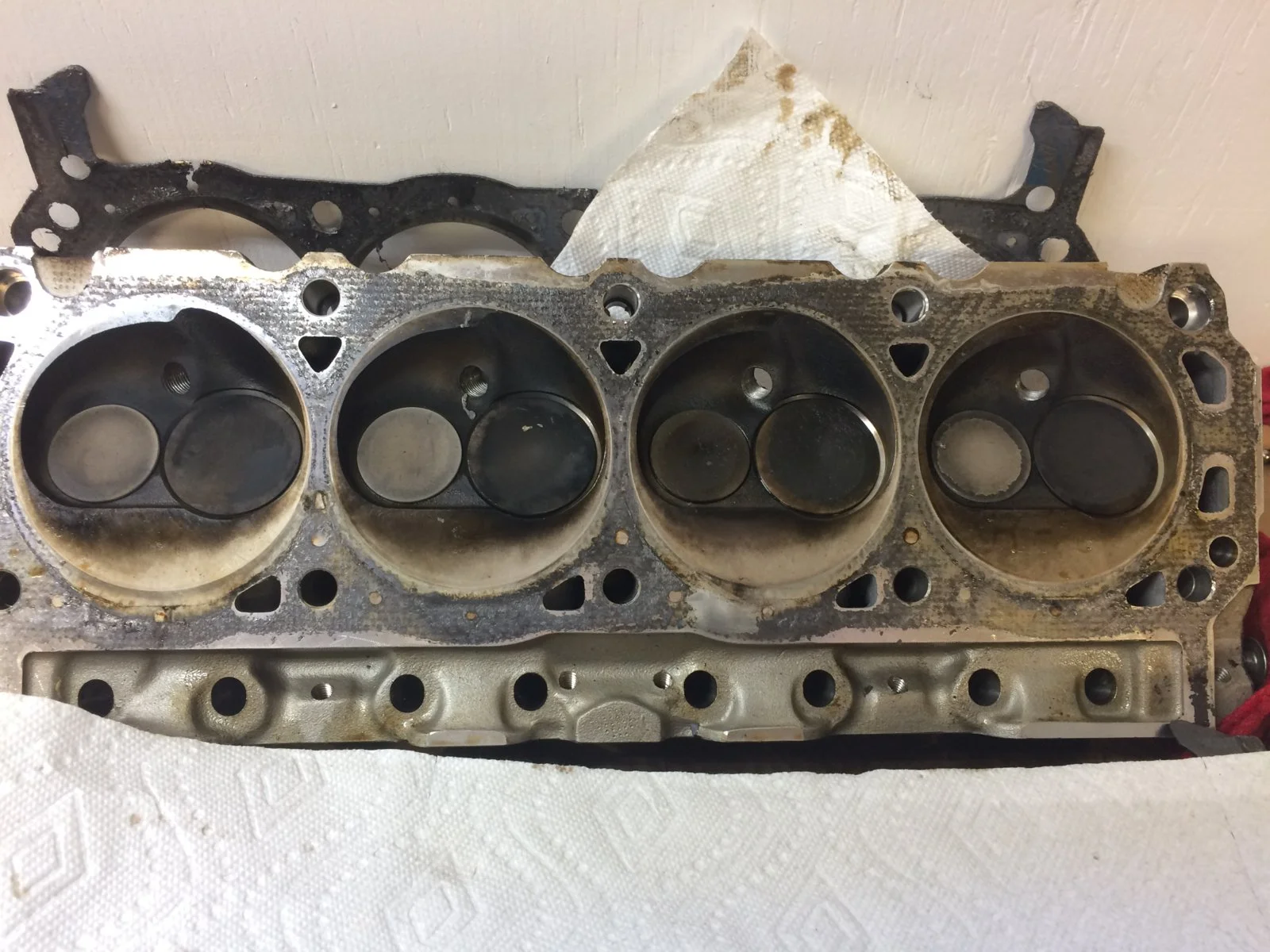

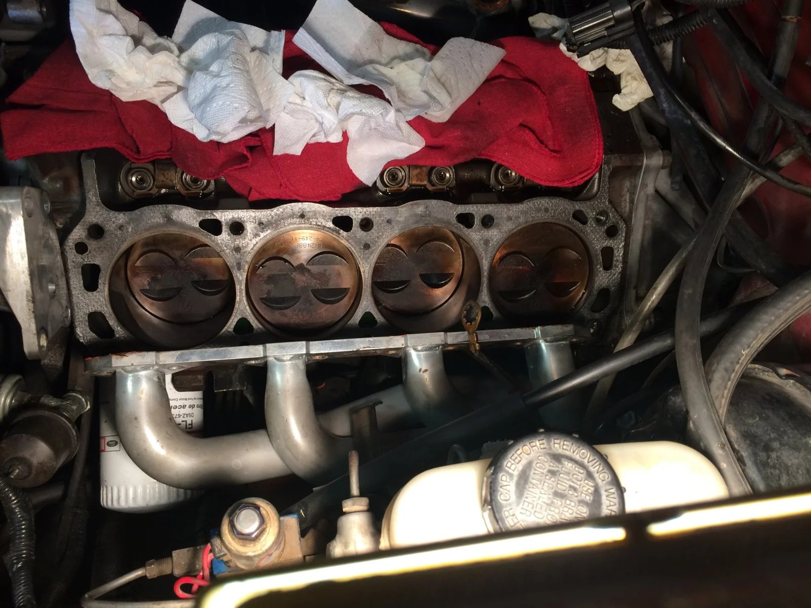

Took your advise and ordered some ford head gaskets to get me through the summer, then I'll figure out what I'm going to do this winter. Head and cylinders look ok. Going to clean everything up and put it back together. Whats a good way to clean the heads and block? I've heard not to use scotch brite pads, of is that BS?
