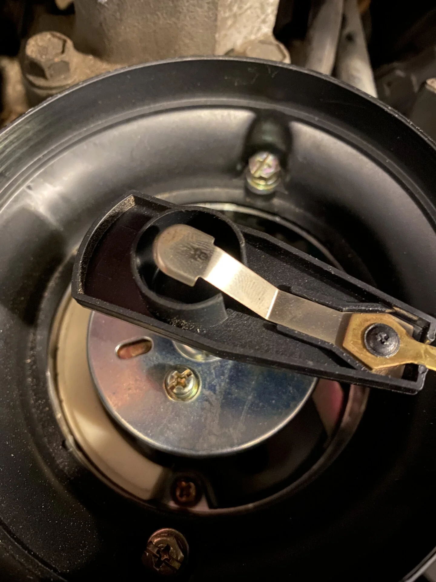

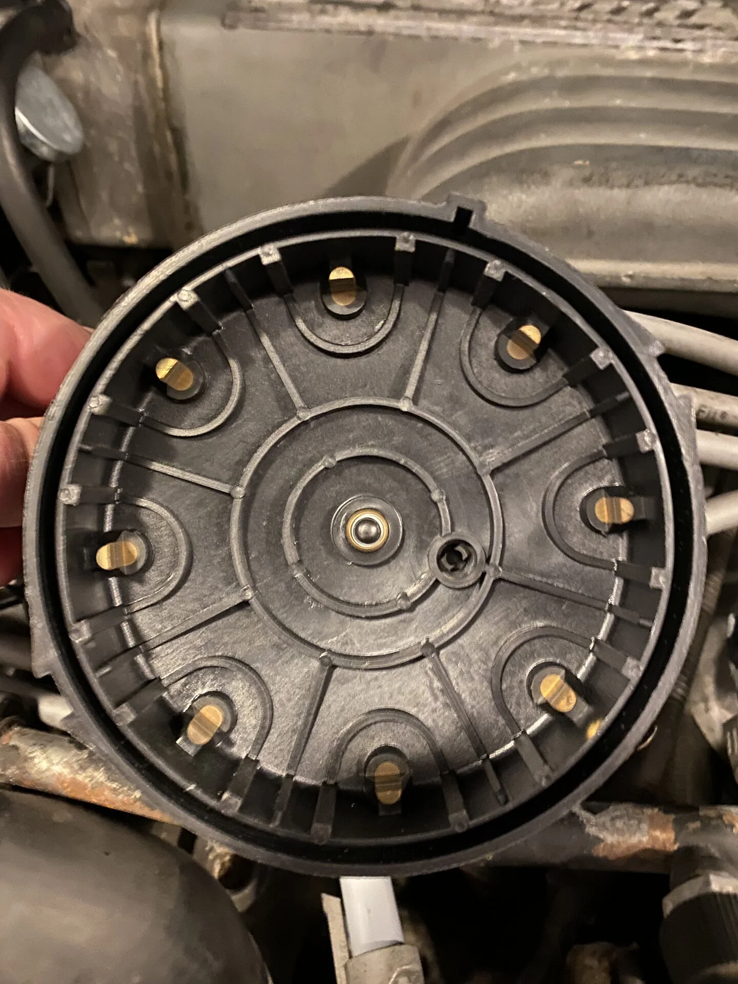

Get a better pick of the distributor and a shot of the inside with the cap off.

90sickfox
Wasn't a pretty sight...and I've got big hands

That stuff looks good to me too.

Thanks! It hasn't been driven all that much in the past couple years. It had been in storage for a bit while I was deployed and was stored in my garage. Just started and run every couple of weeks, so that might explain the dizzy/cap/rotor still looking good. The issues started before that though. I'm gonna take a closer look at the plug wires and coil over this weekend to see if there are any issues that can't be seen.
