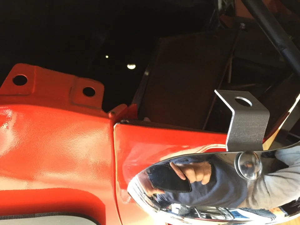

I am in the process of installing the bumper on my 69. There is a mounting hole in the bumper just outboard of the curve. It takes a bracket that the manual says attaches to the front fender. The fender isn't even close and there are no mounting holes if it was. Is it possible that it attaches to the valance and not the fender. The valance is not installed.

there is no hole hiding right behind the bumper on the fender? there is on my 66 coupe.

No do on the 69

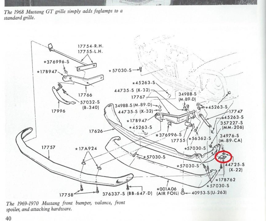

Thanks but this hole is further aft, around the bend in the bumper.

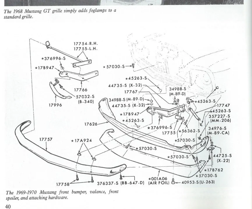

I think the bracket is up side down, it bolts to the valance just above the side marker light

I hope this shows up , i had to scan it . .

Stupid me , i forgot i have a schematic book .It shows a schematic for almost every thing 64 1/2 -70 .

Oops, you're right. I thought it was the one towards the front. Those bolt to the valance.

I think horse is right. You have the bracket upside down. Its in the right hole on the bracket, you just need to flip it over and put it back thru the same hole. Bolts thru the valence.
