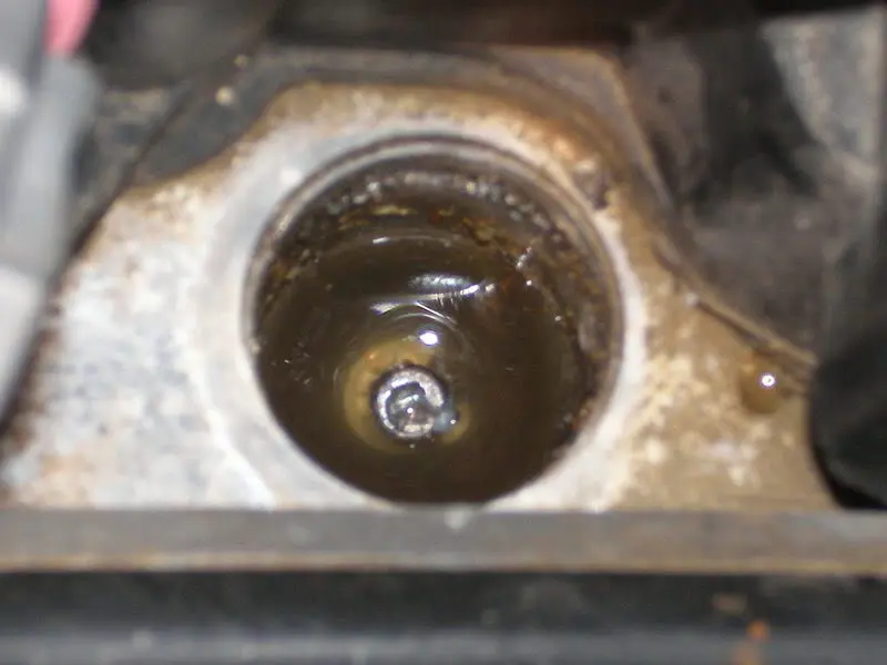

yea i'm pretty much done cleaning my engine too, the end result always looks something like this

Holee crap thats a lot of water! Mine wasnt filled up quite that much!!!!!!
