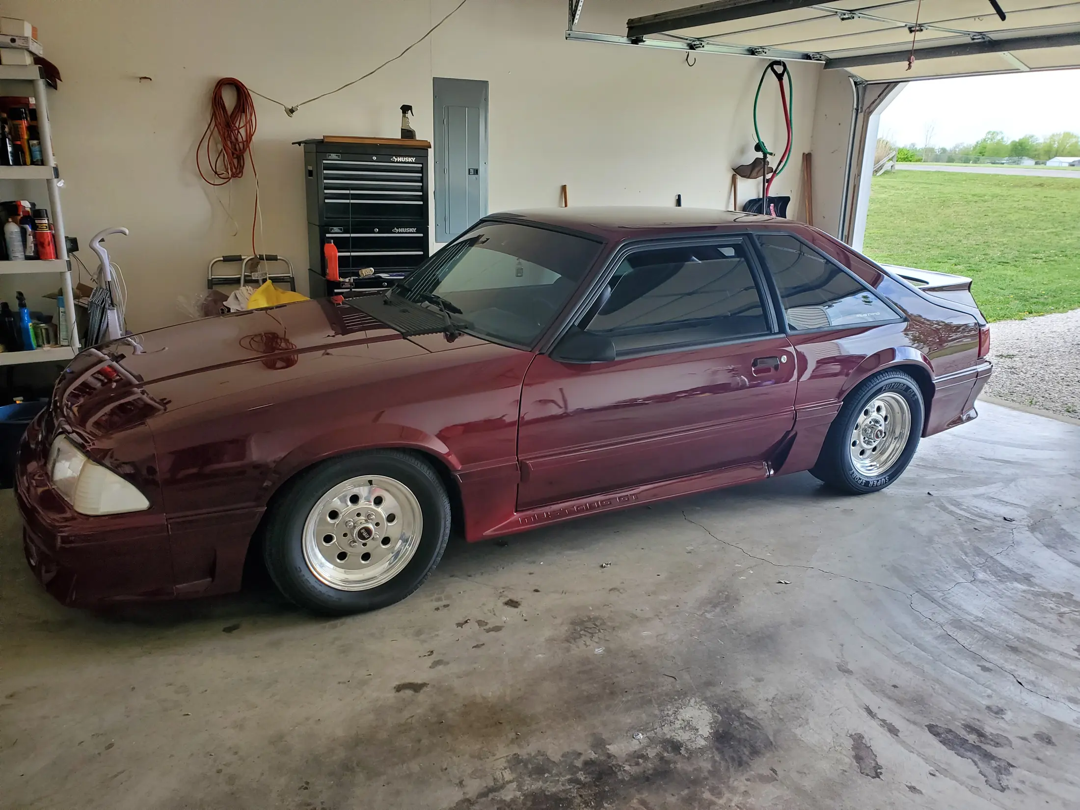

Pics of car and engine please
Instead of my usual “wtf don’t people list what all has been done to the car so we can begin to help” I’m just going to ask what has been done to the car. I am doubting the motor is stock so spill the beans here. Also isn’t on a stock ECU and if so is it chipped and if not the stock ECU what is it?
.30 over stock heads with 1.76 roller rockers and original ecu stock ignition
