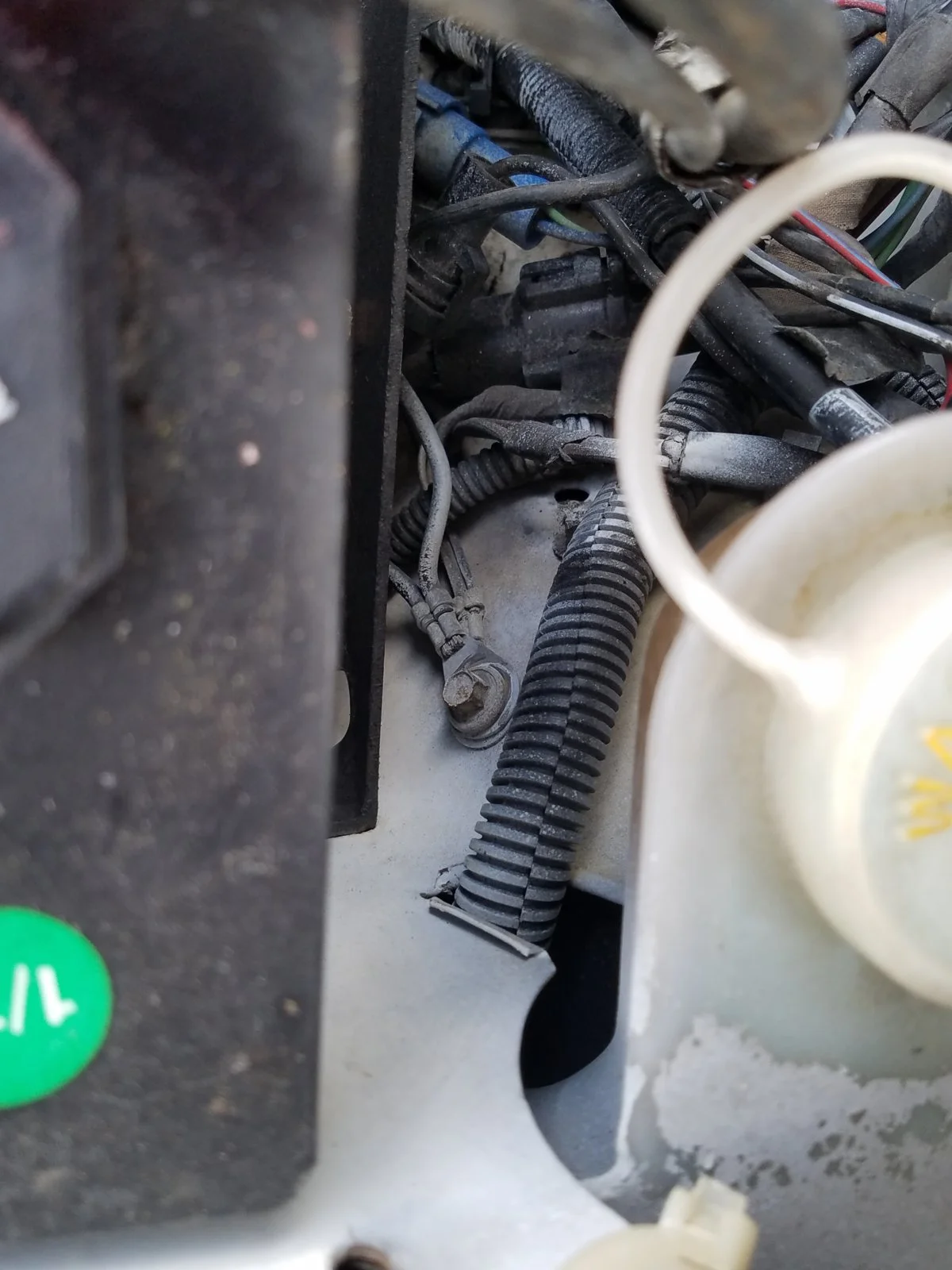

mustanglx91
Sep 12, 2007
56
Wilkes-Barre PA
Mar 15, 2019
  • Mar 15, 2019
I'm guessing that the ground? It's just mounted a little lower on mine.
jrichker
StangNet's favorite TOOL
Mar 10, 2000
27,512
2,813
Dublin GA
Mar 15, 2019
  • Mar 15, 2019
What are you guessing about? You post doesn't give any clues.
mustanglx91
Sep 12, 2007
56
Wilkes-Barre PA
Mar 17, 2019
  • Mar 17, 2019
Sorry a picture was suppose to go with that. My issue ended up being the computer itself. I tested a friends out of his car.
