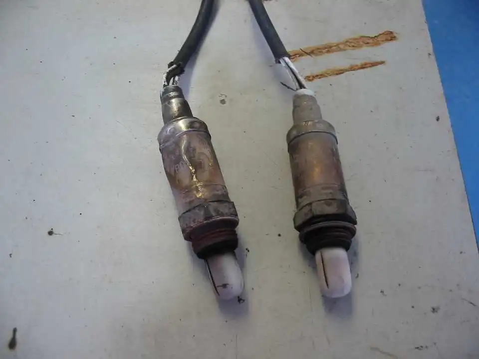

Is there a way to measure these and see if they are good? The driver's side one is all bent up, and the passenger side wasn't even hand tight.
Car is running lean and I pulled them to see what they looked like since I had the car up in the air for an oil change.

They look old and since you have them out, might as well change them seeing how their fairly cheep.

The one on the left (bent up) is now junk.
There's not an easy/good way to test O2 sensors. And, with the price of gas, and how much Stangs drink gas, there's no good reason to reuse those sensors.
As sensors age, they run the engine richer. This "may" result in more power , but they also respond slower. IMHO, the slow *ss response time FAR outweighs the richer mixture and often results in less HP
Either way, older O2 sensors (after ~20K miles on our type) use more gas. And, often, they reduce the power of an engine on the street (since the gas pedal is just about "always in motion").
BTW: It looks like you're running lean on both sides. Did you get lean codes for both sides? Or, it could be additives making the white appearance.

No additives while I've had it. It does run lean according to the plugs. My mileage is pretty crappy also (15-16mpg). Never has thrown any codes in relation to the O2's.
Are the NTK sensors that A.M. sell any good?

Thats what I'm running in my car, NTK is the same company that makes NGK spark plugs so I'm sure their good. You can get the same thing at Advance Auto for $5 less than American Muscle

Well this is weak. I put the new sensors in Sunday. Everything seemed kosher other then a little idle hunting. Today I fire it up to go to work, it is running rough and you can smell unburned fuel from the exhaust. I drove it anyhow hoping the eec would trim it out, when I come to a stop it idles where I set it (750ish rpm) but is still running rough and rich. Not only that but it seems like it is still running lean when I am hammering on it (can hear PI knock). wtf, it was fine two weeks ago. I'm thinking about buying a Quarter Horse so I can get a look at what the sensors are telling the eec, I'm going to buy one eventually anyhow once my new engine shows up.
