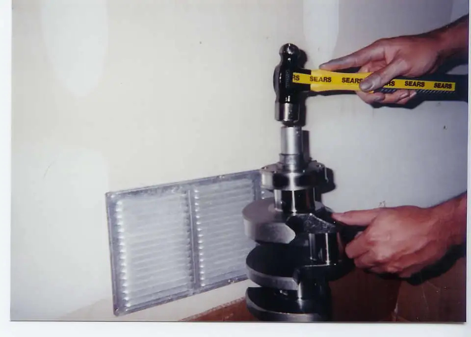

Thanks... Yep I remember now. It's there. Don't think it's new though. Pulled it out of old crank I think. I got a stroker kit so I don't remember if a new pilot bearing came with the crank or not. I did have everything balanced but just don't remember. I have pics I'm gonna go look...

Found it yes. I put the pilot bearing in the crank and it looks new.. Here is a pic.
