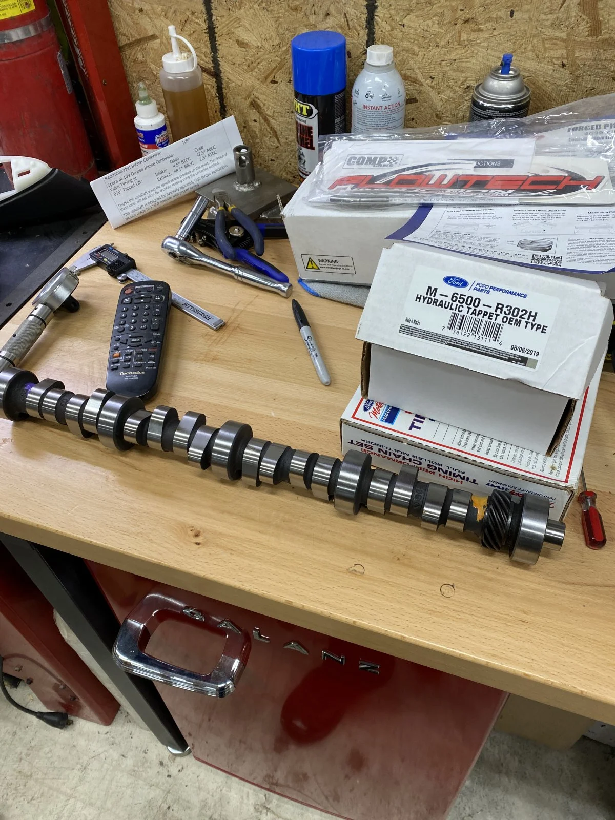

Well, boys and girls, I'm back. I hate that I haven't posted in so long. I hate even worse that the mustang has been under cover and ignored for the same amount of time. I got my ass kicked for about 16 months earning my Paramedic certification and an associates degree in Emergency Medical Services. Managed to do it with a 4.0gpa too. Well worth it because I'm supplementing my full time pay with lots of overtime on an ambulance now as well. Pretty awesome. Anyway...
The mustang is once again a top priority. First on the list is checking piston to valve clearance on this engine so I can get the rotating assembly balanced. For that, I need to get the FTI cam stabbed and degreed, mount those sexy 11R's and get to measuring. I need head studs and gaskets for that and I think that's it. I have to take an inventory of the parts shelves in the garage because I simply haven't had time to spend out there.

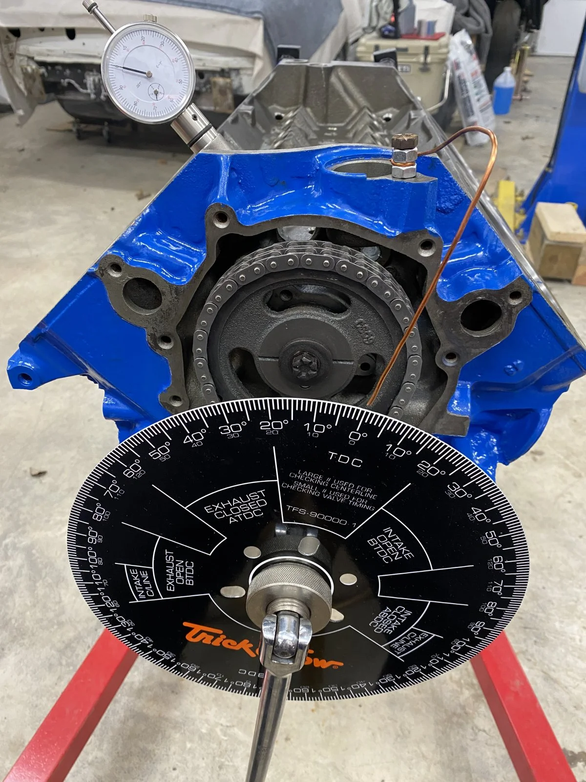

I’m pretty sure I got my cam degreed today. Installed dot to dot, it appears to match the open/close, intake/exhaust on the cam card within a half degree at 0.050” lift. The card states the cam is +2* though. Shouldn’t that mean I’d be using the +2* key way in the 9 position crank gear to get those numbers?? I’ll do it again at final assembly of course to be sure.
I attempted to check P/V clearance as well, but I must be doing something wrong. Valves never touched the clay. I was recommended 7.200” pushrods so my checker is 6.8-7.8. I started at 7.2 just to see what would happen.
I’m also failing at putting checker springs in. I have a spring compressor that mounts to the rocker stud. When I compress the valve spring, how the heck do I get the retainer out? I tried a magnet but they stay flush with the spring hat. Is there a trick to this on the trick flow heads? I’m just a little confused about everything I did today.
you need to smack the spring with a rubber mallet before you try to compress the spring.
