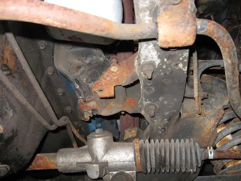

I'll post some pics later, including the mounts.

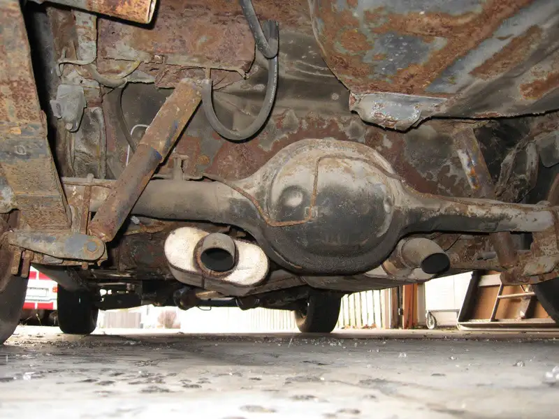

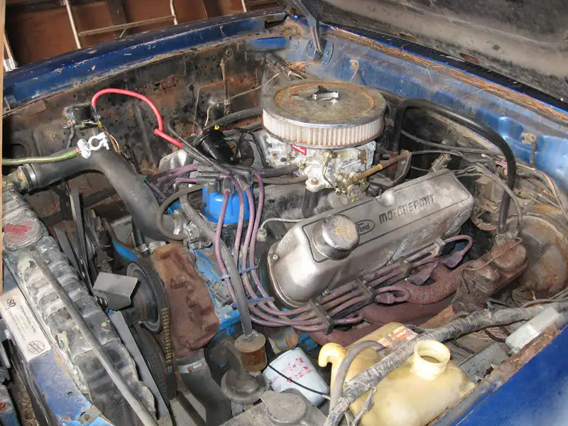

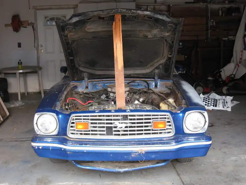

Here's a few pics of the donor, including the mounts. They look stock, but I've never looked at a known factory 5.0L one to compare it to. And yes, the rust is gonna make this fun I'm sure.
