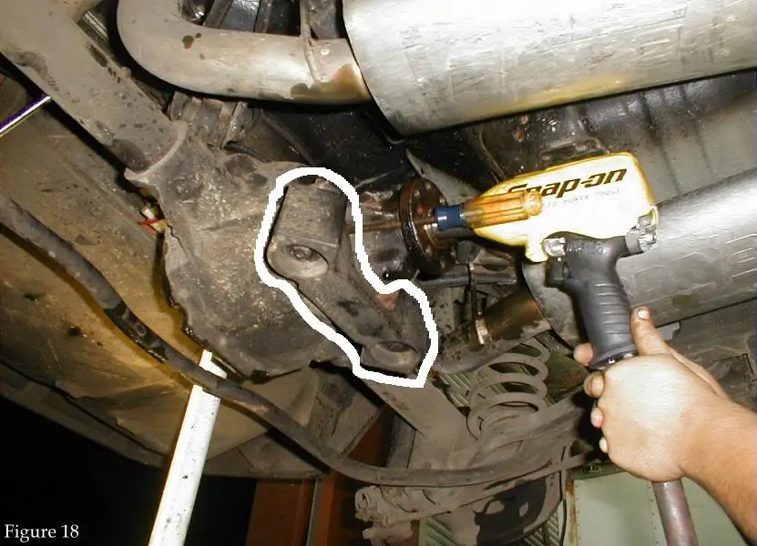

Hey guys does anyone have pics of their dogbone? I want to take mine off but dont know how to go about it? Just wondering if anyone had a pic laying around? And also whats the actual name for it?
The dog bone is kind of hard to explain what it looks like. I knew exactly what it was when I looked under the rear end. It's after the driveshaft, in front of the pumpkin, and wraps around the differential in that area. Theres two bolts that hold it on, and a bracket on top of the differential. You'll know it when you see it, it looks "stuck on there." I just took a socket and ratchet and took it off, just don't drop it on your face because it's heavy.
Rear End Vibration Damper, to take it off remove the two bolts and remove the bottom bone shaped part Keep the top sheet metal part and reattach it to the rear end with some shorter bolts. This gives the pinion snubber something flat to hit against.

The thing that concearns me is the top section of the dog bone on top of the pumpkin. Isnt that the stop for the bumpstop?
YES! You need the bumpstop.
And to get around this ..... I bolted the upper bracket back on. Just use the same bolts. Push the metal inserts out of the rubber bushings that you took off and use them as a washer for the bolts. The only downside is that it looks a little weird now. I have 2 bolts hanging down a couple of inches. I plan to get me some shorter bolts and throw the sleeves away, though.
