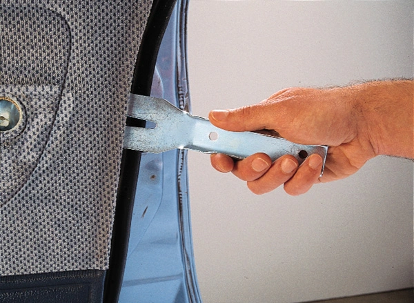

Get a tool to pop uout clips. Looks like a screwdriver with a big flat head and v cut out in middle. Slide that around the edge of door panel and pop clips. Could be a a number of things making the rattle - I bet once you get panel off it will be obvious.

The good tool looks more like a spatula.
Remove the window and door handles, and arm rest pad, and the panel will come right off. $3, and worth every penny.

Excellent. I'll get one. Otherwise, I can picture my wife looking at a bent table fork, and saying, "with all those tools in your shop, you had to turn this into a pretzel?
