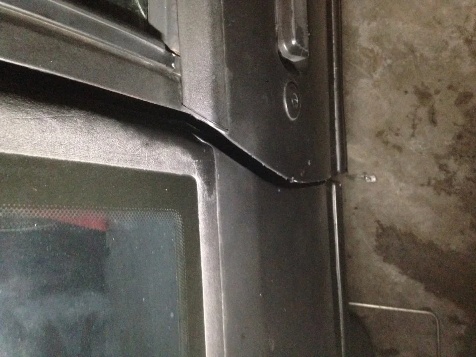

Hey, I recently changed my doors weatherstripping, and both door won't close all the way unless slammed really hard. So I changed the door strikers to see if that would help and still wouldn't close. So then decided to change the door hinges, as the door was very wobbly and thought that would for sure fix it, but nope still wont close properly, and still requires being slammed hard to close all the way. If anyone has any ideas what else I could try that would be appreciated. thanks

post a picture, Did you adjust the strikers properly? Did you also replace or add the plastic striker bushing. When you say door hinges, I assume you mean the pins and bushings and not the actual hinges themselves?

Yea, sorry meant pin and bushings, and yea brand new striker and striker bushing, I think I tried adjusting it (moving up and down) , how do you adjust it?
