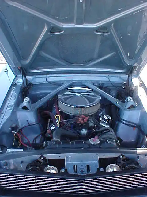

I used the stock mounts for the V belt and only ran the water pump and alt.
I measured with a piece of string, then bought a belt that was the same size. Using the stock mount to alt mount to tension the belt.
