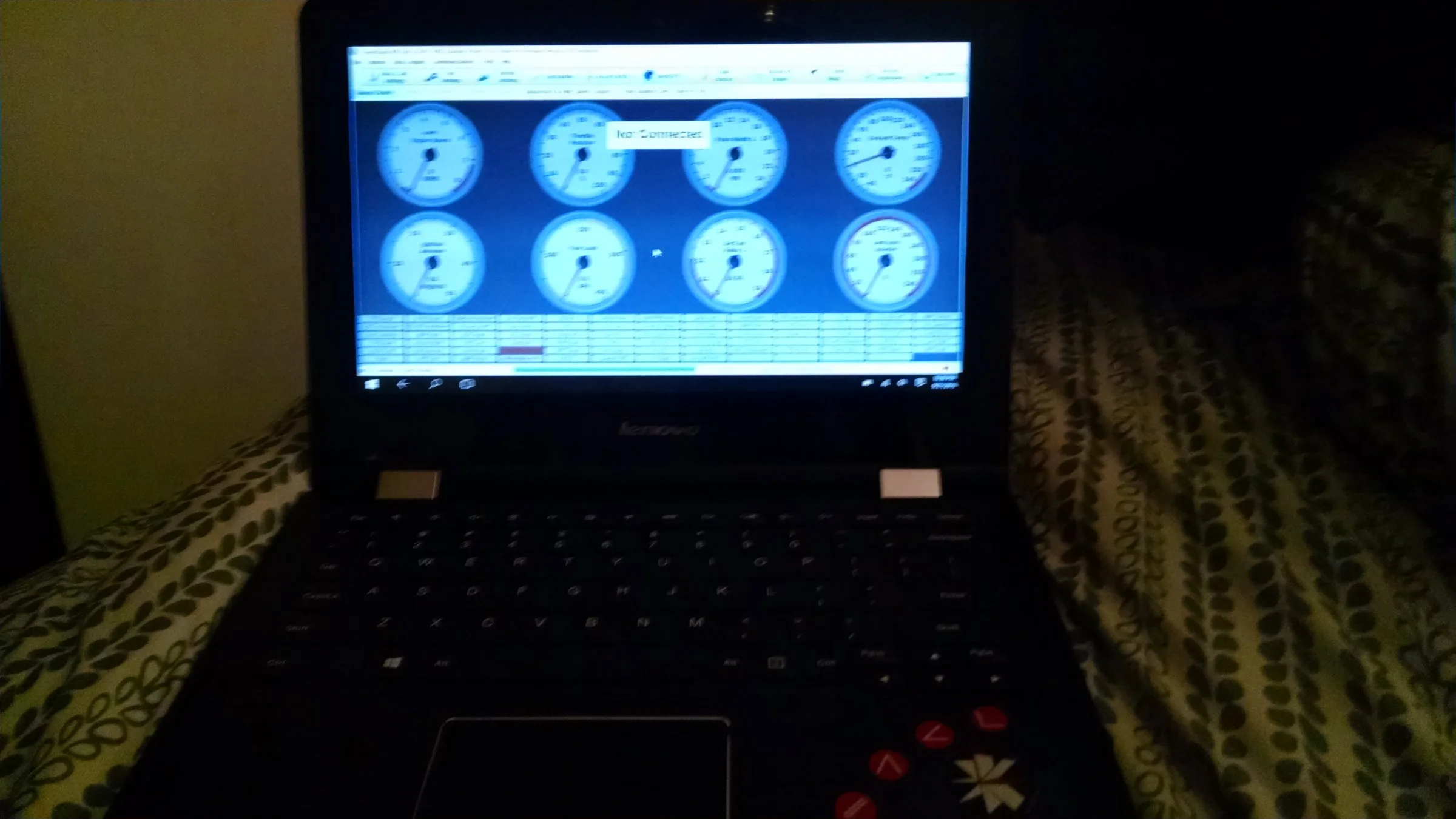

Can't wait to dig into tuner studio.
[emoji2]
Took the first step towards tuning this car.
have you watched my videos yet? I walk you thru the software its a little lengthy but will help a lot.

I need CID- injector size and estimated hp tq
Thanx for the vids. I know what I'll be doing lunch time tomorrow. [emoji106]
Its 331- 42lb injectors... motor should be around 400 na. Comp cam xe282hr cam TW 185 heads, ported holley systemax, 75mm TB.... calculations say around 380- low 400hp. Trying to keep it under 500hp with 6- 7psi.

The nice thing about tuning with the megasquirt is that we can set your base fuel pressure at anything so if you jack it up to 50 and use that as base instead of 40 you now have 50 pound injectors. I'm not sure what fuel pump you use but a walbro gss 250lph hp is what you want.
I've got a 340lph pump and a Kirban regulator. I was going to attempt 45psi...figured that would get me close.
You're " the man " with this stuff. I wouldn't doubt your advise at all. I want 60 pounders but the 42s were almost free.
If you set up a base for me I can pull it off your thread...that way it can be there if someone else needs it. My combo is pretty common.

ok @90sickfox here is a tune for you to start with. This is literally my tune from my car I have 50lb injectors so set your fuel pressure to 47-55lbs this range will work. You will still need to do your sensor calibration from the tools menu.... if you would like I am free this weekend PM me for details a lot easier over the phone.
  • sending @90sickfox a tune rev.1.msq
Great man....I've calmed down now. Lol. OK I'll PM you this weekend. Thanks
