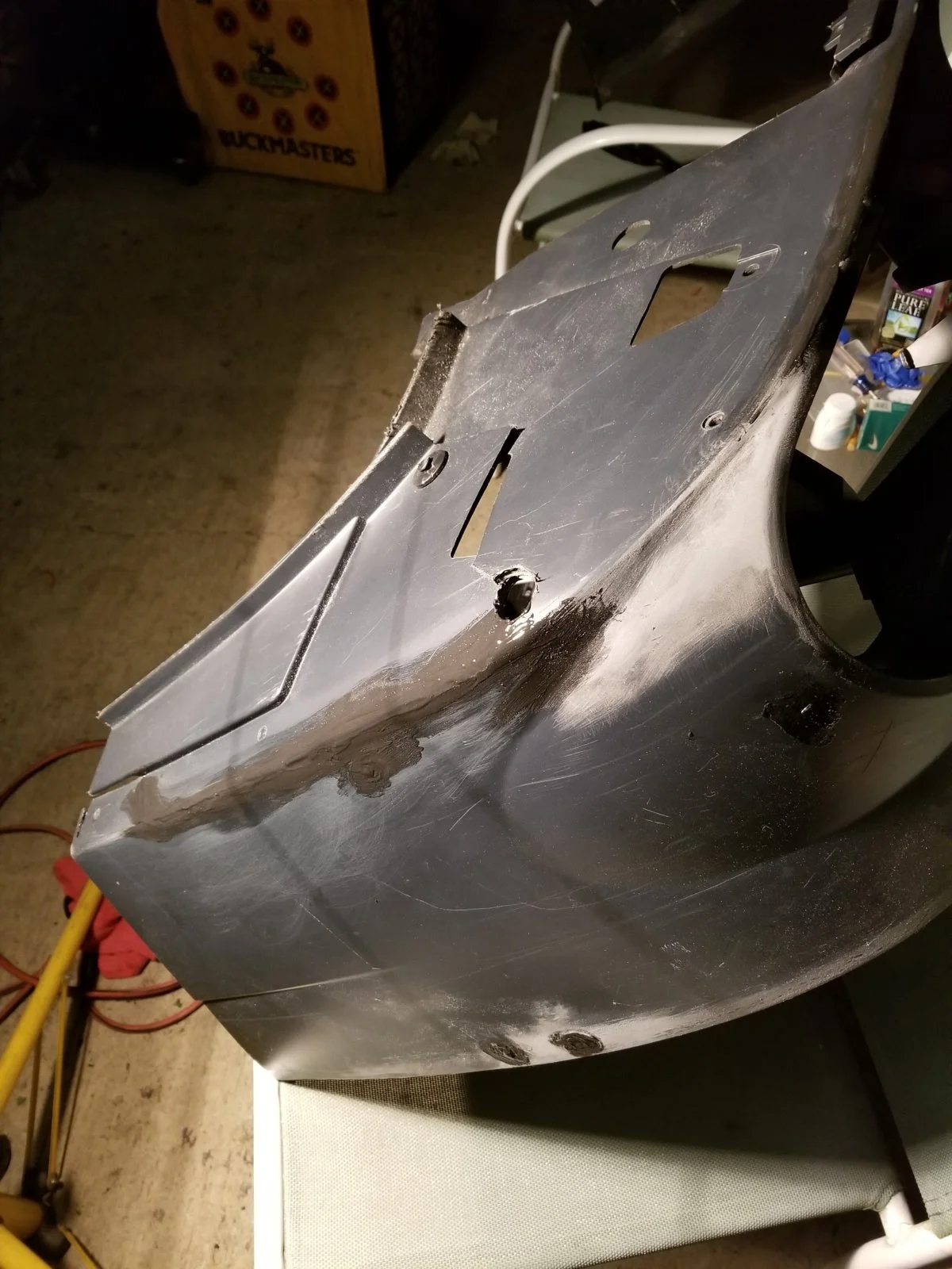

I've had little cracks like that on lots of plastic and fg parts. Try to v out the crack just a little to allow the pba to get into the crack.
PBA is the strongest glue I know of Scott, plus it retains flexibility. It holds new quarter panels and beds on. I've seen the metal of a replaced panel tear and the pba still in tact.
I beveled the crack a little. I glued a little piece off plastic last night and by this morning it would not come apart. Couldn't even rip it apart. The hologen lights kept it at about 107°.
I plan to do the front of the bumper today and glue the winglettes on the wing. Then the front bumper and wing should be able to go on the car Sunday or Monday.

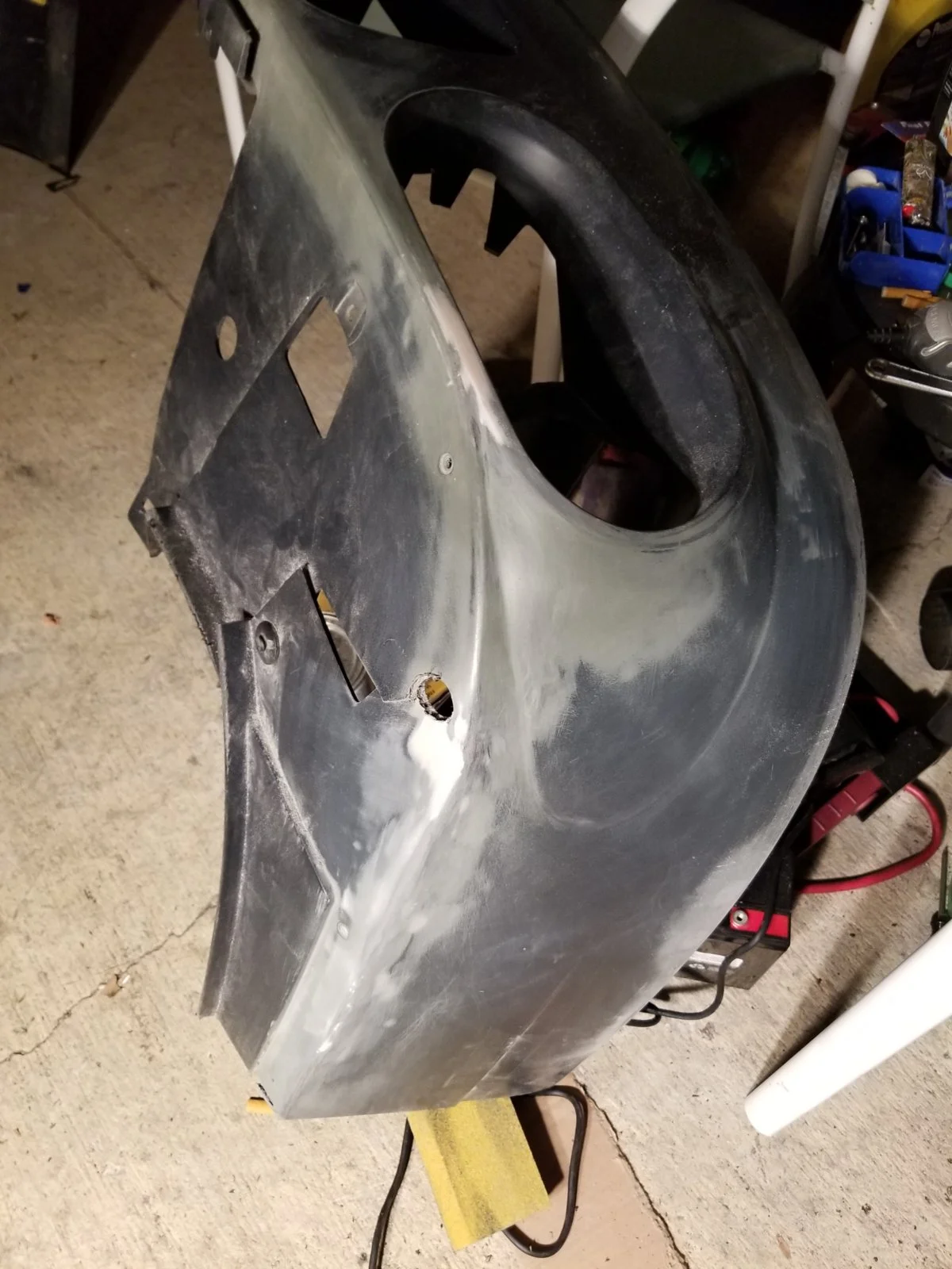

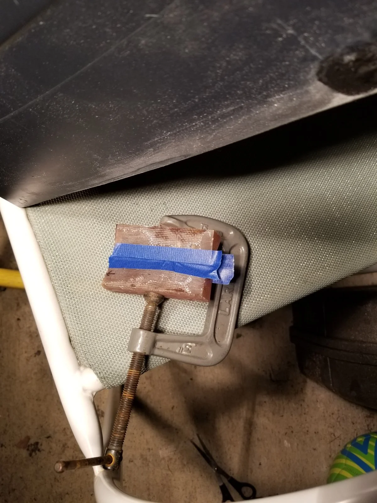

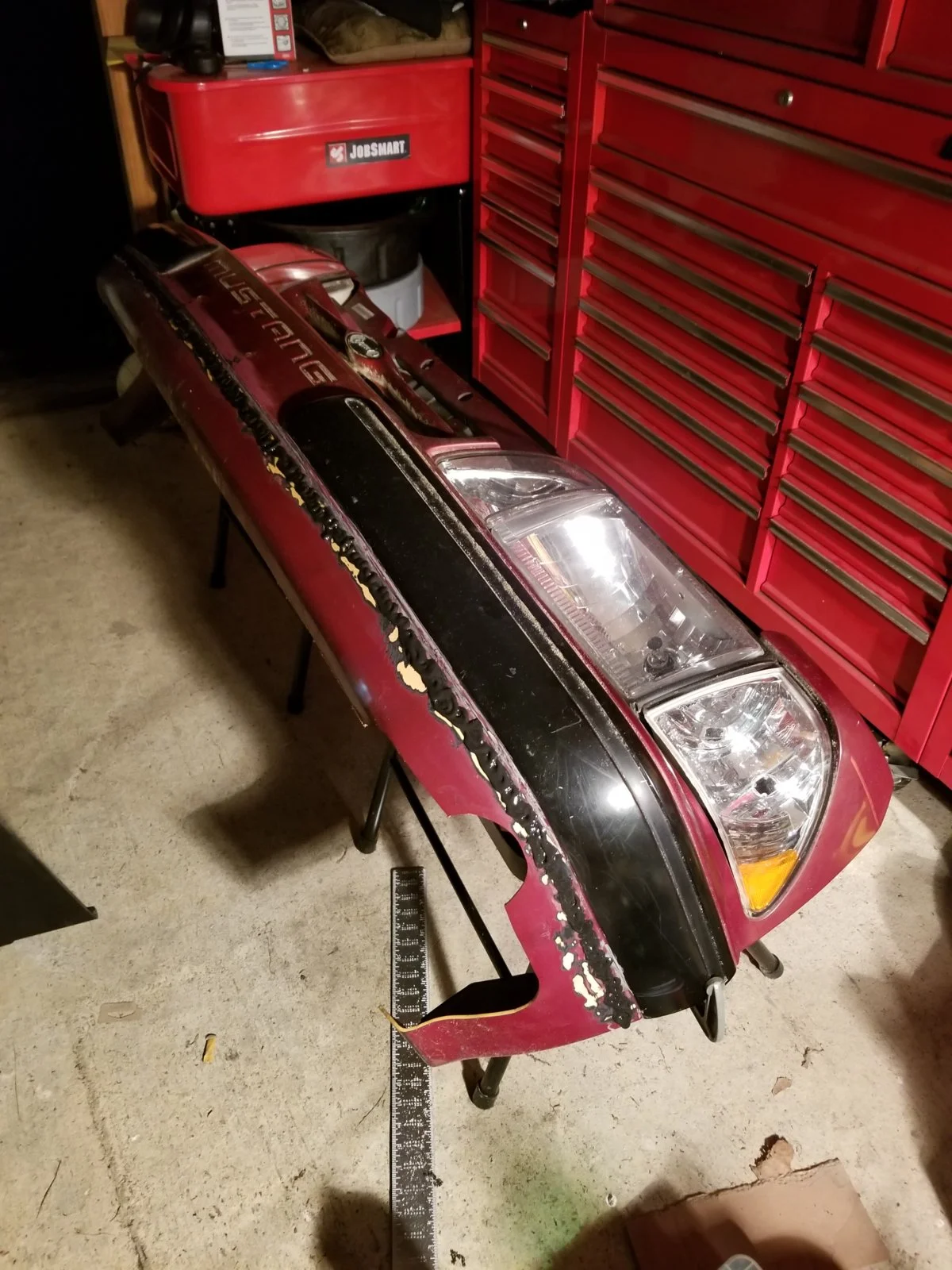

Well... got two things done today
The front bumper by the fog light surround was scratched up really bad. Got the first round of fix on that.

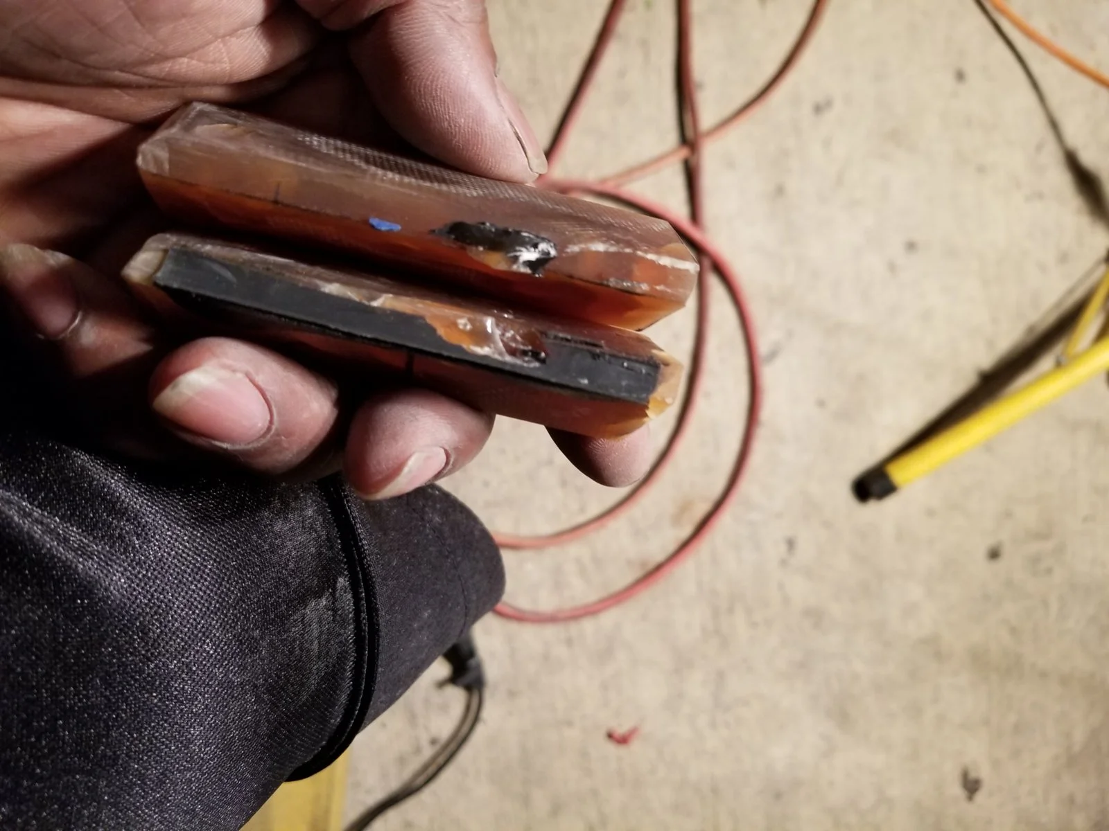

I decided to test the PBA with the same stuff thats on the wing...... fiberglass. The end of these wedges are about 1/4 inch thick. We'll see how this goes tomorrow. If it holds those winglettes are getting glued.

PBA is strong. It took a significant amount of strength to do this...
I couldn't pull the things apart at all...but a decent amount of force did manage to separate them using the glued edge as a fulcrum....I'm satisfied...the winglettes will be glued.
The bumper bodywork is done for ther crack. Very pleased with that, too.
Just a few coats of primer and a lot of sanding ahead. Then I can glue this thing back on.

Well.... that's done.... for now...
Can't tell it was ever cracked. Thanks Dave !!

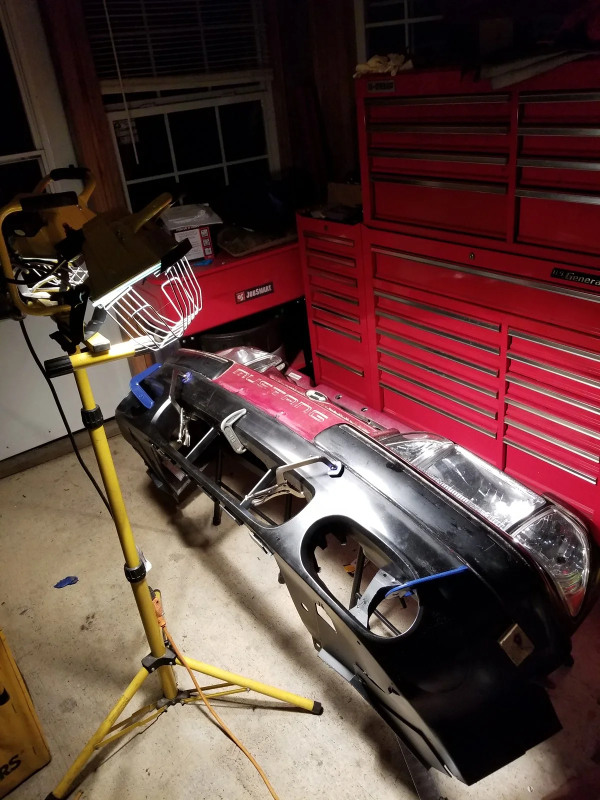

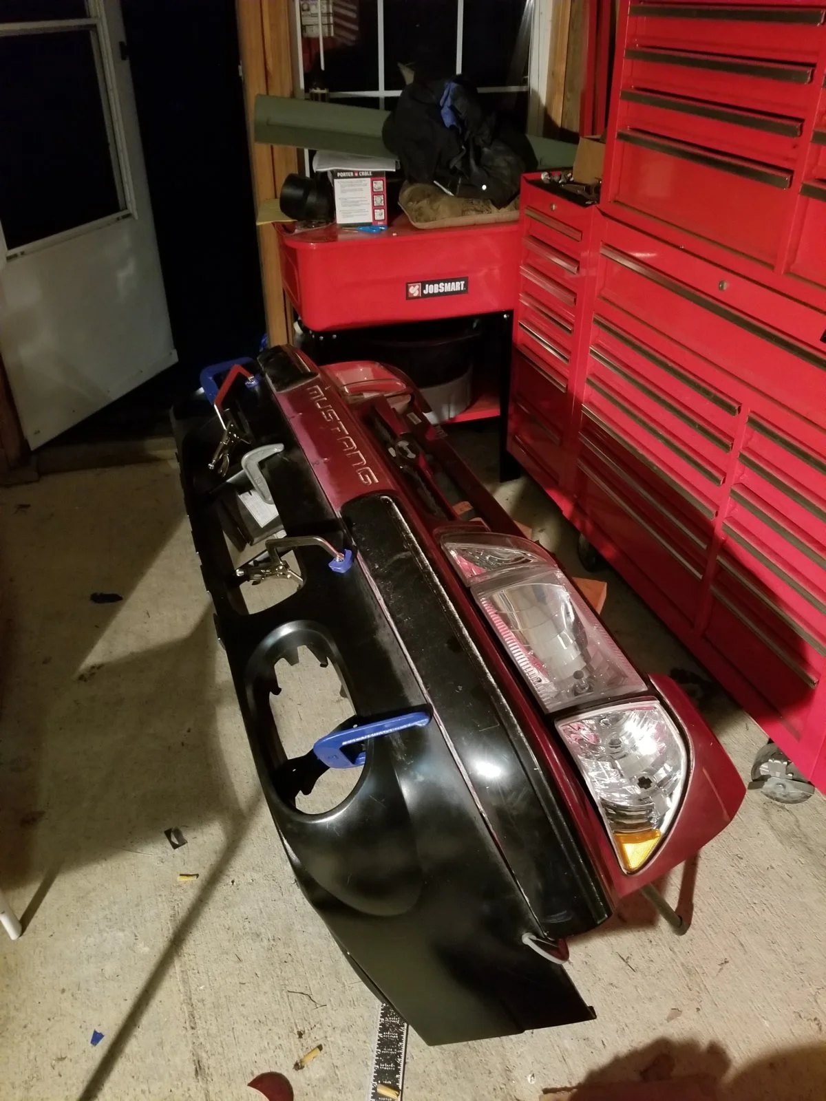

I managed to get this far last night....
Version 2.0.

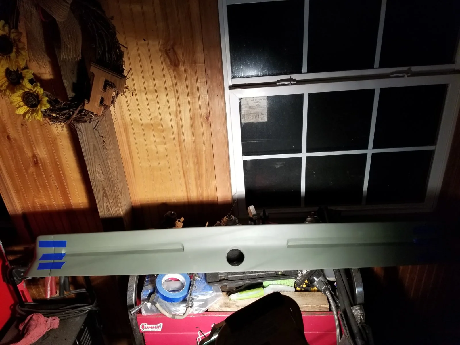

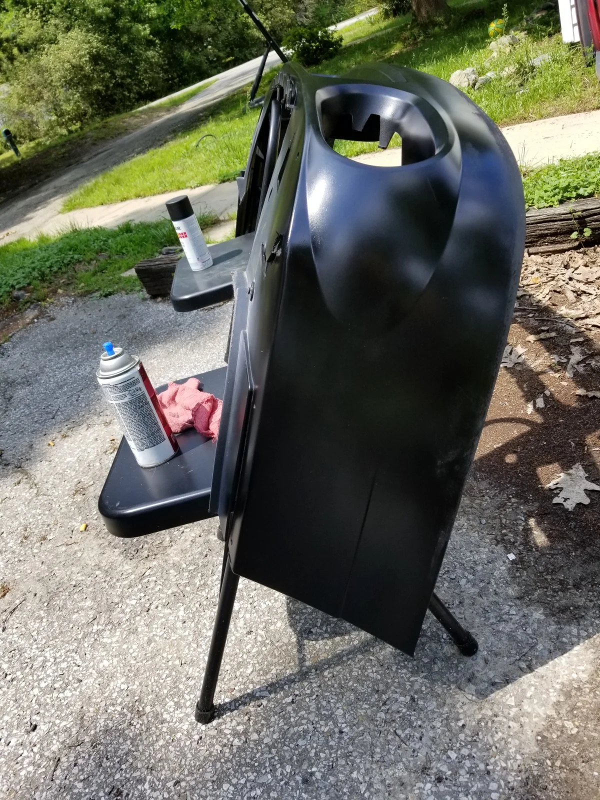

Do ya know what this means......?
It means this...
The last time I did this I glued it while on the car with 3m 04747 epoxy. That stuff sets in like 1 minute. The bumper was actually off center and a tiny bit crooked. This PBA allowed me to get it dead on straight and even from side to side.
.....did this too....
Its now stuck together.... and there's no return. On the back side I used drywall tape and PBA to reinforce the seam. Should hold up decent.
Still have some sanding and finishing to do... then a final coat of ... ( I think ) flat black.

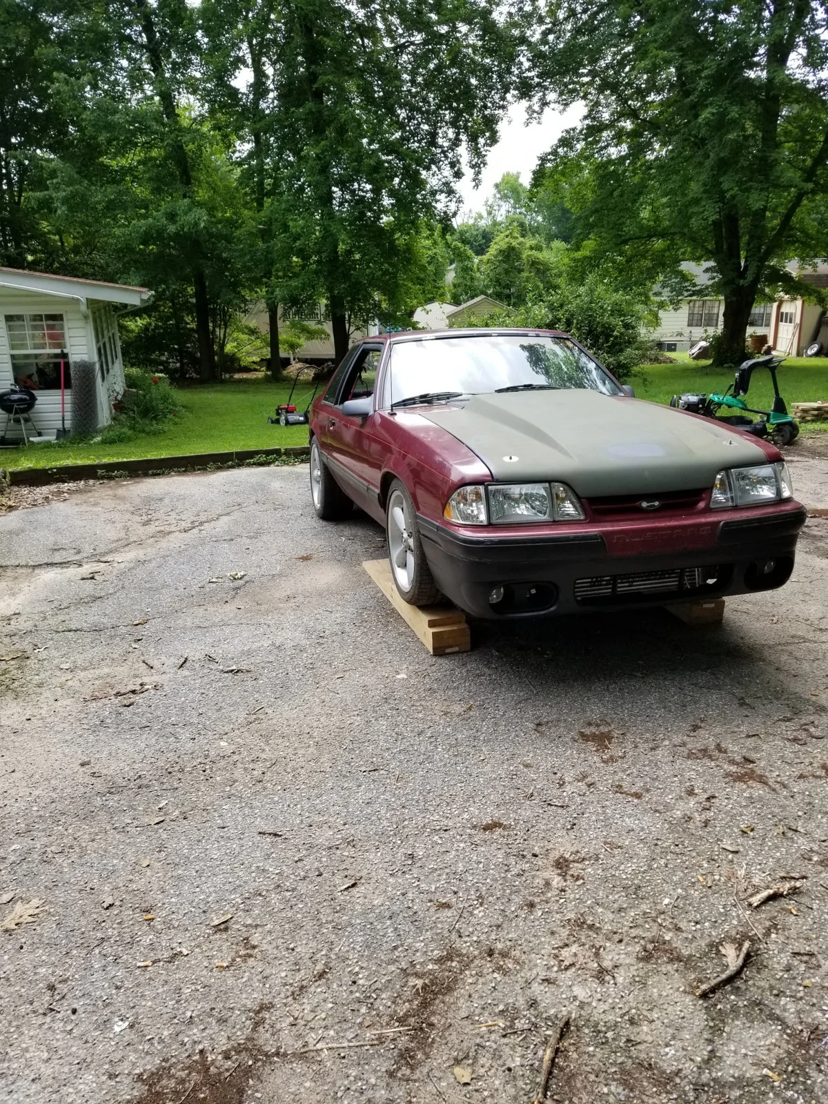

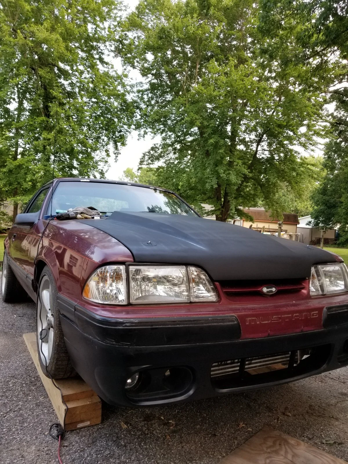

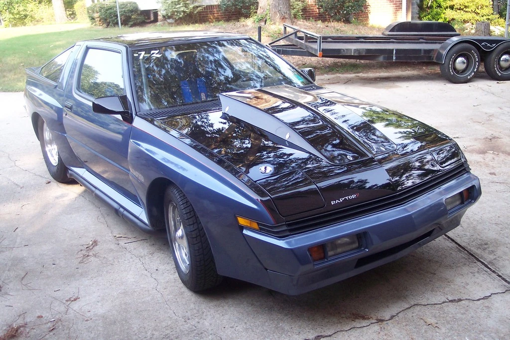

Here's a pic of the front end....still a bunch to do. Still in the process of relocating to northern VA.
Did some work on the hood and did this....
To match this....
My favorite pic of the day is...
Thats it for today. If the rain stops i may have more updates tomorrow...
