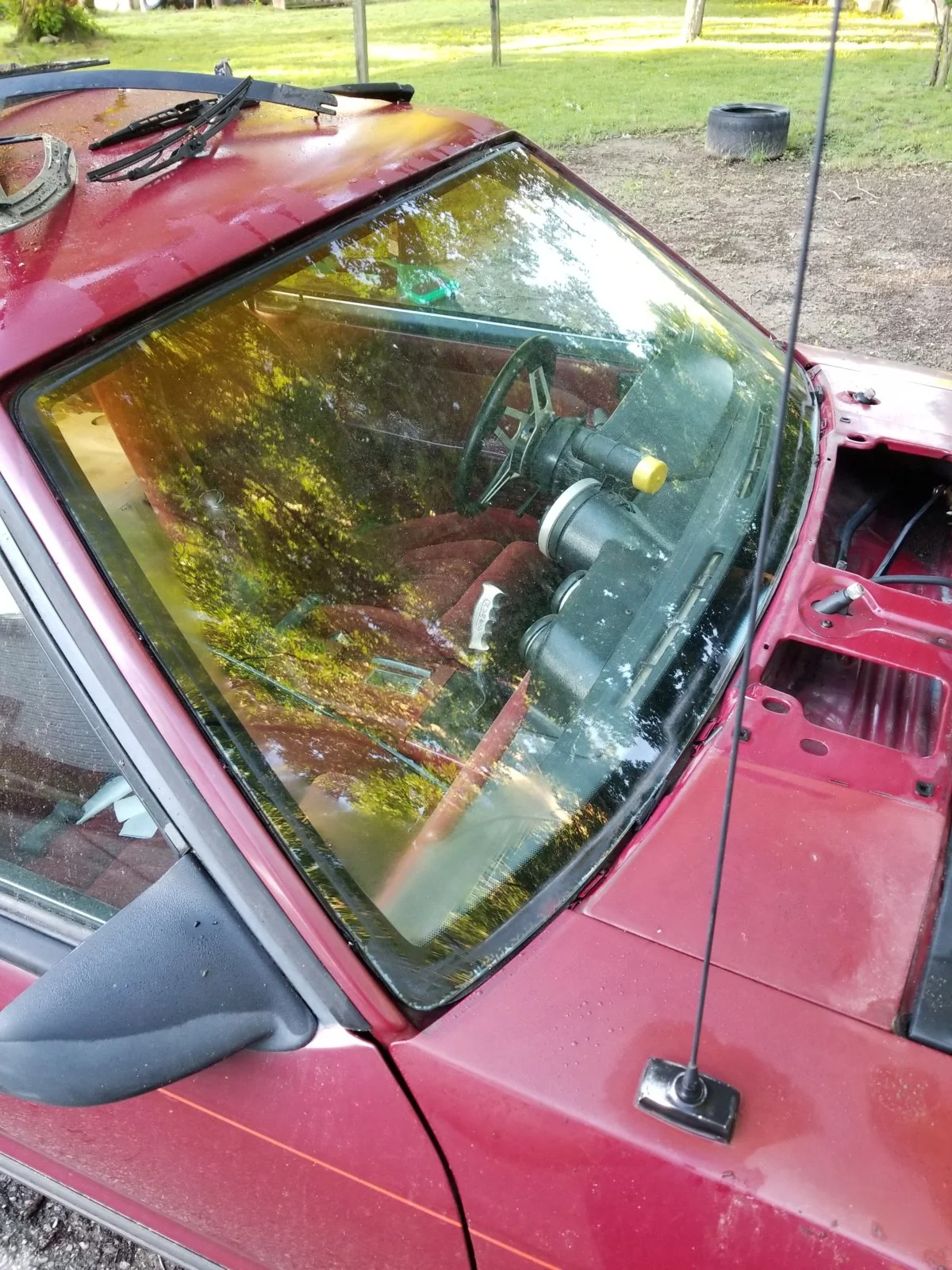

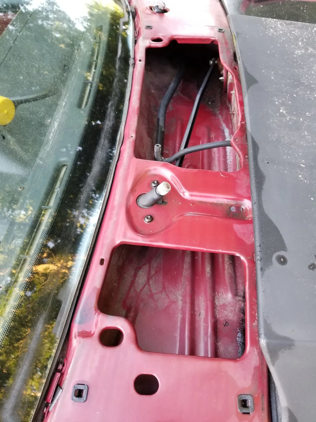

Back in the day.... before the internet... we used to put window screen over the opening and then screw the cowl down. It keeps all the leaves and dirt out. There are drains that run behind the fender ( little cut outs ). Mine were clogged with leaves and small sticks. I cleaned mine out last fall and it was already clogged.
If you haven't cleaned yours recently I highly suggest cleaning this area. The screen is added assurance.

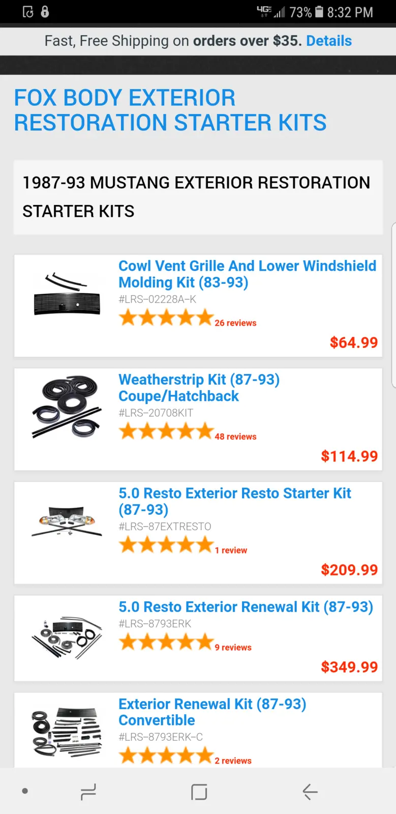

Got something coming from lmr to make dusty a lil' purdy ...

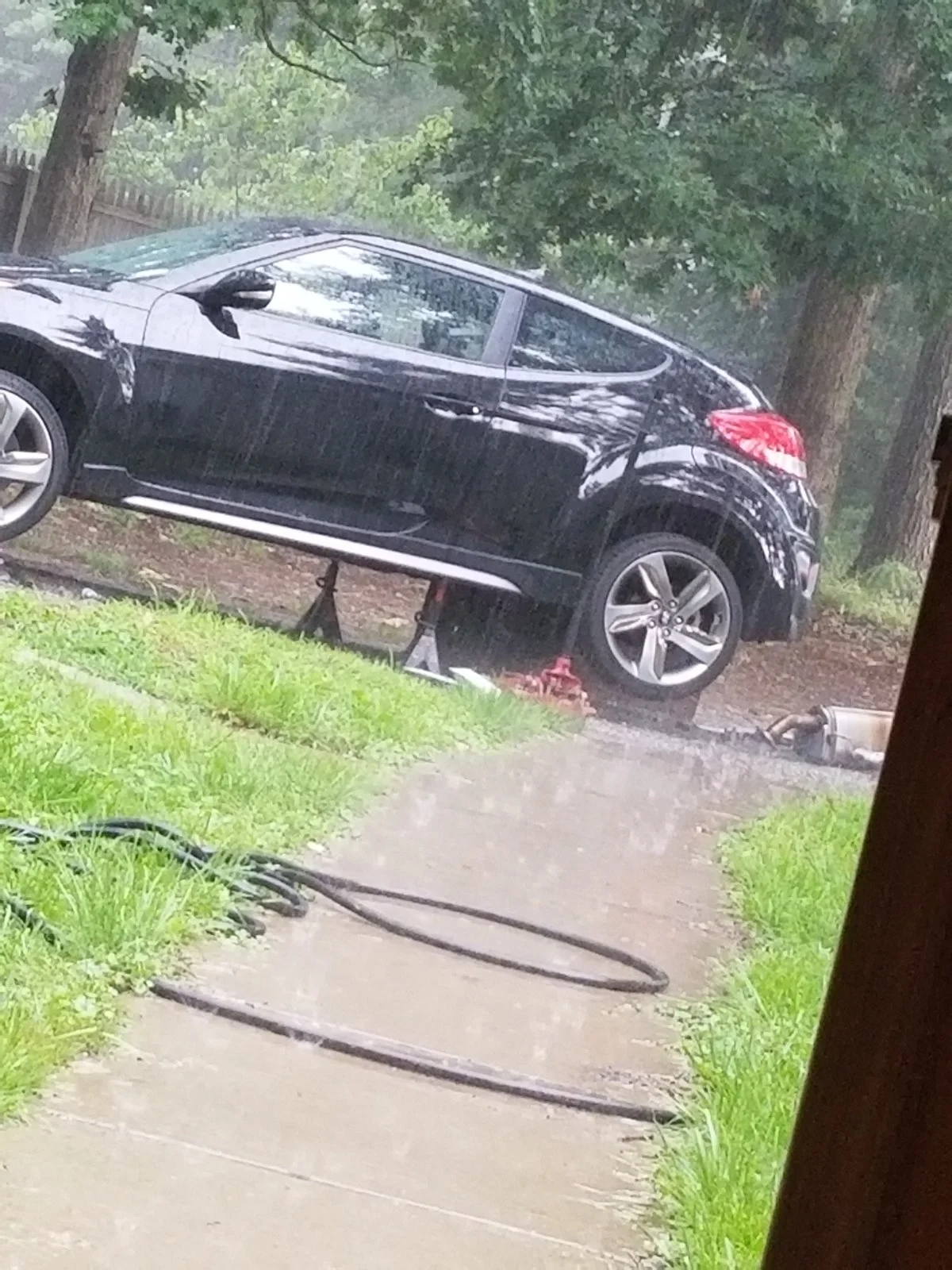

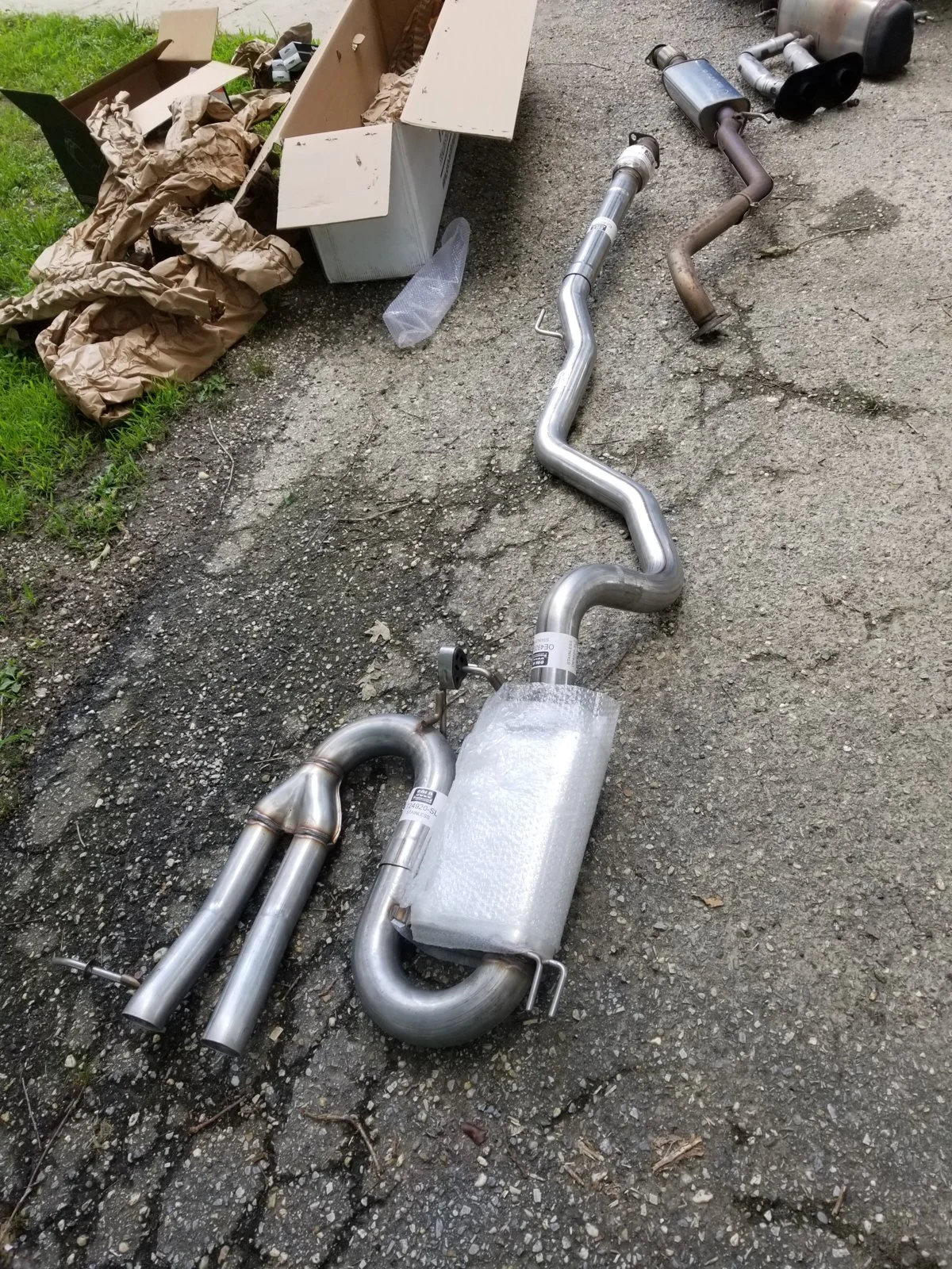

Had a side job today to put an exhaust on a turbo Veloster...
And this happened....
Great ! Love maryland weather...
Reactions: Noobz347, Davedacarpainter and RaggedGT

Davedacarpainter said:
Hey Scott, it's raining.......
I finally got it done. Rain sucks sometimes....jeeesh. This is why i need a garage.
An exhaust cat back and k&n intake system-160...and mazda 3 motor mount- 200... The rain was trying to stop my k member monies
I won !!!! but I'm soaked

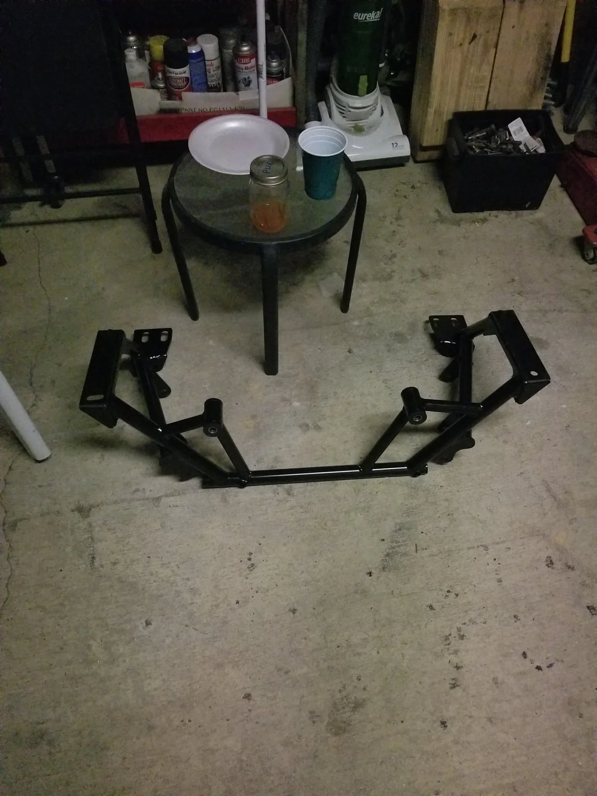

This new K member looks really good. With any luck this one will last at least 10 years, just like the one that's on the car....

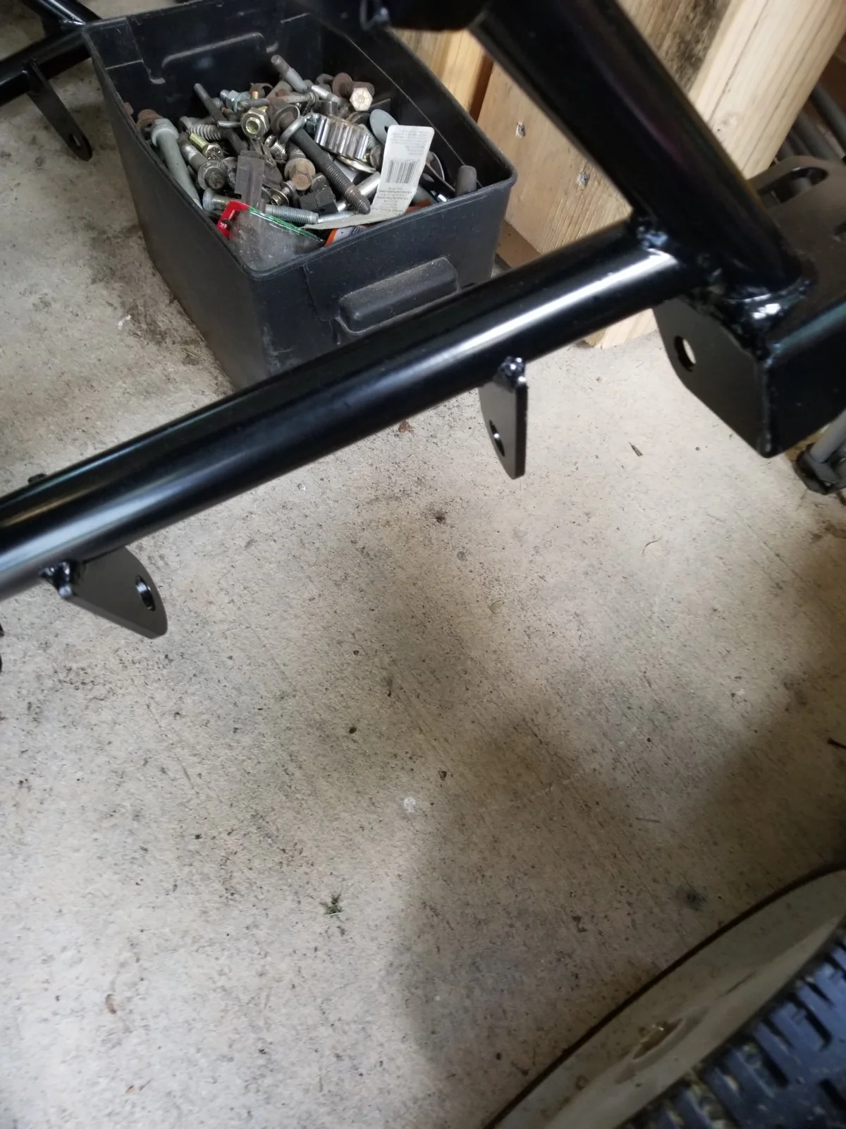

Figured I'd show some things I found out.
A couple years ago AJE noticed an issue with the design of their k member so they changed it.

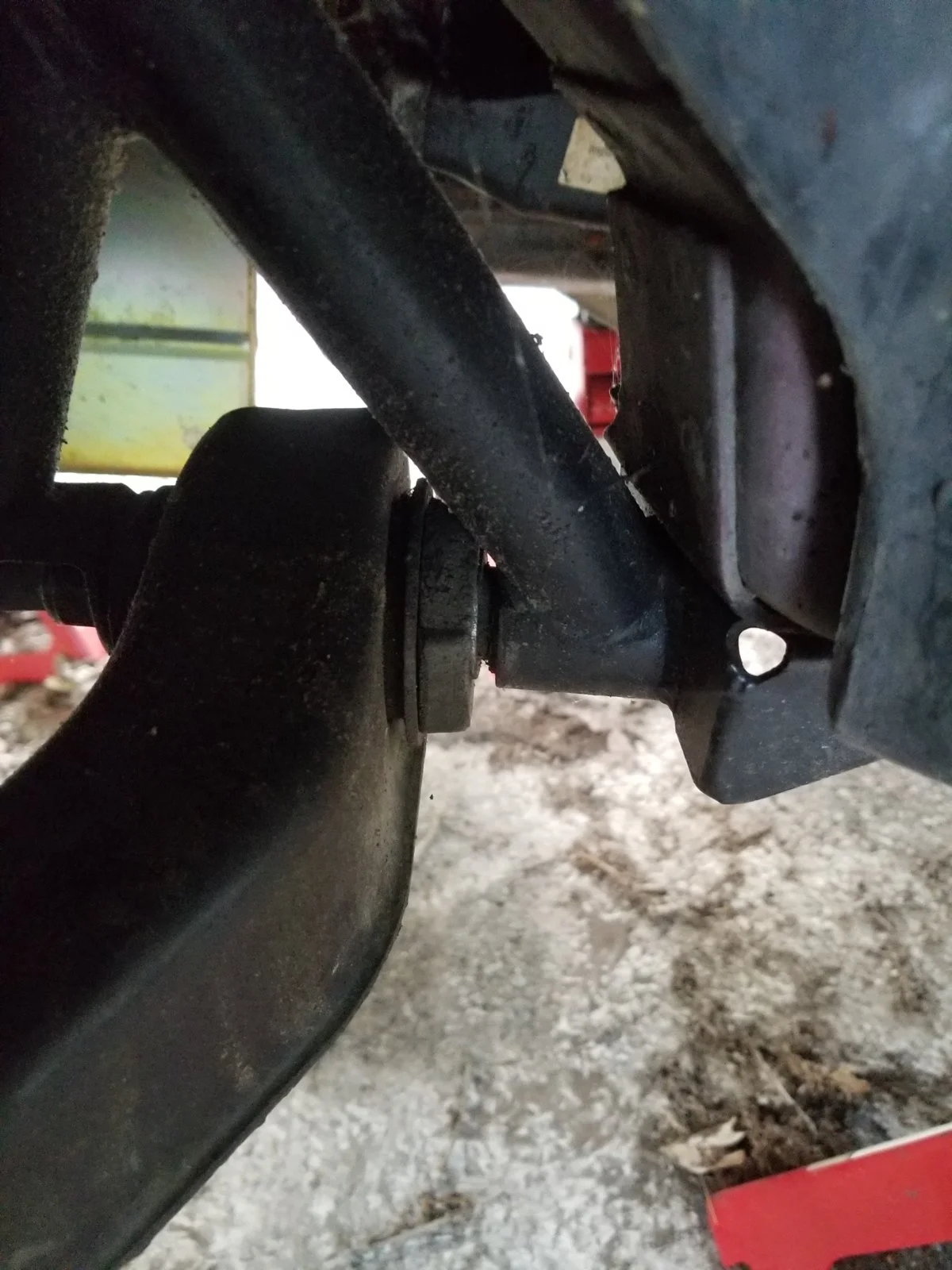

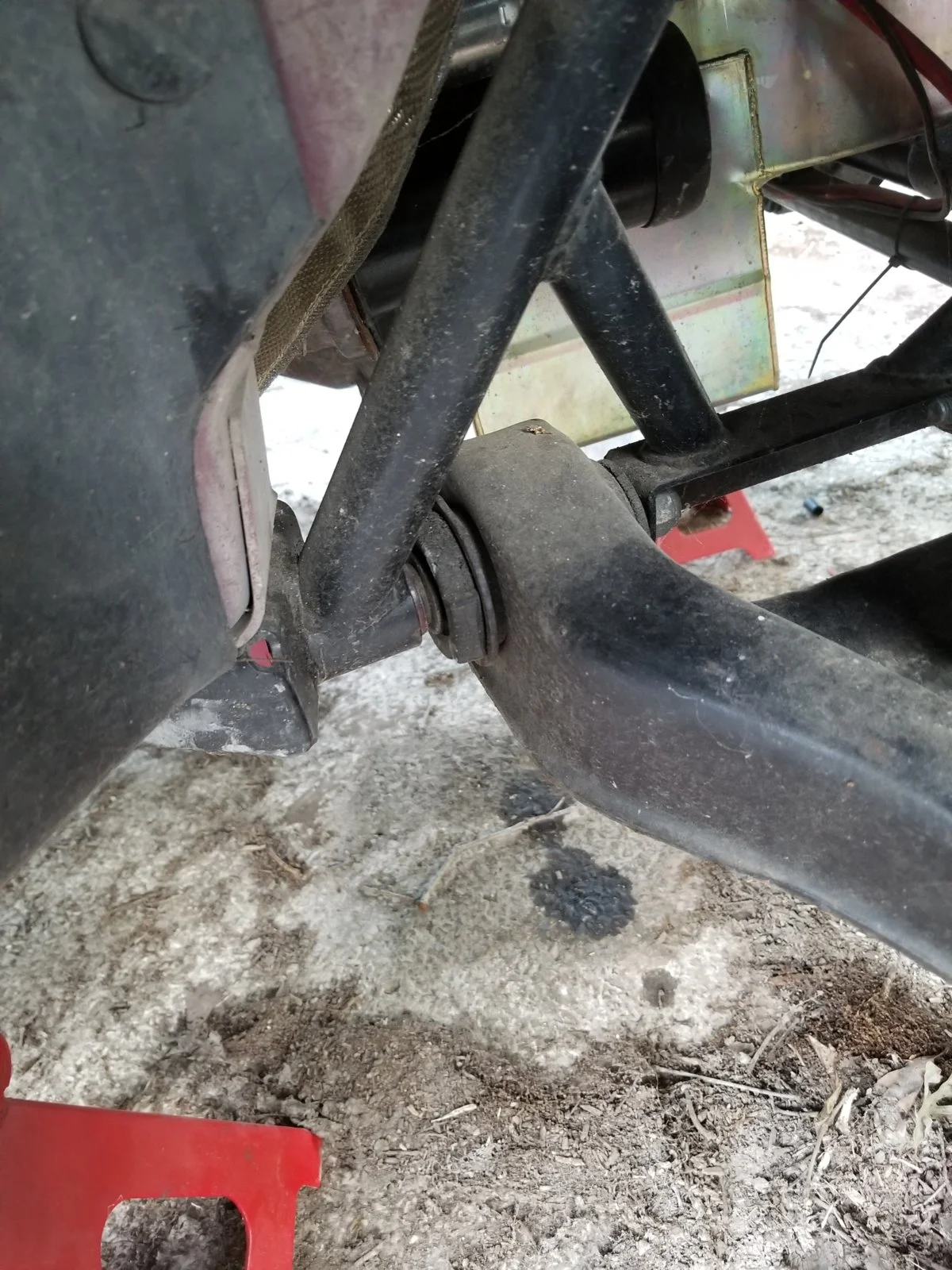

Here's where mine bent....you can't really see it but it bent at the rear control arm mount on the left side.
Here's the other side...
The new design has a bar running from side to side above where the control arm mounts. They also got rid of the slide bushings that were in the original...

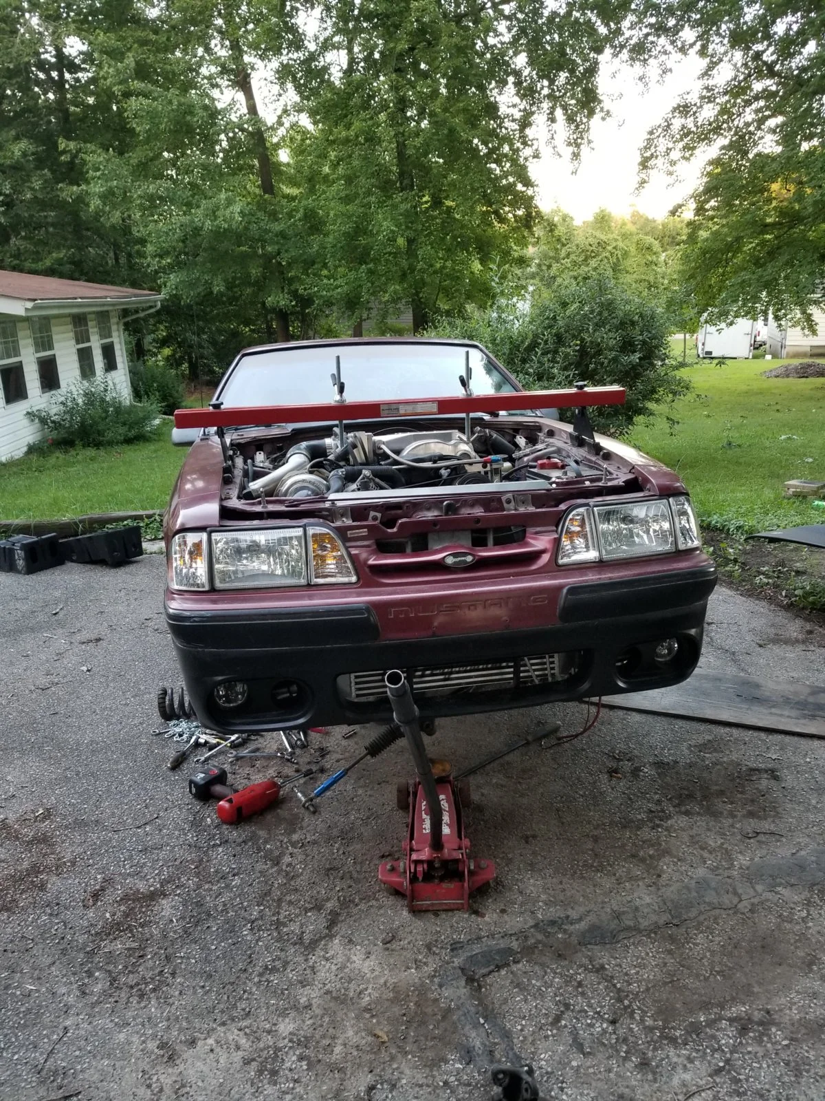

Here's how Dusty sits, a waiting the new k member.
Still a bunch of work to do...but with the , " hunny to do list " , time is very short and spread out. Guess I'll be done in a couple years.

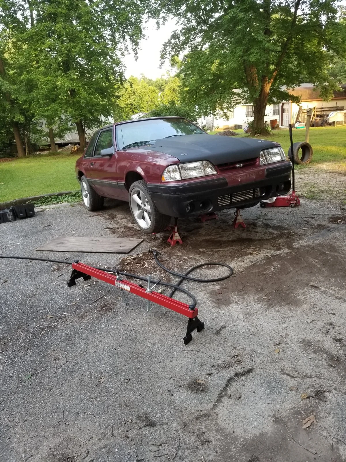

Got a bunch done on Dusty.
The Harbor Freight engine support worked out well...
The k member is in. The passenger side control arm is bolted on. Drivers side will wait till tomorrow.

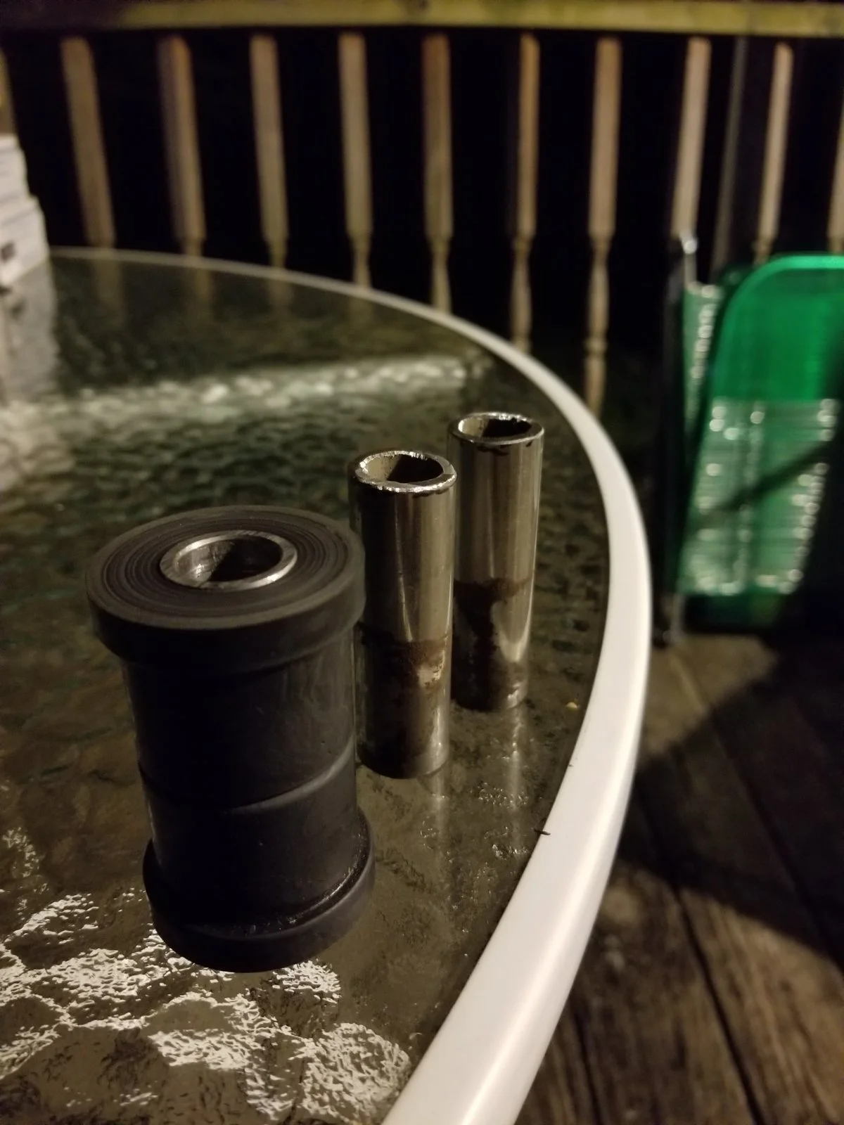

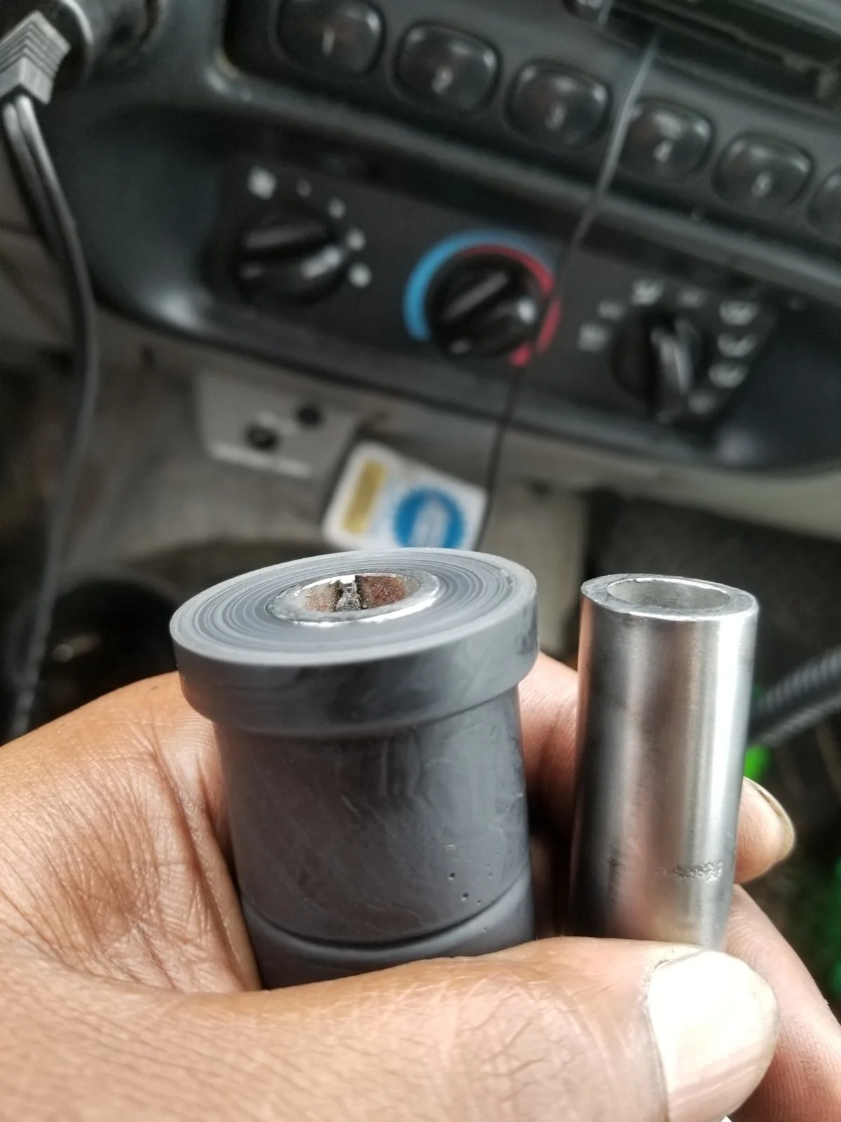

I had a little metal sleeve and bushing missing for the rack and pinion. Luckily, the same bushings are used for the engine mount. The sleeves are about 1/2 inch too long. I already cut them down. They'll be taken to work tomorrow to get traightened out.
This actually works out better because the new sleeve is slightly larger than the bolt. The old bushings fit the bolt perfectly.
I contacted cjpony and they had me send pictures last week but haven't emailed or called back. AJE was also emailed to see if i could buy them....with no response....so....I found a way on my own.

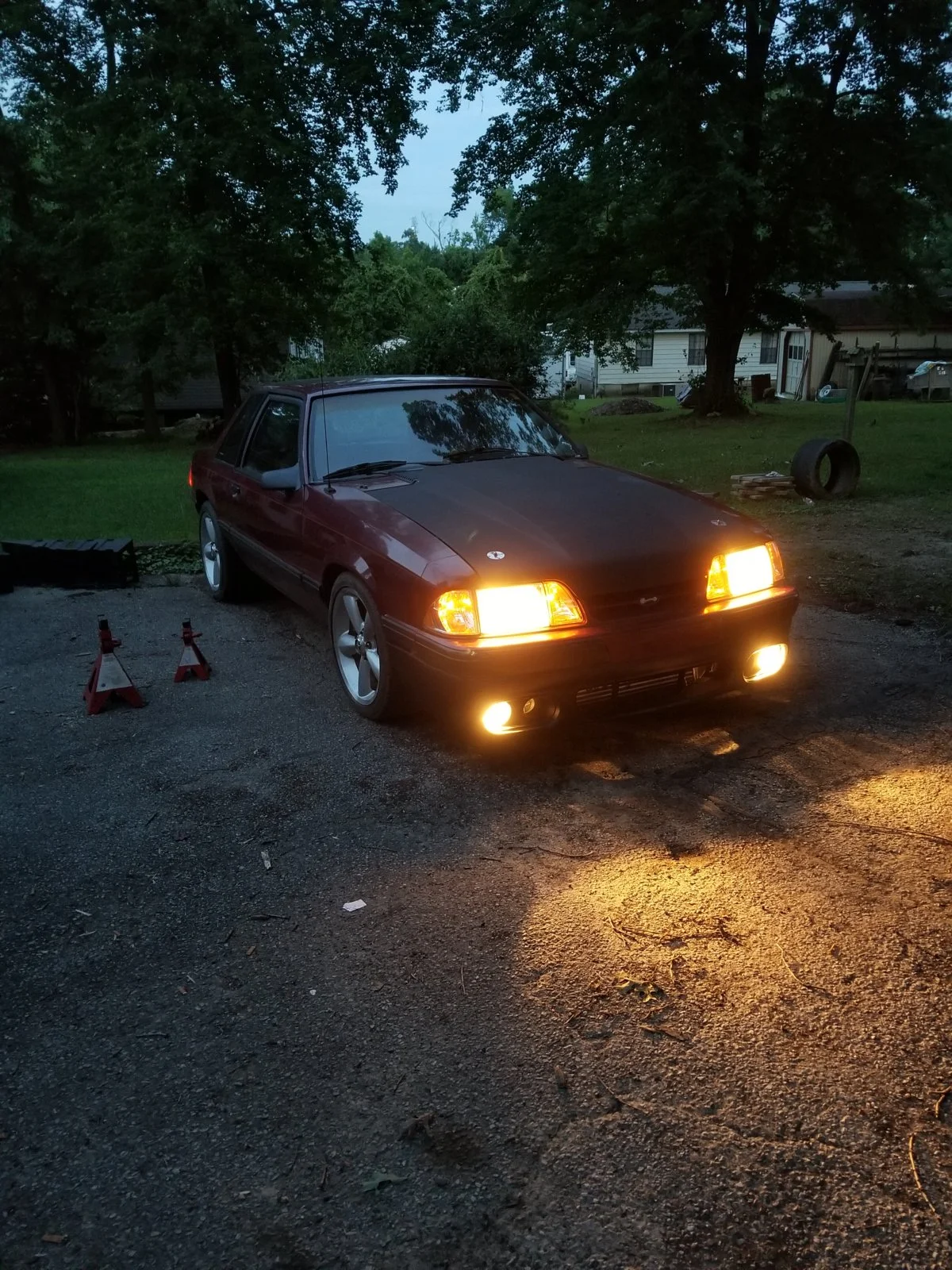

Dusty is on the ground on all 4s. The new k member went in without a hitch.
Almost ready again......
